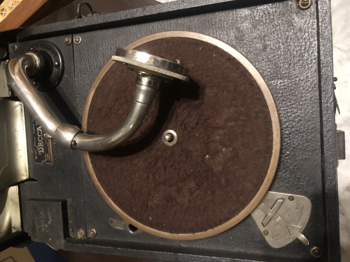

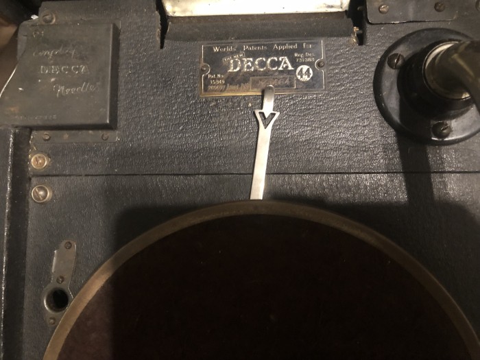

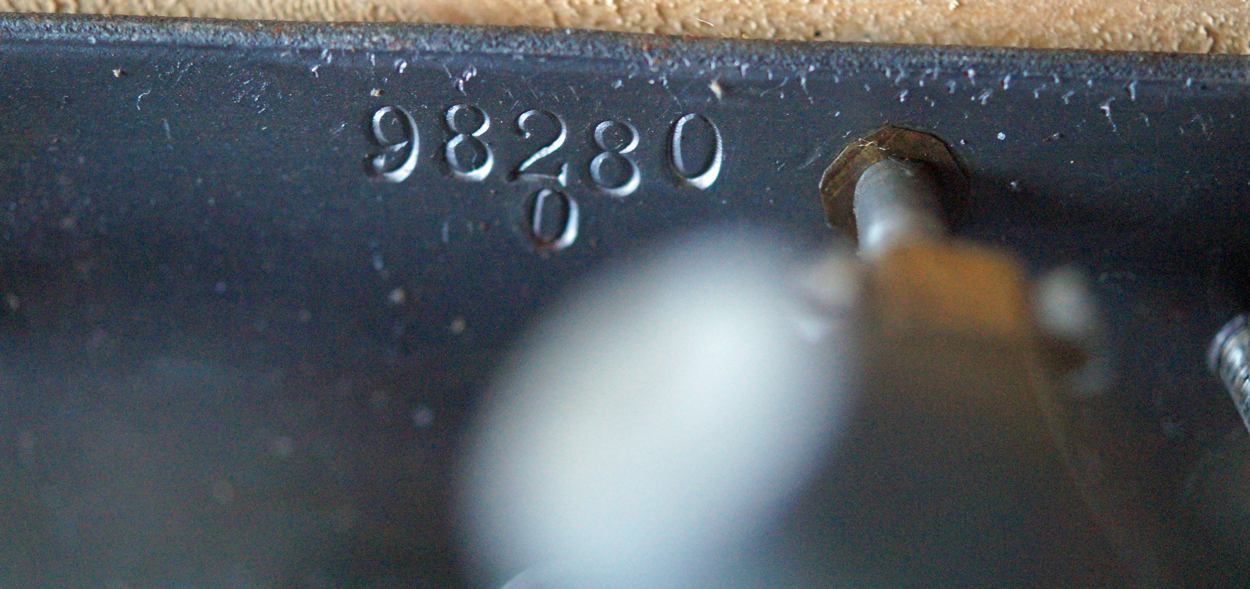

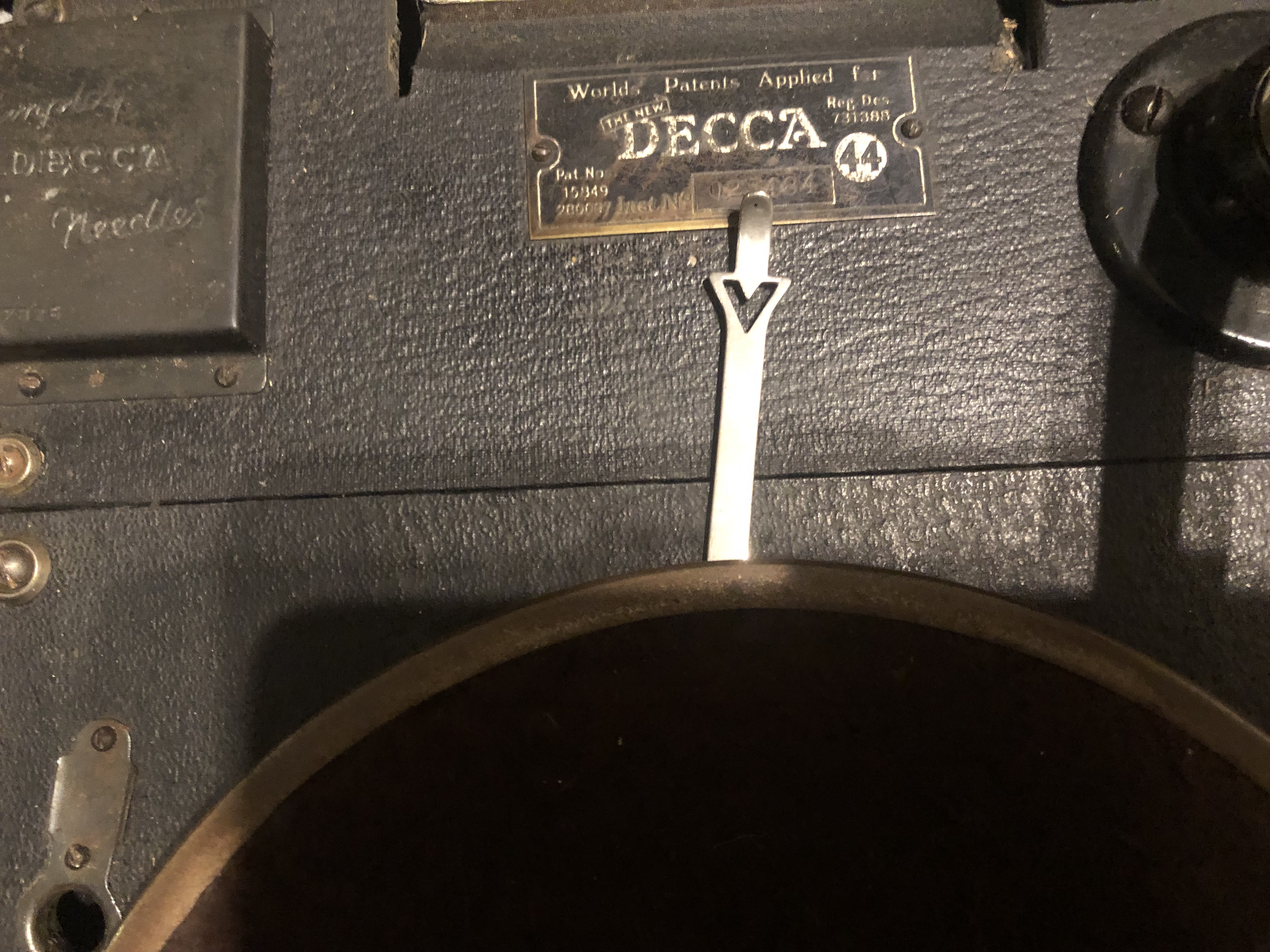

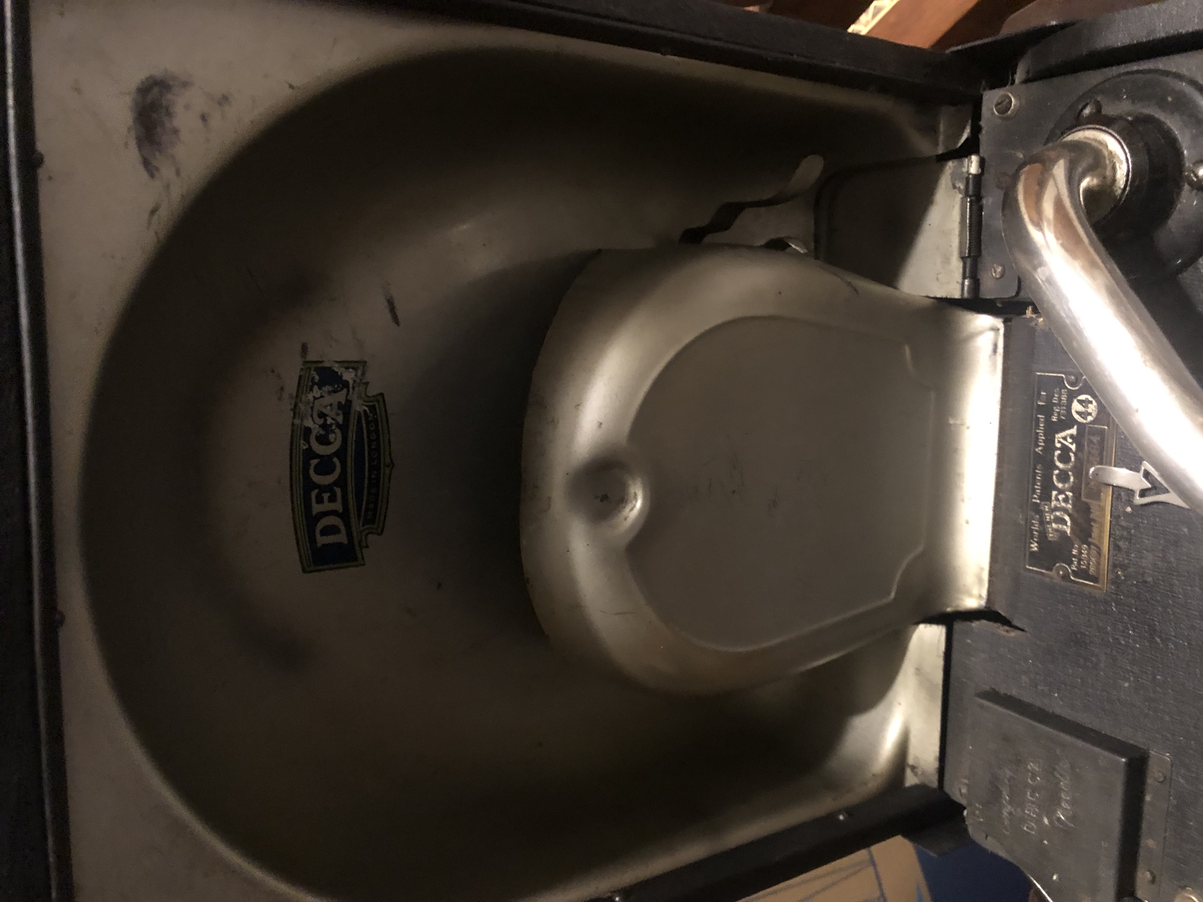

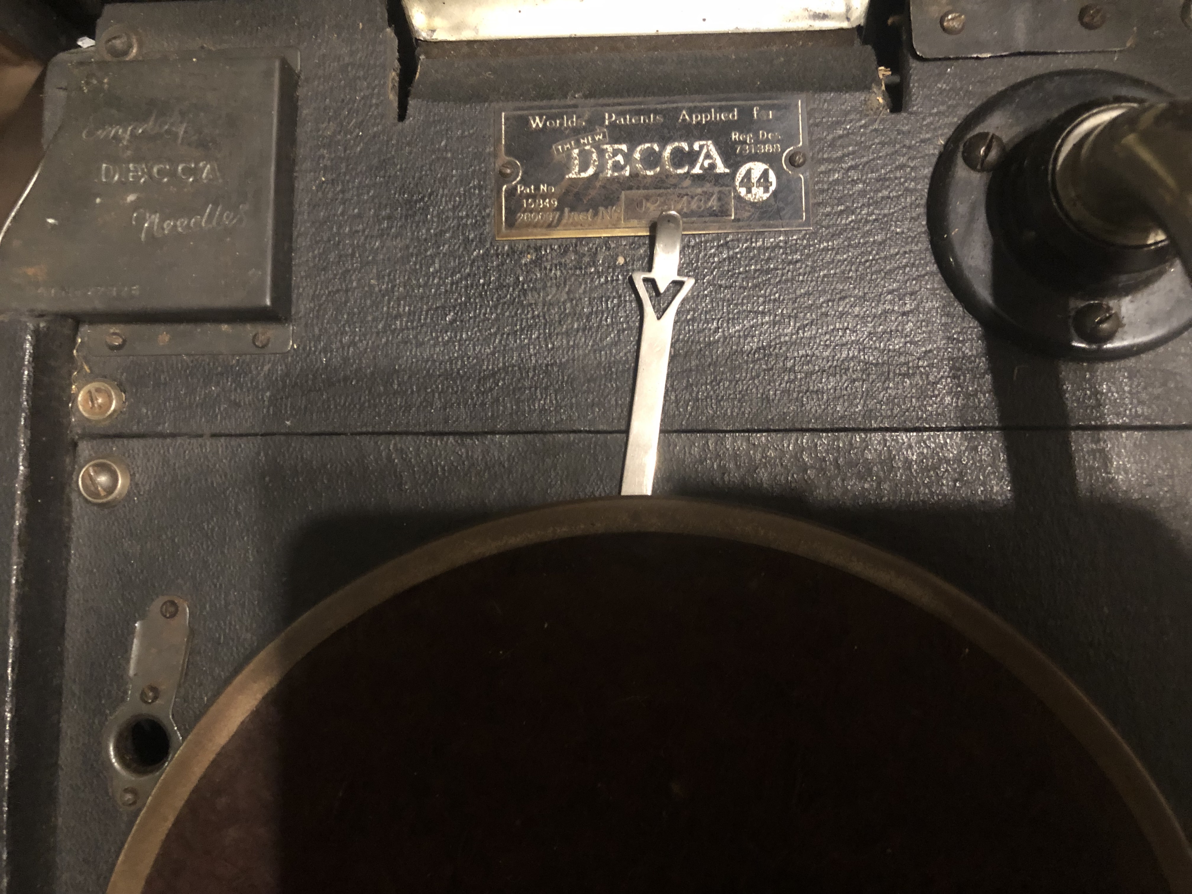

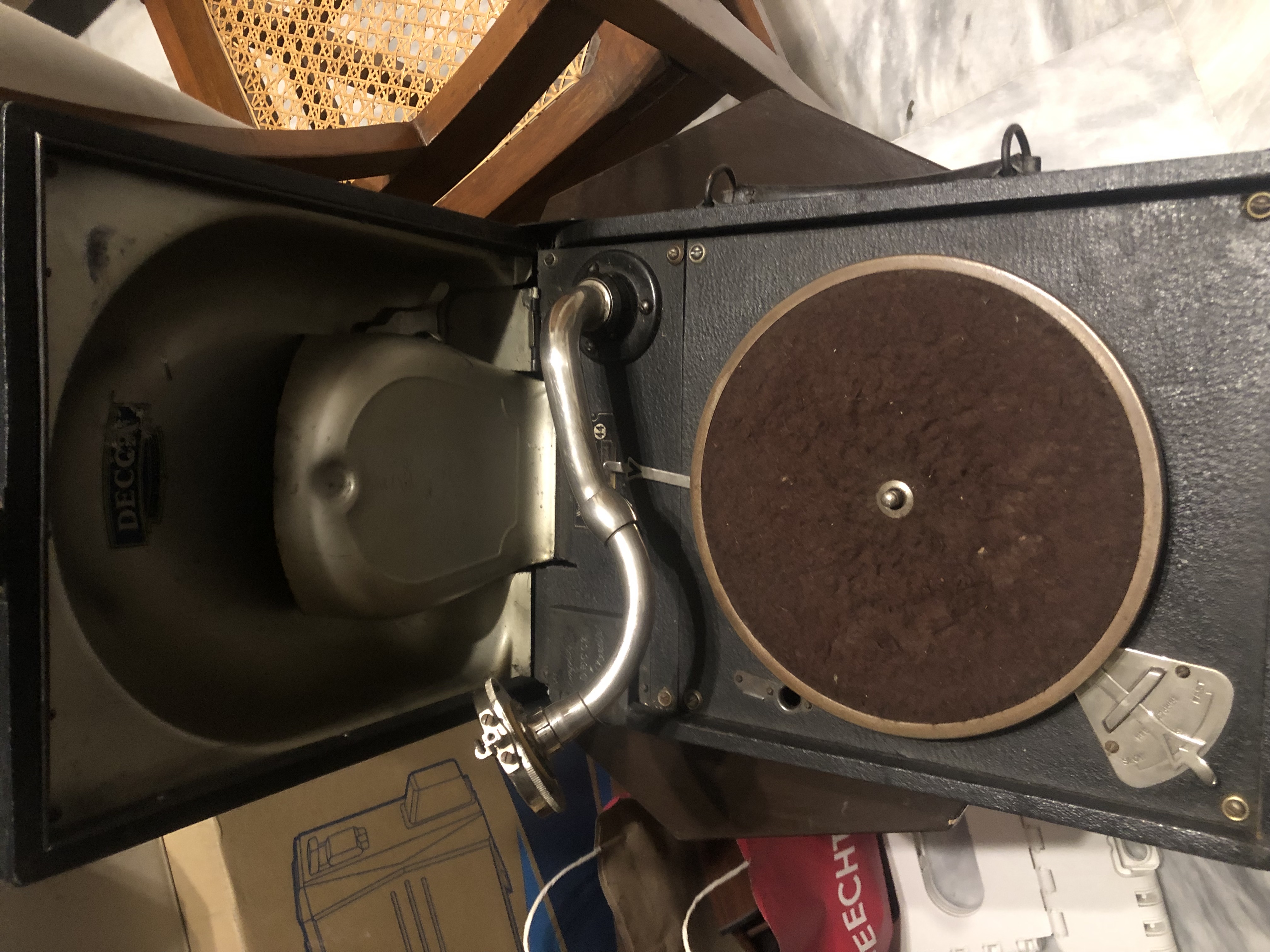

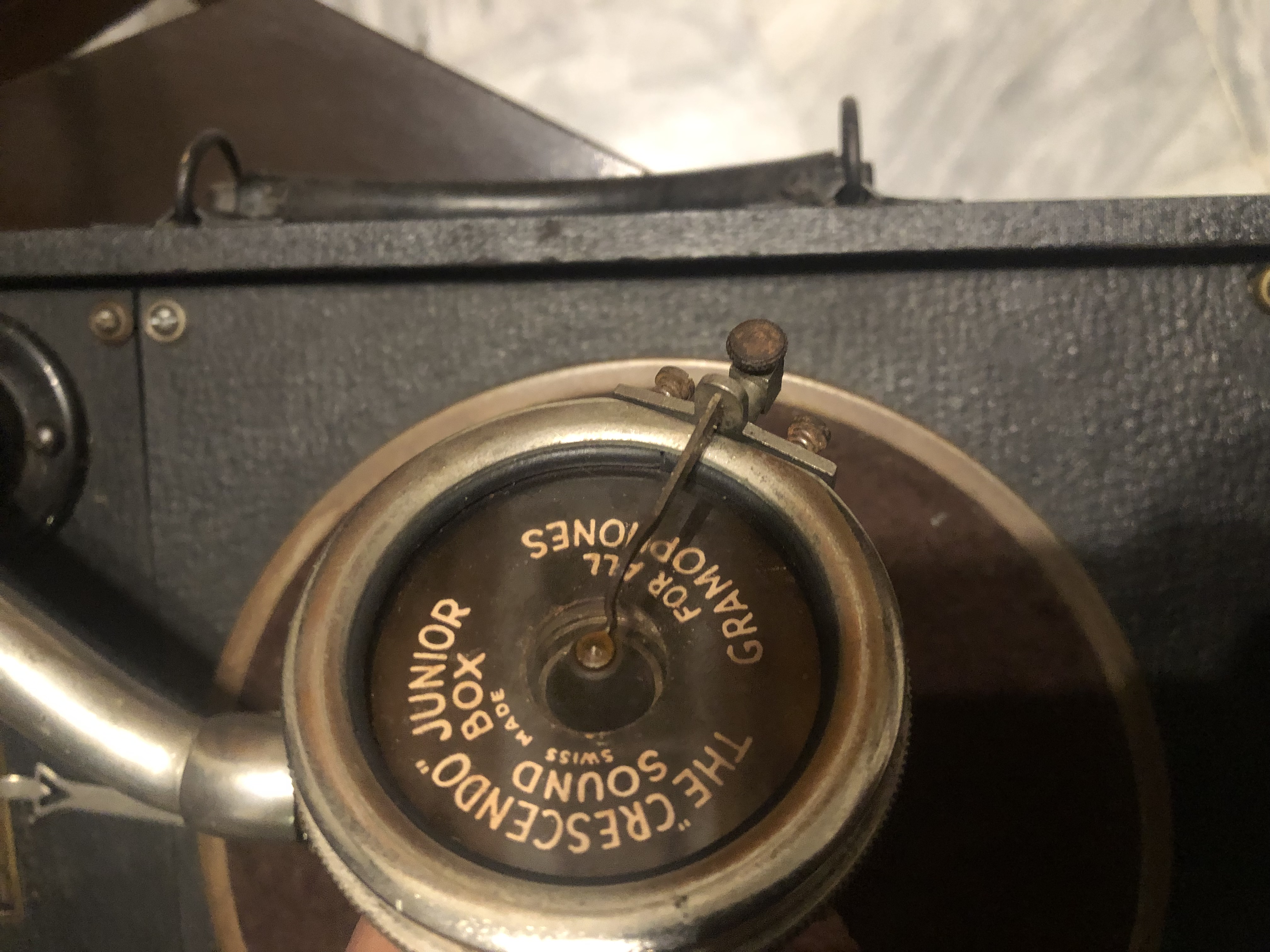

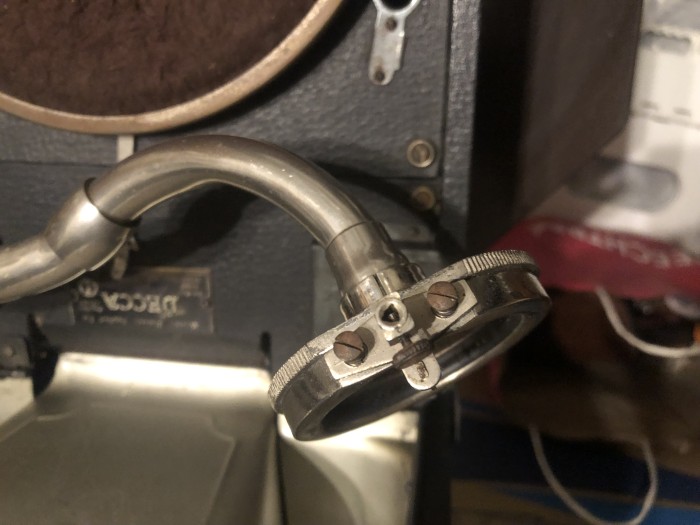

Hi ! If yours is a Decca 44, here are the pictures that may help you in your restoration work.
Regards
Sheraz

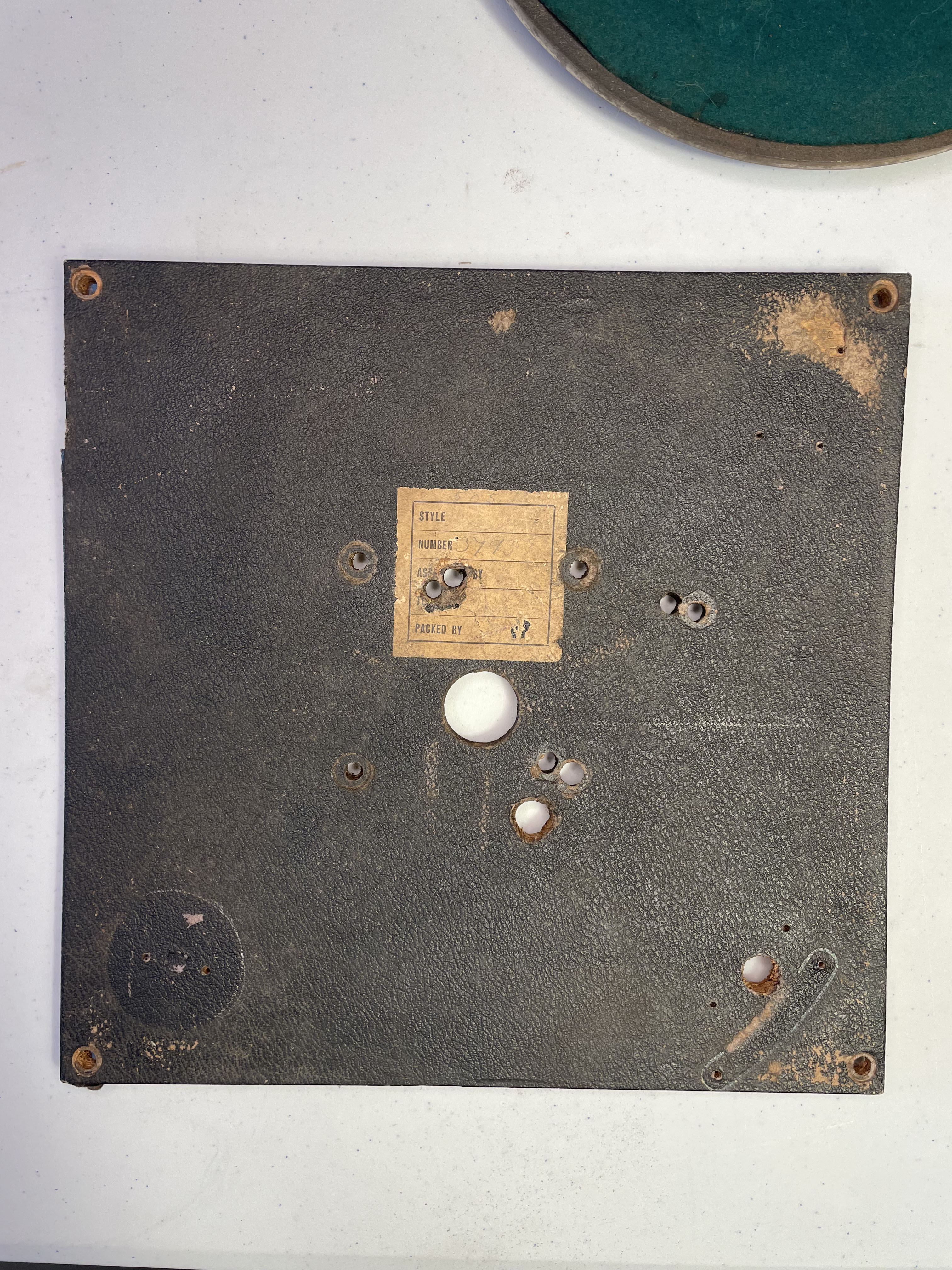

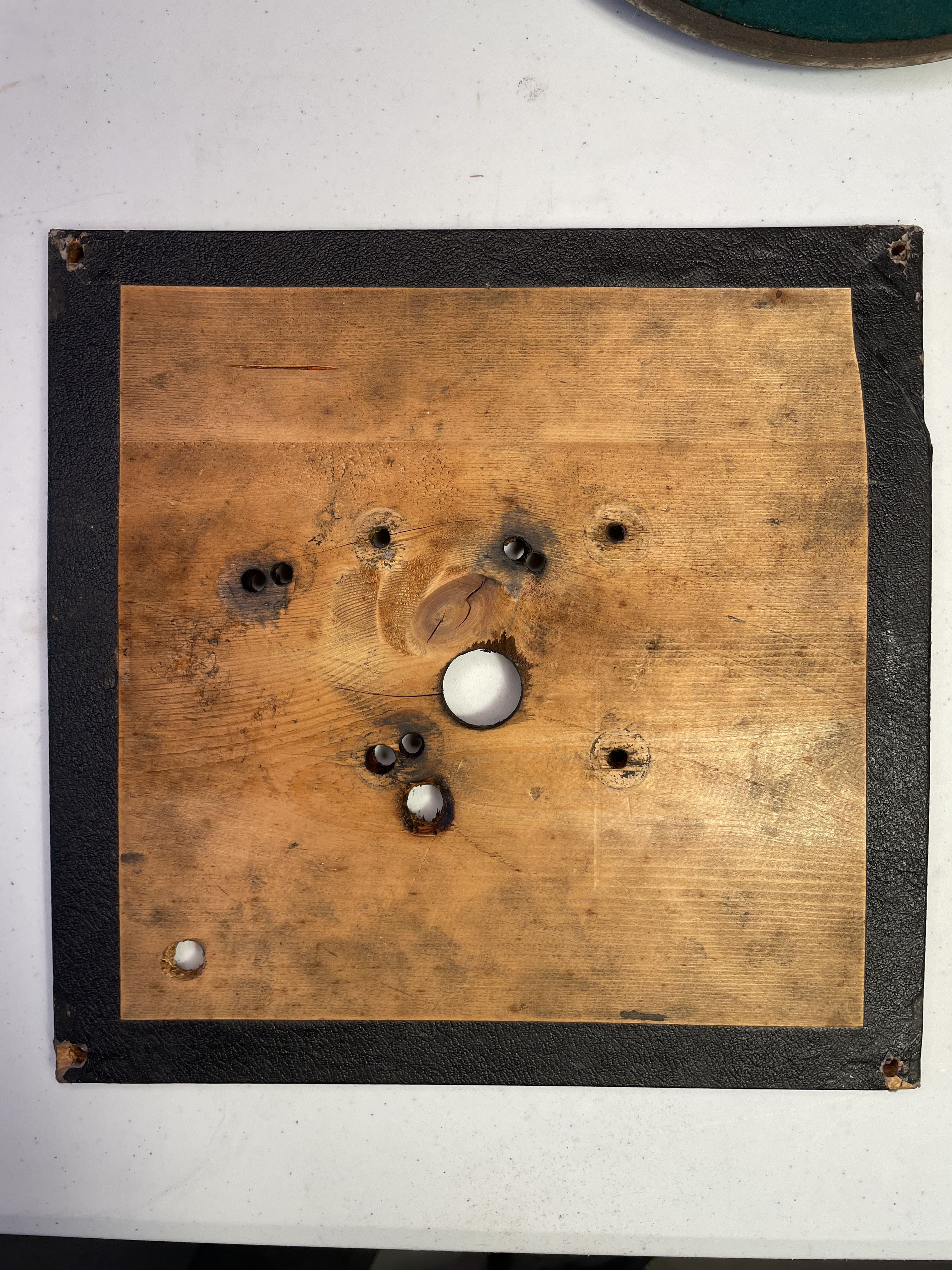

The Motor Board
Please rest assured that I will never — under any circumstances — put another hole into this original motor board.
Someone else in the past has already put in a few to modify this to accept a Garrard (my apologies for my earlier misspelling — too many Paillard searches, my fingers wanted to keep pressing a double-l) Model 14.
Here is a photo of the top and bottom of the motor board, with all hardware removed.
Top view of motor board - all hardware removed
Bottom view of motor board
The bottom view is a little better at revealing where I believe the original motor attachment points were.
The board is also slightly warped (damp storage, time, and weight of the motor has taken its toll) so

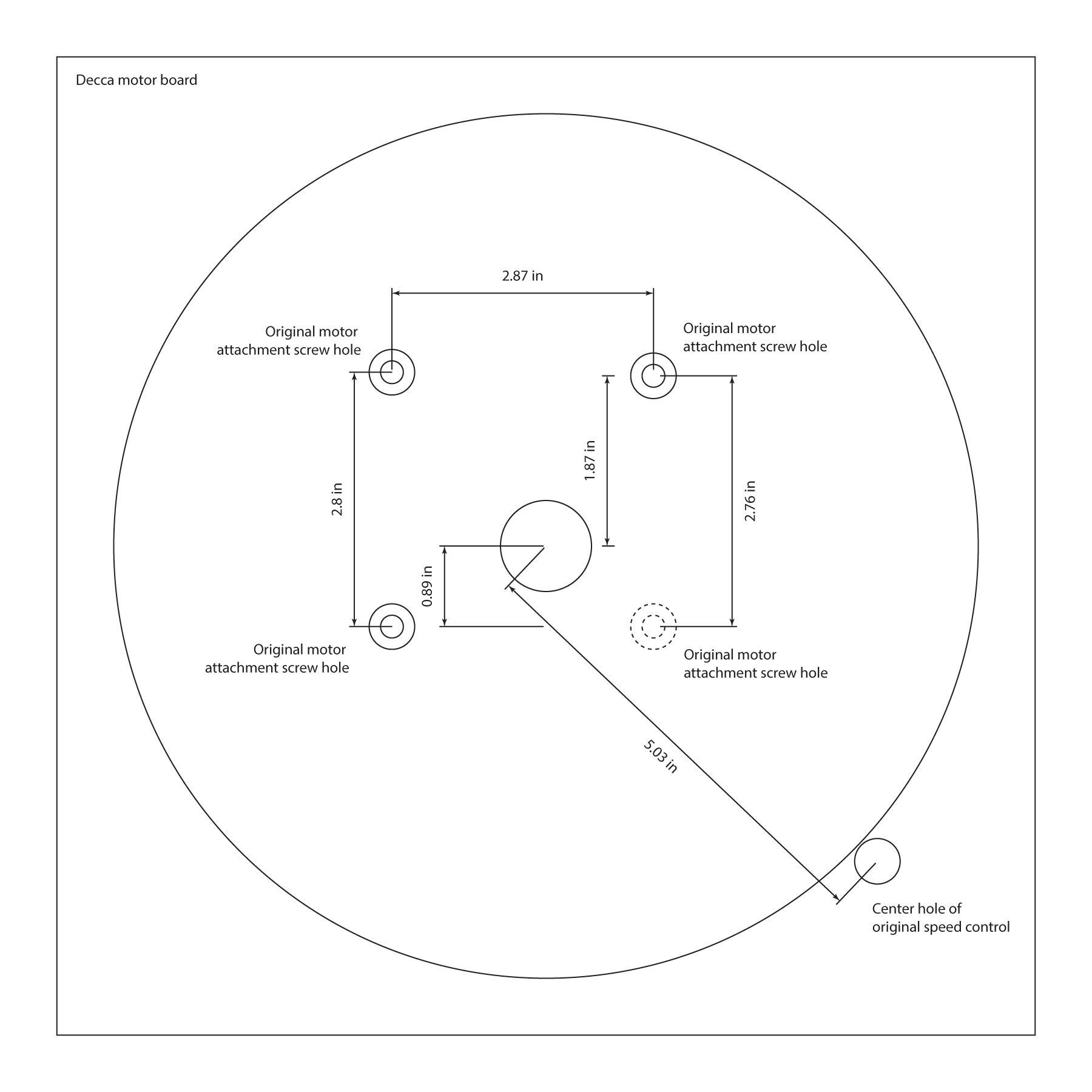

Oedipus again made an excellent observation that during the war any and all available parts were likely used to complete these machines as well as possible. While the original motor would likely be a Paillard or Thorens (or a similar Swiss type) the best method would be to measure the original attachment holes and find an appropriate motor to fit.
Here's my diagram showing the original attachment holes and the distance from the center pinion to the center of the original speed control adjustment hole.
Rough diagram showing original motor attachment points
Fortunately, the excellent Swiss website Graphonogram (https://www.graphonogram.com/4-documentation.html) has an excellent collection of Paillard and Thorens Catalogs from 1910 and circa 1920. Some even have dimensions that might help. So, the search begins!

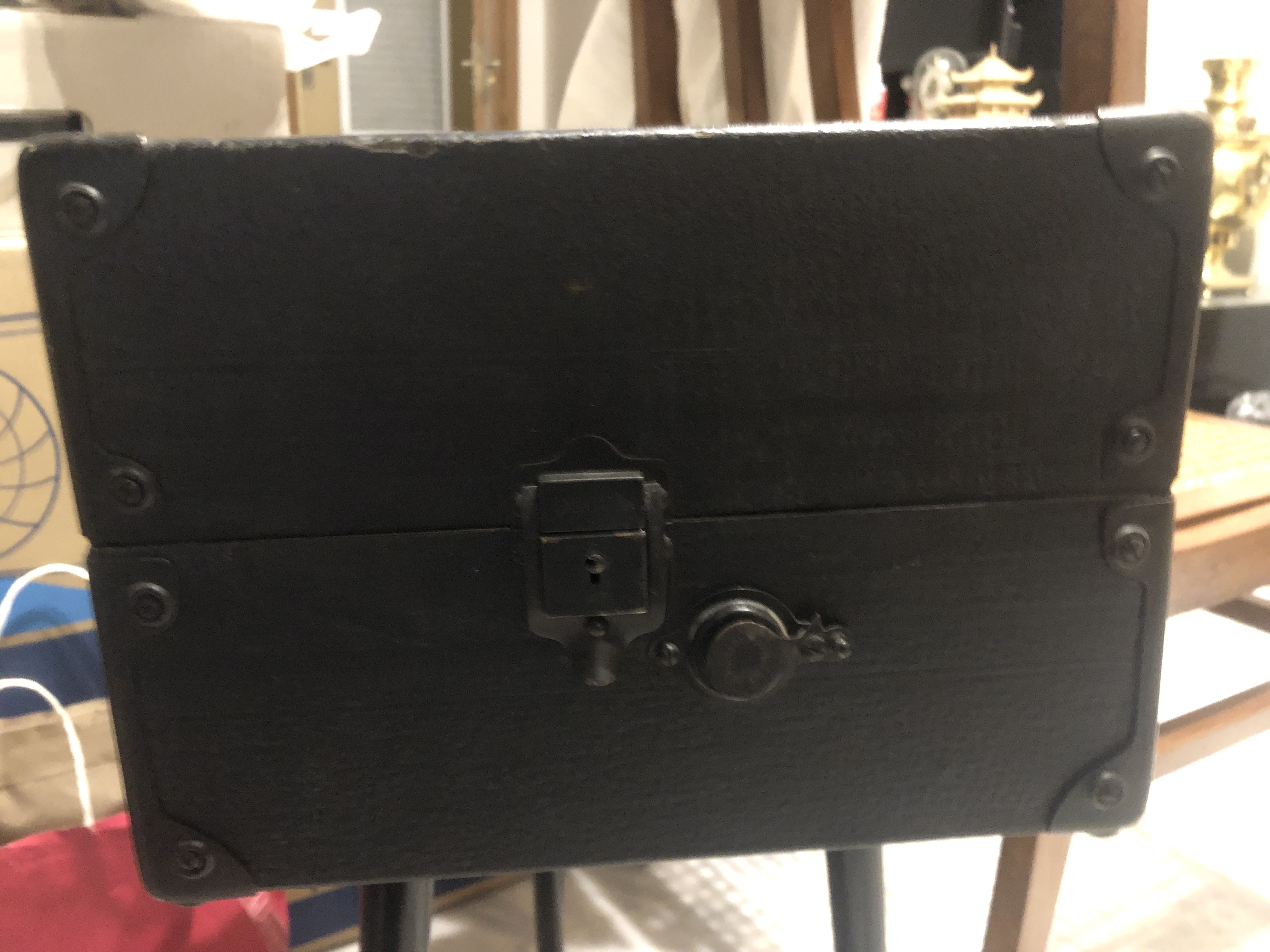

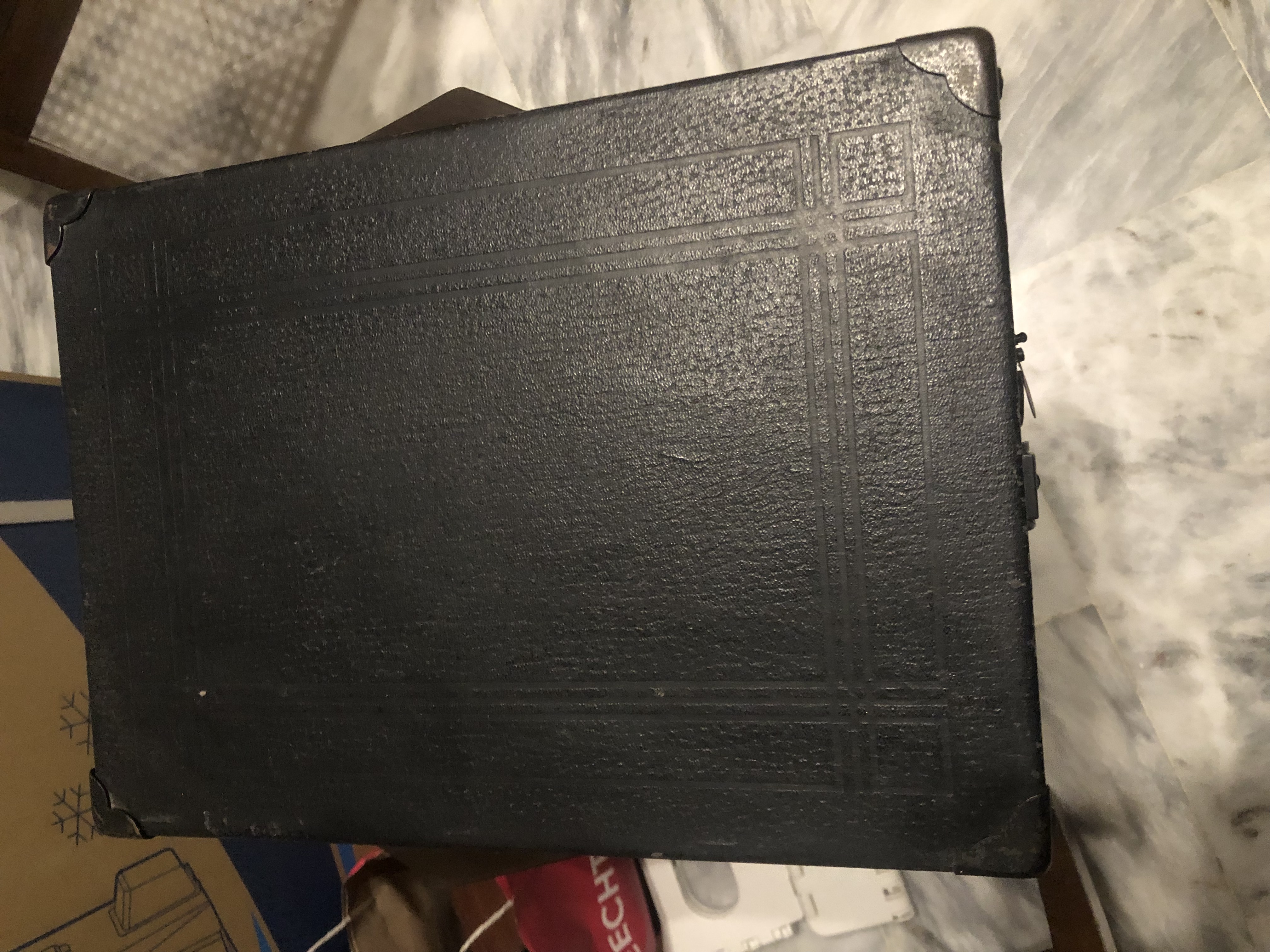

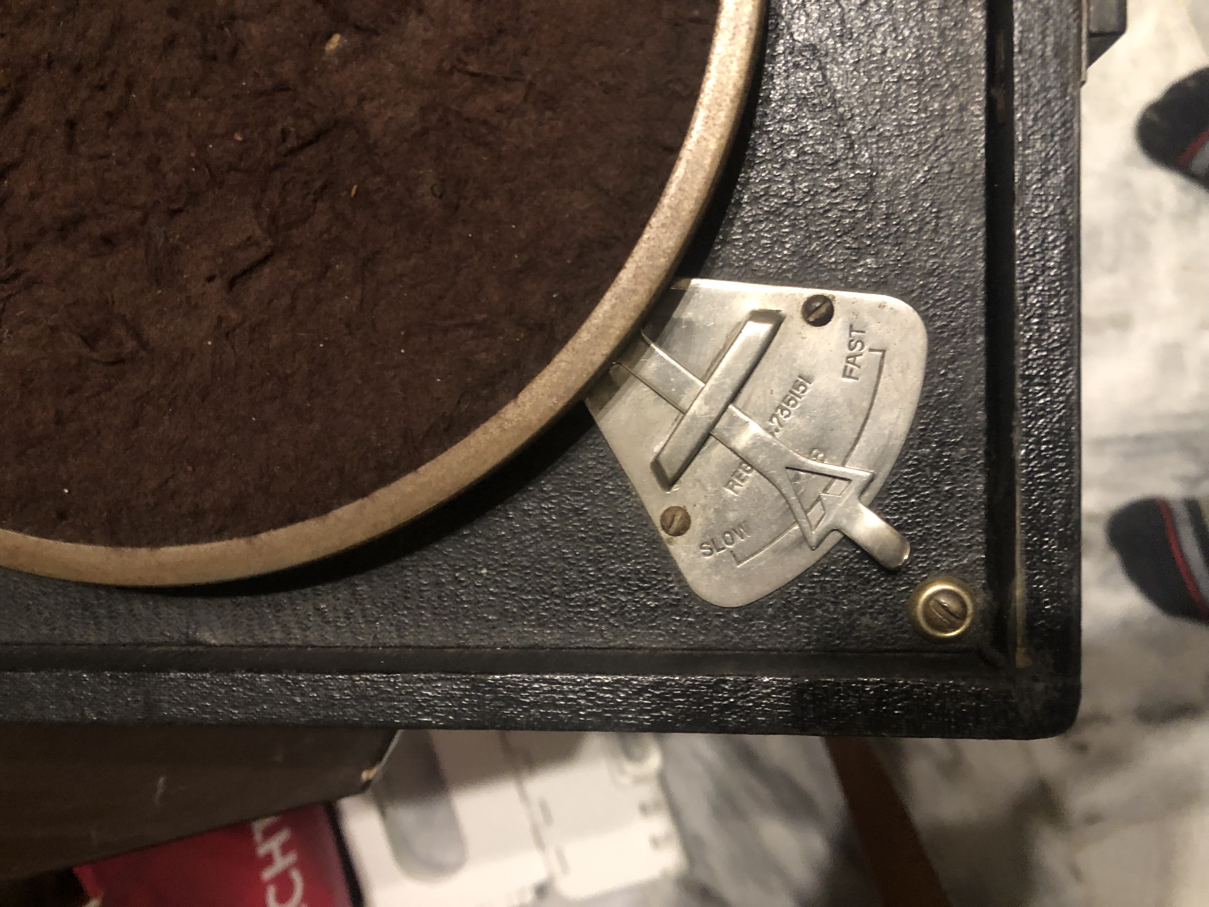

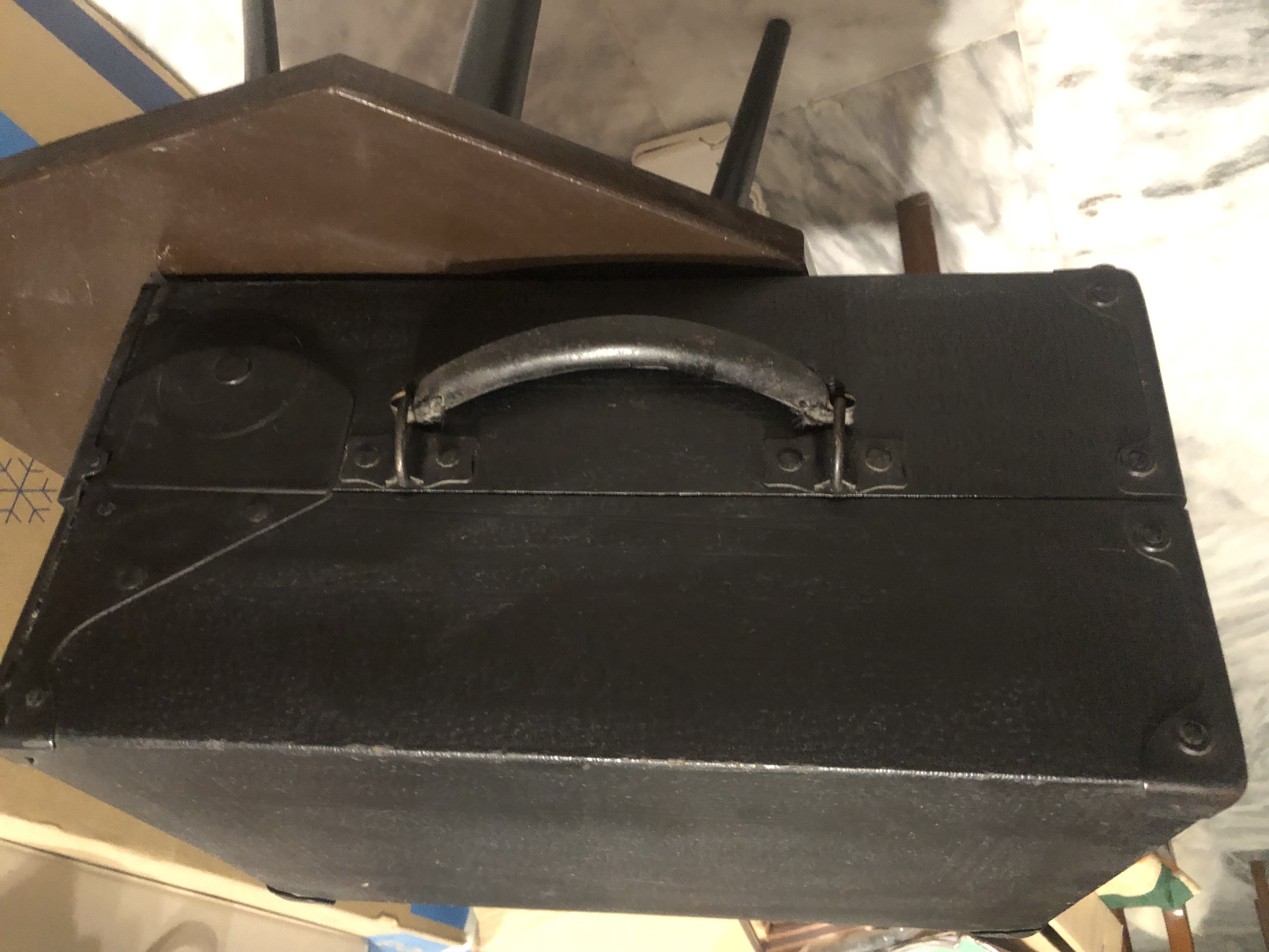

Given your description of the machine, yours may be one of the two models in the attached pictures. There must be marks of tiny screw holes for handles and locks in the front of the case, which may help you identify your model.
Sheraz

Thank you, Sheraz.
My model machine has the handle in the back where the hinge is. There are no holes in the front for clasps.
The photos you posted are of 1920s era machines, I believe. Mine has characteristics of the earliest 1915-1918 types.
Michael

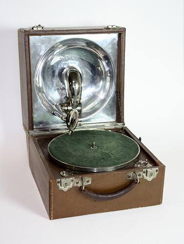

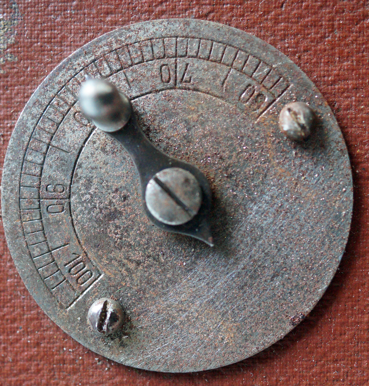

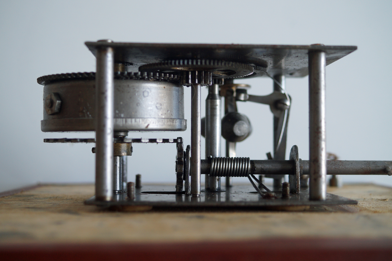

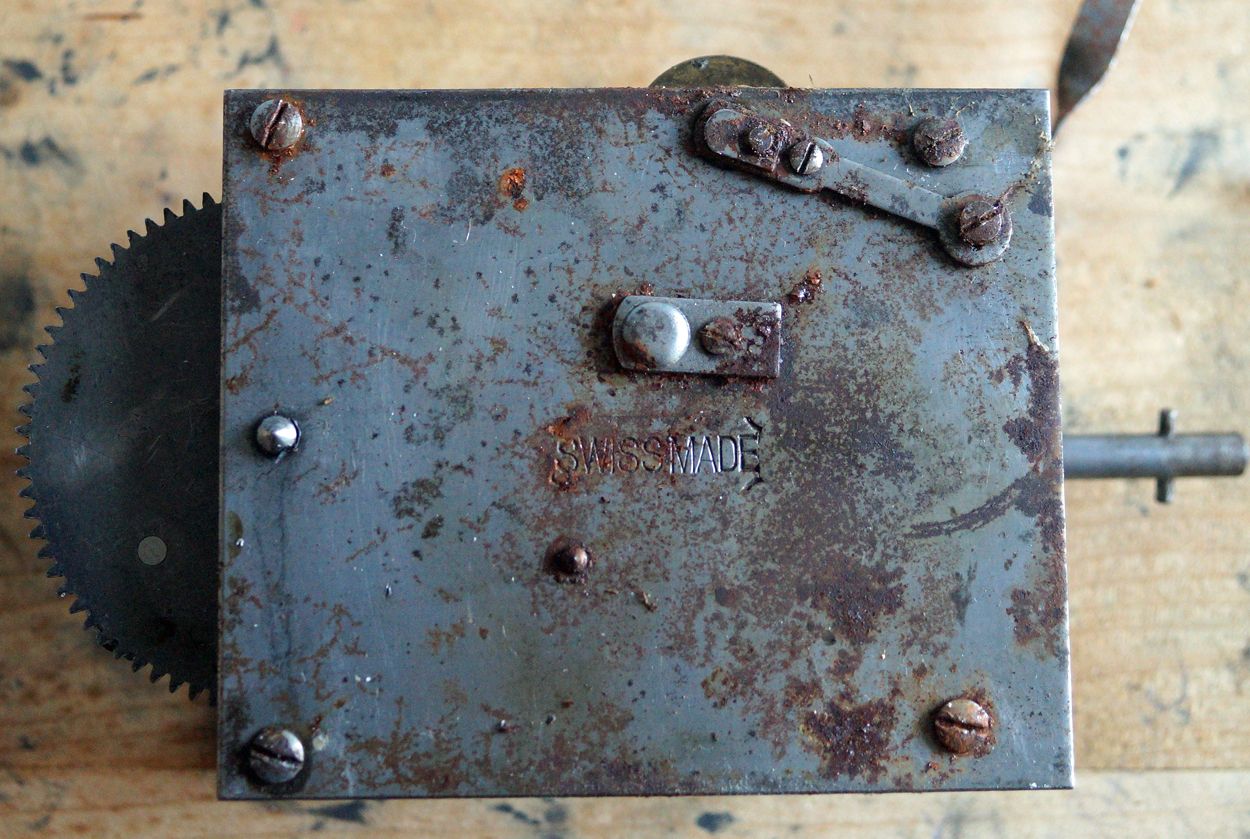

I have two of the early Decca models with the 'copper' colour reflectors.
I managed to find one of my machines but sadly I removed the brake to clean it some time ago and (of course) I can't remember where it is now. I will find it in a few days though. It will not be lost for-ever. I think it is circular incidentally.
Anyway, the one I found still seems to have it's original motor and speed control. The motor just has 'Swiss Made' and a number on it.
I don't know how useful they are to you but photographs are 'below':

Ah! Thank you poodling around!
These are very helpful indeed. Thank you for taking the trouble to send them.
I’m certain I need to find a motor that is similar to the one you showed. Single spring, probably one play per wind.
Thanks so much!
Michael

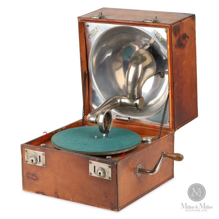

Here’s a recent auction showing an early Decca.
It’s a leather model, but has the same Dulciflex bowl and labels mine does. And the handle at the hinge back.
https://live.millerandmillerauctions.co ... phonograph

mbhdesign wrote: Fri Apr 19, 2024 5:00 pm Here’s a recent auction showing an early Decca.
A very good find !
It does indeed seem to show how yours would have looked in all probability.

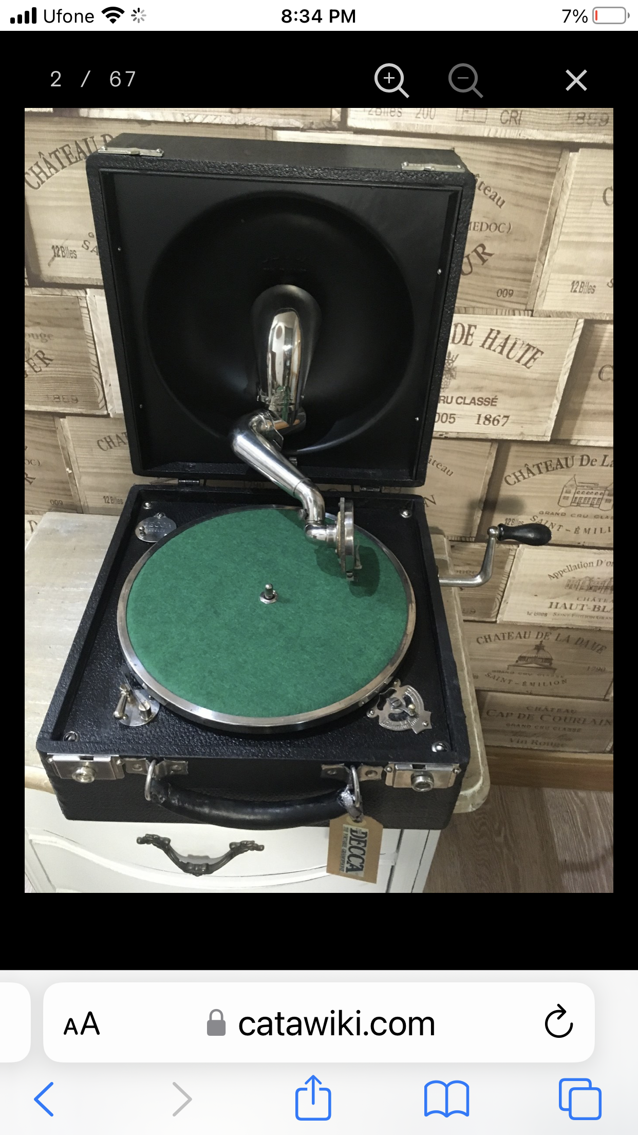

However, something puzzles me. In the photograph below there are three items attached to the motor board. One would be the brake, one the speed control and the other ? (eludes me).
Maybe the one I labelled '1' at the back is a new addition and an additional brake ?
Maybe I am missing something obvious ?
