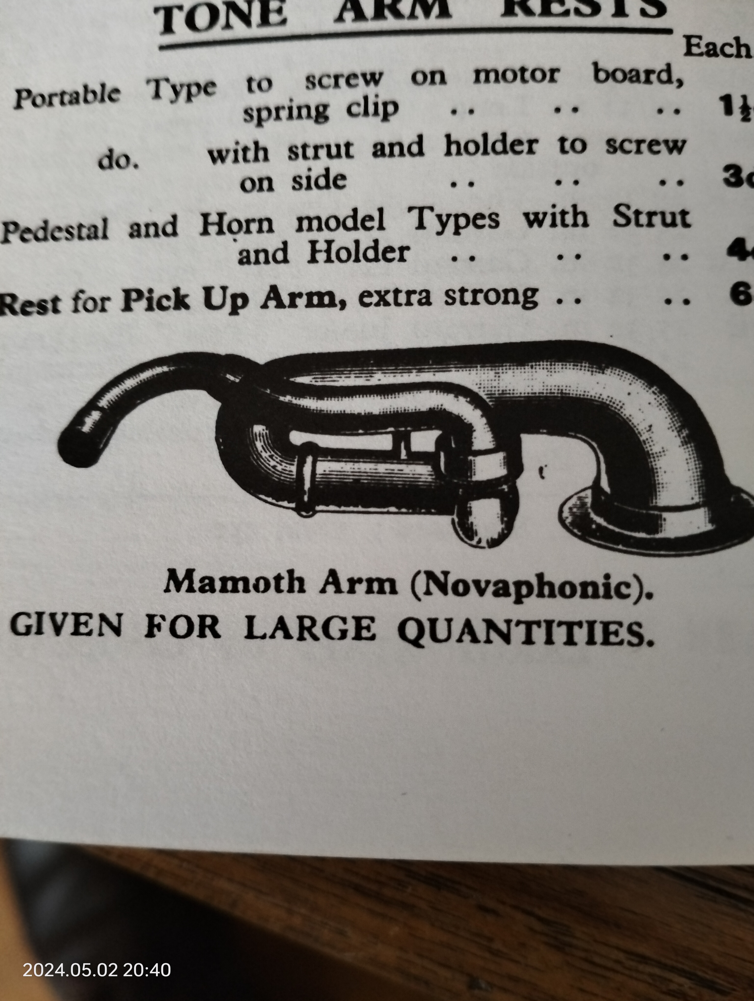

Re: Alba Gramopohone
Posted: Thu May 02, 2024 2:26 pm
by Inigo
Wouldn't it be the same as this one?
Or this, seems equal, from a Maxitone patts catalog
