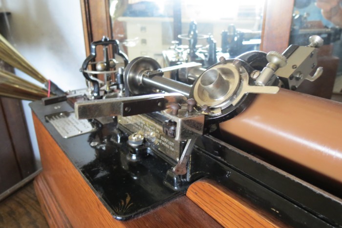

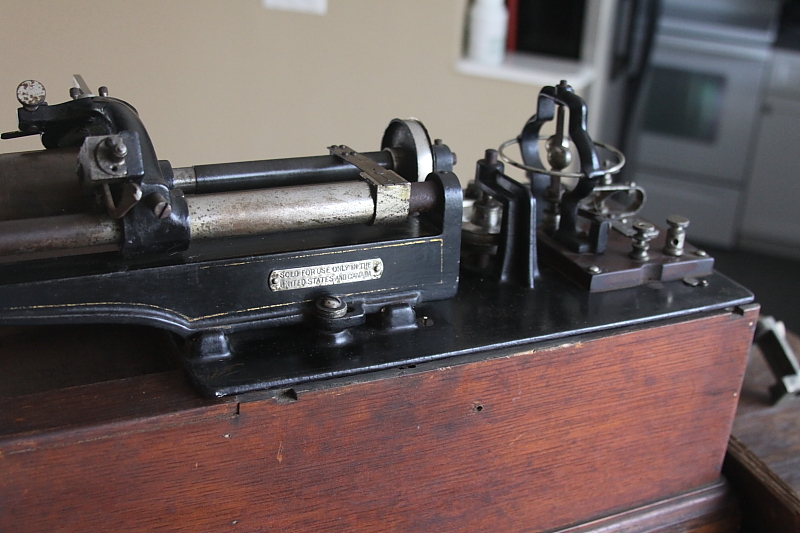

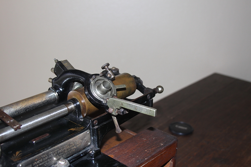

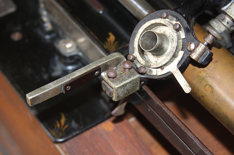

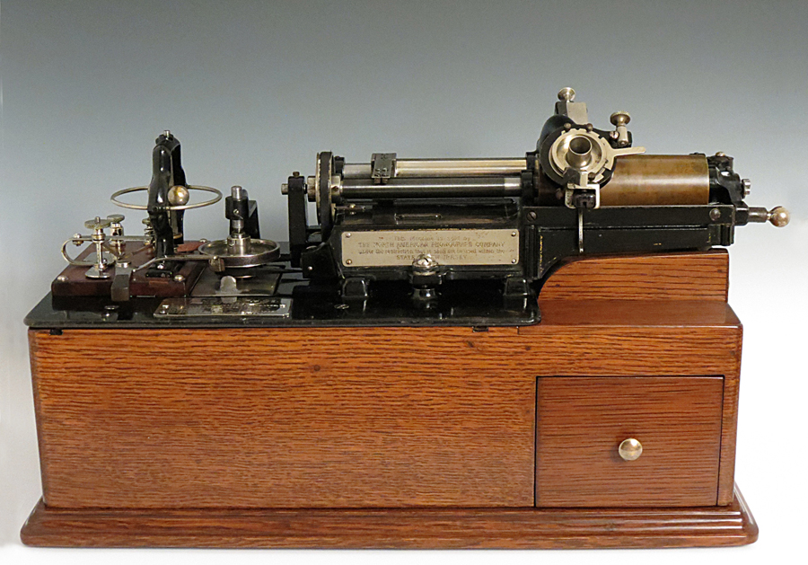

For informational purposes, I had a Class M SN 6589 that was once in a Keller Coin Op but the mechanism was later repurposed into the typical late style edison "Victor" case like your Class M. Two features that stood out were a "SOLD FOR USE ONLY IN THE UNITED STATES AND CANADA" plate on the reverse side of the upper bedplate and an extended nickel plated arm that was screwed on the carriage above the lift lever. See pictures. If your carriage has 2 screw marks above the lift lever, it could have been in a Keller.

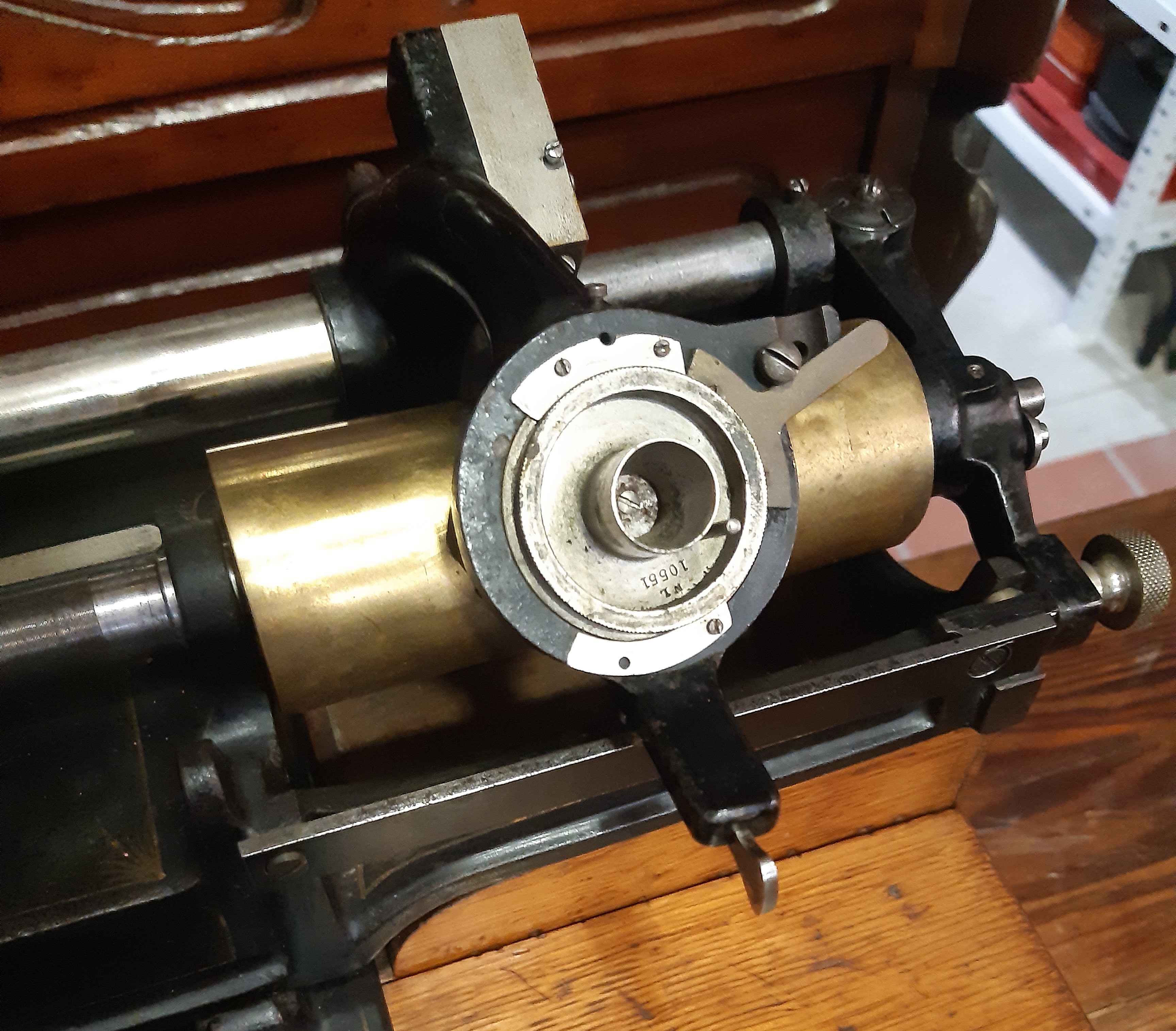

Post by ducretet »

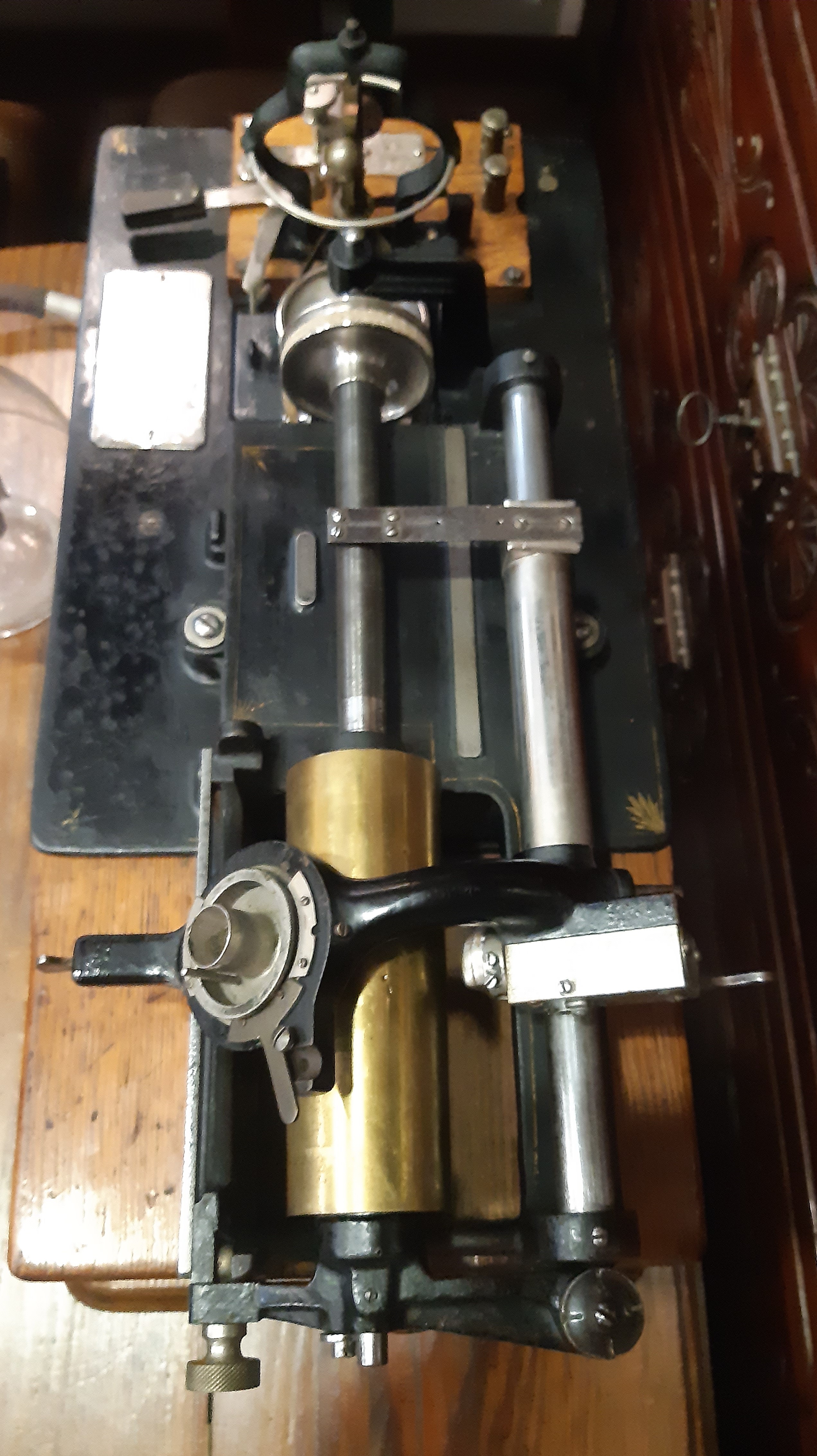

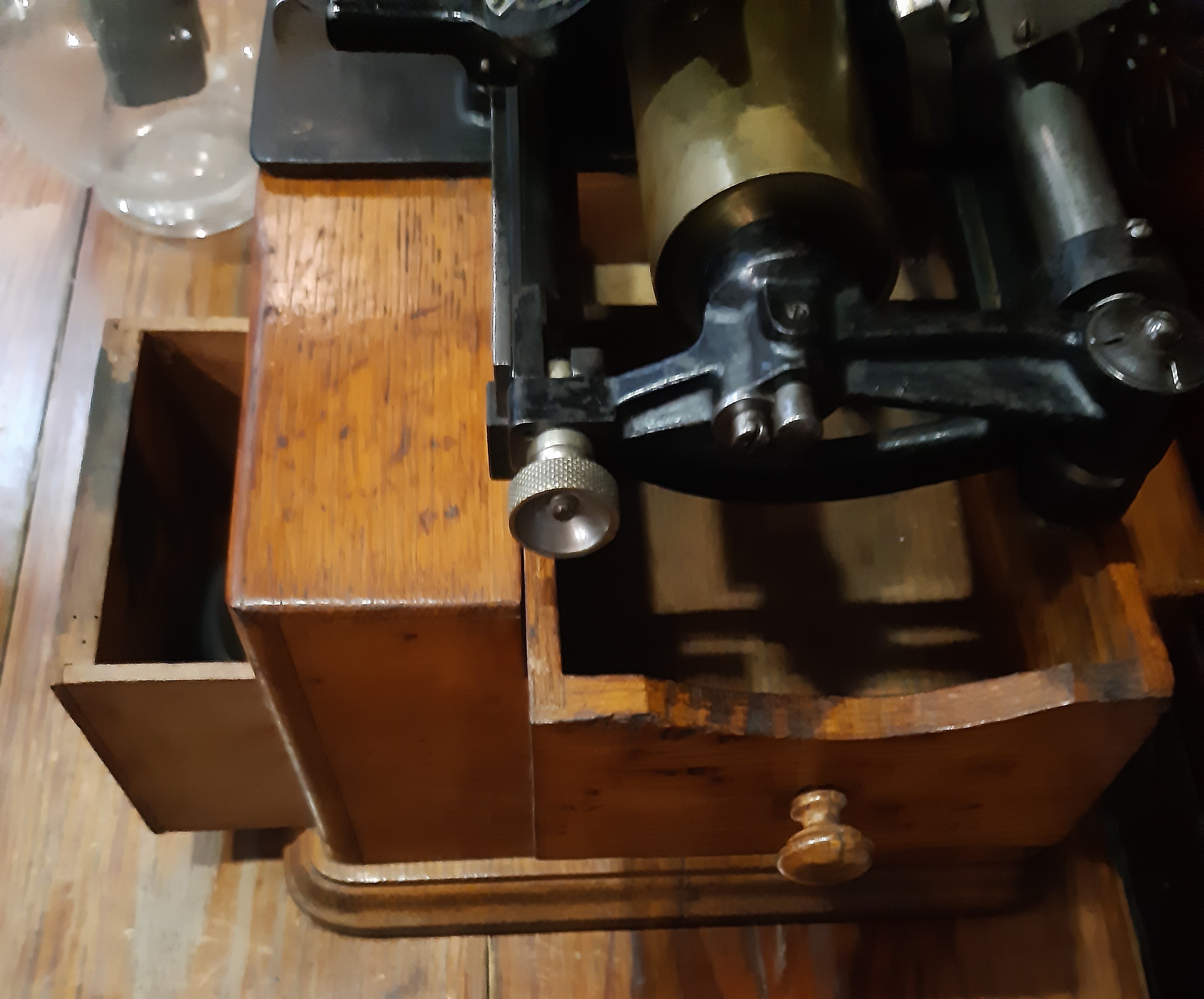

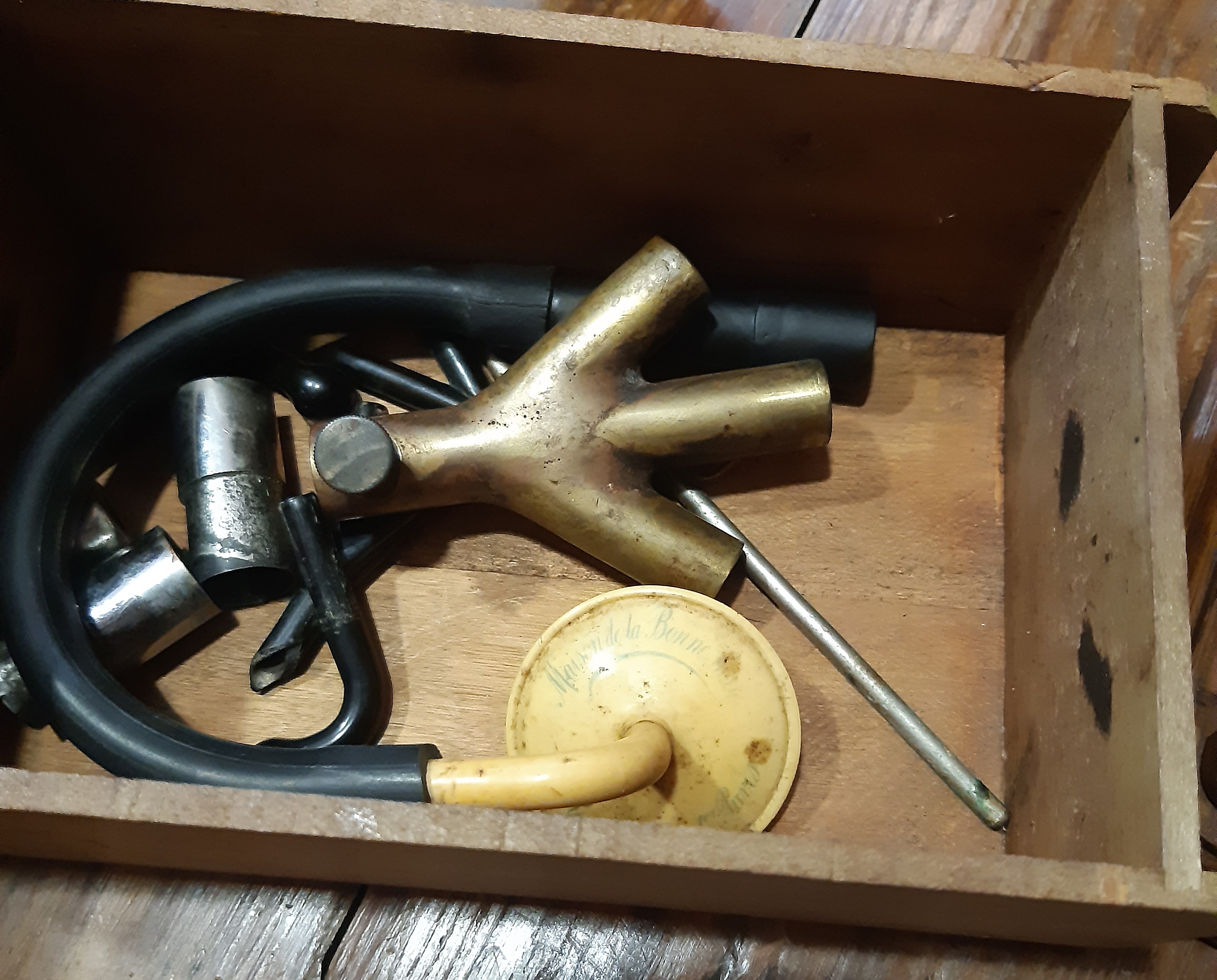

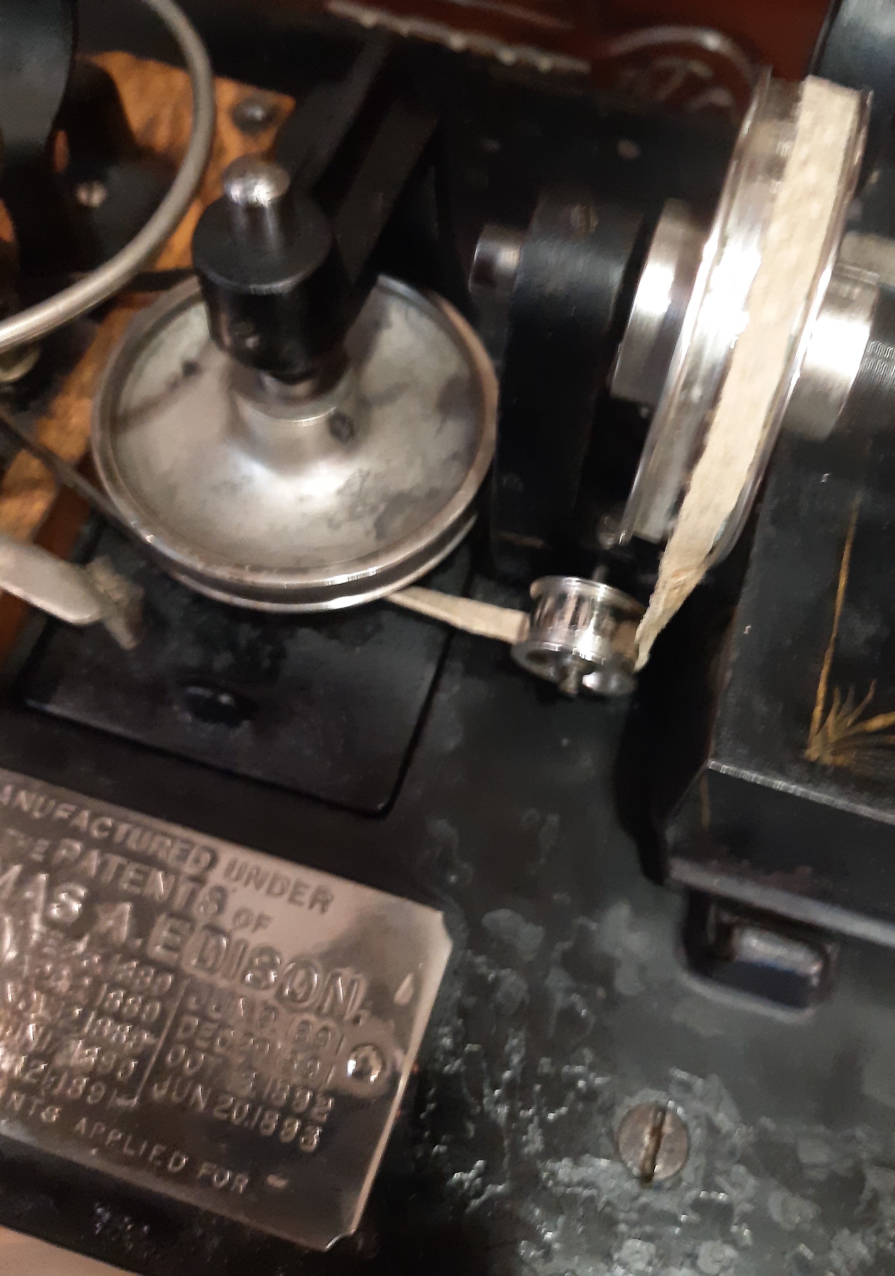

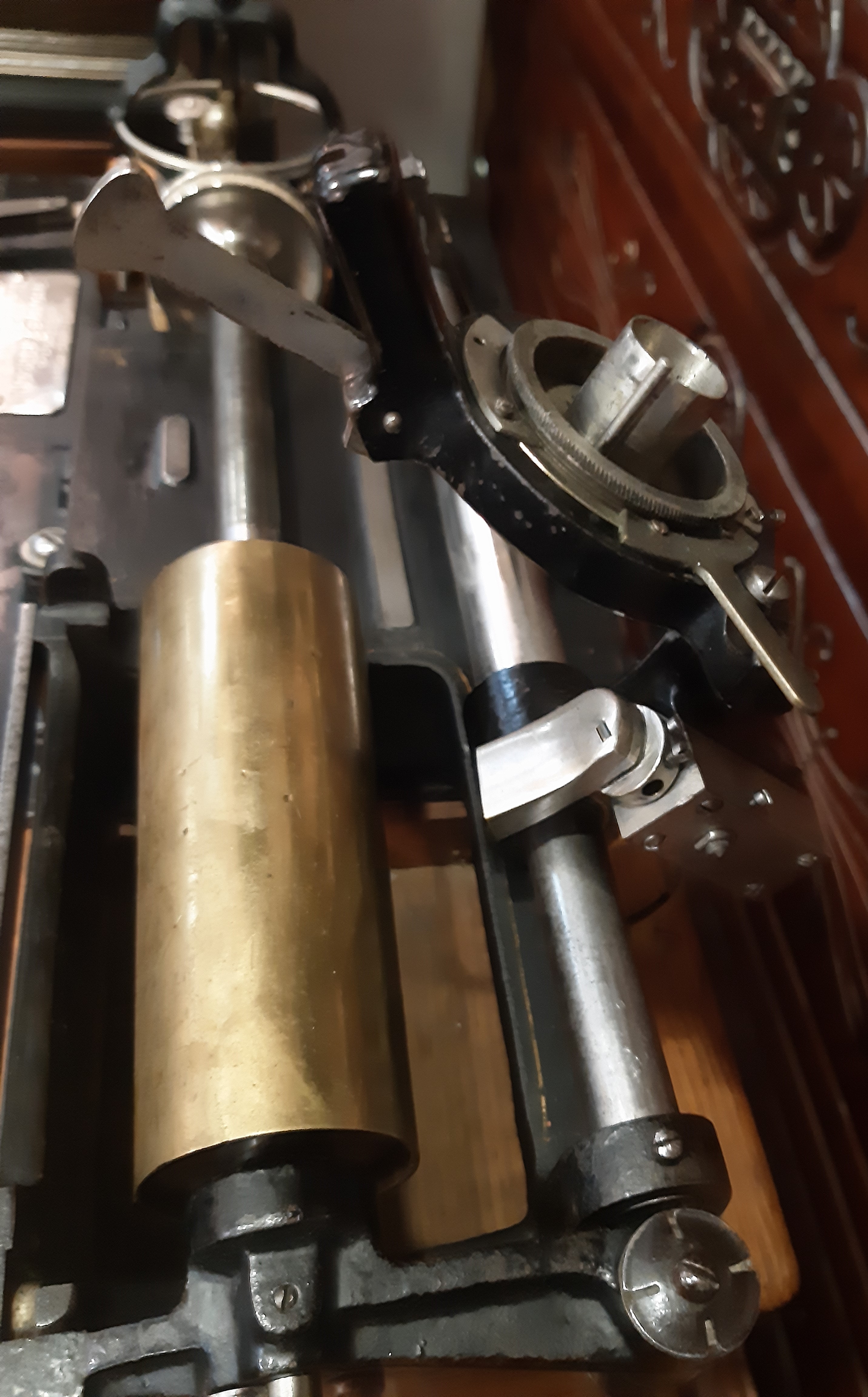

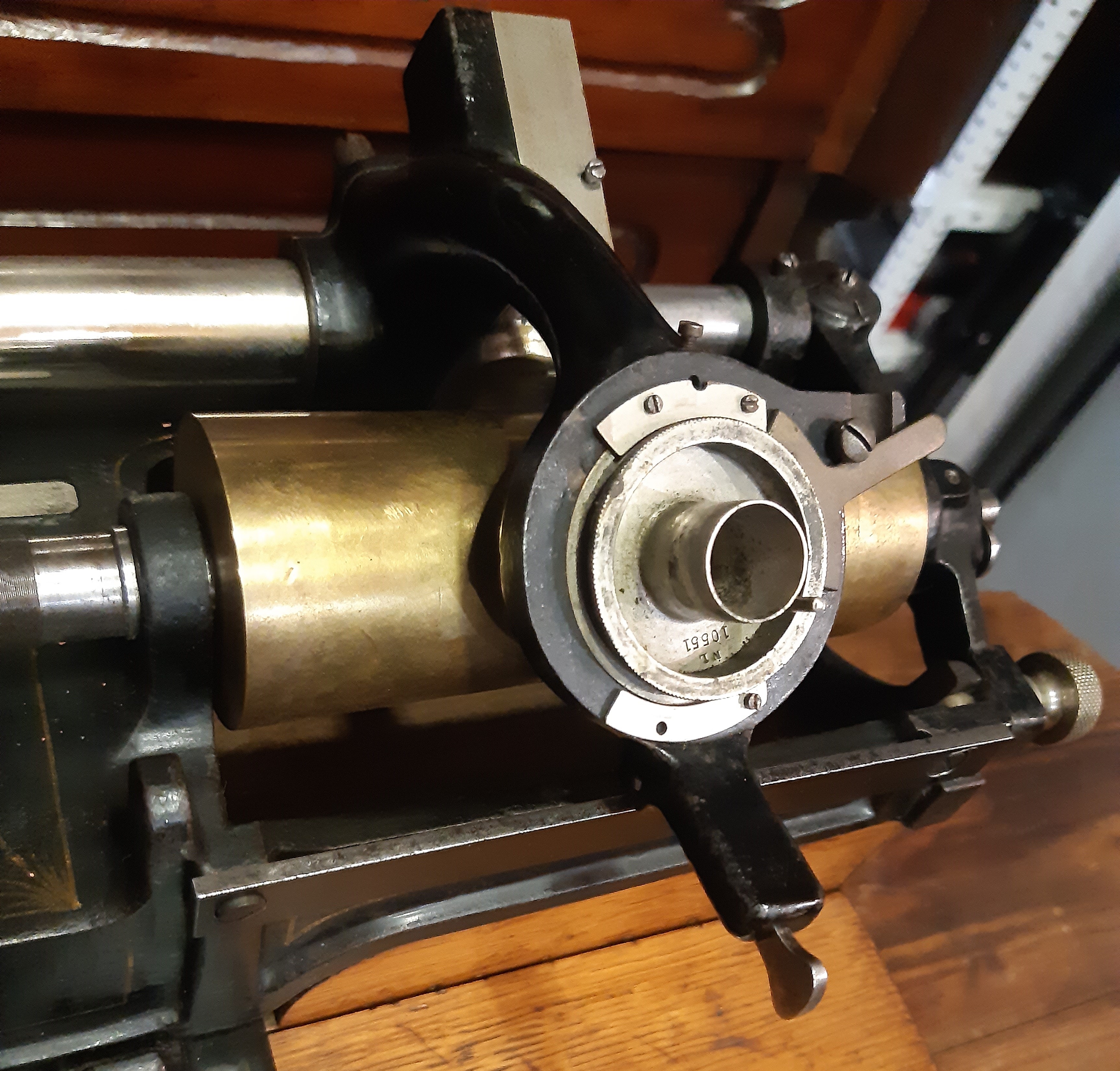

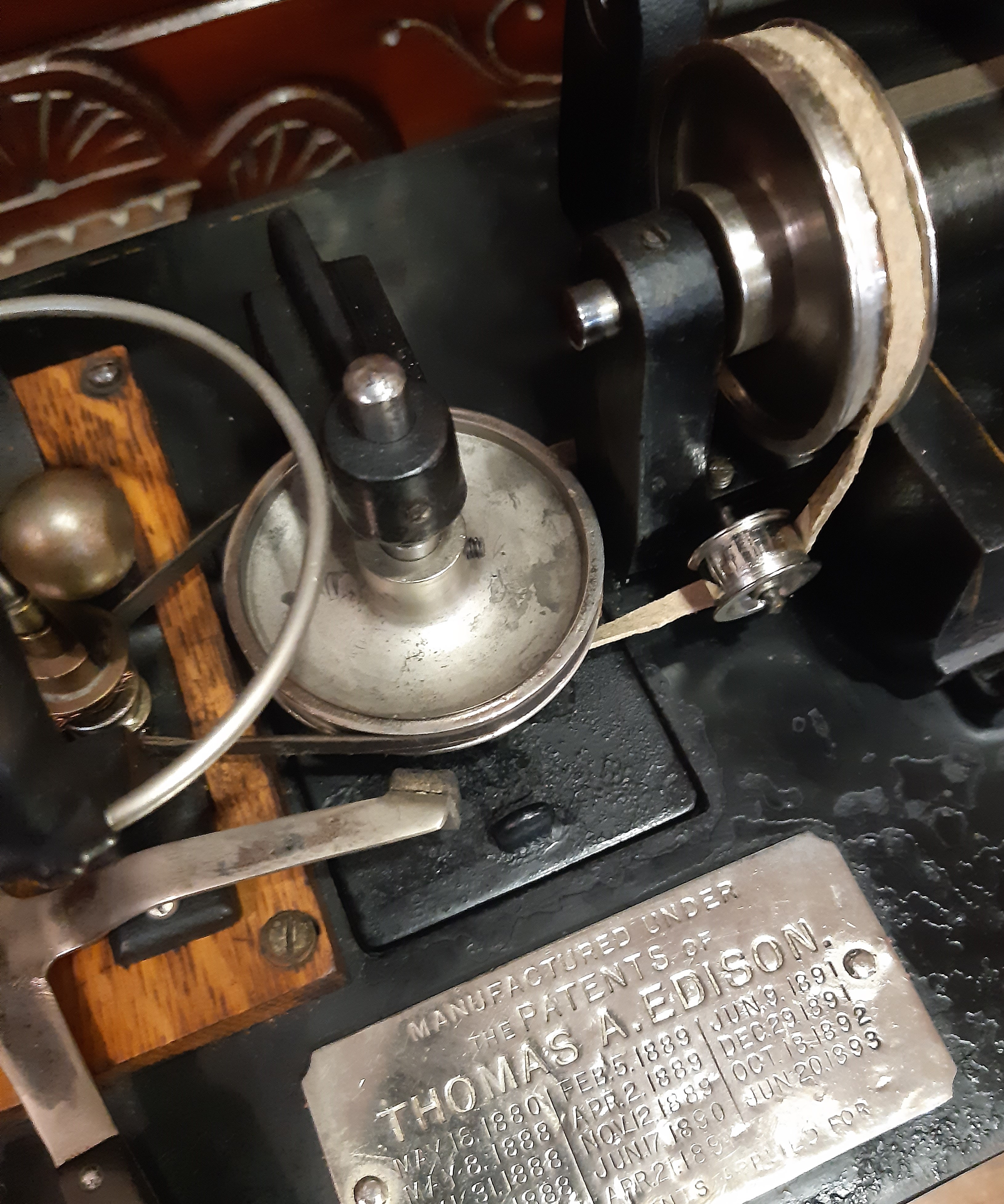

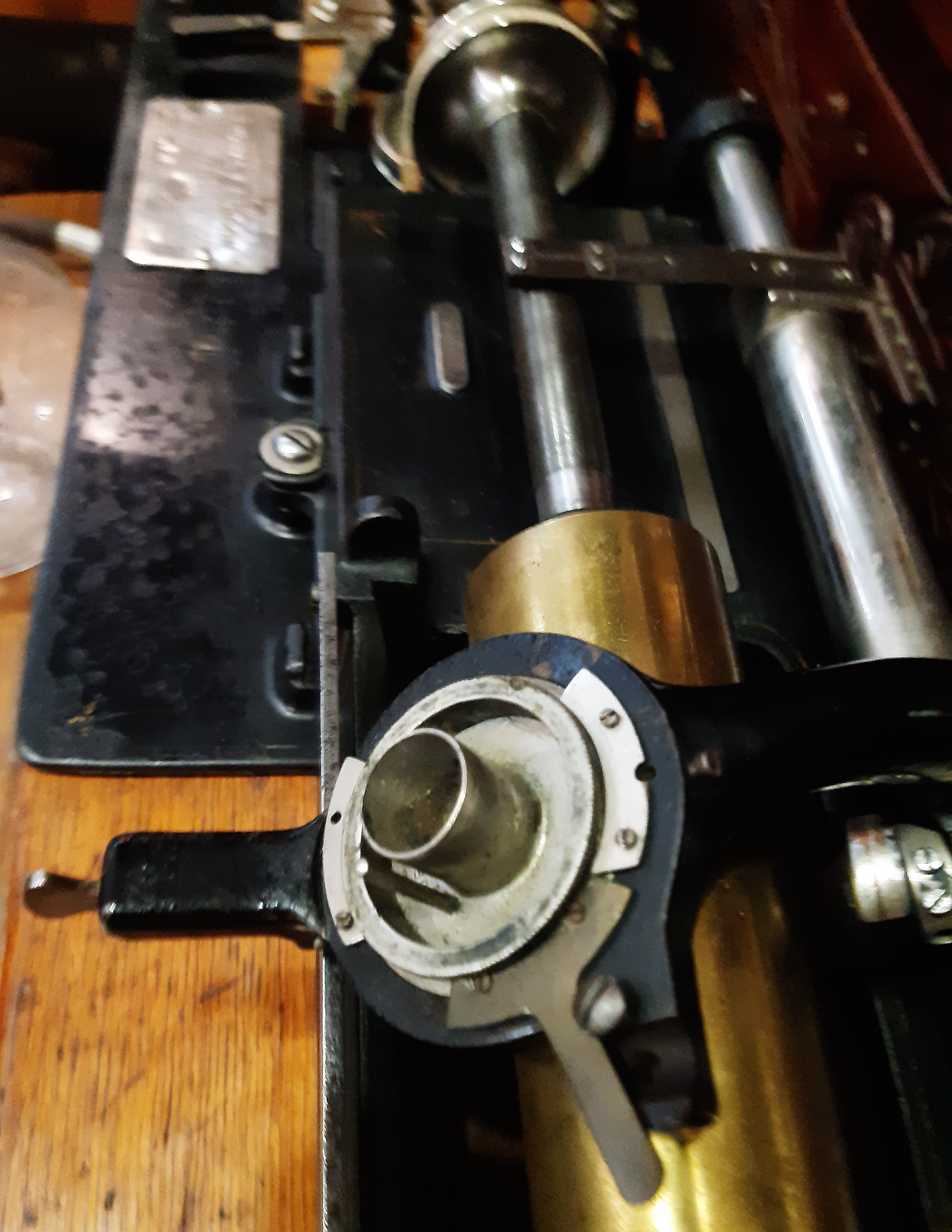

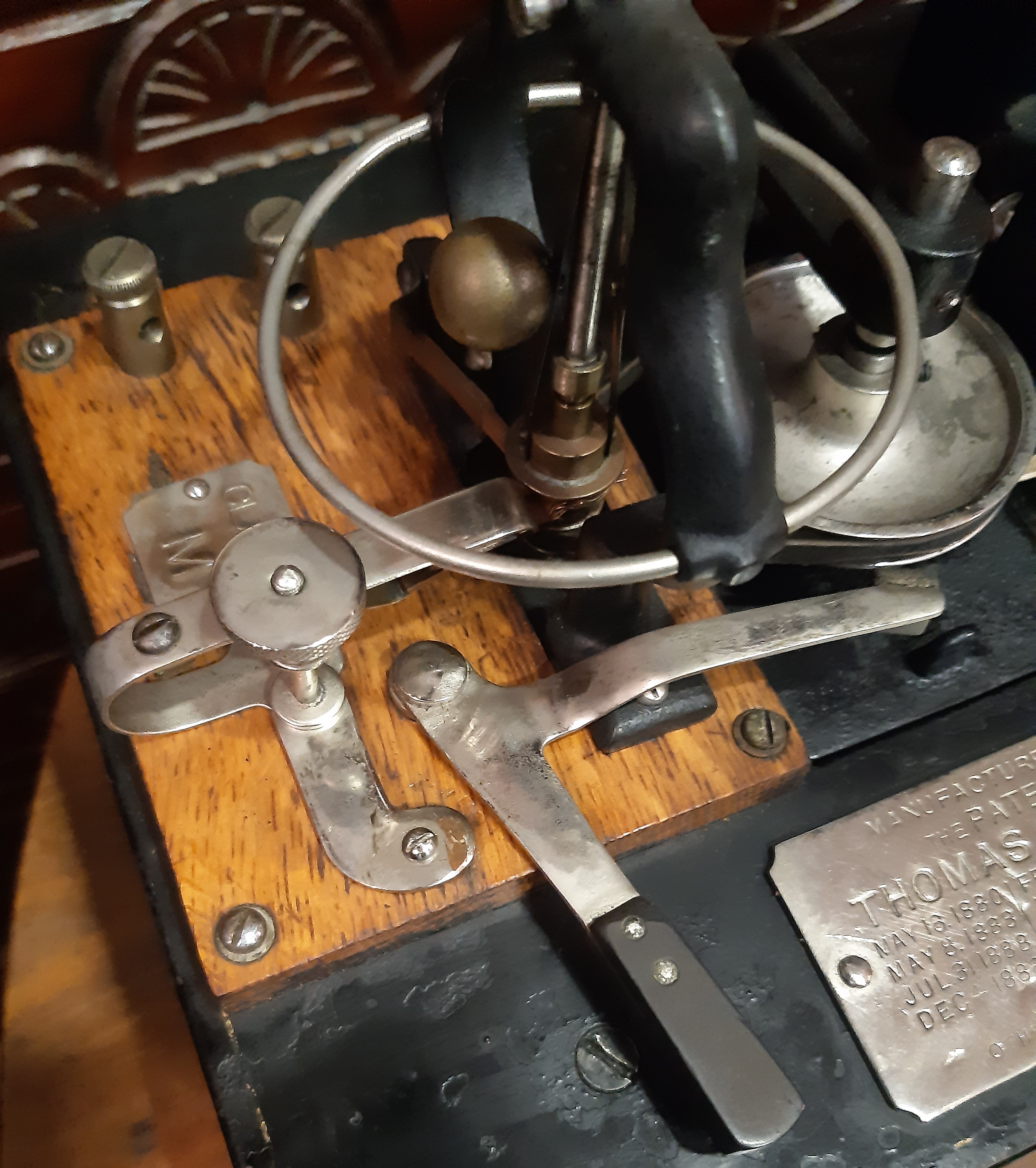

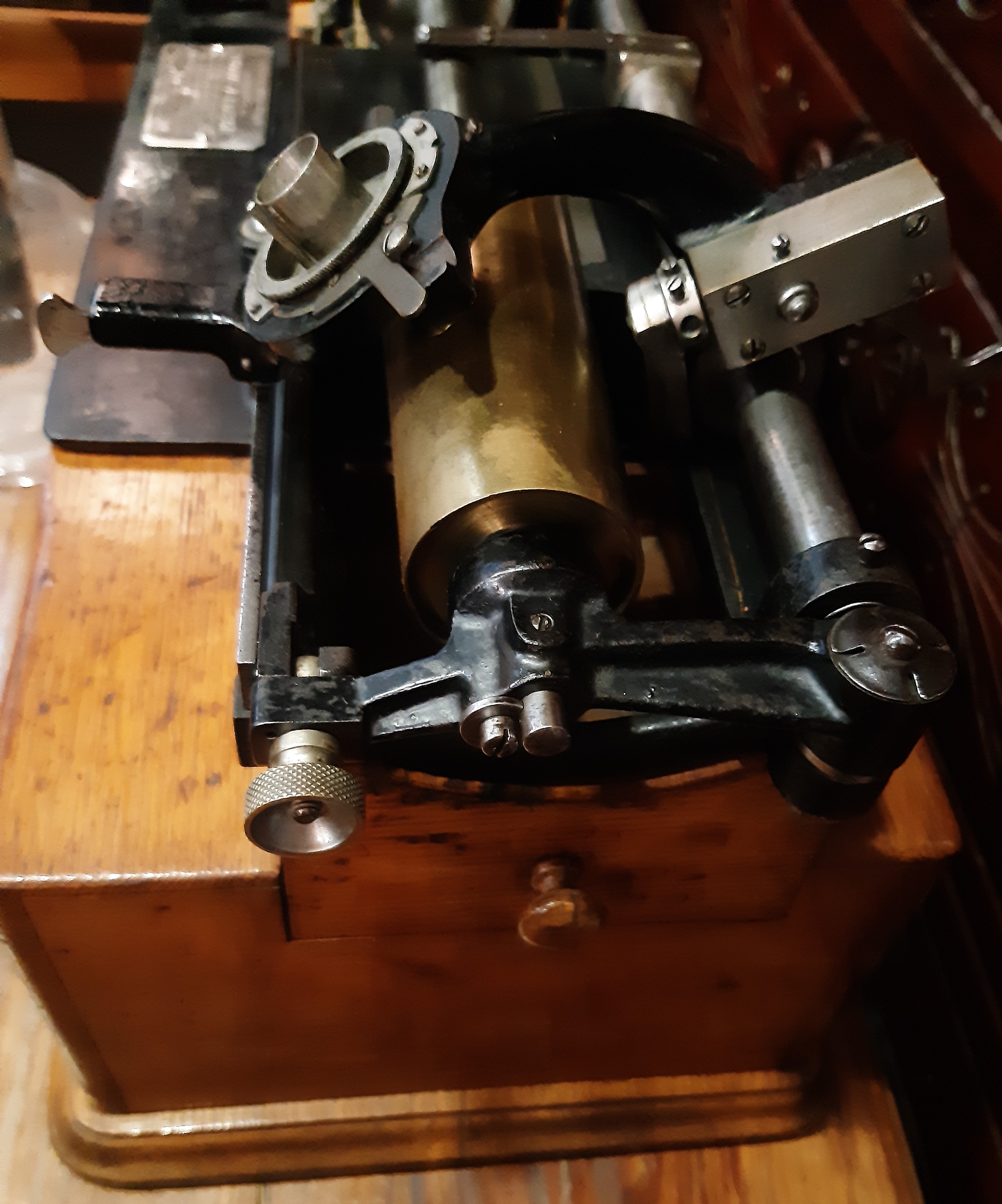

I attach more photographs, so I can investigate more about the matter.
Thank you.
Ferran

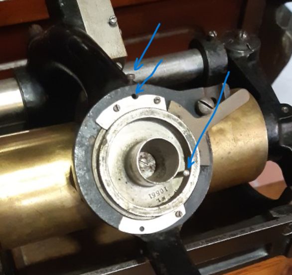

Posts: 6828
Re: EDISON CLASS M
More question marks????
Screenshot 2024-06-01 083808.png (448.47 KiB) Viewed 796 times
phonospud
Posts: 260
Re: EDISON CLASS M
Post by phonospud »
Just as another tidbit of somewhat useless information. It’s my understanding that you cannot accurately date any class M mechanism from it’s serial number as the entire run of chassis castings we’re manufactured at one time in one large run, so low numbers turn up in late cases and vise versa. Early B series model T ford engines are like this too.
Posts: 8281
Re: EDISON CLASS M
JerryVan wrote: Sat Jun 01, 2024 8:40 am More question marks????
Jerry, the two empty holes at the top of the carriage were meant for a positioning wire (front) and its set screw (rear). This wire and the post seen on the Standard Speaker's tube plate were used to ensure the proper positioning of the cutting jewel with a speaking tube, and the reproducing stylus with a listening tube. Notches in the ferrules of the speaking and listening tubes prevented accidentally mixing the devices. These vestigial features are sometimes found on later machines due to the recycling of Edison Class M upper works.

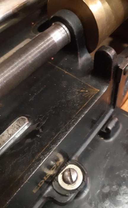

The end gate fastener is typical of the design used on Edison machines at the behest of Edison-Bell for a few years into the early 20th century. I suspect the "EDISON" decals and the added "K" serial prefix were applied by the company that imported this machine for European consumption.

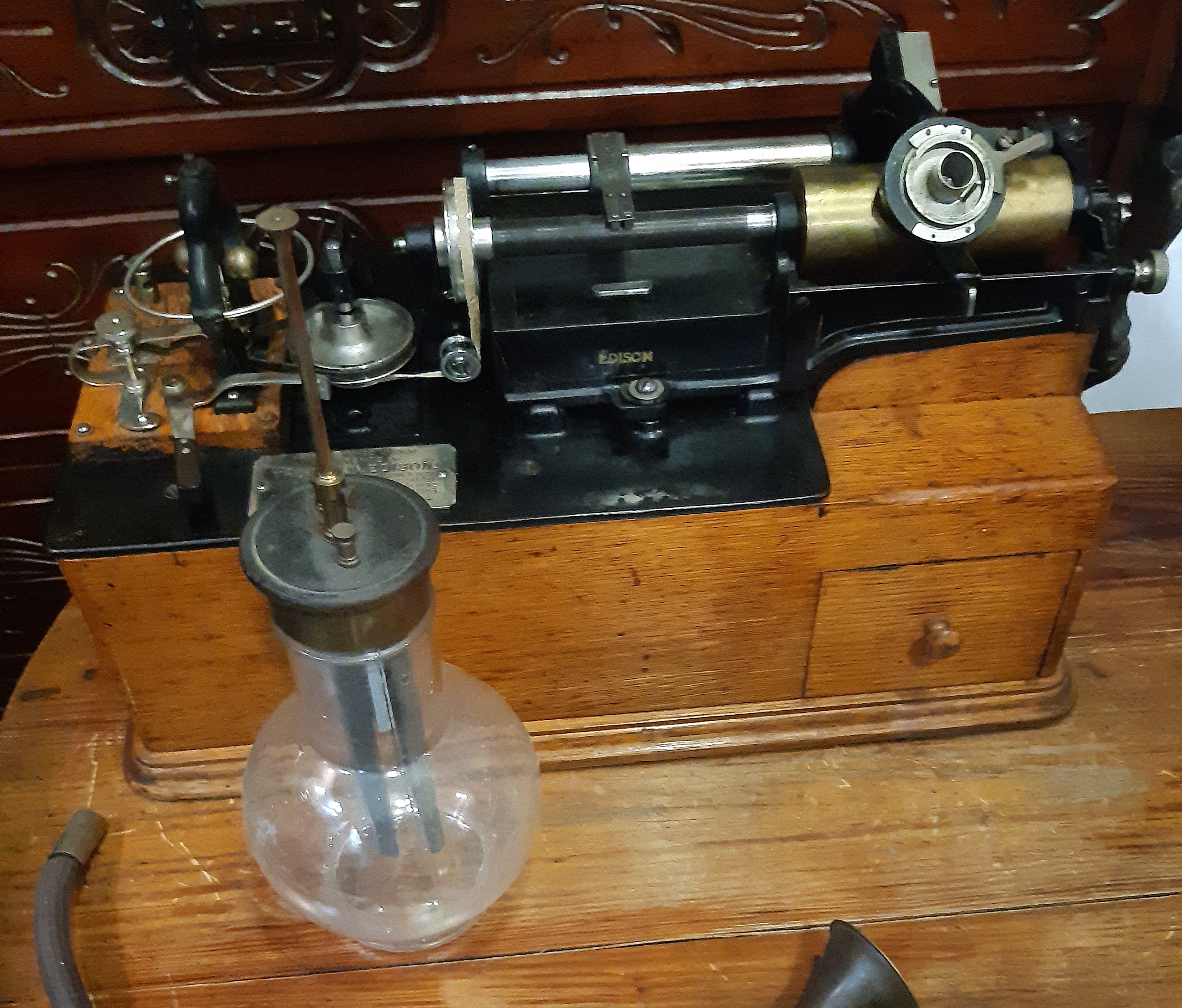

edisonclassm
Posts: 544
Re: EDISON CLASS M
Post by edisonclassm »
