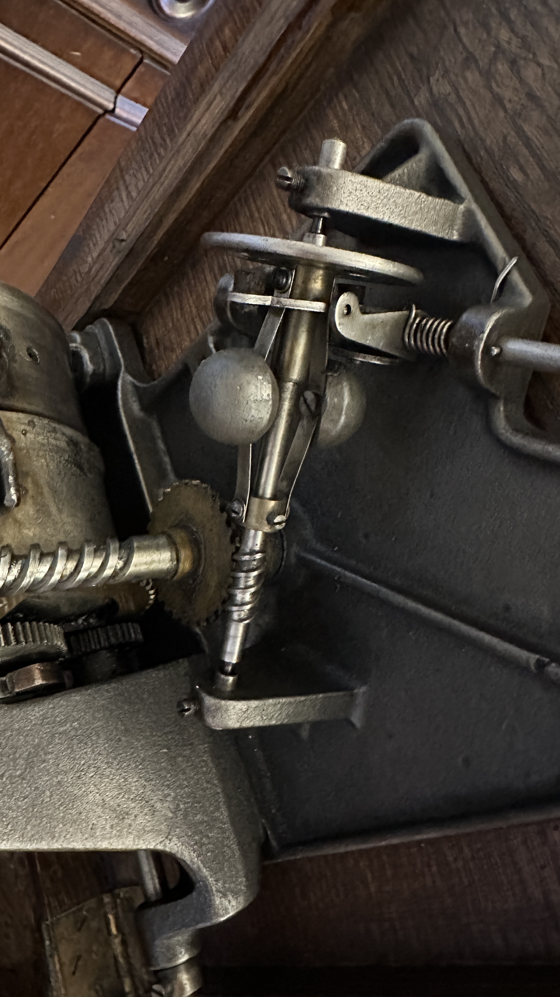

Sorry to say, your governor is not right either. The friction disc appears to maybe be from a Columbia. Do I see 2 weights, or the proper 3? Any more pictures of it??

Jerry is right that the governor friction part is wrong. From the photos, the rest of the governor looks right. I believe this is the right part.https://thephonographshop.com/products/ ... s=e&_v=1.0. The Phonograph Shop also has the governor weights and springs if you need them.
Don't feel too bad. It looks a nice machine and we've all bought a machine online, got it home, opened it up and got that sinking feeling. Restoring it back to original parts is half the fun and it's very satisfying once you get there. And in about three years you will forget how much it cost you and it will become a great story to swap with other collectors.

Thanks Jerry and Michael, THAT is why belonging to a group like this is imperative for anyone fixing up an old machine new to them, it takes a village to raise a phonograph. I do look forward to fixing this up bit by bit, it sort of prolongs the satisfaction and will make the first play even sweeter.kiwiatlarge wrote: Sat Jul 20, 2024 9:35 pm

Am I right that the motors in an L-door Vic are the same as a Vic III? If that’s the case I may swap mine around and then worry about the L-door later. At the very least I can use one as a reference for another.
Someone mentioned maybe the tonearm dowel being down inside the back bracket. Alas, that is not the case. Any hope of finding this part? I also think the shaft in the tonearm is missing a pin. I’ll post pictures.

The part you need is this one: https://thephonographshop.com/products/ ... er-bearing. You may also need this one if it's not in taper arm. https://thephonographshop.com/products/ ... s=e&_v=1.0. The missing screw may be this one: https://thephonographshop.com/products/ ... aa60&_ss=r Finally you need a spring inside the bracket to put pressure in bearing and hold it in place. They are sold out at the Phonograph Shop (https://thephonographshop.com/products/ ... 642c&_ss=r) yet any compression spring of the same size from amazon will work.Dischoard wrote: Sun Jul 21, 2024 10:22 amThanks Jerry and Michael, THAT is why belonging to a group like this is imperative for anyone fixing up an old machine new to them, it takes a village to raise a phonograph. I do look forward to fixing this up bit by bit, it sort of prolongs the satisfaction and will make the first play even sweeter.kiwiatlarge wrote: Sat Jul 20, 2024 9:35 pm

The VTLA motor is not the same it’s a 3 spring and the III had a two spring motor. Many parts are likely interchangeable but not the whole motor. Yours looks very fixable and depending on your location there are some really good folk out there who will work on it for you if it gets too challenging to do yourself.

Um, you’re absolutely right, that is not a Vic governor. Crazy that someone got it to fit. Is the Vic III governor specific or could I use one from, say, a VV-X donor which I happen to have
