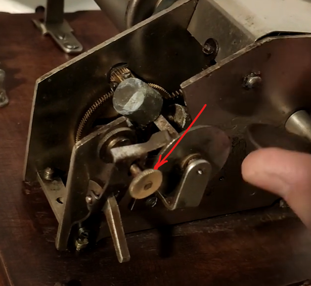

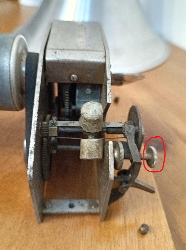

Posts: 6828
Re: Indestructables on a Pathé No. 0?
Patheno0 wrote: Thu Oct 24, 2024 11:41 am where the cylinder is put on (I believe the mandrel) wobbles, and the one cylinder i have is not just running a bit slow, it is literally unplayable (hard to know if it's even a song)
Also there is no speed adjuster on the Pathé no. 0.
This is your speed adjuster....
Patheno0
Posts: 20
Joined: Tue Oct 22, 2024 1:45 am
Post by Patheno0 »
thanks, never noticed it, also the guy who sold me the machine never told me and he was an expert on phonographs, guy had a museum.
