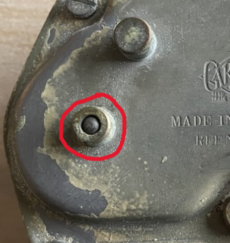

This is the other end of the stuck shaft, correct? Apply some penetrating oil here. You can drive out the shaft with a small brass punch and some light taps with a hammer. Shouldn't take much persuasion to get it out so don't go nuts on it. :) (The shaft end being the smaller diameter part inside the larger bearing.)

Thank you - it’s currently soaking overnight the other way up - I’ll try this tomorrow :)

I soaked it for about 3 days and it was still stuck fast so I tried hitting it. That didn’t do anything either except slightly denting the end of the shaft. In the end I used a blow lamp to heat the case and then hit it to get the shaft out. I gave it a clean up with wire wool, greased and put it back together. At first it played slowly but after a couple of minutes it was up to full speed and seems fine now. Thanks for your advice :)
