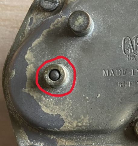

Re: Seized spring box
Posted: Fri Dec 27, 2024 4:47 pm
by JerryVan
This is the other end of the stuck shaft, correct? Apply some penetrating oil here. You can drive out the shaft with a small brass punch and some light taps with a hammer. Shouldn't take much persuasion to get it out so don't go nuts on it. :) (The shaft end being the smaller diameter part inside the larger bearing.)
Screenshot 2024-12-27 164330.png (335.6 KiB) Viewed 600 times
Posted: Fri Dec 27, 2024 4:59 pm
by Thomps
Thank you - it’s currently soaking overnight the other way up - I’ll try this tomorrow :)
Posted: Thu Jan 09, 2025 4:27 pm
by Thomps
