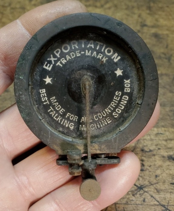

But so are some of the European copies, particularly the German "Exposition".Victor guy1 wrote: Thu Jan 30, 2025 8:00 am I have trouble believing that neither company made this,
It is the exact same as a regular exhibition with a little bit of a difference?
Would like more info on my exhibition concert reproducer
- Steve
- Posts: 3928
Re: Would like more info on my exhibition concert reproducer
- Posts: 6831
That's pretty much the very definition of a clone, (a.k.a. knock-off).Victor guy1 wrote: Thu Jan 30, 2025 8:00 am I have trouble believing that neither company made this,
If it were made by Victor/HMV they would not be shy about placing their name on it.

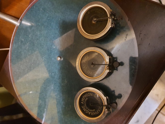

Yes, Steve, I have some of these imitations, and show two of them in the photo below, together with a genuine HMV Exhibition in the middle. I have also a Saturn, but could not find it for the family photo. The Amphion has some ambiguity: it shows Paris on the face, but also an Importé d'Angleterre - it is identical to the original. The one on the right has Exhibition as brand, barely visible, but showing made in Germany ; it looks identical to the Exhibition, apart from a mirror of the original, with the front spring in the other side of the needle stem. It may be genuine, but if so it is the first Exhibition made in Germany I have seen. The Saturn, from what I remember, has a different rubber back attachment with three instead of two bolts besides having a shiny brass front with the name Saturn, a comet and stars etched on the surface.Steve wrote: Thu Jan 30, 2025 11:23 am But so are some of the European copies, particularly the German "Exposition".

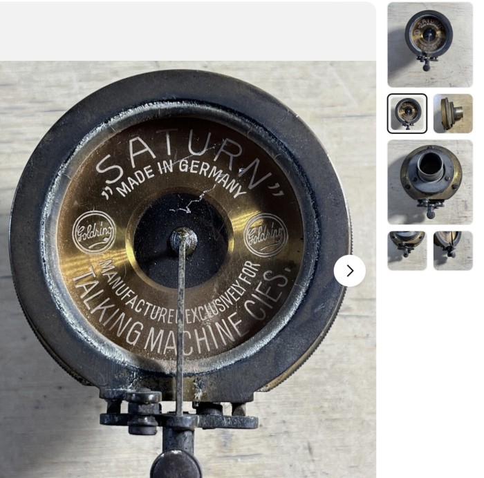

Carlos thank you for sharing your pictures of the clones. I have not seen the Amphion before. 2 more from eBay:

CarlosV
- Posts: 2186
- Location: Luxembourg
