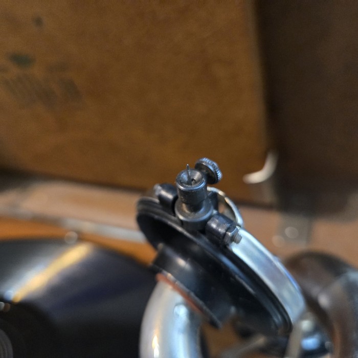

Thank you for that detail Lah Ca! I've decided to oil the base only, which made quite a bit of difference. I bought 100 Soft Tone needles and wound this baby up. Although it is skipping and I am not sure where I am going wrong. The elbow of the tone arm is slightly loose.
I've captured a video of the playback showing skips, and the looseness of the tone arm elbow. Also grabbed a picture of the needle. Does anything look obviously wrong? If you listen carefully, you can hear my wife yelling at me in the background.

Does it skip with all records?
Does it skip only at the beginning of a record? What happens if you start play from the middle of a record?
It is hard to tell from the picture, but the needle you are using looks rather blunt. Is it a new needle? If you are experimenting with old needles while you wait for new ones to arrive, the needle may be part of the problem.
Is the machine set so that the platter and motor board are relatively level?
Or it may be as JerryVan says, and you need to keep working on freeing up the arm.

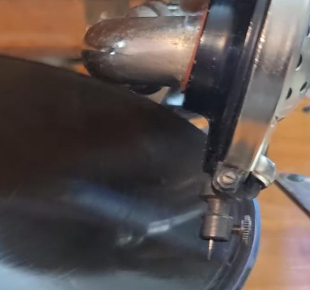

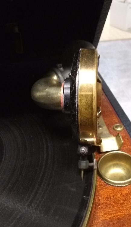

It also seems that with your reproducer things are not quite in alignment. It is hard to tell though from your video clip. Many web/phone cams have a slight fisheye effect to increase field of view.
Yours (screenshot from your video):
Mine:
Make sure the reproducer is set on the end of the arm properly with the arm fully inserted. Set the needle angle. Put the needle down on a record without starting the motor. Take a picture similar to mine and post it here.

I looked at things in your Google account. It also looks like there is way too much slop/play in the elbow joint of the arm (quite the opposite problem to mine).
https://photos.google.com/share/AF1QipN ... N1ajF2TFBB
Can you slowly and carefully tighten the set screw to see if this tightens things up a bit. [Edit: On closer inspection, the set screw looks as if it is fully tightened and the lock washer under it is squashed flat.]

That wiggle would make sense. I pulled the elbow off and put it back on, it's a little better, but not as tight as I would like. Does not seem to be a way to adjust on the table itself. Wondering if I'll need to add something in there (small strip of paper) to fill the gap if needed.
It is a new needle and I only sampled a few spots, but will have to check further along the record. I readjusted it's placement which seems only impacted by that small thumbscrew which holds it in place.
