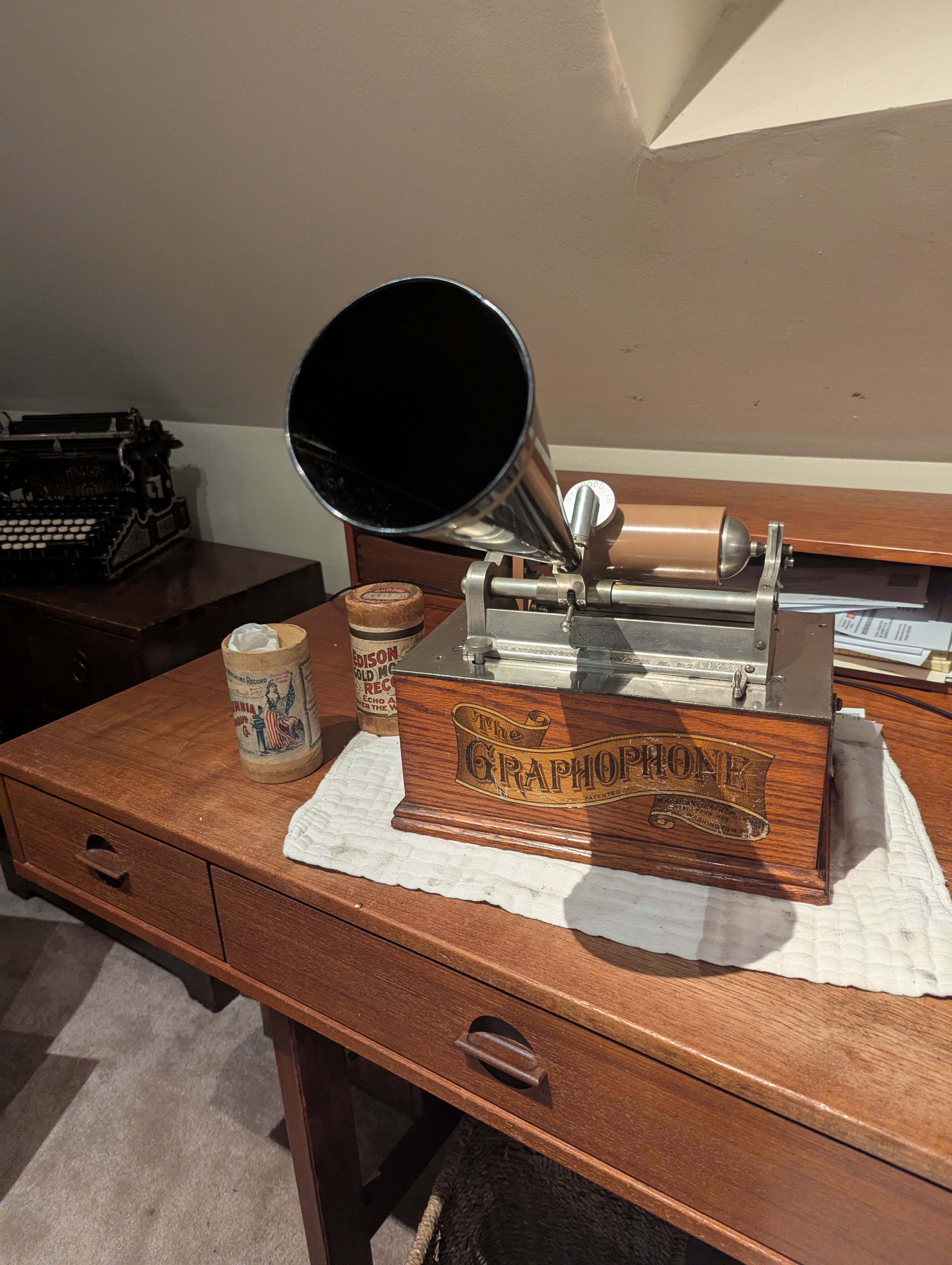

The new brown leather belt was the charm. The Type N runs like a champ--almost three full cylinders on a single wind. I'm sure disassembling and cleaning the motor helped, but the stitched leather belt was simply too thick and stiff for the machine. Now I need to hold out for an original slotted crank, a gutta percha reproducer, and a funnel horn.
I've been using a large floating reproducer because the small number 2 reproducer I have needs to be completely overhauled. Can anyone tell me if the bezel unscrews in a counter-clockwise direction? It doesn't want to budge in either direction, and--as always--i don't want to force it until I'm better informed.

Yes, the bezel on the small Columbia Reproducers unscrews in a counter-clockwise direction. A drop or two of penetrating oil overnight will facilitate the operation. Also, the use of a watch case opener like this one will eliminate the possibility of scoring the bezel:
https://www.ebay.com/itm/221113768026?_ ... BMtpK048Bl
There are a number of different designs for these tools. Just be sure you get either pointed or rounded tips rather than blades:
https://www.ebay.com/itm/143353512241?_ ... GWG6T54NH4

Pardon me, but is that a Smith-Premier double keyboard typewriter I see in the background?
You fortunate son of a gun.

VanEpsFan1914 wrote: Sat Apr 05, 2025 10:09 am Pardon me, but is that a Smith-Premier double keyboard typewriter I see in the background?
That is indeed a Smith Premier #1, with the lowest recorded serial number I'm aware of. (I haven't found any lower serial numbers in the various databases.) It's temperamental but functional.
