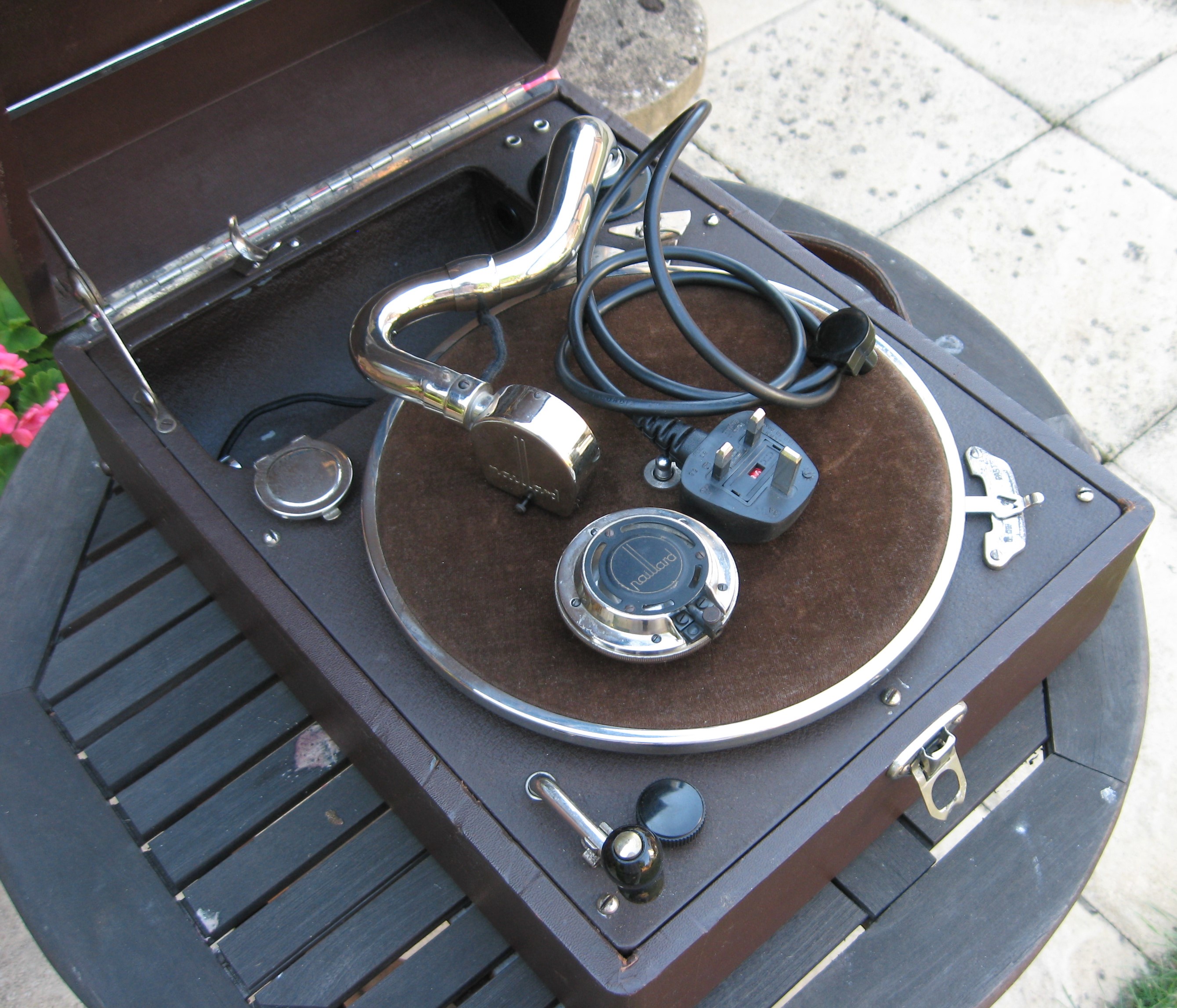

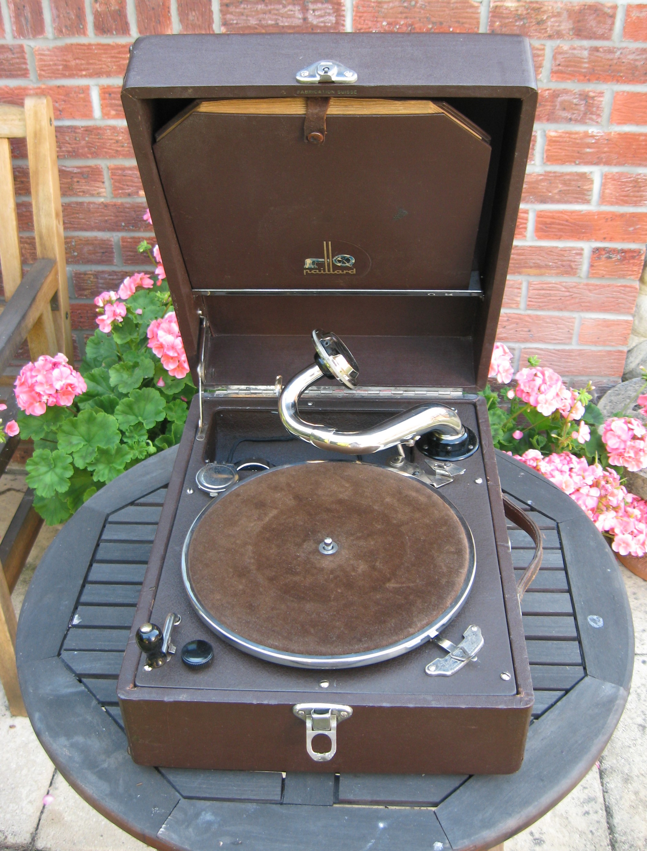

I expect the 106UP has a similar arrangement to my Paillard pictured below. Unfortunately it has developed an electrical fault which tripped the power in my workshop, and as I am no electrician I need to get it checked by a professional.

Hi, sorry for the late reply. Yes, it is about the same concept, but with different motors. The Electrola has one with collector and carbon brushes, the Paillard is without that and so the more elegant construction in my opinion.

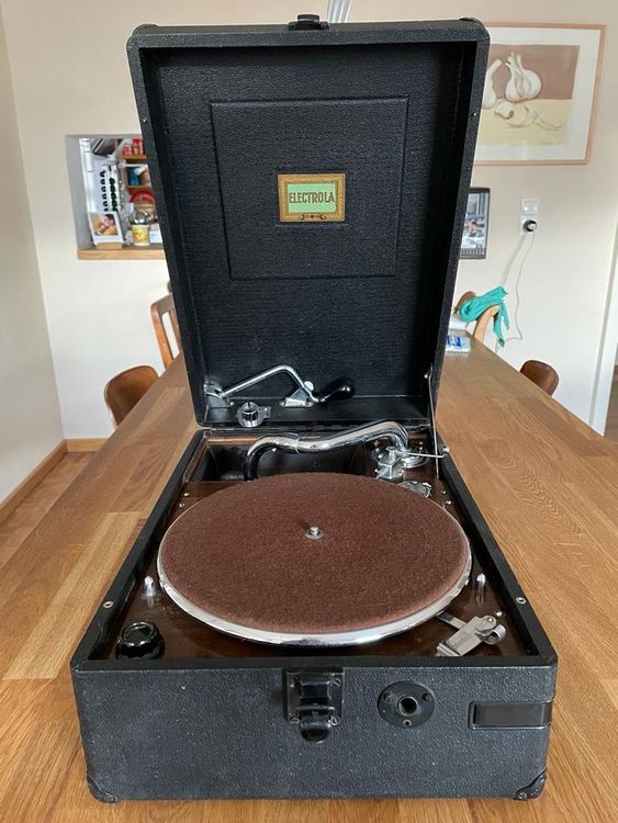

I did not know that Paillard had that built-in volume knob, but it still has a cable from the electric pick up - where is it going? The Electrola has a fixed contact for the electric pick up, and you do not see any cables as they are running in the tone arm (see picture, the brown bakelite ring next to the soundbox attachment). So in this point it is a more elegant solution on the Electrola.

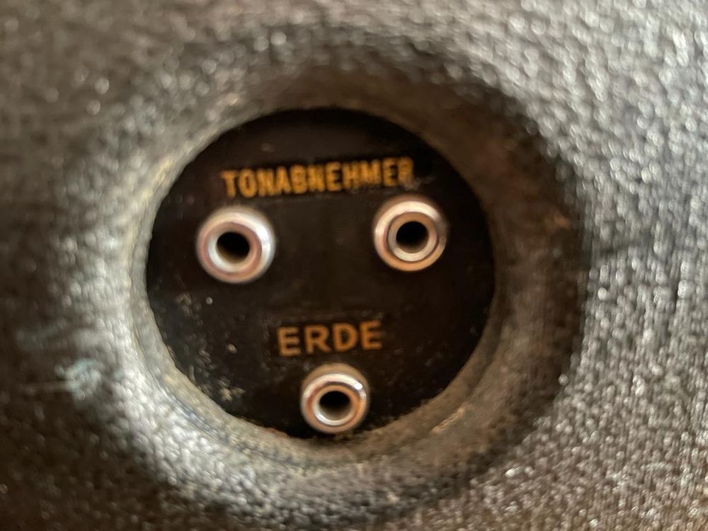

The cable from the electric pick-up connects to these sockets at the rear of the case. Jack plugs on the cable from the radio complete the connection and electrical amplification is achieved :

Yes, on the Electrola 106UP they are leaving the case on the left side. But you do not see any cable from that in the open machine, it is all hidden inside. You see only the volume knob (in front left side) and the holder for the soundbox or pickup, that is not in use (in front of the winding handle clips).
So this special electric pickup would be a nice addition to complete this gramophone... so if anybody should have one and does not need it, I would be happy if he could contact me.
