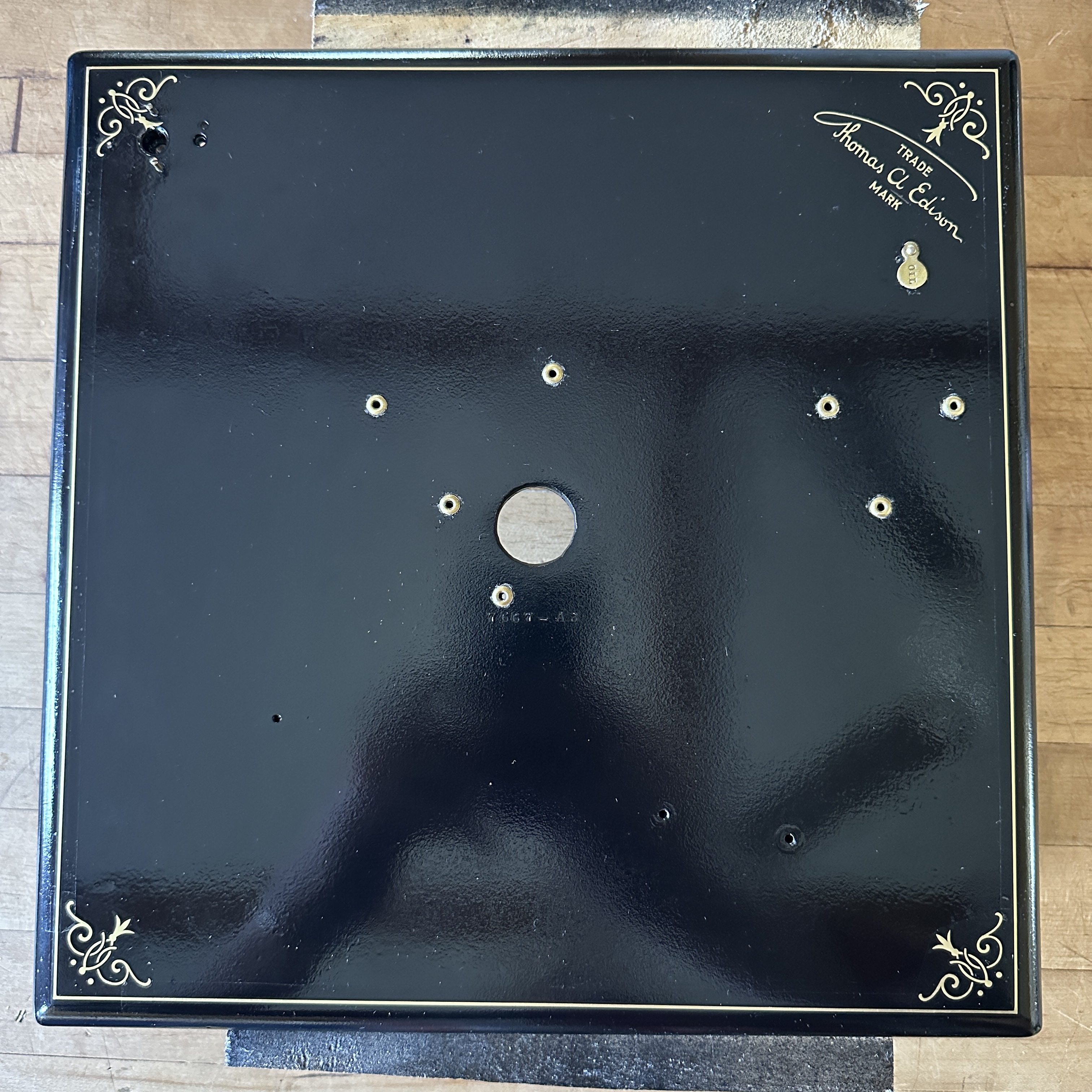

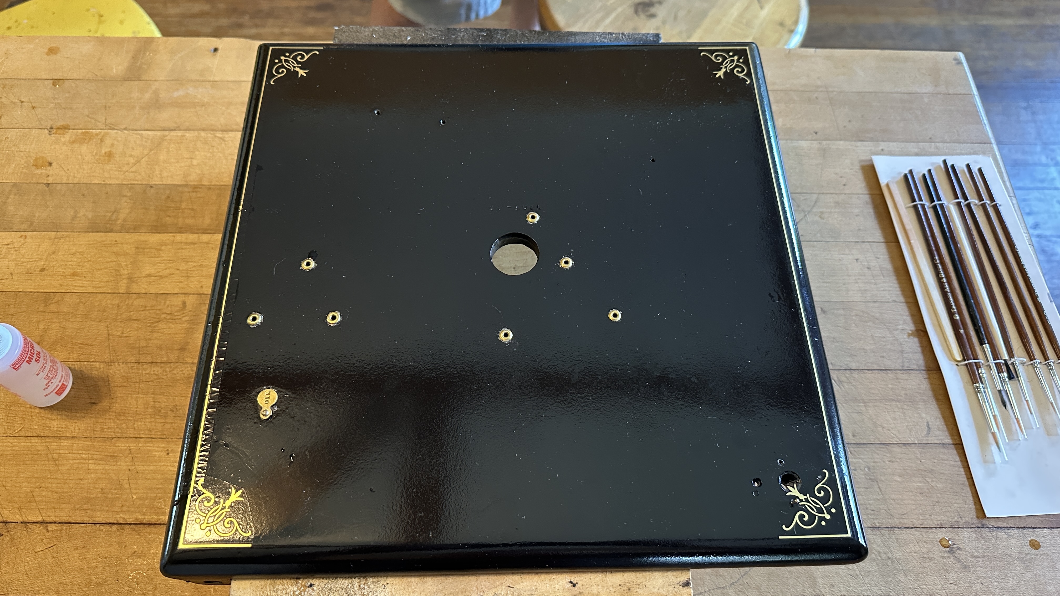

Ah! So glad you found this post! As it turns out I was coming here to update the progress, my friend came over and, at least compared to what it looked like before, I think we did a bang-up job! :lol:
Here is a "during" and "after" pic. Not yet quite finished, I'm going to wait a day and then hit it with more clearcoat which should blend those edges in much better and give the whole thing some protection. Then it will be time to clean and re-attach everything and start putting this back together again!
during...
during...
After!
After!

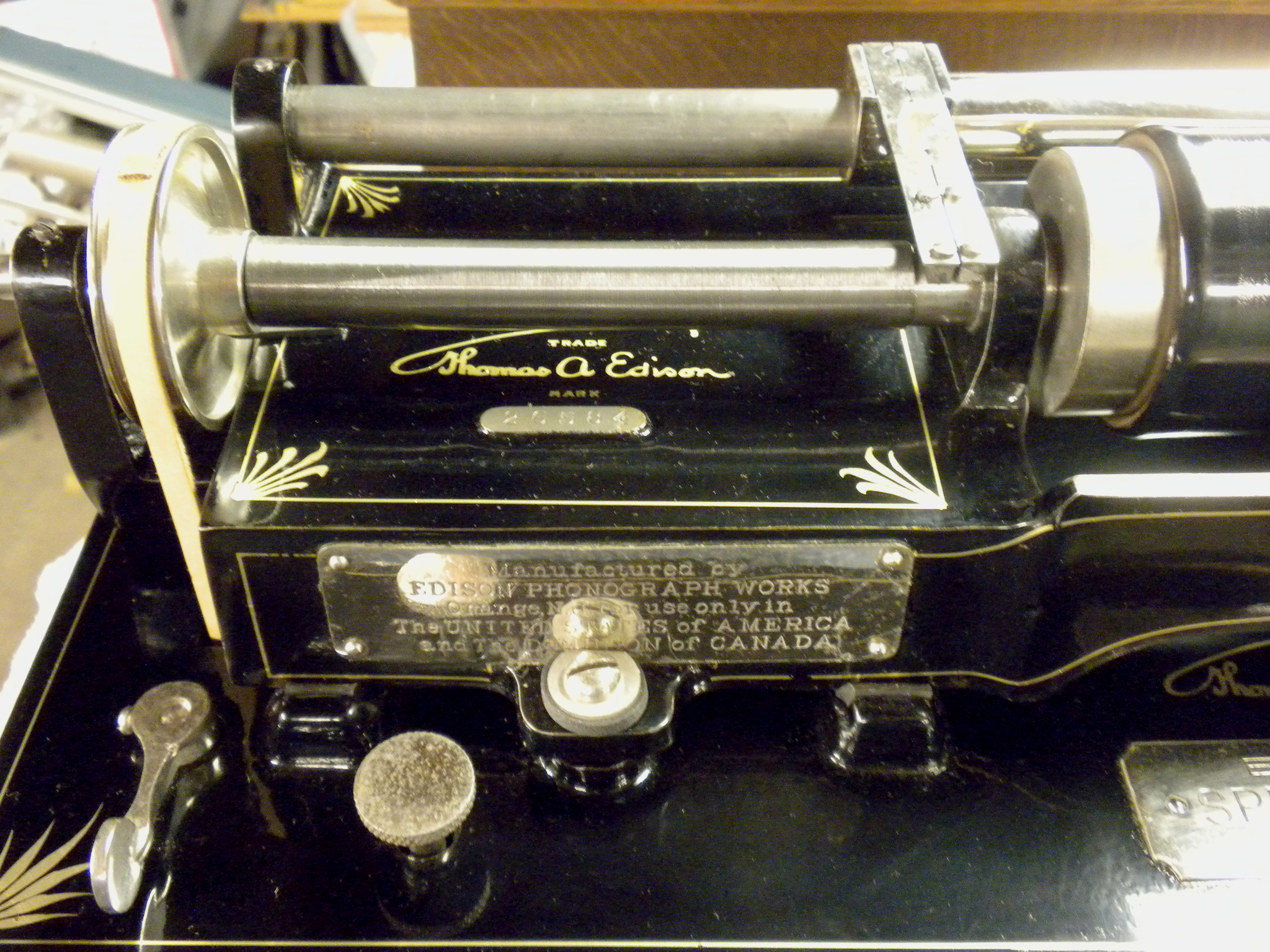

If you continue adding layers of clear coat (I use shellac, clear or orange if you want to tone down the gold, I used both on this one) over the decals and then lightly remove a small amount with 1000 or 2000 grit paper then spray again and repeat you will eventually blend in any edges of the decals and end up with a mirror smooth finish.
This is a Spring Motor I did awhile ago, I think there are about 25 coats of shellac with sanding between until the last spray which I rubbed out with
polishing paste.
Chuck
