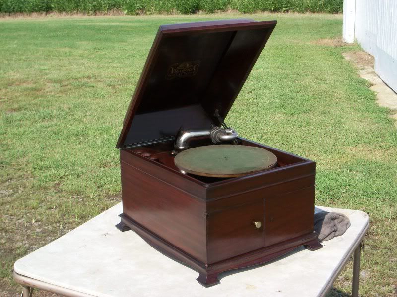

Alrighty, a little before and after so far...still haven't sanded it, ust GoJo-ed + steel wool and Lemon oiled it.
Before:
Image Image Image
And now:
Image Image Image Image Image
Quite presentable finish-wise now, but I still want to see if some delicate sanding will take care of some of the "dullness" of the finish.
Can anyone hook me up with a knob (or two) and a winding key? I'm not paying $45 for a crank on eBay, I'll simply thread the end of a steel rod, bend it, and add a knob until I can find a decent one, at that price. Knobs new are $15, which is a bit much IMO, but I may pop on it if I can't find any decent originals. Two are missing (motorboard and right door) and the left door is too tarnished.
Not bad so far, eh?
Saving America's Acoustical History, One Phonograph At A Time...

Post by SignatureSeriesOwner »
How did I do?
Image Image
#0000 and Gojo cleaned all the junk off, then I used lemon oil and #400 sandpaper to sand away the heavy alligatoring. Most people say to use #600, but #400 was all the local hardware store had. Glad I didn't go the #600 route (might, just to make it a bit shinier) while sanding, it took long enough with the #400!
It looks quite acceptable now. Still have a bit of touching up here and there, but for the most part, it looks really nice. The little dot at the bottom corner is a ladybug. :D
