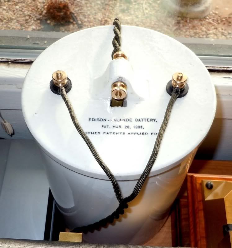

Battery jars turn up on eBay fairly often. A very, very nice one just sold last week for $40 -- a great deal, usually they run closer to $100. Most that I've seen on eBay are empty but that's fine if you're setting up a power converter as you obviously are. It's easy to use modern hardware to simulate the external appearance.
You need one of the non-embossed jars with name and patent date fired into the lid, either 1883 or 1890 patent. The embossed "ESCO" type are much later.
Here's one I made to power my Class M and Edison fans:
I ran the power line into the hole on the back of the hump; obviously this isn't correct for a battery but it's reasonably discreet, and of course you need to power it somehow. I didn't want to attempt drilling into the porcelain jar. With a transformer and bridge rectifier I get 4.5V DC output. Technically, this isn't wired authentically. The knurled nuts at left and right originally held the hanging zinc plate and were electrically linked; the bolt on the hump supported the copper electrode. So as originally configured it should be wired with one output wire attached to either side bolt and the other wire to the center. But for display purposes, this setup looks more attractive.

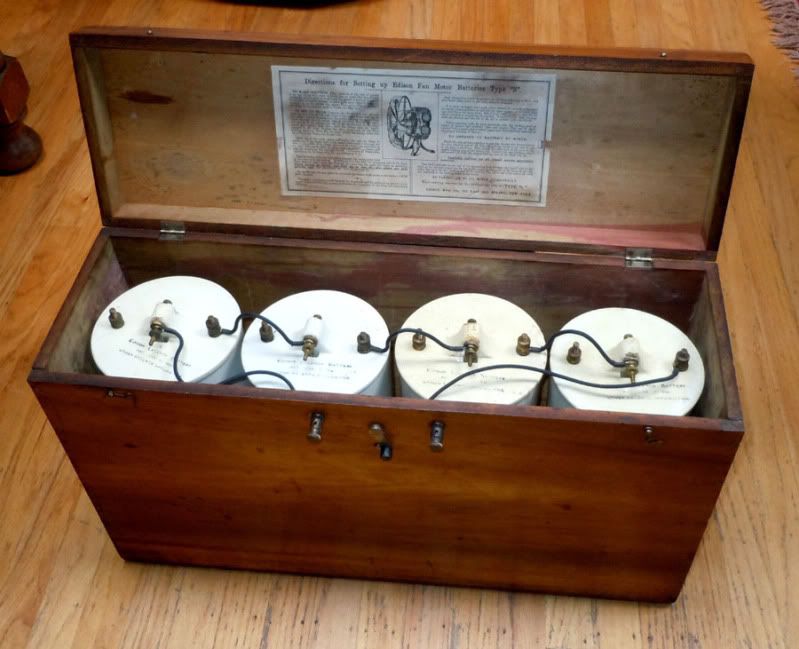

If you really want to do it right you need a wooden box with a set of 4 cells, either Type S or Type V. But they are very rare. Here's a Type S:

- Andersun
- Posts: 905
- Joined: Thu Jan 08, 2009 10:38 am
- Location: Oldsmar, Fl
Re: Class M Restoration
Rene,
Great information and pictures! That is what I plan my end result will look like. Doubt I will ever get the wood box!
Thanks,
