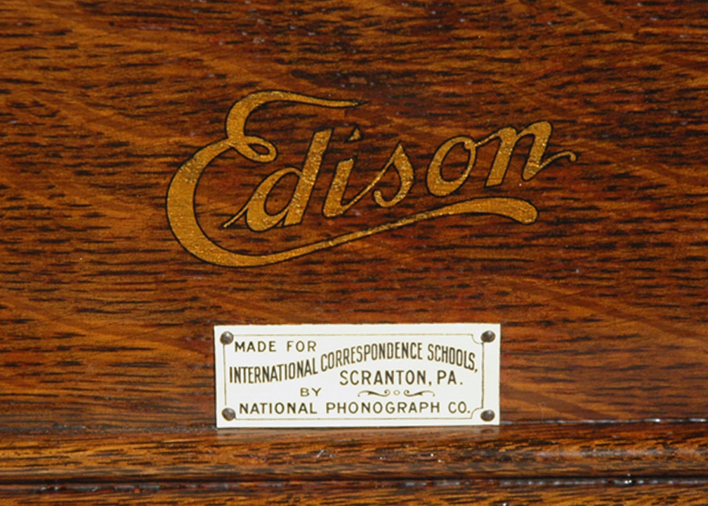

Interesting label that names the International Correspondence Schools, Scranton, PA. ICS was the go-to source for folks who wanted to learn a trade (hey, wanna be a locomotive engineer? Here's how!) through home study. Their textbooks make interesting reading today. Their original headquarters building still stands today in Scranton; it's been pointed out to me by a friend who's more familiar with the city than I am.

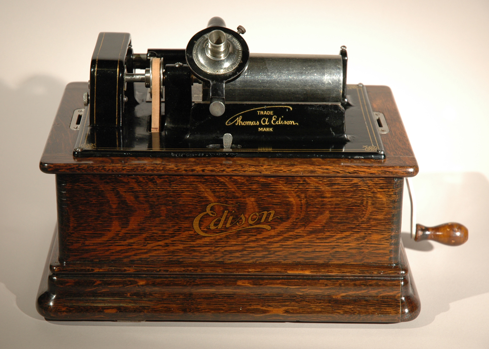

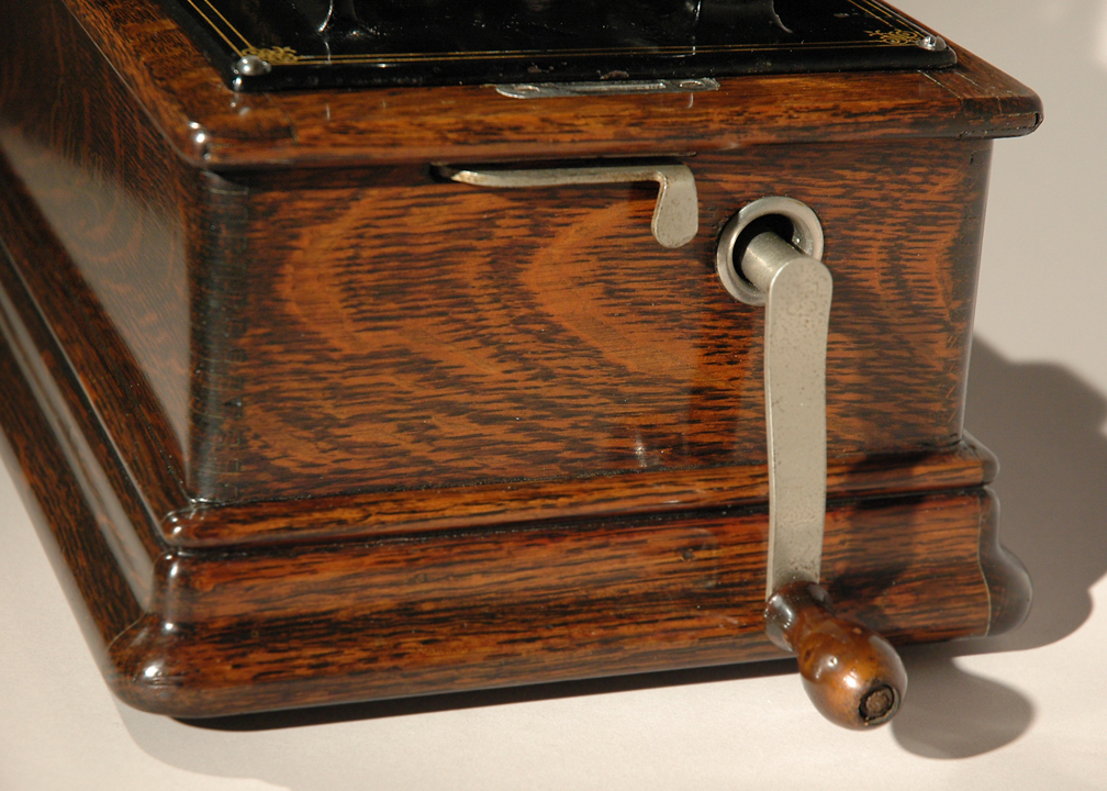

Since the photos disappeared due to the hosting service going kaput (and since there has been a request), here are the photos re-instated:
Post by martinola » Mon Feb 06, 2012 11:43 pm
Hi Clay.
My take on re-amalgamation is that it's worth a try if you don't mind being patient and are willing to experiment. I just finished a re-amalgamation of my Standard Model D that was rather rough and had bad flaking on the lid, back and crank side. The thing is that simply re-flowing a trashed finish isn't usually enough. I've had to add coat after coat of clear shellac in order to "level out" the finish. There's a lot of time that goes into touch-up color matching, filling in low spots, sanding and polishing. The result is essentially the original color and (I think) better than a re-finish.
Std D before side view Std D after side view Std D wide after front Below are some shots of an earlier re-amalgamation/restoration of my Standard Model C ICS machine. My main goal on this one was to save the decal.
Std C finish and decal before Std C decal after Std C wide after Anyhow, whatever you do decide to do; good luck!
- Martin

There was also their other branch, the International Textbook Co. (ITC), also in Scranton: my Standard B has their label.Henry wrote: Tue Feb 07, 2012 11:16 am Interesting label that names the International Correspondence Schools, Scranton, PA. ICS was the go-to source for folks who wanted to learn a trade (hey, wanna be a locomotive engineer? Here's how!) through home study. Their textbooks make interesting reading today. Their original headquarters building still stands today in Scranton; it's been pointed out to me by a friend who's more familiar with the city than I am.
