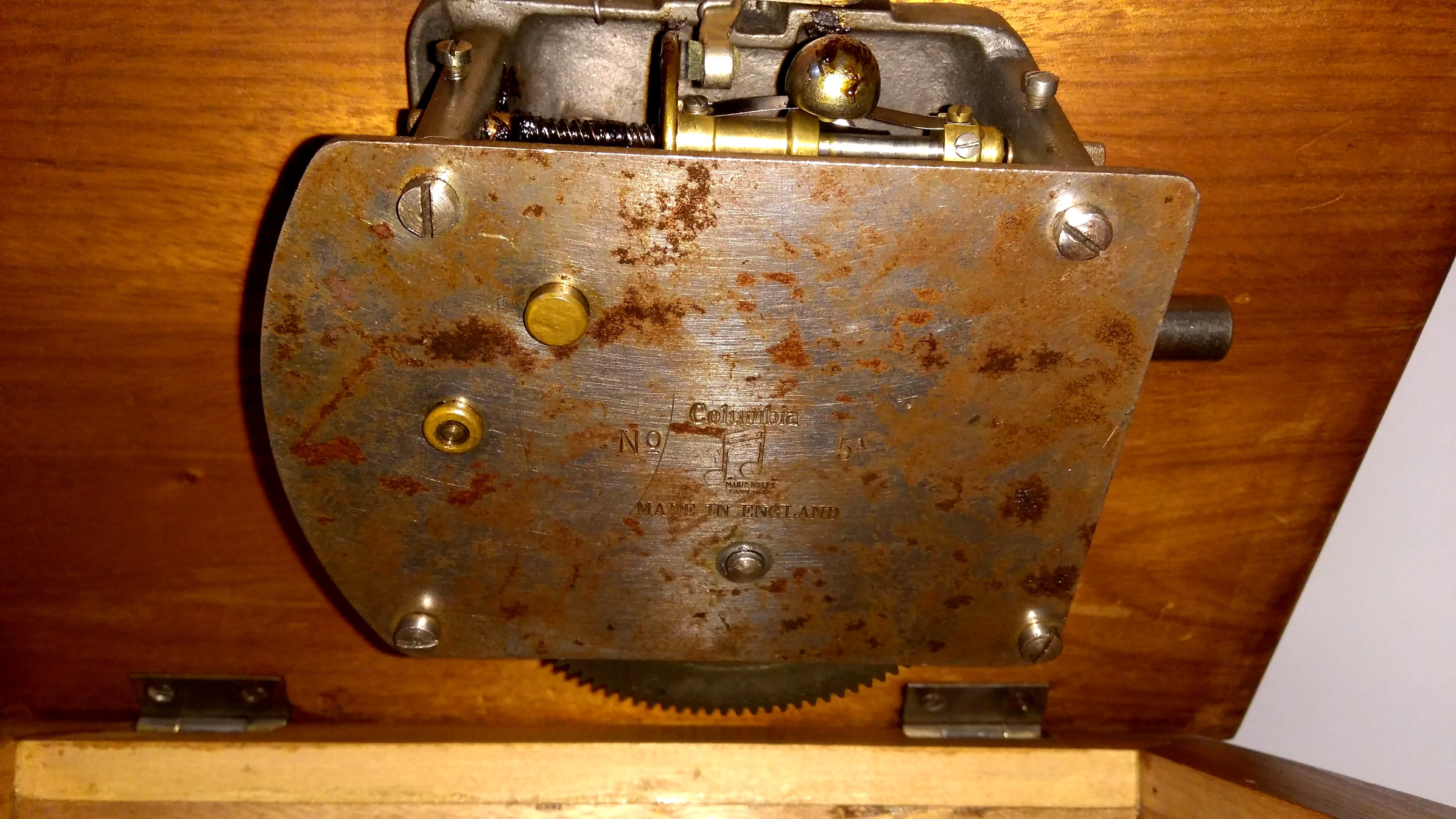

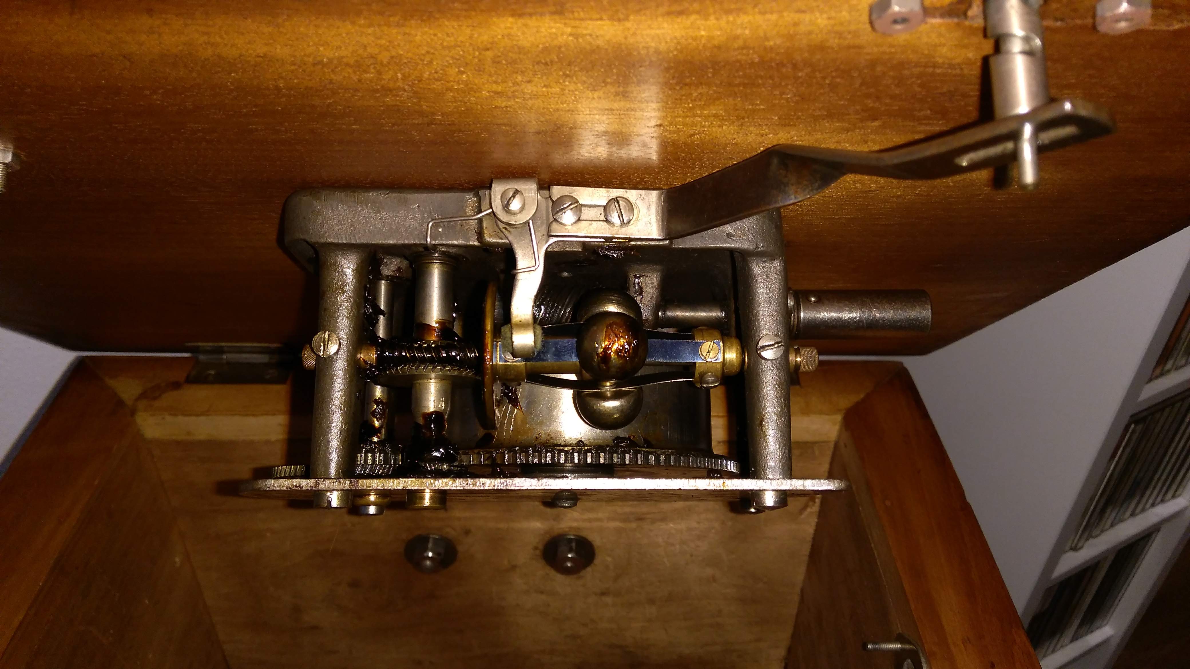

here's some more photos of the motor, which is marked 5A and seems clearly a single spring model:

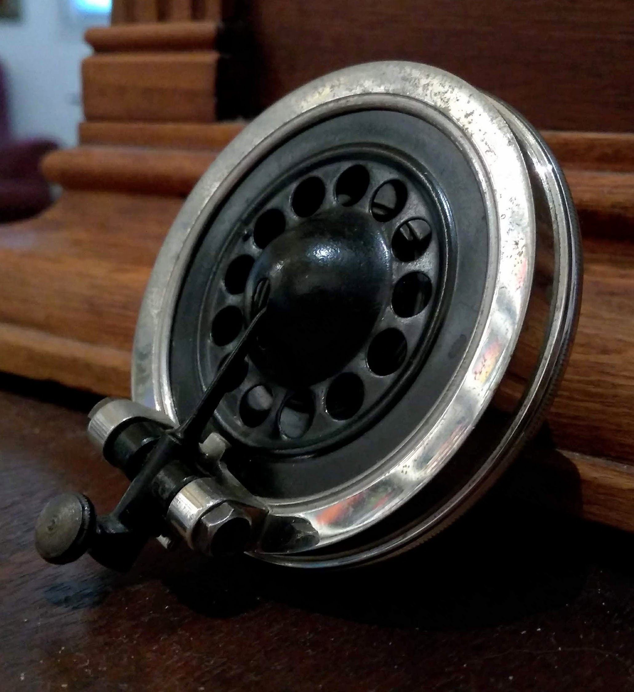

This is the additional soundbox the gramophone came with. I thought at first it was a Columbia n°9, but looking at the n*9 soundbox depicted in the catalogue uploaded by Inigo as well as in the Youtube video the front cover and arrangement of holes are different, so I conclude it is indeed a Columbia N°8. Please correct me if I'm wrong.

In the catalog, the Columbia no8 Viva tonal soundbox appears with no front bezel, the diaphragm exposed. I don't know if it was supplied this way, or if they removed the bezel for the images... Si yours could be a no8 with bezel. The no9 as you said looks different, the bezel is different and the diaphragm too. No8 send to have a black metal diaphragm with a prominent conical dome in the center, while the diaphragm of the no9 is the well known aluminium plated diaphragm with concentric corrugations anda smaller round dome in the center, and all around the plane edge it has the transversal corrugations in form of a C letter: CCCCCCCC... , as used in the following Viva tonal soundboxes.
