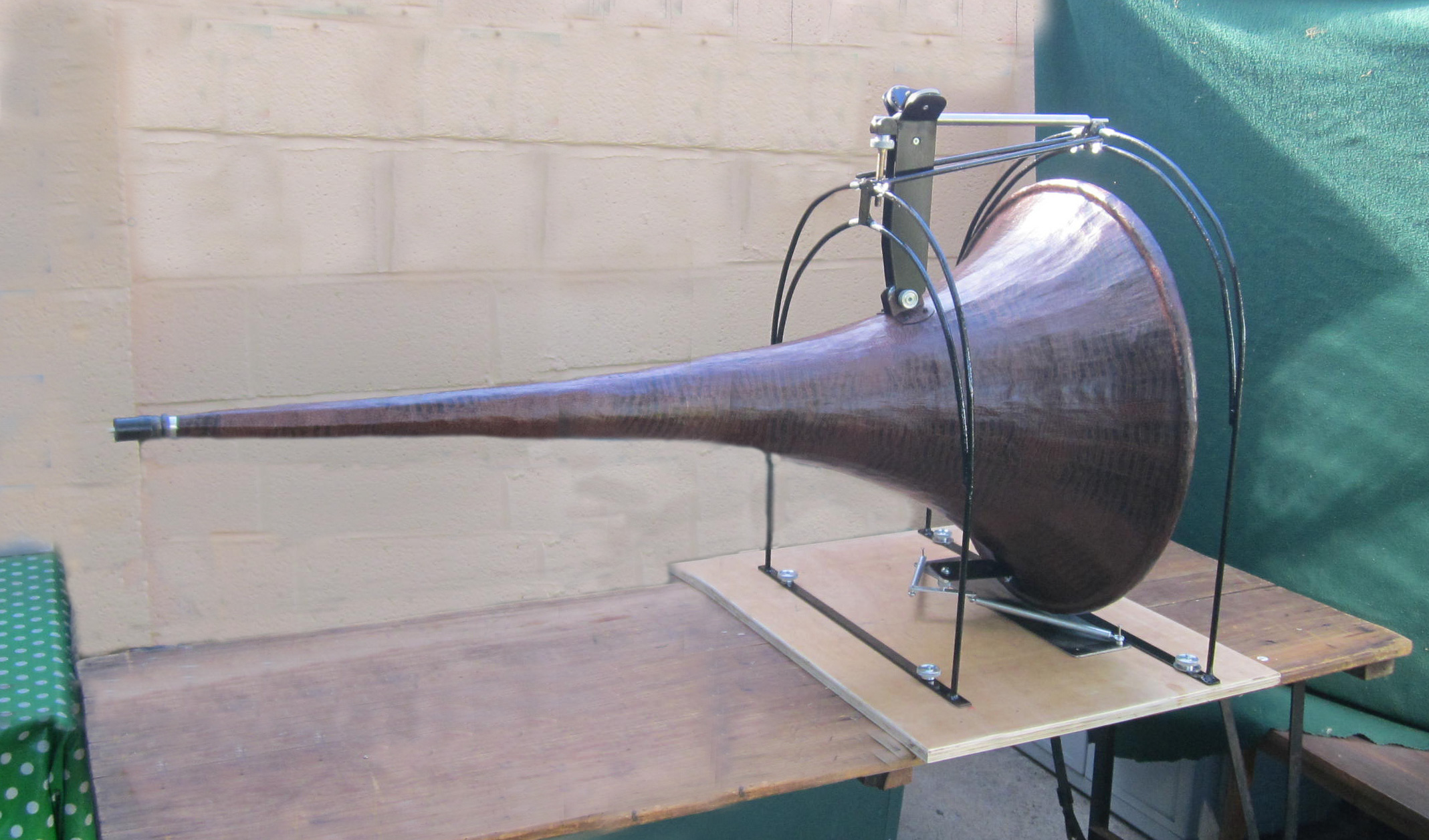

Here is the first picture of the machine which is being built. The picture shows the basic set-up, minus the motor box unit and soundbox.
I will be adding explanations to more photographs when I add them fairly soon. They have been written by Adrian Tuddenham, who can really
take the credit for thinking up, then manufacturing the mechanical side of this, what I call the "Neo Balmain" machine, even though it does not copy very closely most of Mr Balmain's ideas, The main similarity is the effect of "straight line amplification".
Mr Tuddenham is trying to enroll as a member of this gramophone forum, but is having much difficulty getting to grips with the system used, even though he is very well versed in computer technology, and has been for many years. So, I am copying his writings which he has so kindly sent me down as e mails. He has spent many hours both in thought and putting into practice his ideas. Granted, not all of the time does he get it right first time, but try and try again,and it all becomes second nature to him, (give him a pencil and a bit of paper, and he will work it out)as the theories seem to take form and work. I am sure not all of you on the forum will be in agreement with his designs, but we must congratulate him for producing something, (which we think will work well), and has not been copied from part projects by others. He is reasonably confident that this machine, when finished will work accurately, or as accurate as can be expected from a machine of this type. If there are any problems with the quality of reproduction, then I will hang my head low, as I constructed the horn, and may not have put the exponential theory, but the horn with over 34 layers of sugar bag paper, using over seven kilogrammes of strong paste, will at least be as acoustically "dead" as it can be.
I hope some of you will read this and find it as interesting as we have done as it has taken shape. Dear old Frank James is the chap who really got me into paper horn making. He was a great encourager amongst all his other qualities.

Alastair, big hurrahs for you and for Adrian! We're eager to see your progress, and to watch and hear your tests!
Don't dismay even if the first sounds you get are not as expected... This machine, as did the commercial ones, will need fine adjustments and tuning, but we're sure you'll finally get an impressive sound with lots of 'presence' when the design is at its fine tuning stages.
Go ahead, gentlemen!
