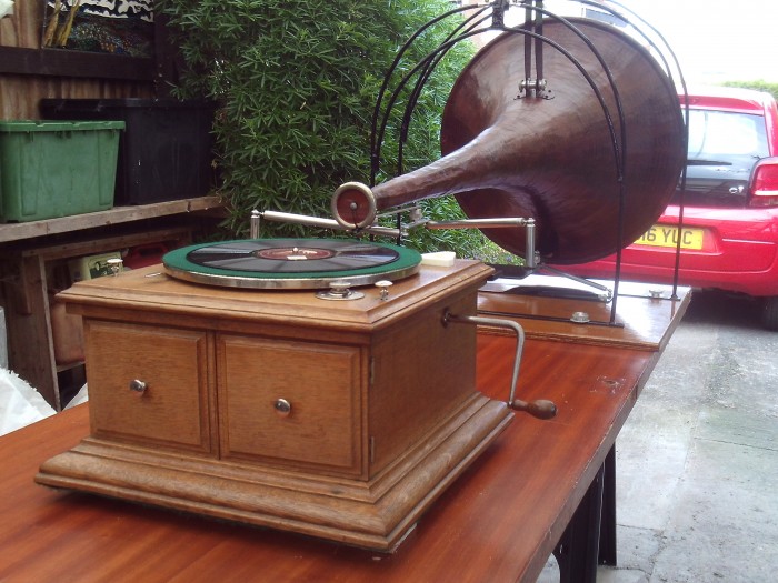

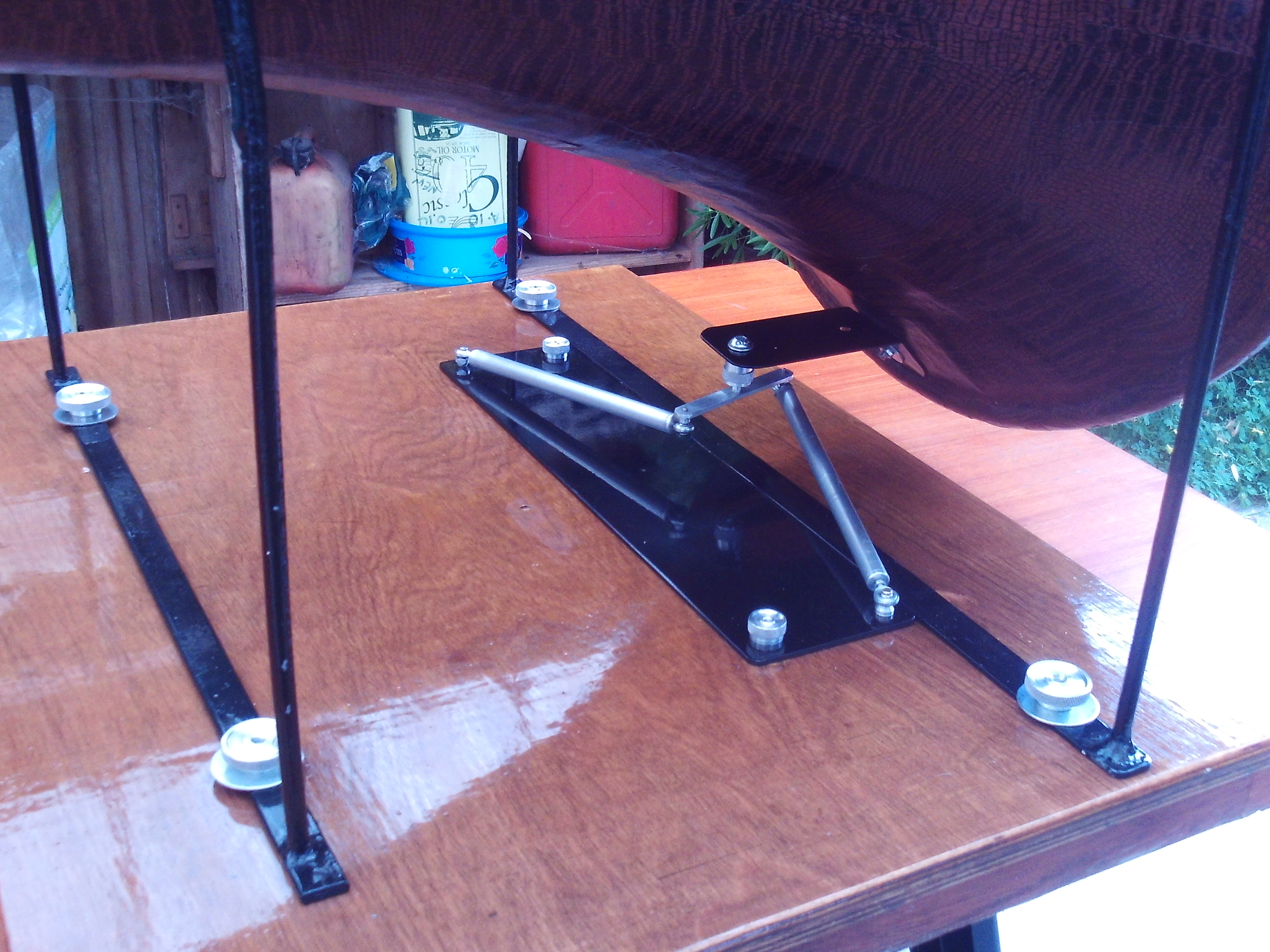

Regarding the on-going work on the "Neo-Balmain" machine. I travelled to Adrian's yesterday, in the town of Bath. He has made the two "U" clamps to be attached to the soundbox end of the horn, several inches along it's length.. The clamps will have an attachment for the Watt Linkage which will be raised on small pillars on their bedplate. To where the bedplate is going to attached exactly has required some thought for the proper working of the linkage, but Adrian seems to think that the plate can be attached to the motor board. but the exact place will be governed by experiment when I next venture to his abode. He is still pretty confident that the machine will be able to function as it is intended to, when finished. He even mentioned that we might be able to play some 14inch hill and dale records, but that does not worry me, as I am happy to play ordinary gramophone records, of which I have many, (just ask my wife!)

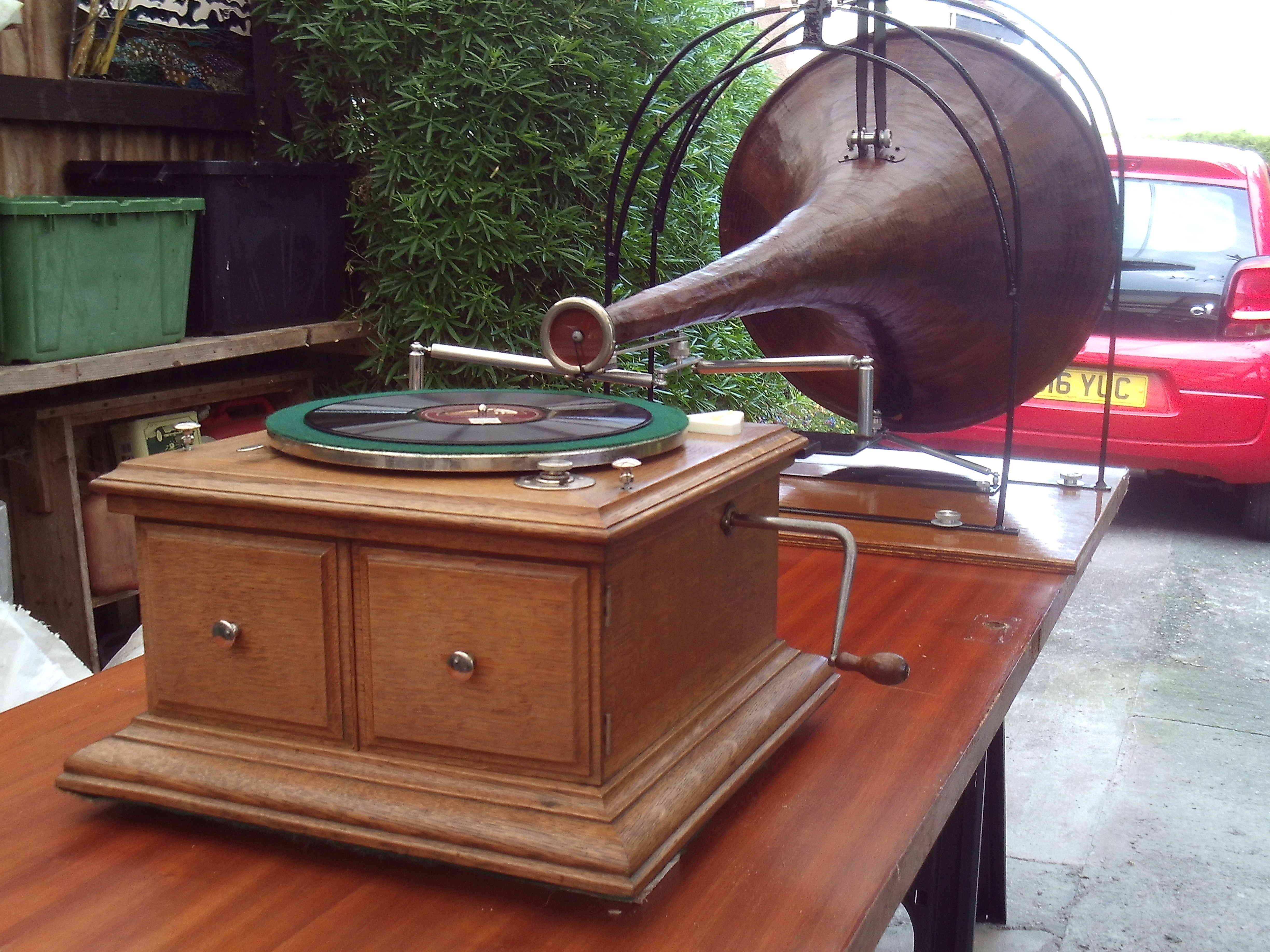

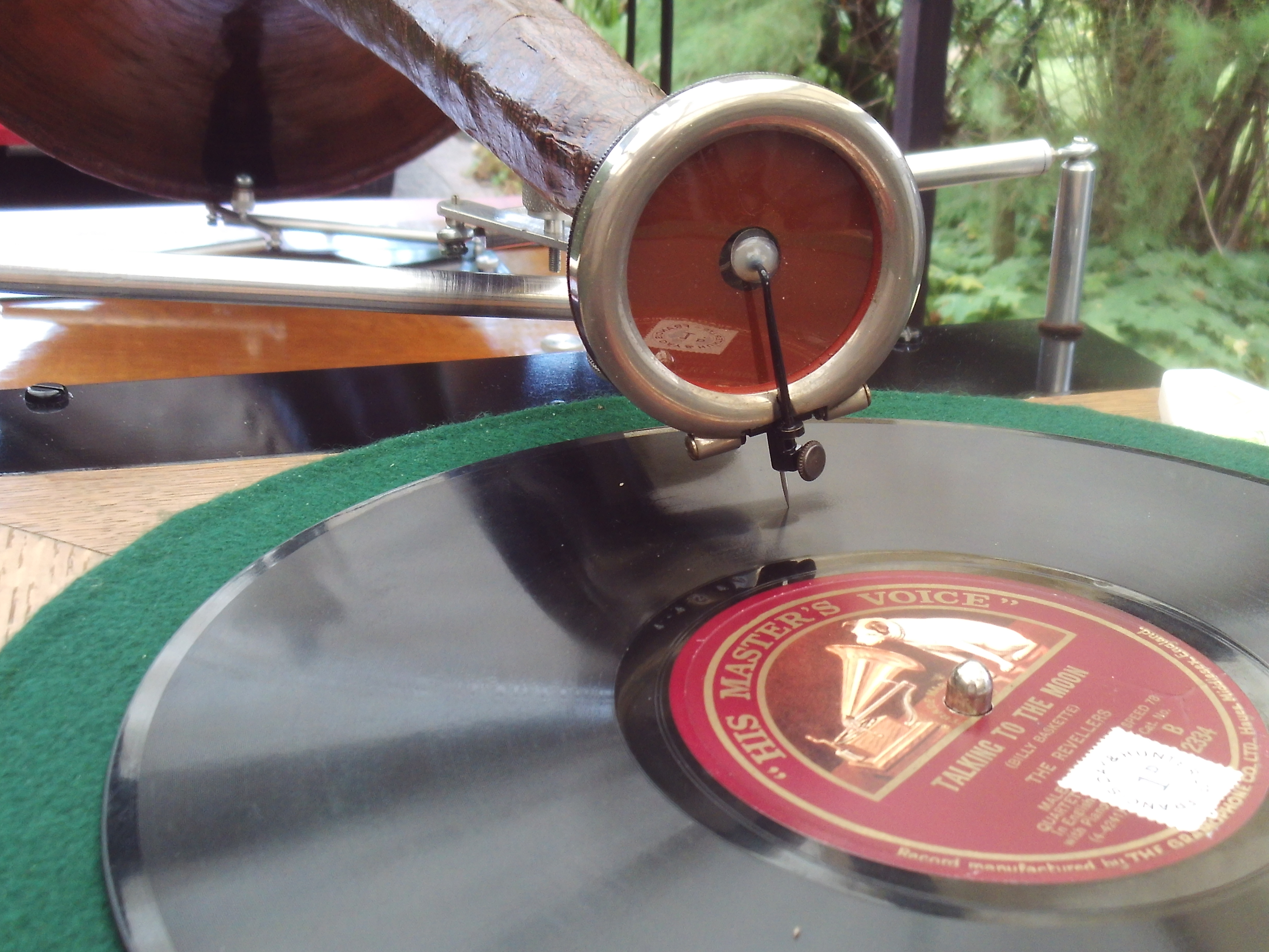

Today I set up the "Neo-Balmain machine in the car port, as plenty of room!
I set it all up on an old door we had kicking around, which lay on a couple of my wife's trestles. After levelled the gramophone, I found that I had to raise the motor cabinet about 1.6 inches on blocks, so that the needle was level in the soundbox from a side view, on the record, A weight adjuster is to be sorted, but I used an old clamp, weighing 72 grams to weigh the soundbox in the grooves. I will probably add height adjusters to the bottom of the cabinet , so that different soundboxes of different sizes can be utilised. A no 4 mica is being used at present for tests, and seems quite good. The sound from this machine is not particularly loud using a medium tone steel needle, but the clarity is good, and the overall "openness" seems reasonable. I may not have got the acoustics quite right with the horn that I made, but it is acceptable. A little muddiness, perhaps is evident with heavier sounding discs a couple of 1930s orchestral records of the lighter kind, but well recorded. Time does not allow me to try many more today, but when the machine is next assembled, I hope to be able to report back favourably!

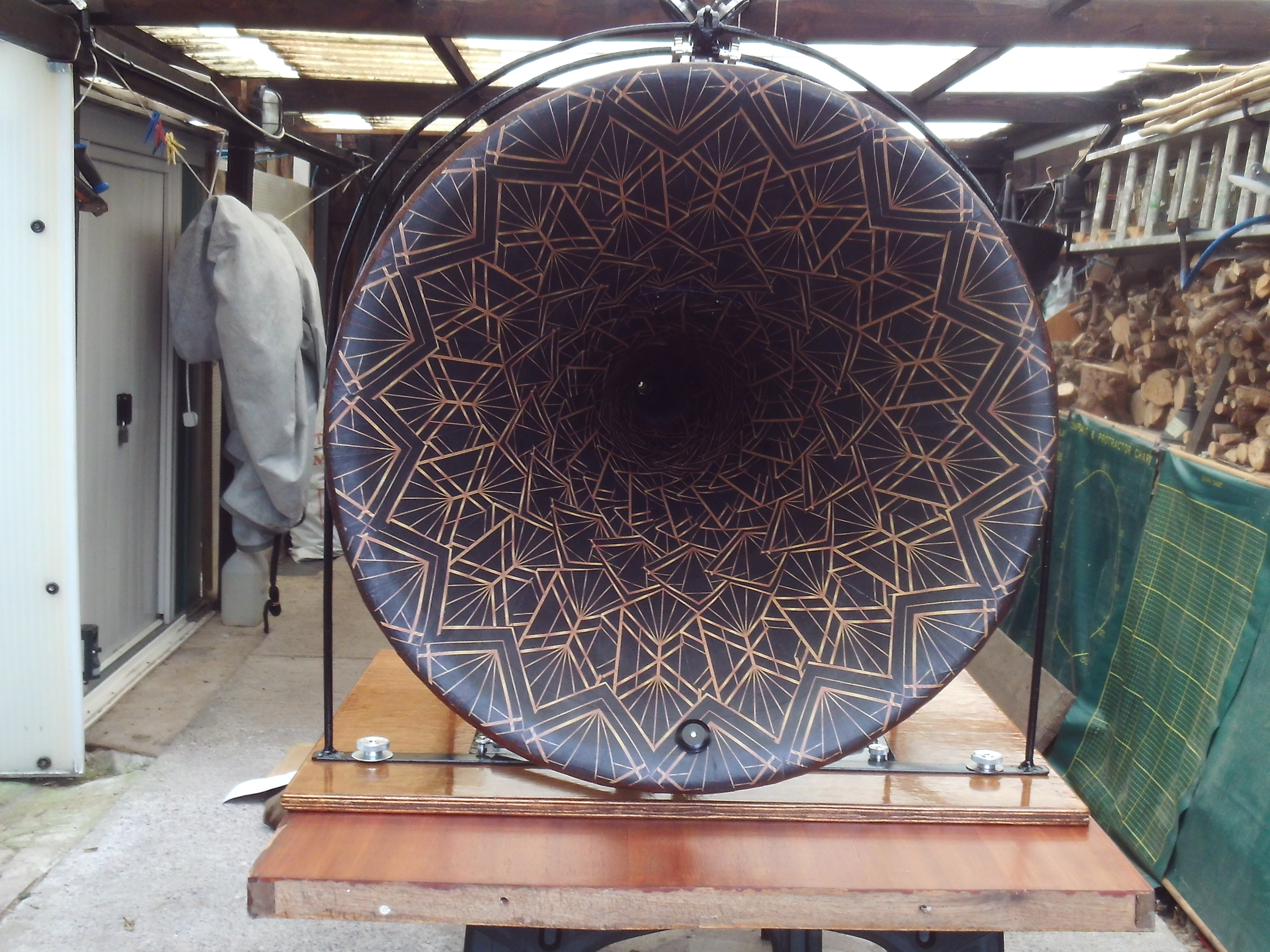

Really all the thanks for this "one off" machine must go to that very original thinker, Adrian Tuddenham, from Bath, Someset. Many messages passed between us on various designs throughout most of last year, and this year the making took place-not always getting it right, but interesting all the same, the horn manufacture had started last year. This final design may be the only gramophone it's type in the world using Watt linkages to help the horn move in a straight line across the record.
I am sending a few pictures for you folks on the forum to see. As I said there are still a few things to sort properly, BUT it does seem to work well-and that is what we wanted. A proper table is to be made before long, and sturdy! as the whole contraption is very heavy, the horn alone with it's appendages weighs 7.2 kilograms.
Alastair Murray.

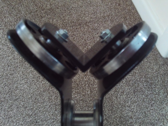

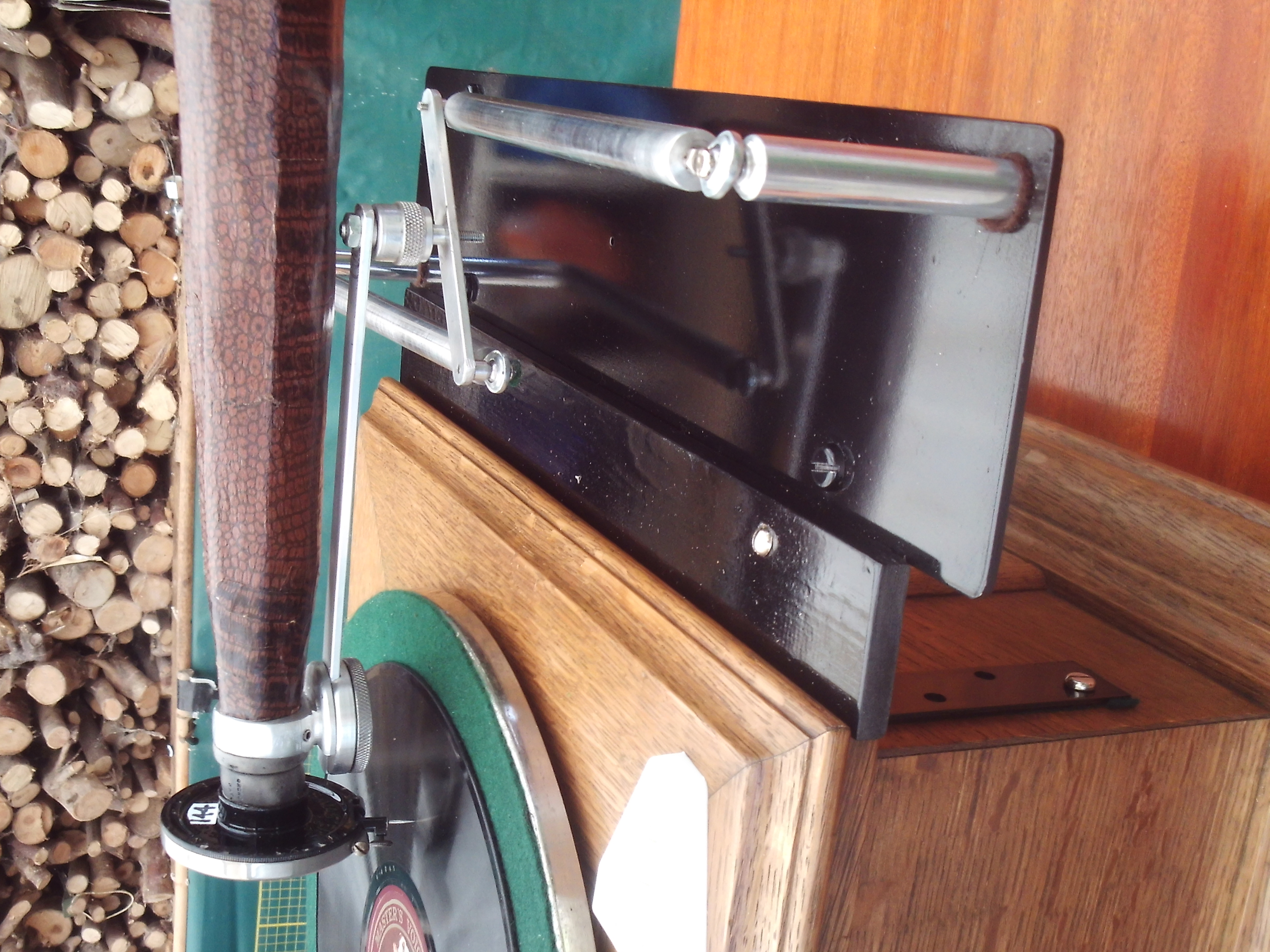

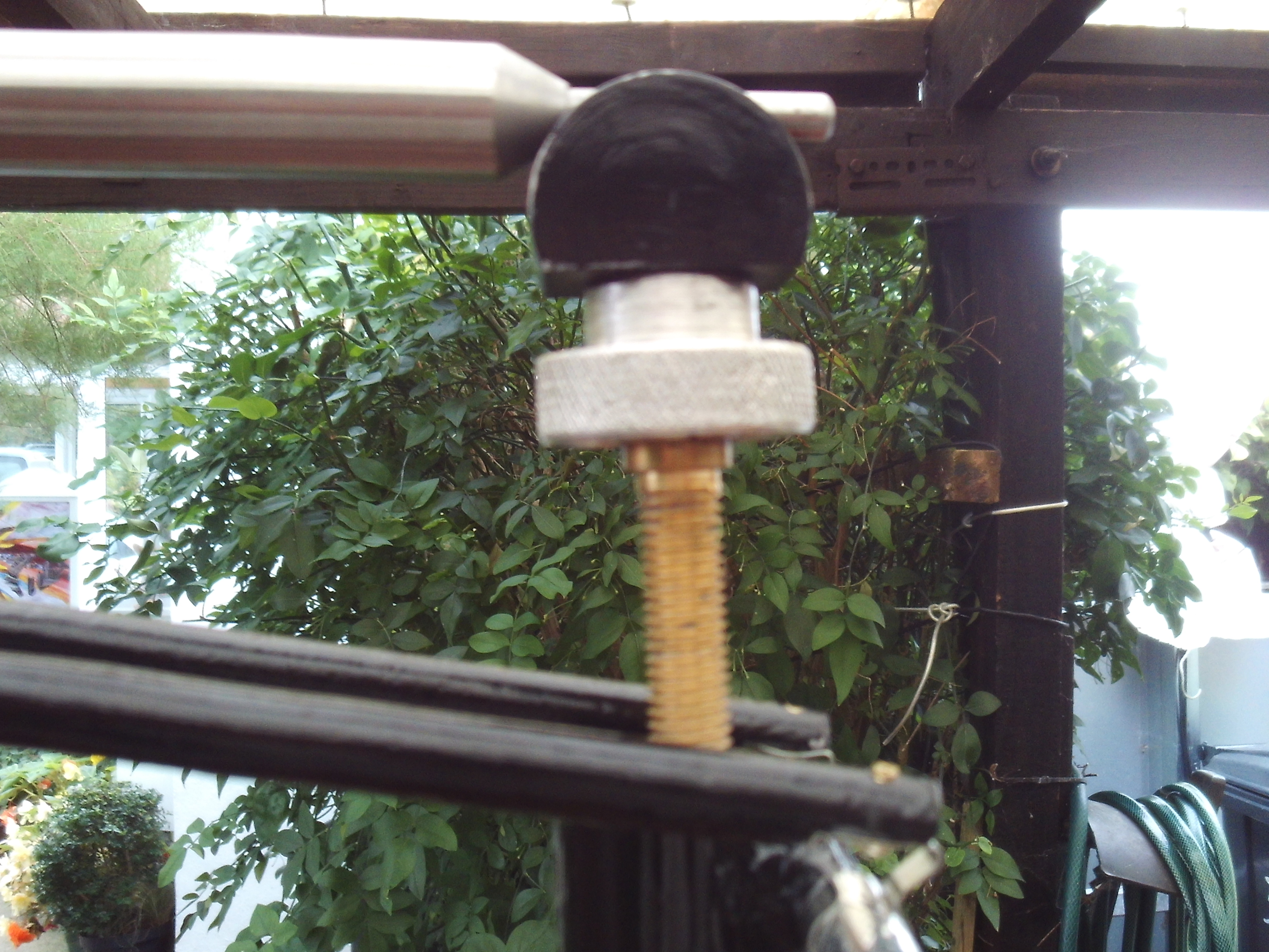

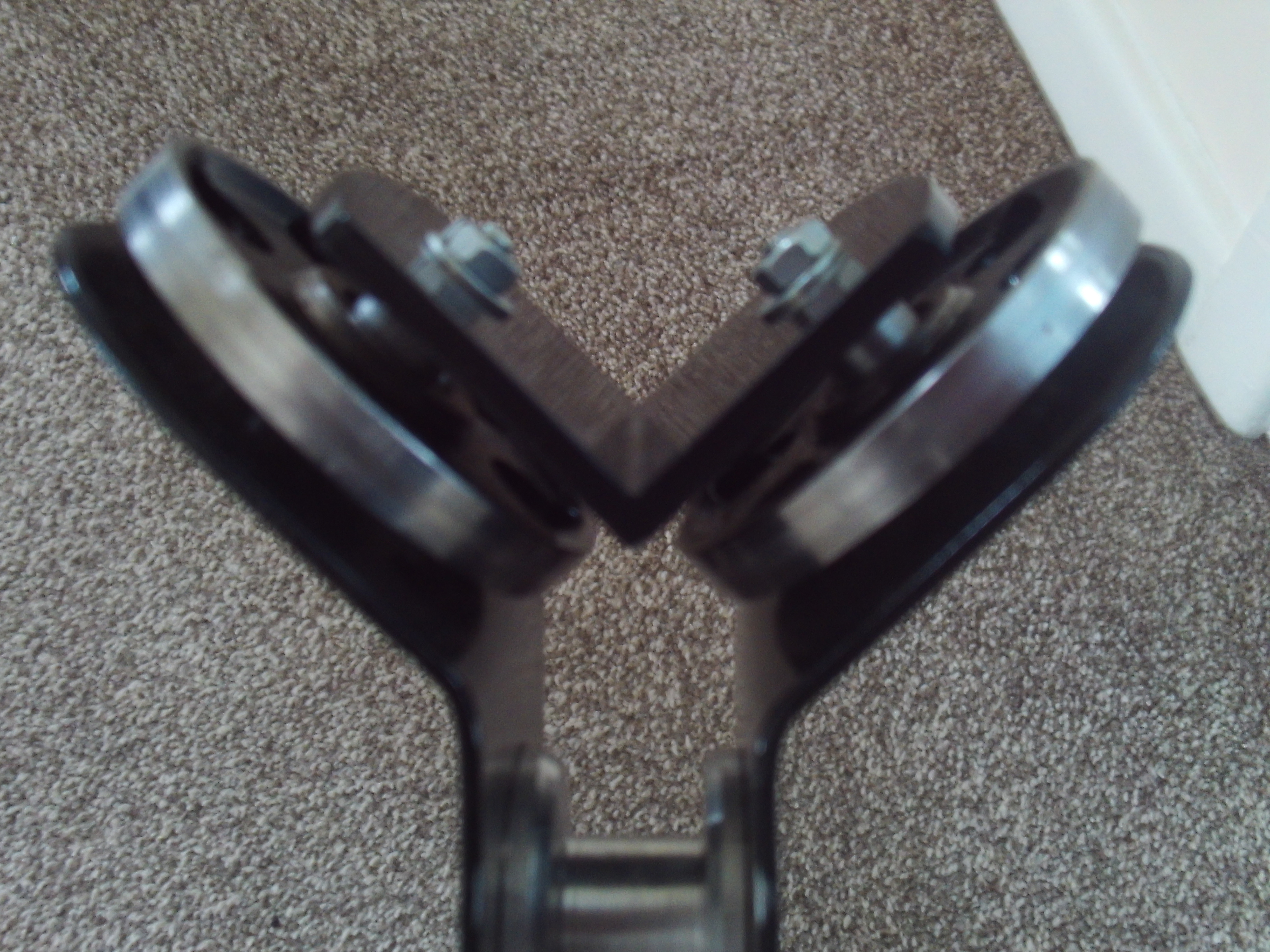

I am placing a couple of pictures which I forgot the other day. Not very good, but give an idea. One is of the levelling screw, which allows for the steel rod ( to be levelled by screwing up or down. The other picture shows the two angled wheels, which bear on the steel rod. They are fitted with ball
bearings.
