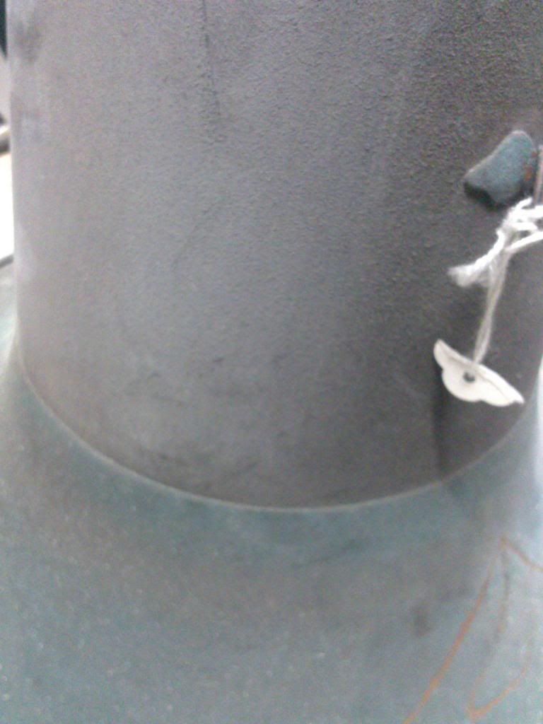

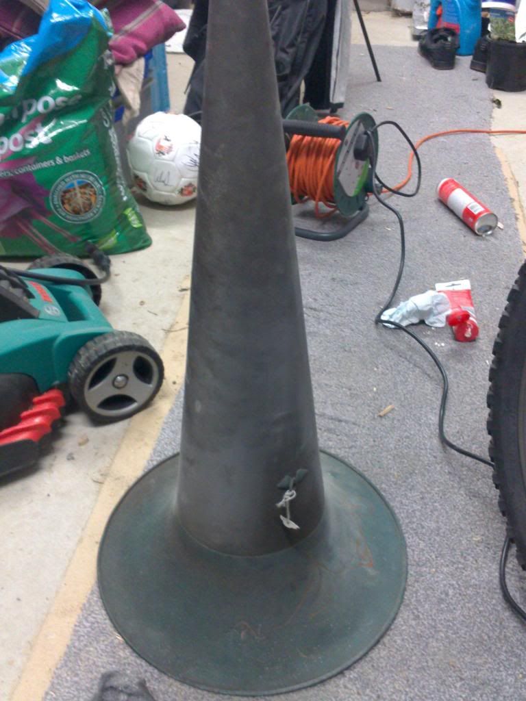

Can I just check this.
If the corrosion is removed with wire wool then the horn is polished smooth, can it then be just left un-lacquered without the corrosion becoming a big problem?, has anyone left a horn un-lacquered?, I don't really have a place to lacquer a horn, I would get someone to polish it to a shine then lacquer it for me and get the job done right but I don't know where I could get that done where I am or how much it would cost.
I like a shiny horn but it is over 100 years old, as aslong as it looks better than it did then I'm happy with that!

Is that an all-brass horn or a sheet metal horn with a brass bell?

Looks to me like a steel horn with a brass bell.

Get out your magnet and test the body of the horn - if it sticks, it's sheet metal - if it doesn't, it's brass... As far as polishing brass and leaving it un-lacquered, that is my preferred method. Polishing it removes all of the years of built up crud and leaving it uncoated, lets it age back to a nice patina...

Nope, all brass, I have already removed some of the corrosion on the horn and it shows shiny brass both on the bell and the body of the horn underneath that buildup of corrosion and dirt.
