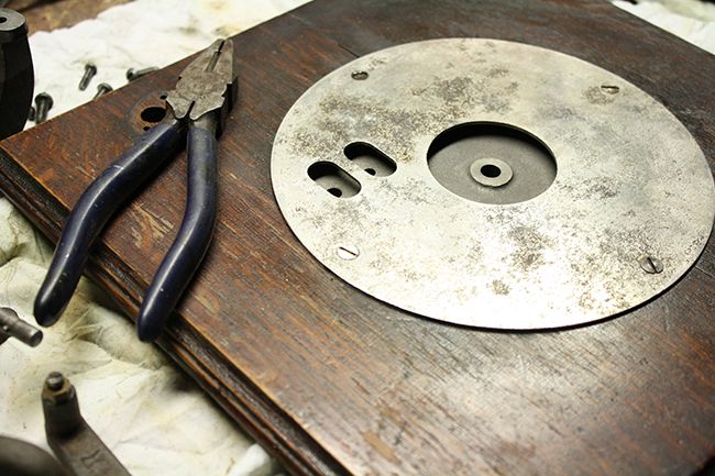

I then moved on to the top which was actually split in two pieces but held together
by the braces underneath.
Before
Before Top4.JPG (320.44 KiB) Viewed 1268 times
I used the motor plates and braces to re-align the two sides.
First one side...
Then the second (with glue)
Then Clamp (not as much blood and swear words, but liberal amounts of Grappa)...

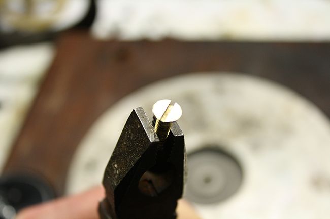

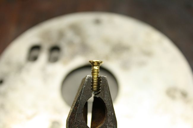

I'm sure the eagle-eyed have noticed the brass pan screw showed up again.
I took care of this one!
I'll polish and nickel plate it after the Grappa wears off...

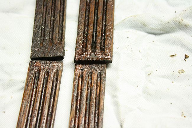

Part 5c?: An Unwelcome Surprise
When I realized that refinishing the cabinet wouldn't be required I was
quite pleased, but then...

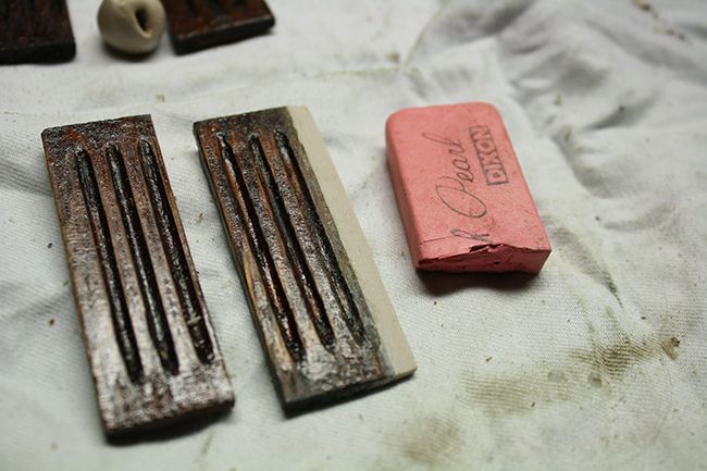

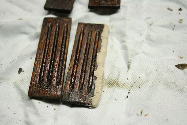

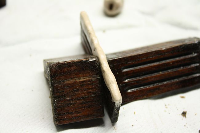

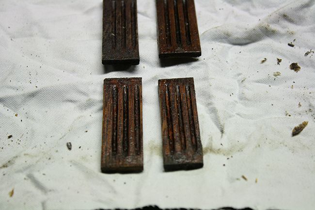

I began arranging all the pieces of the corner columns and found that one of the fluted pieces had
a large sliver of wood removed from one side of it. In the picture below you'll see that each column
has two sides, the first slightly larger than the second. In this case, because the piece was damaged, they were both
the same size.

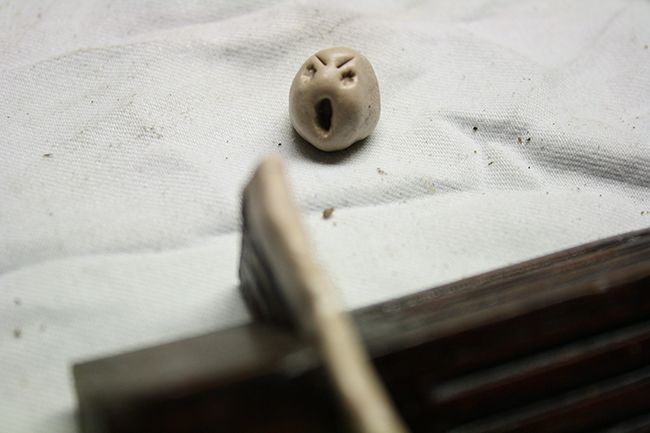

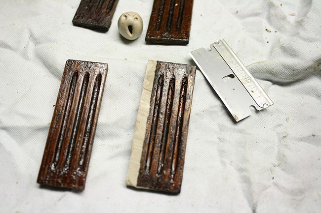

So I contacted a good friend of mine who's a restoration expert at the Museum in Cairo Egypt and he recommended
LIBERAL application of epoxy. Luckily I had some epoxy putty on hand so I followed his advice.
The angry collector looking on in disgust...
When the putty was hard but still slightly flexible, I carved it into shape with a razorblade
A few more of these...

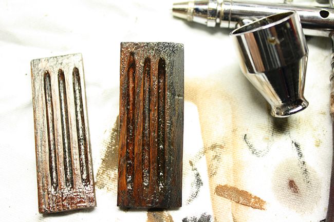

Once it was completely cured, I used a dried up eraser as a block to sand it into shape (220 grit, then 400)
Then, armed with an airbrush and a very fine artists brush, I applied some toner and then grain with
some oil based paint. It'll need a light coat of shellac for the correct sheen, but the case still
needs to undergo a thorough cleaning before that happens.
