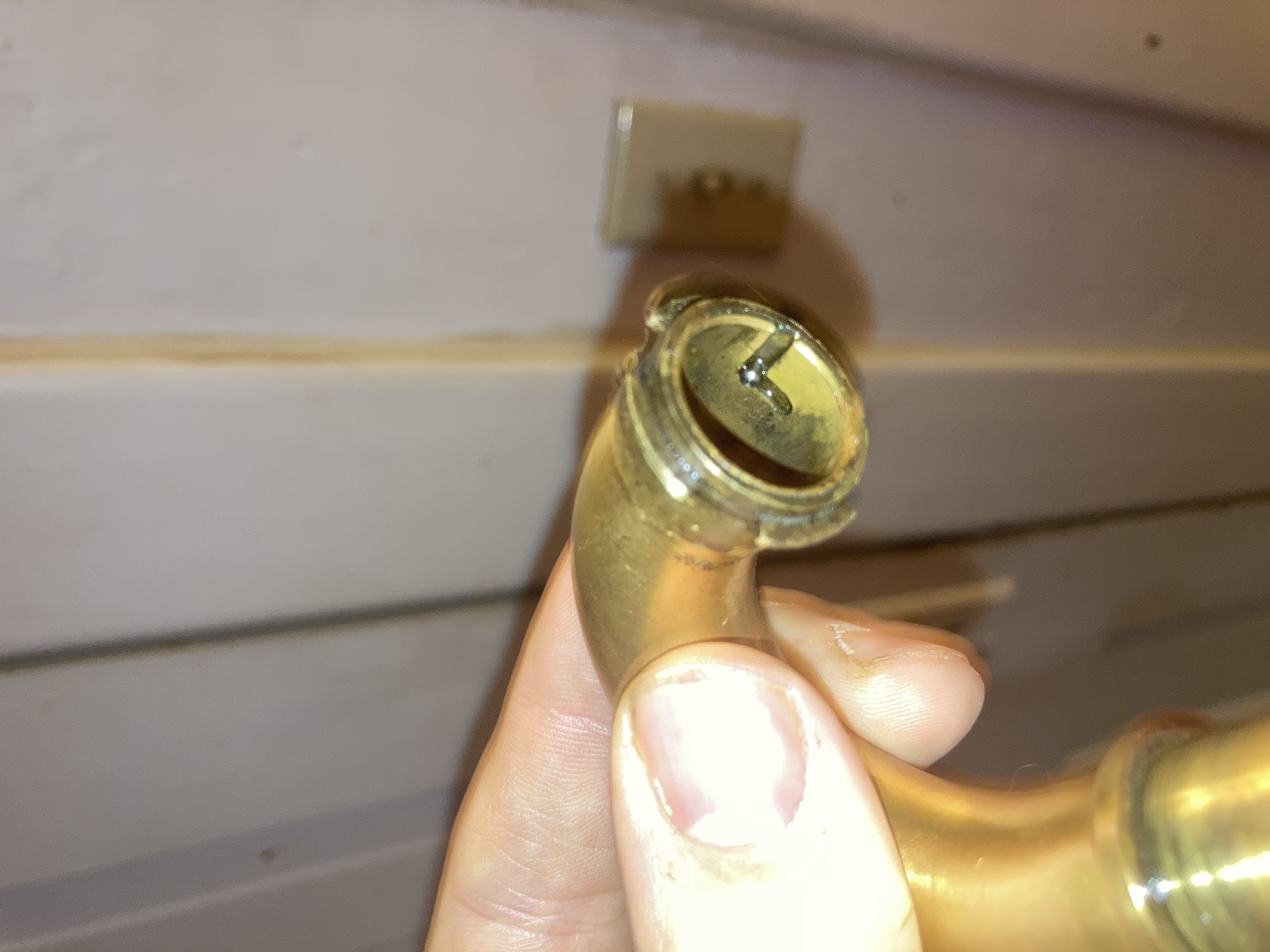

And here I am almost 7 years later with the same issue with this XIV! How do I get this dang thing off?

Post by AmberolaAndy »
Well unfortunately it wants to be an ABSOLUTE sore in my side and NOT slip off! 😾
I tried to yank it off with a pair of pliers NO dice!
Always gotta be that one ABSOLUTELY STUBBORN part that gets in the way!!!
So now it’s Currently soaking in PB blaster.
If I’m gonna Dremmel this off so be it.
AmberolaAndy
Posts: 2746
Re: Stuck Exhibition Reproducer
fran604g wrote: Fri Nov 11, 2022 7:56 am Maybe you should just buy a replacement "u" tube at this point?
Welp. I’m really this dang close on making a thread on the Yankee Trader section for another one as my last hope! But that will be after I ruined it in the process of getting this absolute bear of a flange off! It’s not too messed up by my pliers so far…

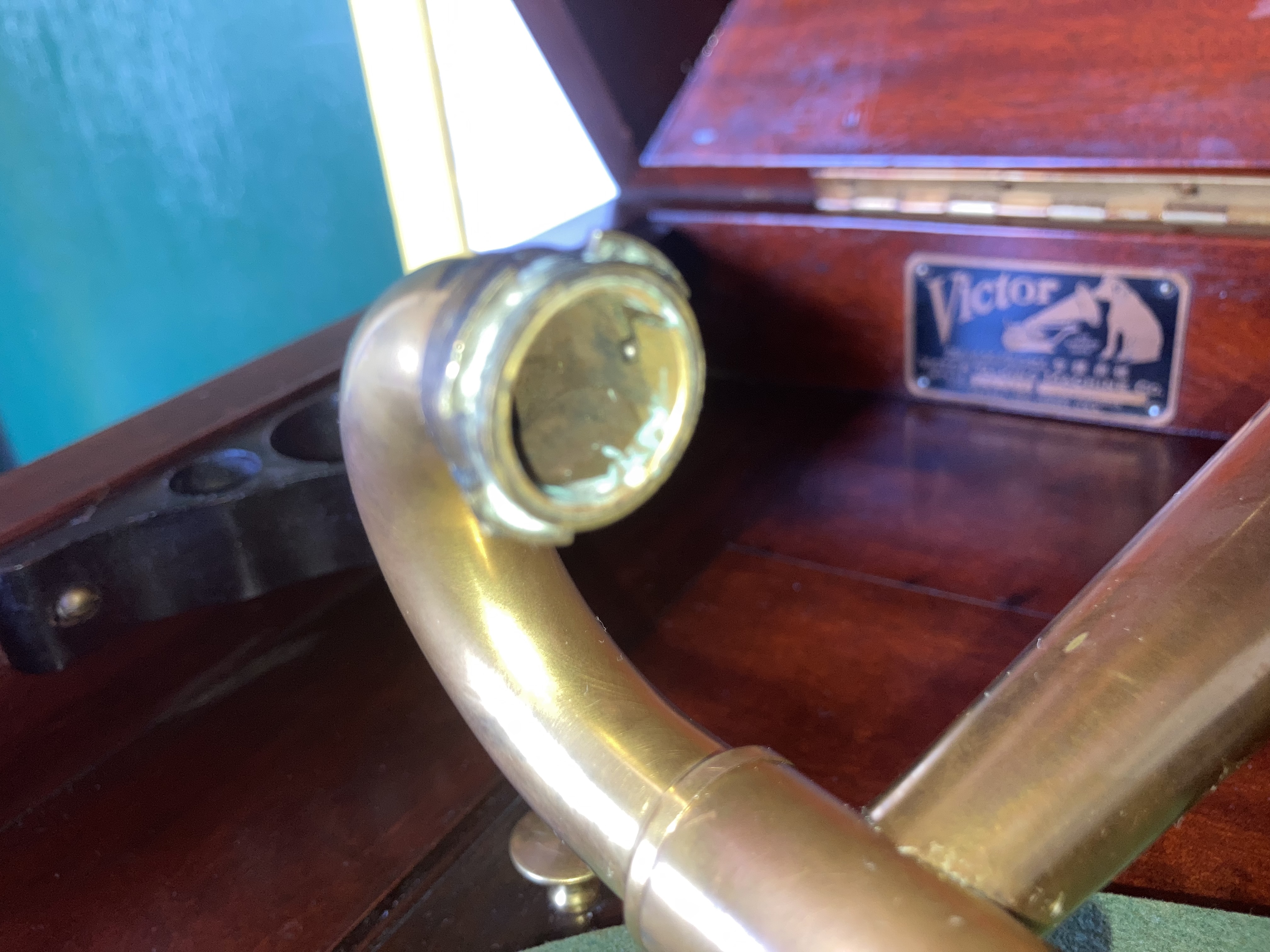

52089
Posts: 3836
Post by 52089 »
