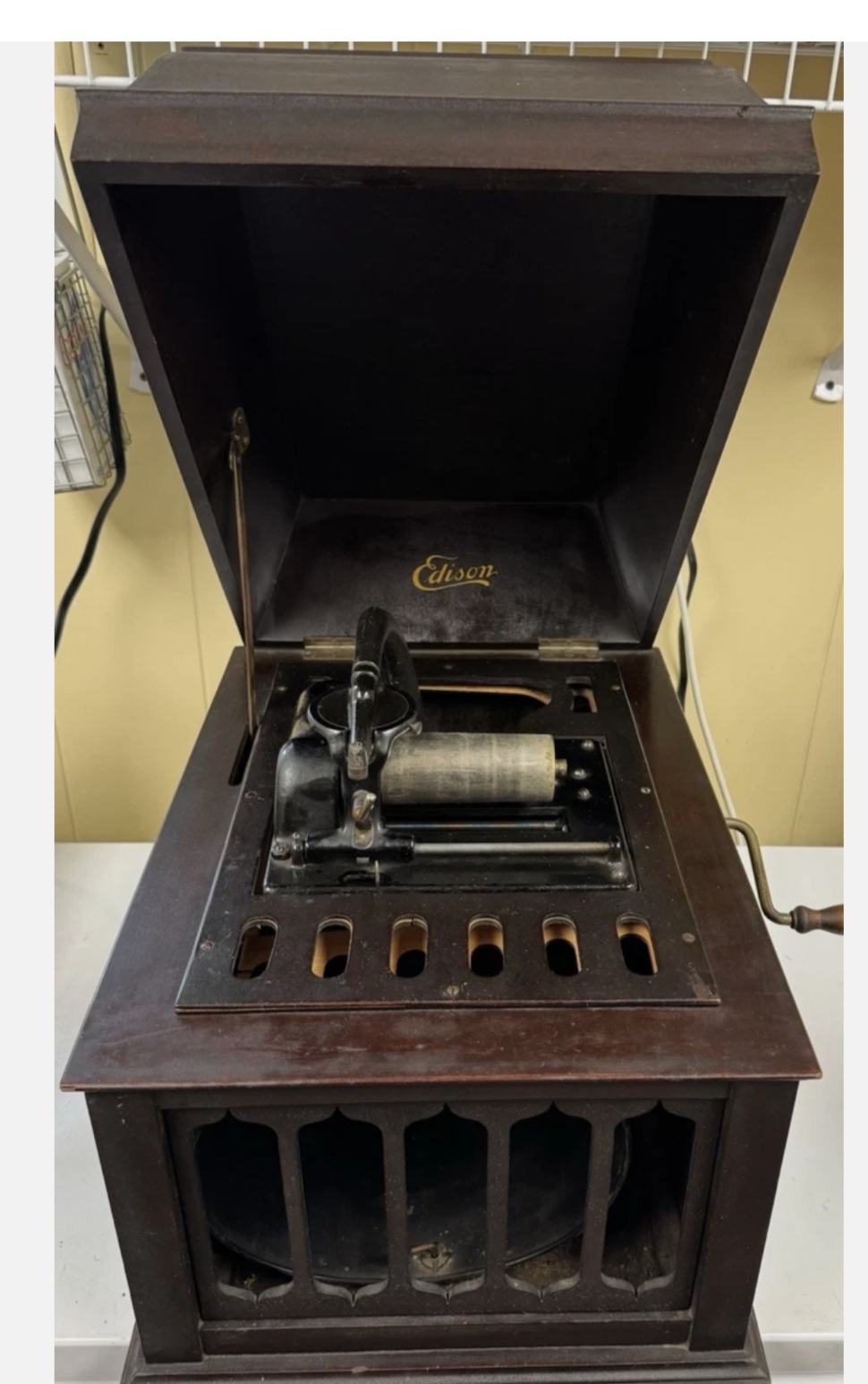

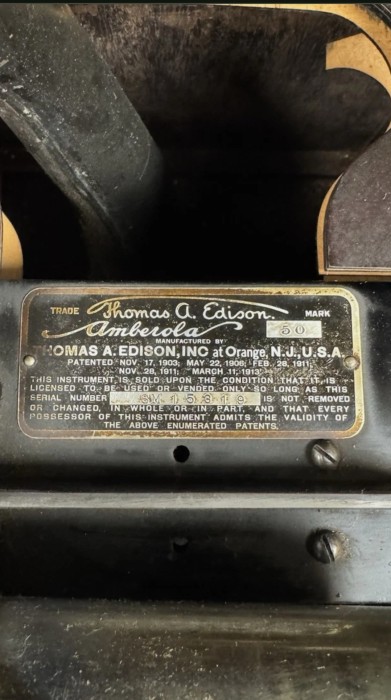

I'm new to Edison machine and looking at an Amberola 50 with this data plate. Wondering if this is a later machine in the 1920s? Is it correct that it only plays Amberola blue and green records?
Would you be able to also share what would be a fair value to buy an Amberola 50 these recent days?
Many thanks!

Re: Edison Amberola 30 grille cloth
I have looked at the two pics that you provided of your Amberola 50 machine. You appear to have An Edison Amberola 50 "2nd Model" (Late 1915 to Late 1917) approx. It has the Mahogany Finish. If its running and functional (Reproducer is working correctly).....and based on its current condition....It should fetch around $450-$500....thereabouts... Maybe $525 on an extremely good day with the right buyer. The Amberola 50 machine... as all Amberola 30-50-75 machines are "4-Minute Cylinder, Celluloid Only" Machines. They ARE NOT meant for 4-minute Black Wax cylinders (Damberols) and will destroy them if used. They are meant For use ONLY with Edison 4-Minute Blue Amberol Cylinders, Edison 4-Minute Royal Purple cylinders, OR Albany/Columbia or Sears/Lakeside Indestructible 4 Minute cylinder use ONLY. The are not meant to play with much anything else Except Modern Reproduction Resin 4-Minute Cylinders such as VULCAN Records Cylinders or Edisonia 4- Minute Cylinders. - Tony K., Edison Collector/Restorer, Melbourne, Florida.
