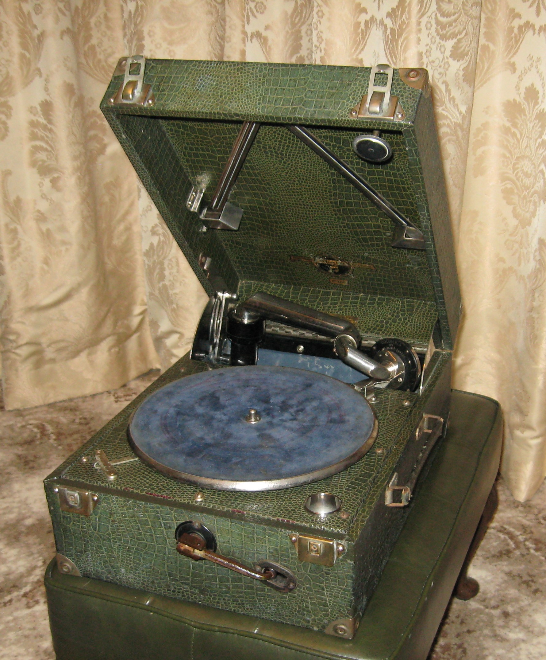

Do the "two others" (green crocodile 112A's) referred to above include the one I have?epigramophone wrote: Thu May 19, 2022 1:46 pm The Garrard No.50 is a large single spring motor and when in good condition should have plenty of power.

My collection includes three 112a's (black, brown crocodile and green crocodile) two 202's (black and brown) and a 201 in blue.
The green crocodile 112a is very rare and was never included in Columbia catalogues. Apart from mine I know of two others.
Their only weakness is their pot metal horn assemblies which can become fragile in old age. Repair is possible but tricky.
