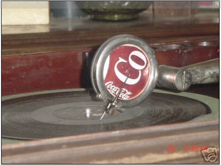

Here is an example of a "home repair" which is amazing in its own right - see if you can pick out the original and the home made replacement.

I'm not sure how old these "homemade" parts are, but one of them fooled me.
The 2/4 gear cover was in a box of parts, so I obviously knew right away-
The Amberola gear cover was on a machine I purchased on Ebay several years ago. The angle of the pictures, the distance and the fact that it was a good Buy It Now price-- and I rushed a little-- and I missed it. A "nice" surprised when I opened the shipping box.
Still, someone did a pretty decent job crafting the replacement cover out of a thick steel. Worked just fine.

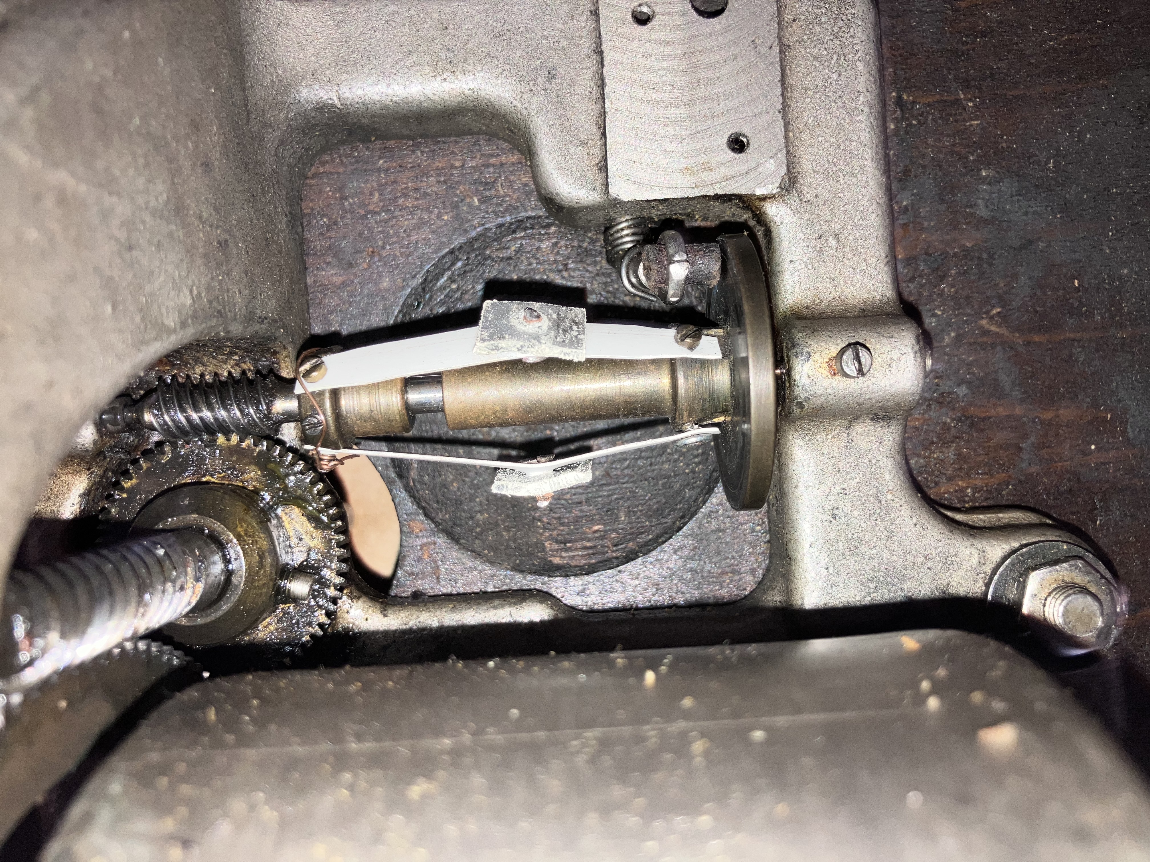

Bumping my old thread to show a governor “repair” on a recent machine I acquired.
This VV 1-70 I got from eBay showed up in one piece (thankfully) but when cranking the motor, I noticed it was very noisy same with playback.
So I took the hood off to inspect the motor and I saw this!
Yep Uncle Bubba got ahold of this one!
The “springs” appear to be made from a plastic Dixie cup.
