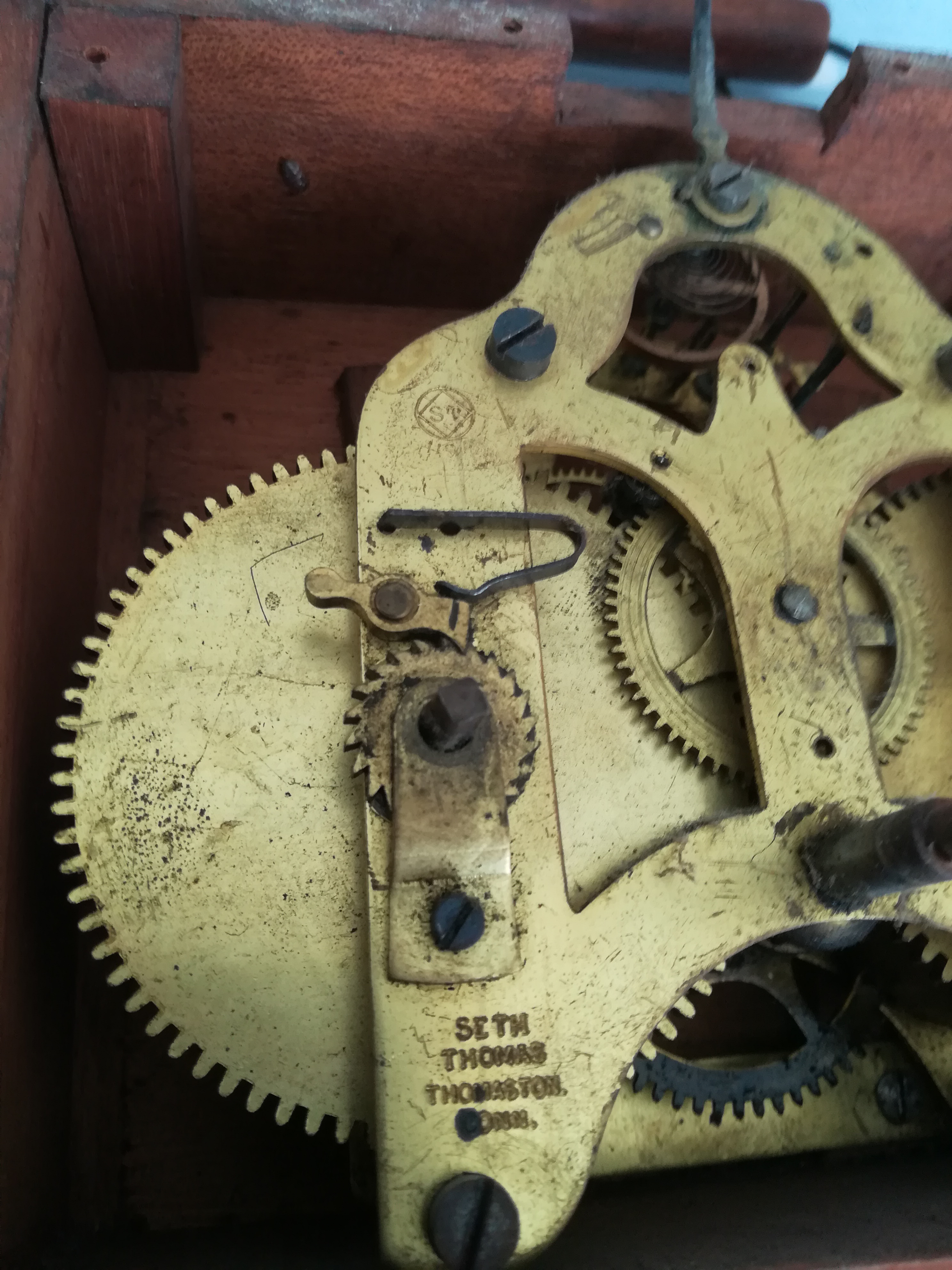

andyive wrote: Mon Jun 21, 2021 6:04 am This is what I have found so far. JOHN C HOYER IS THE NAME ON THE FRONT, AND THERE IS A FAST AND SLOW LEVER AS MENTIONED
Also Attached is the Seth Thomas write up from the America clock journal. "THE CLOCKWORK MECHANISM IS SETH THOMAS"
Andy,
Again, it would be nice to provide supporting material for your statements - pictures, documents, etc.
Your quote mentions an attached write up from the America clock journal... Where is it?
You say the movement is "Seth Thomas", in spite of an identical movement identified as being by Waterbury. Historically, Waterbury and Seth Thomas had no business relationship, so this doesn't make sense. Does your movement have an engraved Seth Thomas logo? If so, could you attach a picture of the engraving?
Also, could you attach a picture of the front of this item showing John C. Hoyer's name and the "Fast/Slow" lever?

The writing on each of the left and right says WIND, with a direction arrow. The centre one says 1 hour revolution, with an arrow
The makers mark is John,C Hoyer, scientific instrument maker 15 Bouverie st London
No mention of US anywhere.
Graces Catalogue is where the cyclinder recording idea came from, see my previous write up.

The clock mechanism says made in the USA and the left hand corner has the Seth Thomas mark
andyive
Posts: 8
Joined: Fri Jun 11, 2021 10:40 am
Personal Text: Interested collector
Re: cylinder recording motor
Post by andyive »
The clock mechanism says made in the USA and the left hand corner has the Seth Thomas mark. Last 2 phots attached

Thanks for the additional photos.
I think the John Hoyer stamp proves it's not just a home made box with a clock mechanism in it.
The modifications to the movement and the 3 witness marks on the wood front are a good indication this was a scientific instrument of some kind.
The rotating cylinder of the Kymograph (as Curt correctly named) is the only instrument I can think of that would require a mechanism like this.
It does however appear that whatever this was used to rotate, did it on both the front and back of the box.
Have you wound the mechanism to see if it works?
Because of the modifications, I'm wondering if each spring runs each side independently, and if the 2 speed control levers at the top control the speed of each side independently too.

Andy, sorry I pestered you, but thanks for posting these pictures. They take away any doubt about its origins...
