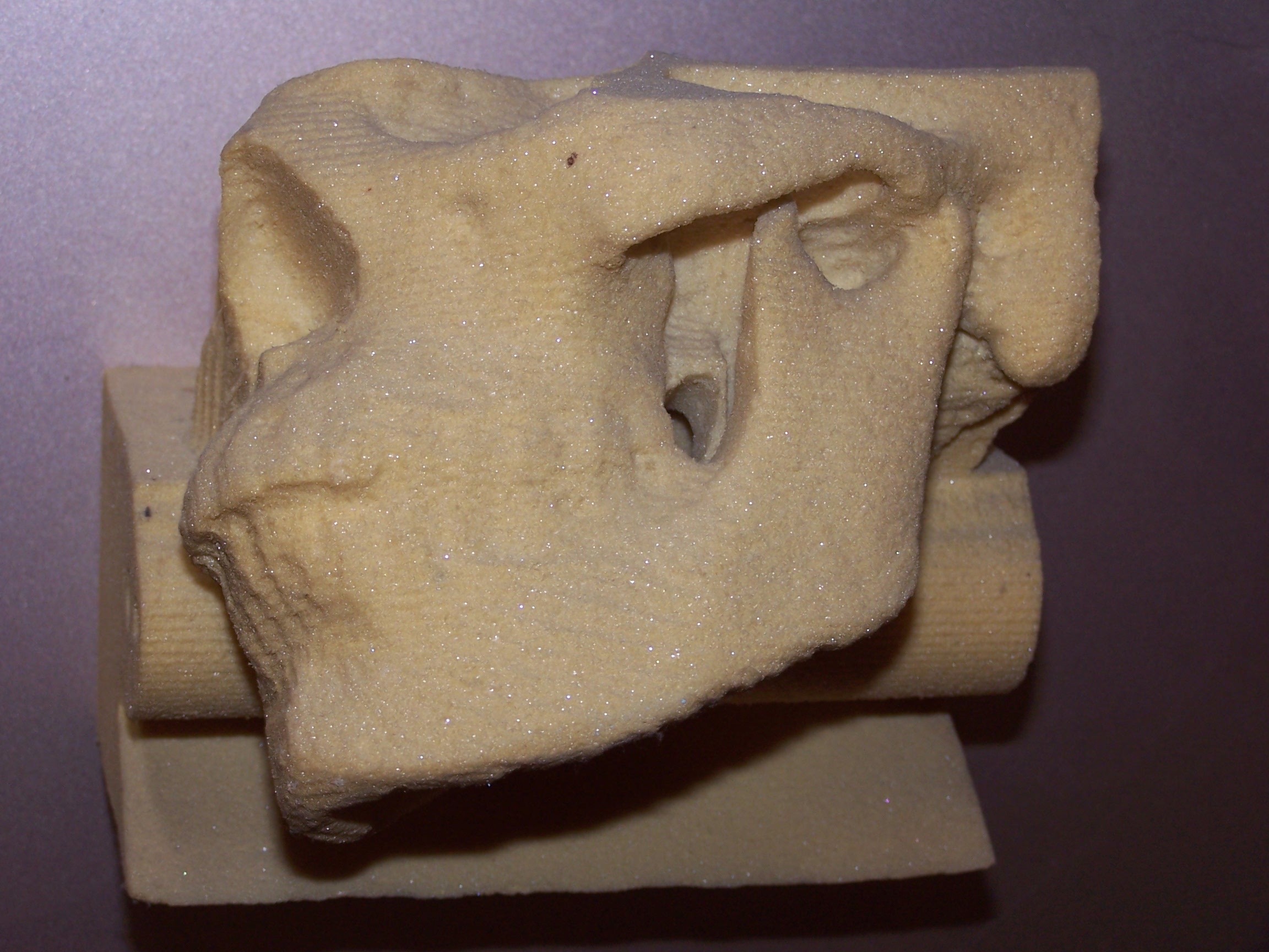

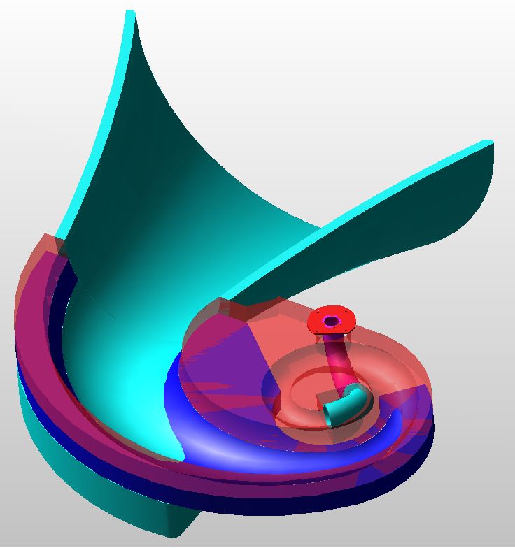

The latest idea for producing a horn involves milling block sections made of 2" stacked and glued building insulation foam board. There would be 4 blocks, these would be about 16" X 30" X 8+". These would contain mirror image sides of a spiral horn, split along the center plane of the spiral. 2 blocks would be glued edge to edge to form a 32" X 30" X 8" block containing one mirrored horn, 2 others the opposite mirrored horn. These two 32" X 30" blocks would then be assembled to contain the complete horn, other than the 3D and petal sections.
The assembled horn would connect via a short 3D printed 90 degree bend on one end to an Orthophonic tonearm that I have removed from the Granada. The other end of the spiral would have an approximately 17" diameter, which would connect to a 3mm Baltic Birch petal mouth increasing the mouth termination diameter to about 30". I have attached a 3D model of the assembled sections. with the exception of the largest section, the illustrated sections represent the core of the horn. The core is subtracted from the blocks, which are then milled. There are also photos attached of a quick experimental trial run milling the foam.

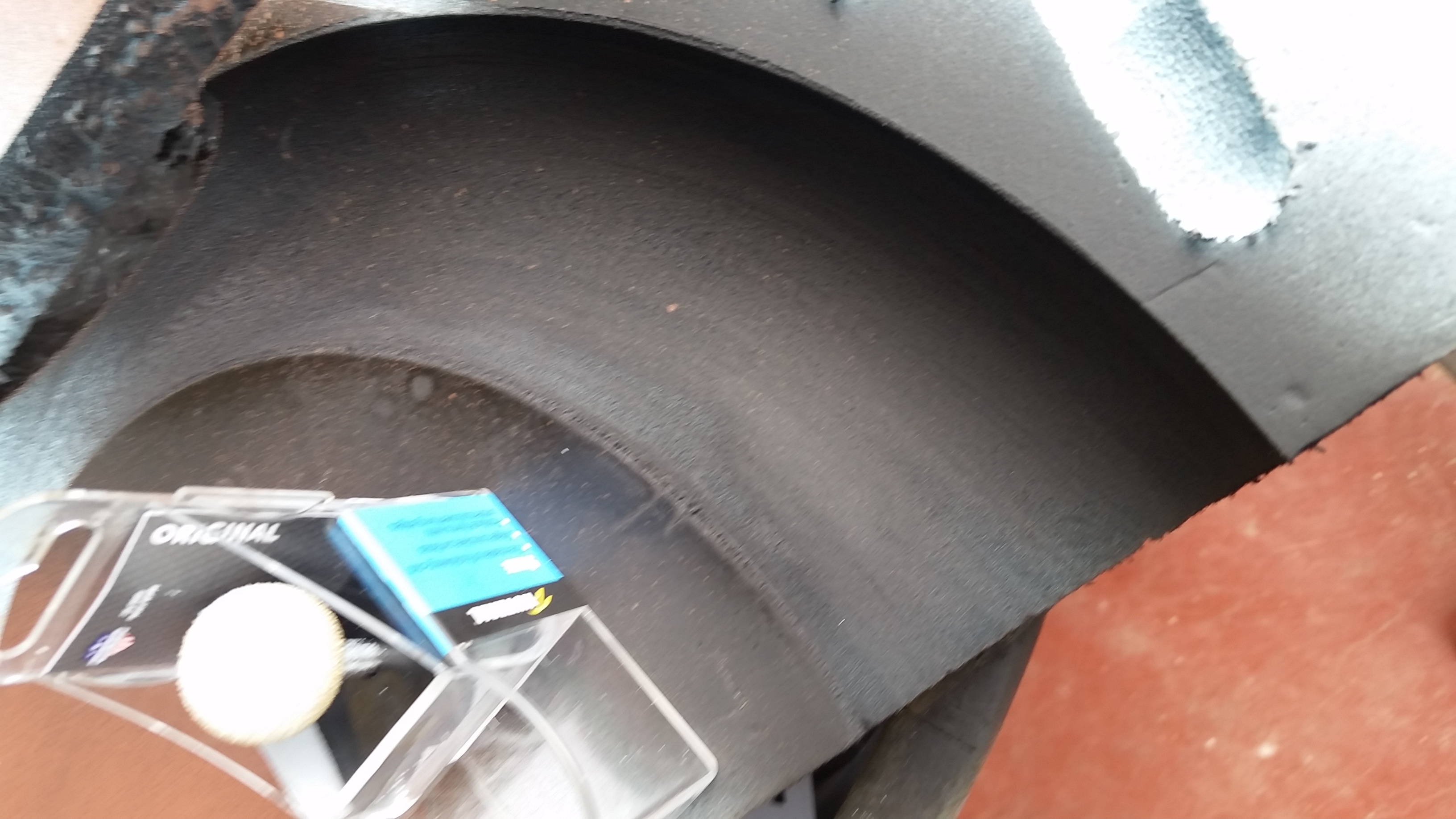

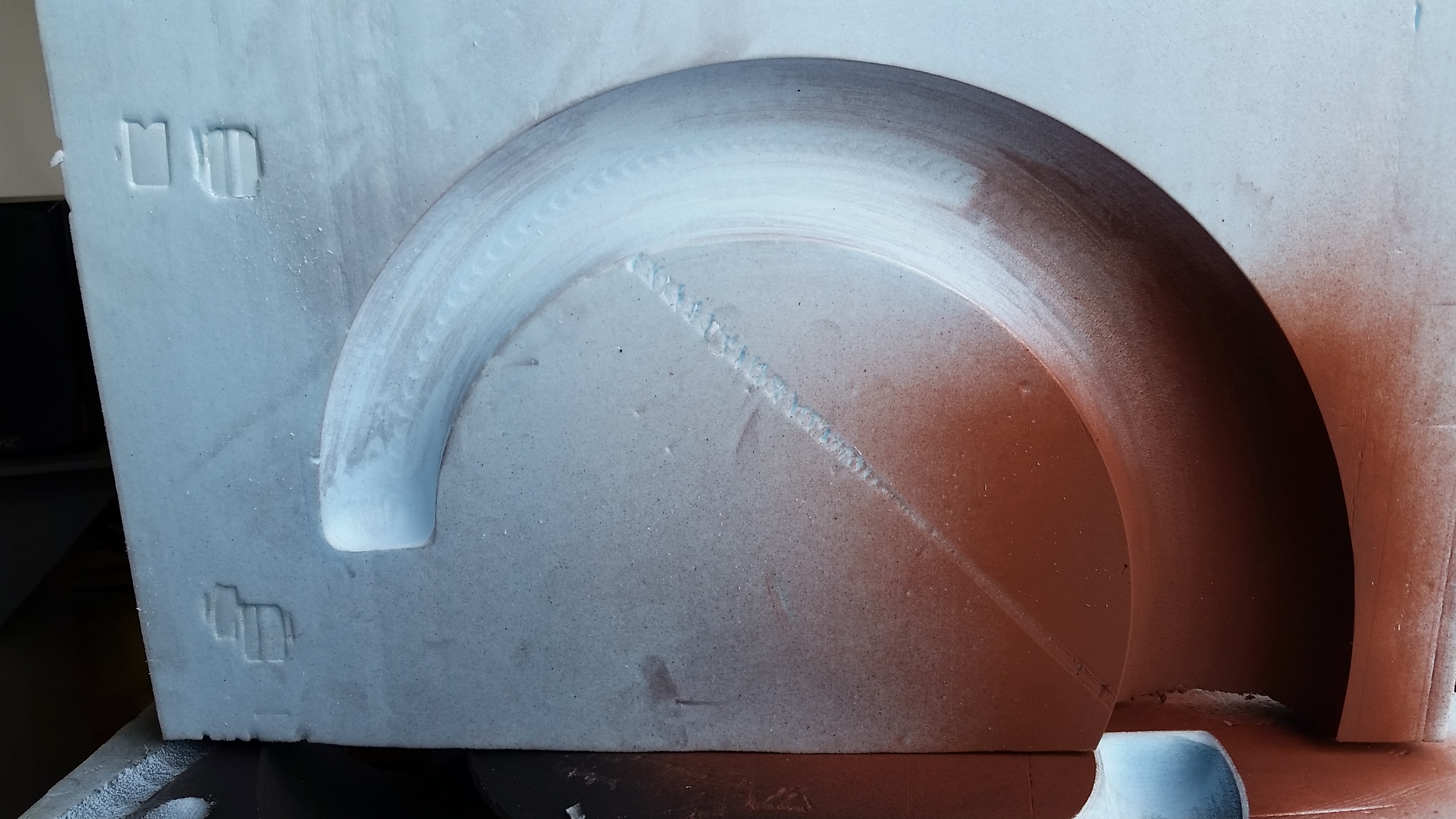

The foam is so soft that milling it to produce a smooth surface is a problem. Light sanding improves the surface but easily removes too much. In this case I ground/milled one sample with a spherical burr, the other with a mounted wheel dressed as a sphere. The dressed wheel produced a marginally better surface. Neither is as good as I'd like, but may need to suffice. Rustoleum improves the surface somewhat, but probably isn't worth the trouble. The 3D CAD horn model core is based upon the 14' horn dimensions in Modern Gramophones and Electrical reproducers. If this were to work out well enough, I'd add the larger mouth completing the original MG&EP 68" diameter design. There is also the possibility of replacing the Orthophonic tonearm with a longer tonearm consistent with the original horn dimensions.

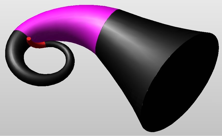

The image is of my latest thinking regarding milling a horn using the Wilson & Webb radii on page 100 in Modern Gramophones and Electrical Reproducers. The top layer is 60% transparent to show the lower layers of foam. The throat is 1.280" diameter to make up to an Orthophonic tonearm I have, and the mouth radius is 17.5". This horn is all but the last 2' of the W&W horn sound path dimensions. It appears that all but the bell shaped mouth can be milled from a single 4' X 8' X 2" sheet of insulation foam. I haven't been able to find Polyurethane foam at a reasonable price, though I'm still looking. I think I can dress the Kutzall burr to cut a cleaner surface, which may make the insulation foam milled surface acceptable. The key is to avoid sanding the milled surface as it is so easily damaged, even with gentle sanding. The mouth may be best done in the insulation foam as well, as this is a trial horn, and I don't want to spend money on materials for a prototype that may not succeed. 8 segments can make up the mouth section, which will require an additional ½ sheet of 2" foam. I'll need to keep my grandsons clear of the mouth, they'd have a great time poking fingernails into the foam.
The 2 contorted throat sections can be 3D printed. I may need to add a short 1.280" diameter flanged sleeve depending upon the vertical location of the platter. From what I've read though in W&W that may not adversely affect the sound.

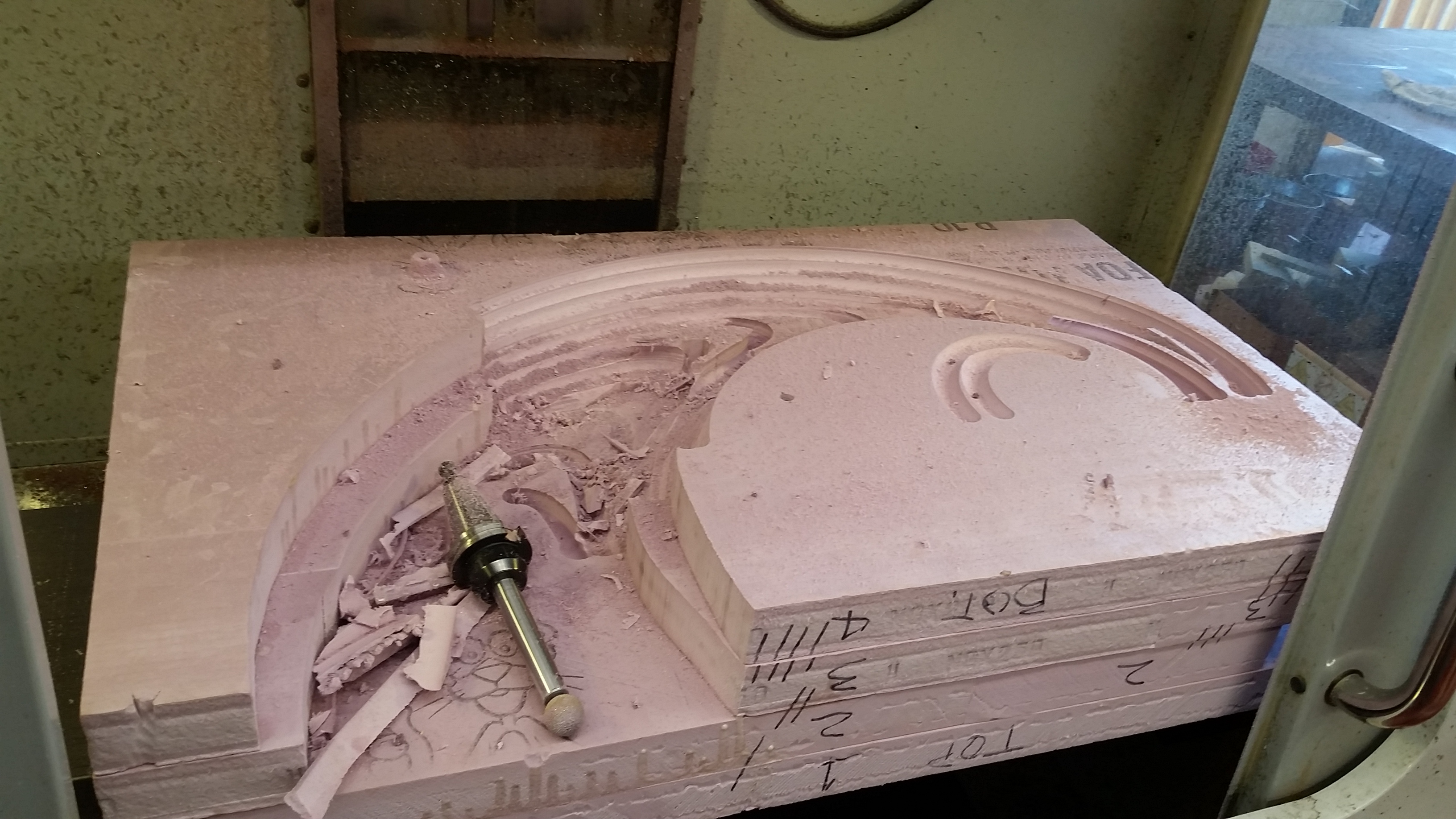

A little progress.
The first passes have a .5" change in depth, which was just to try the geometry and setup quickly. I'll redo the toolpaths with a .01- .05" dropdown (change in Z) for the finish passes.
The geometry will require 4 setups because the Haas milling area is 30" X 16" (X&Y), and the horn geometry is 42" X 24", were the blocks 1" more in Y, or a few more in X, there would not be sufficient travel insude the shroud. Fortunately the Haas has 21" of travel in Z, depending upon the tool length. Even with the extention, there is adequate travel in Z to accomodate the cutter, which requires a maximum depth of 7.75".
