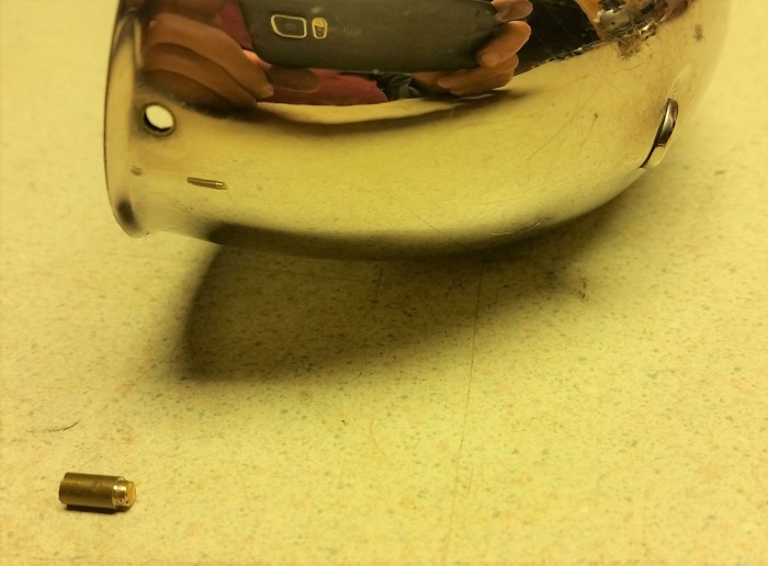

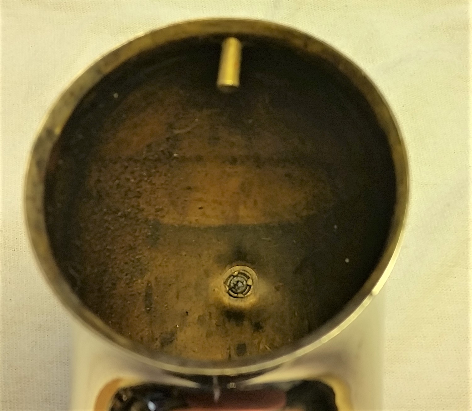

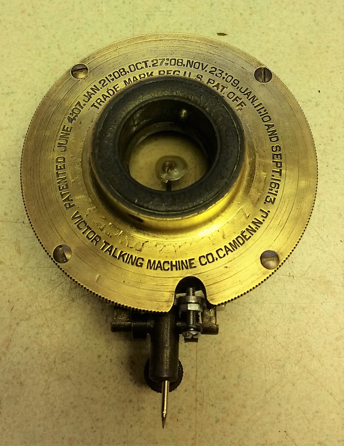

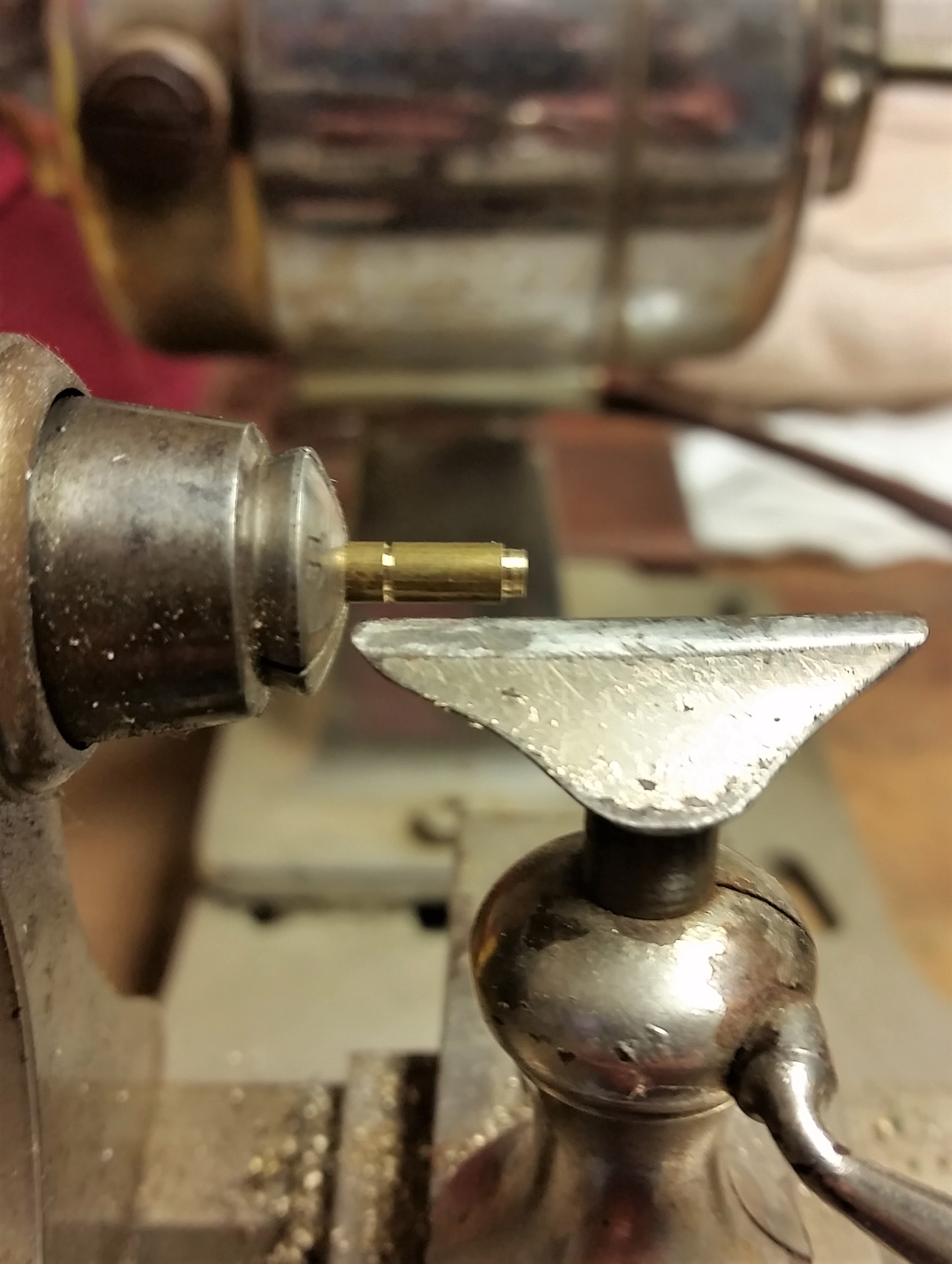

I got my parts for the reproducer rebuild, I first had to make a new tone arm pin, it was missing when I got the machine. I turned one out on my jewelers lathe and stacked it to the tone arm.

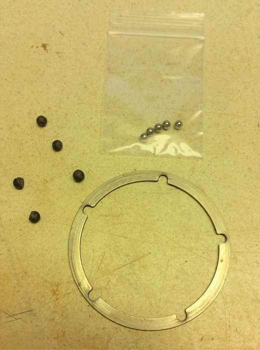

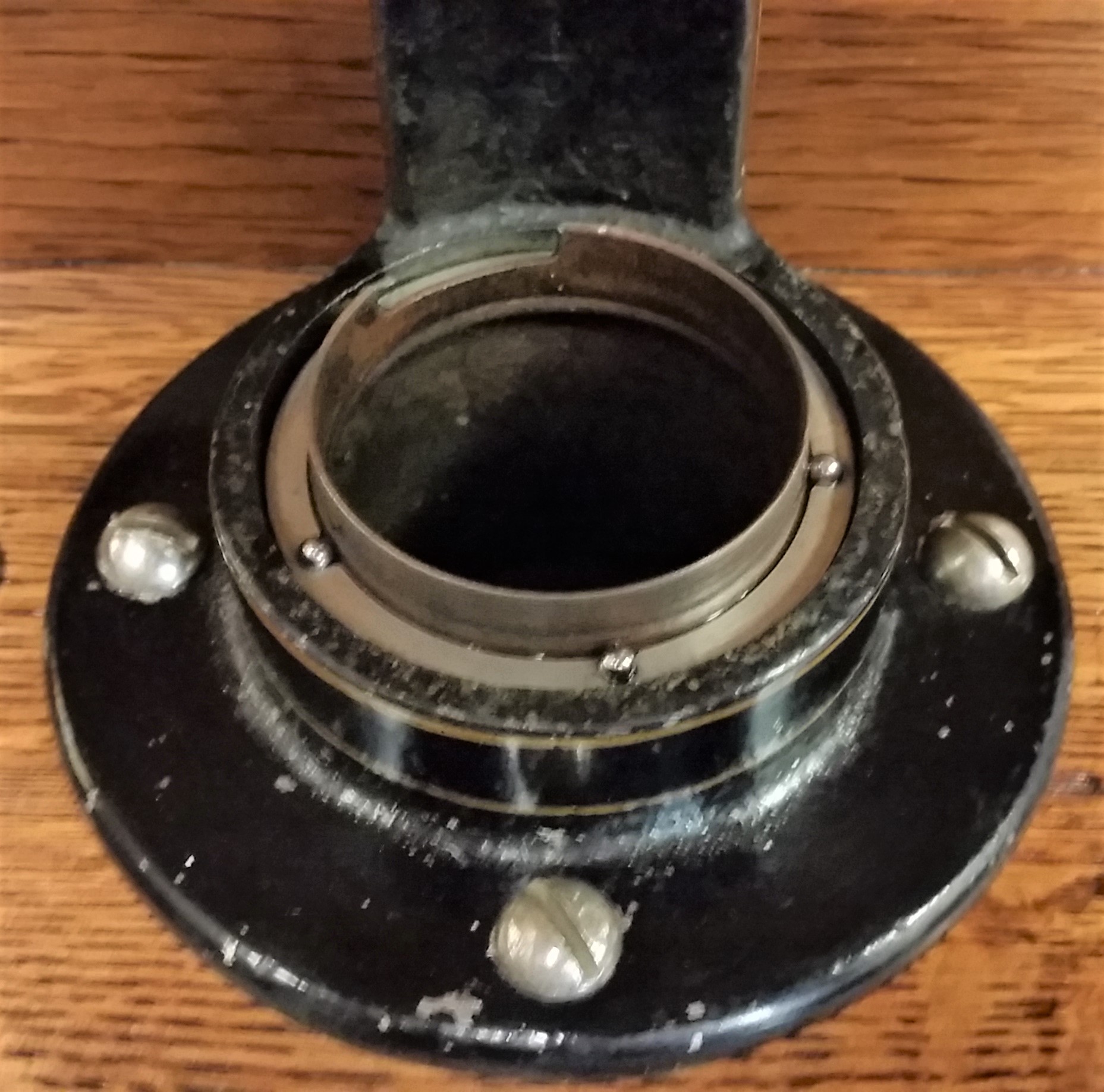

The machine had what looked like lead shot for bearings, I purchased new bearings. Installed them to the tone arm mount and oiled them. I polished the tone arm with MAAS ready to mount.

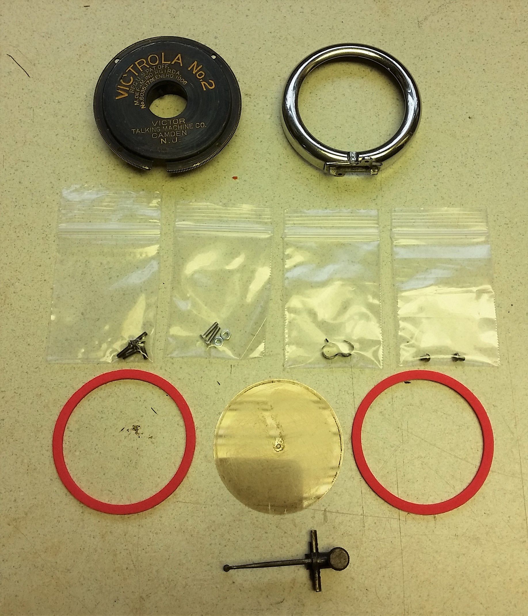

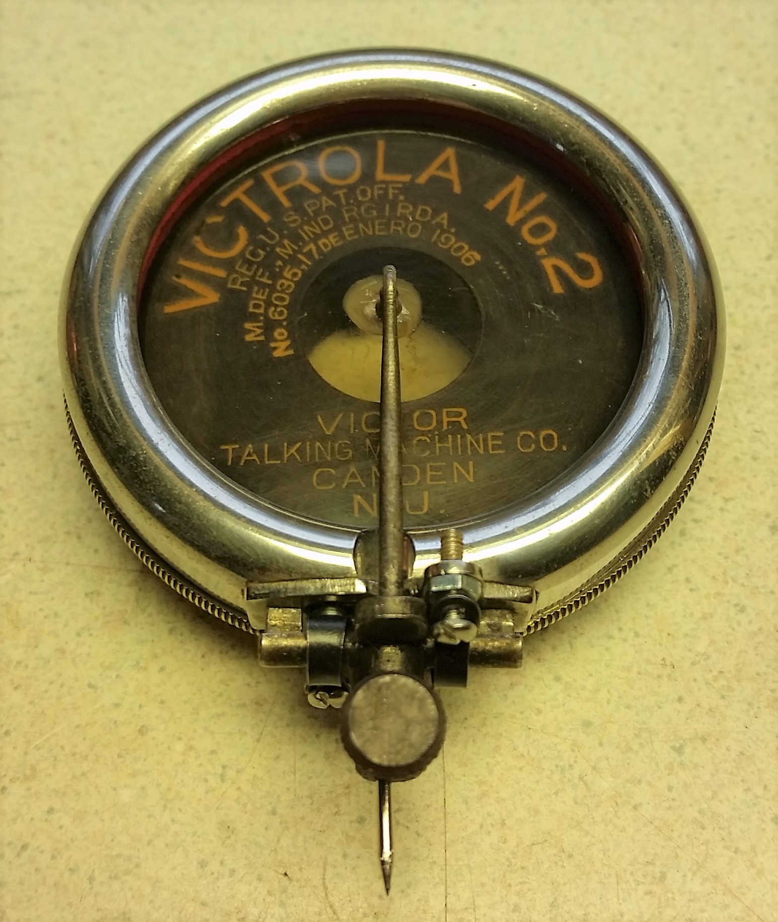

I purchased all new screws and springs for the reproducer. I polished the front case with MAAS and Brasso on the back plate. I also cleaned the needle arm.

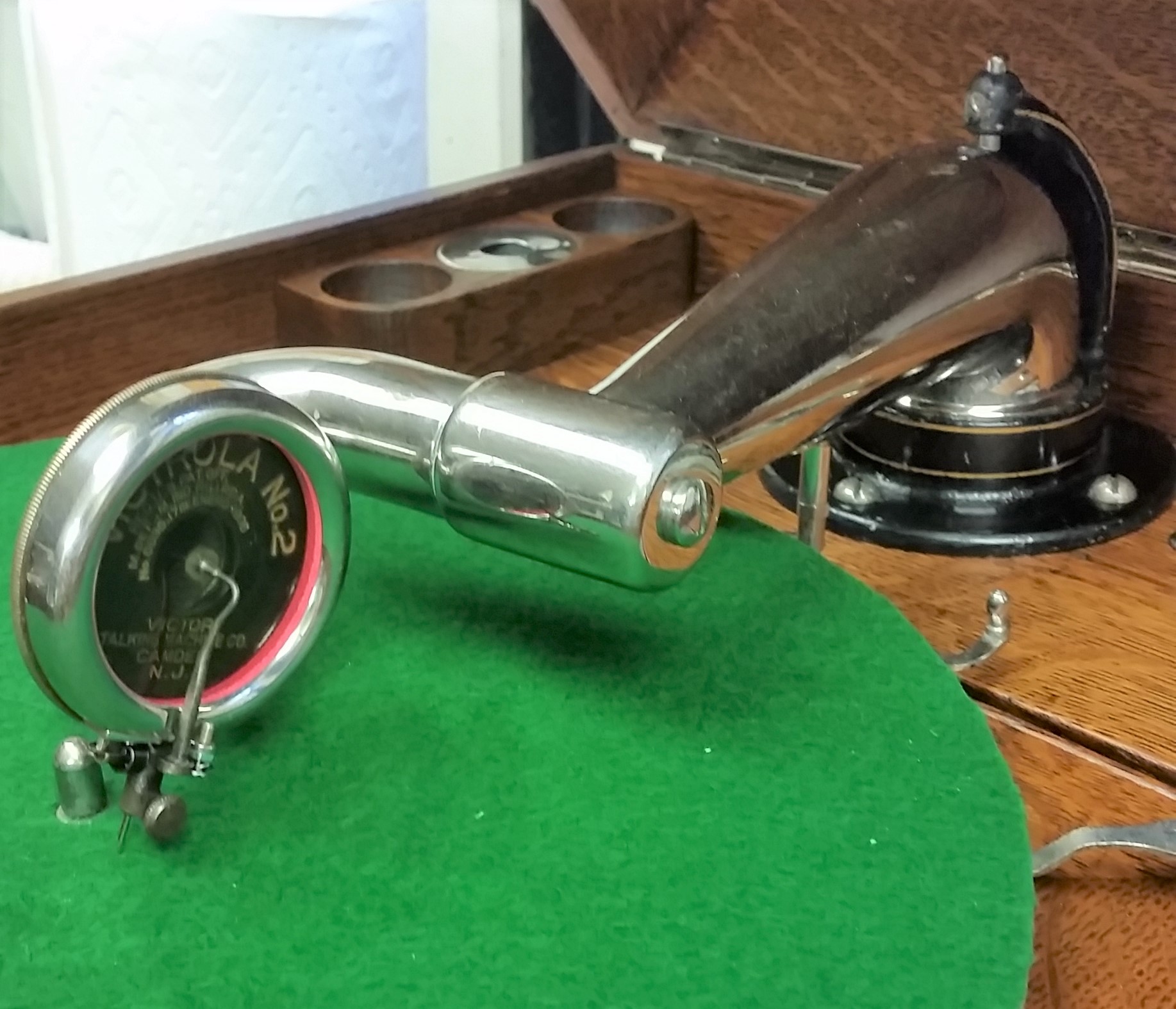

After rebuilding the reproduce I was ready to install it on the tonearm.
Looked good at this point. I wound up the machine and played my first disc. It sounded really good. Then the second disc started to slow down at the end of the disc. Hum, that is not good. Wound up the machine again and just let it spin. Crap it got slower on the RPM real fast. Then it came to a grinding halt! I just hung my head and voiced things that could get me kicked off this sight and that my grandkids should not hear. I am going to need motor gears for sure. How do I go about getting replacements? I think I need the spring drum drive gear and also the drive gear for the governor. Not feeling to proud of my rebuild right now.

Great job so far. I am convinced you'll get the motor issues figured out as well, no worries.
Just FYI: the backplate of the #2 reproducer should not be polished to blank brass, but rather should be black. No big deal, you can easily blacken it again with liver of sulfur or similar concoctions. Probably happened to most of us at some point when we got too eager cleaning up. It sure has happened to me in the past :oops:

Thanks alang, I did not know that, it was not black at the start but I could see that it was brass. So naturally I thought it should be polished brass. My mistake so I will use your suggestion to get it back to what it should be. I guess it is just the clock guy in me to think it should be polished. If I would have known that it would of saved me an hour or so that I took to polish it.
