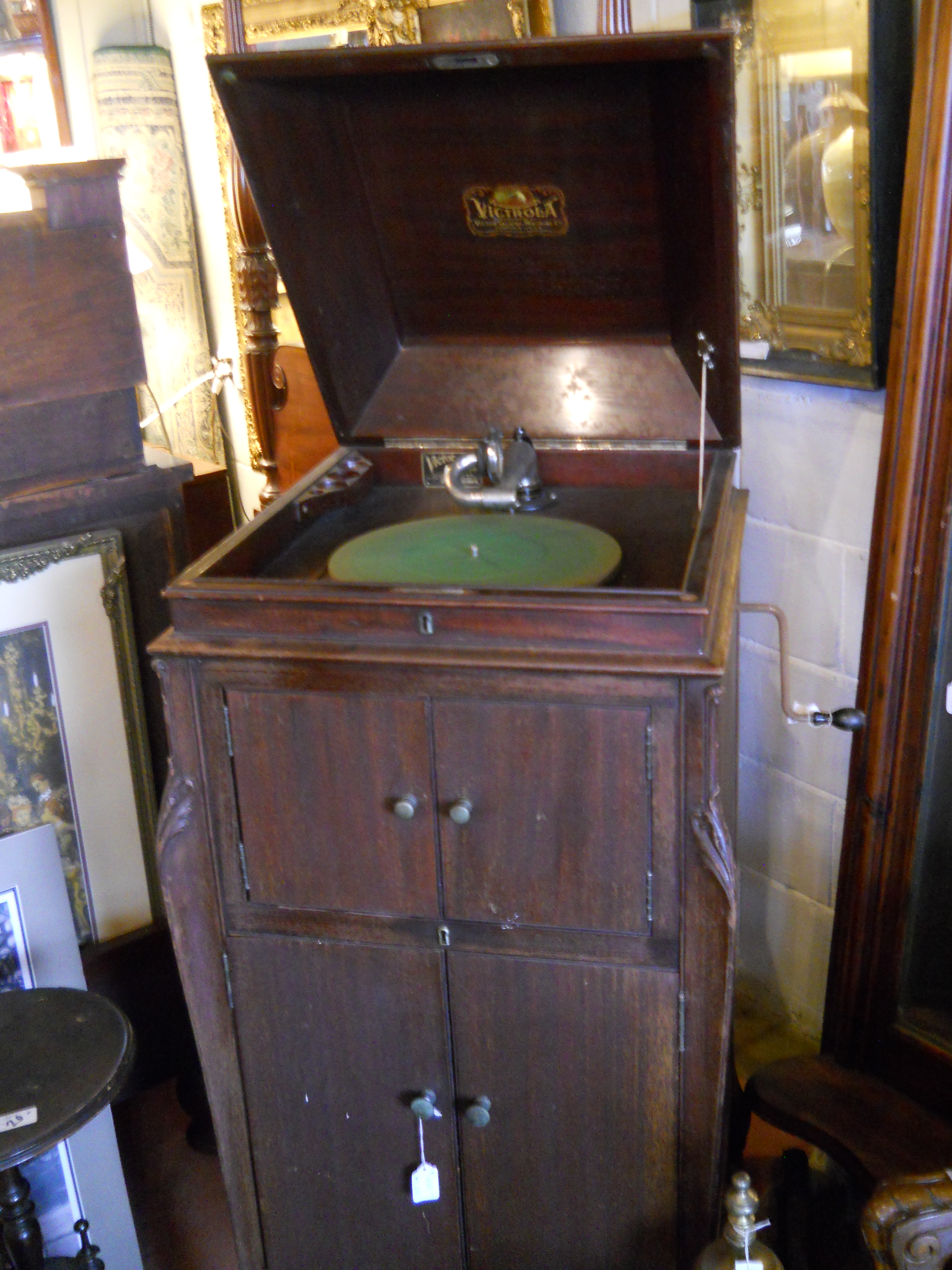

I'm still not precisely sure if I want to strip the inside. I'll certainly fill the holes, but the paint seems to have been applied early in it's life. It doesn't detract from the value of the machine afaik, and, well, I'm not sure how much I want to be working with lead based paint.

If you're worried about lead paint, antiques might not be your best choice for a hobby. But seriously, regarding potential lead paint, wear a respirator & gloves when working with it and you'll be just fine. Should do that anyway when you are working with paint stripper. If you ever fired a gun you've turned loose a lot more lead than is in that bit of paint, and if you've ever cleaned your own gun then you've been exposed to the same. Lead is manageable. Take good quality paint stripper, disassemble the case, and follow the directions on the tin (including the use of a brass brush going with the grain.)
Now--What I would suggest is slow down on both your purchasing and your posting, and get busy. These won't restore themselves, just like (as you may detect by now) they won't pack & transport themselves either.
Listen to the guys who have suggested taking that box apart--when it's apart you can do a good job on that one panel and then it should all fit back together very well.
If you'd read these threads & links, get a hint of what's what, and go down to the hardware store and try some of the furniture products there, I bet you'd get this moving right along. Most neighborhood hardware stores will have what you want.

Use your head, think outside the box. I found that scraping old shellac finishes worked better than stripping them--I also have a vintage safety-razor as well, and the blades look just like paint scrapers. So I scraped the finishes & got the wood ready to sand & paint without chemical stripper, on some machines.
And for heaven's sake get on with it. When I was sixteen I bought this--
And I made it look like this. Yes, that is the original finish. The back panel was missing so I bought a replacement painted in white oilbase. The whole motor was junked, everything that could go wrong had, and the veneer was curling badly--now it's done & ready to use, and so I did put it to use. Six years later it's still working.
All this was done with stuff from the local hardware store. I later went through & changed from 3-in-One Oil to sewing-machine oil, upgraded my skill and redid the governor, did a better job adjusting the reproducer--now I've got a nice enough Victrola. You know what? They most certainly do not restore themselves, and the only way to get good at it is to start turning wrenches. Next time that you post I'm hoping you can get the bottom off that Fireside and start working on the paint--or at least go to a hardware store, or have a rummage in the garage, and get some supplies.
Now go get restoring before this thing rots to dust with everyone sitting around talking about it.

How do you know it's lead based?gunnarthefeisty wrote: Mon Oct 18, 2021 10:36 pm I'm not sure how much I want to be working with lead based paint.
Besides, using stripper on the paint will prevent any inhalation of paint dust/lead. How is the lead going to enter your body?? Nothing to worry about. (For that matter, I wouldn't let it worry me anyway.)
If you're still concerned, just paint it again with flat black. Still not correct, but much less glaring.

yeah, I'll strip it. I think I might give it a shellac coat after I've stripped it so it looks decent inside. I assume it's lead based, but I don't have any proof. I'll start on this when I finish my Victor. The nice thing about this is mechanically it's fully restored, so the case is all I have to worry about.

There was no reason to put lead in aluminum paint. It would have been white or "red" if it was lead based paint. They may have used a little bit of heavy metals for a drier, but that would have been it and unlikely. For whatever reason aluminum paint got to be really popular in the late 20's for a sealer. I refinished a mahogany Amberola 1-A a few years ago that had been completely covered in aluminum paint. The guy that bought it new thought that was a good look for it in the mid thirties. It was a mess, but it actually cleaned up pretty nicely. I think those cabinets are fairly ugly with that lyre grill, but they do look much better with a decent finish on them. Unfortunately, they have removed the methylene chloride from the paint removers in the last few years, so it's going to be hard to remove some of the more stubborn finishes that are out there. And MUCH more expensive. I bought some lacquer thinner this weekend and it was $11 more than it was a month or 5 weeks ago. So there is that as well.

thanks for the information! Nice to hear there's no lead, and I think the finish was done a while ago. My dad or grandpa probably have paint thinner somewhere. I'm intending to make this my main player. I'll be buying a model O reproducer and a fireside horn once I can afford it.EarlH wrote: Tue Oct 19, 2021 8:36 pm There was no reason to put lead in aluminum paint. It would have been white or "red" if it was lead based paint. They may have used a little bit of heavy metals for a drier, but that would have been it and unlikely. For whatever reason aluminum paint got to be really popular in the late 20's for a sealer. I refinished a mahogany Amberola 1-A a few years ago that had been completely covered in aluminum paint. The guy that bought it new thought that was a good look for it in the mid thirties. It was a mess, but it actually cleaned up pretty nicely. I think those cabinets are fairly ugly with that lyre grill, but they do look much better with a decent finish on them. Unfortunately, they have removed the methylene chloride from the paint removers in the last few years, so it's going to be hard to remove some of the more stubborn finishes that are out there. And MUCH more expensive. I bought some lacquer thinner this weekend and it was $11 more than it was a month or 5 weeks ago. So there is that as well.
