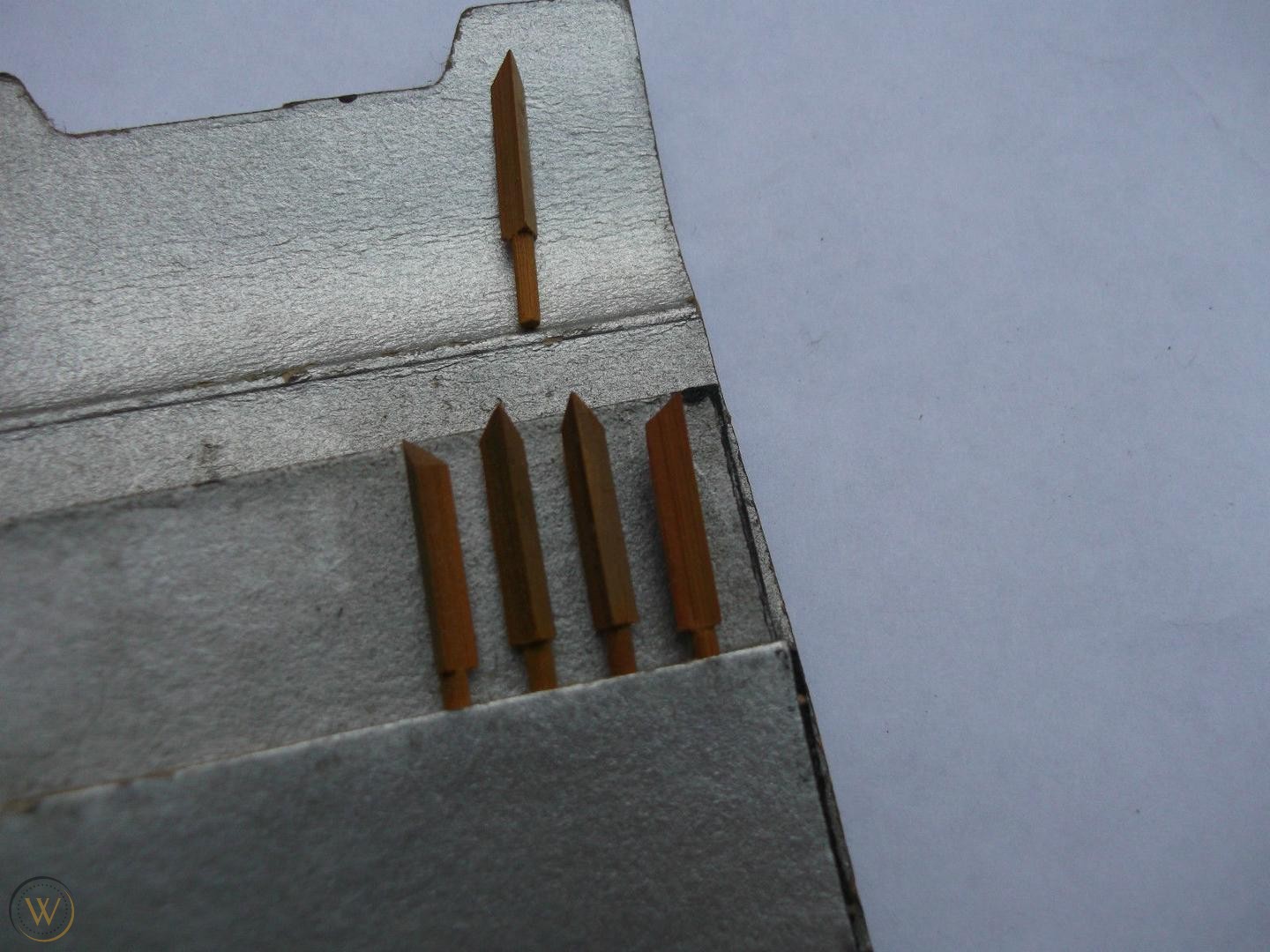

Yes, it's not difficult. With a blade cutter you can cut out the triangular peaks into a thin cylinder, from the mid of the needle up to the upper end, so then it fits into the round holder. These are the hmv example
