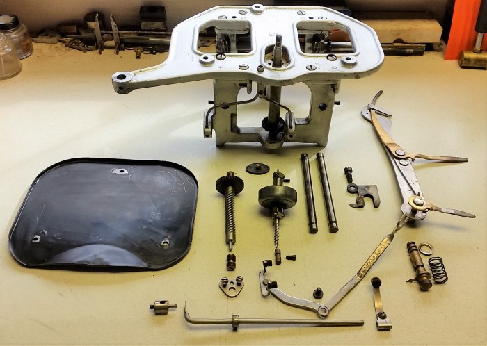

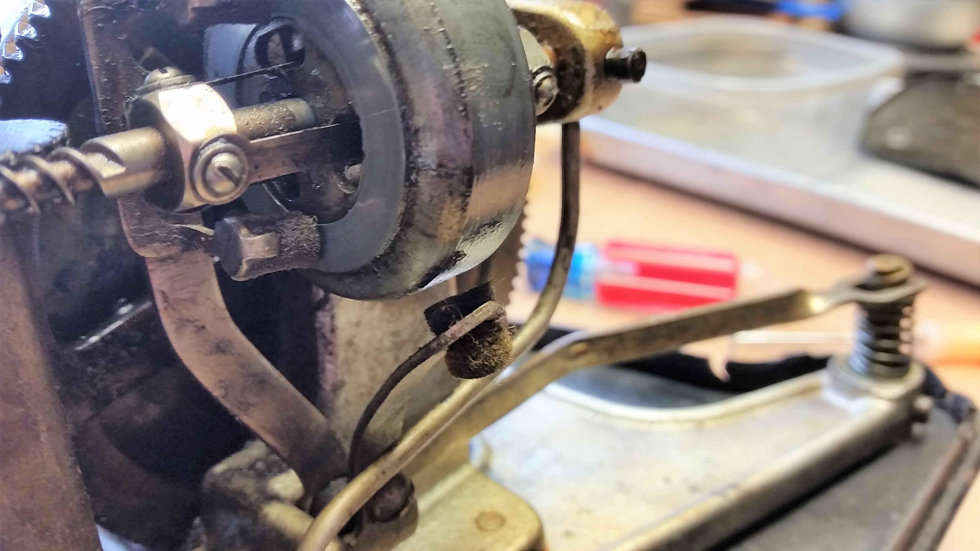

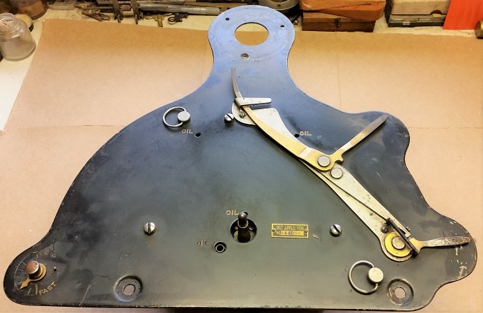

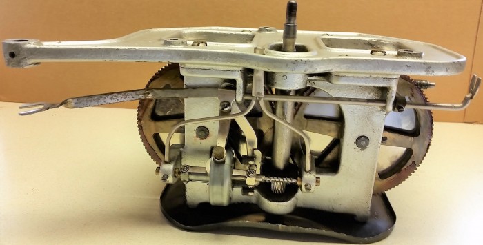

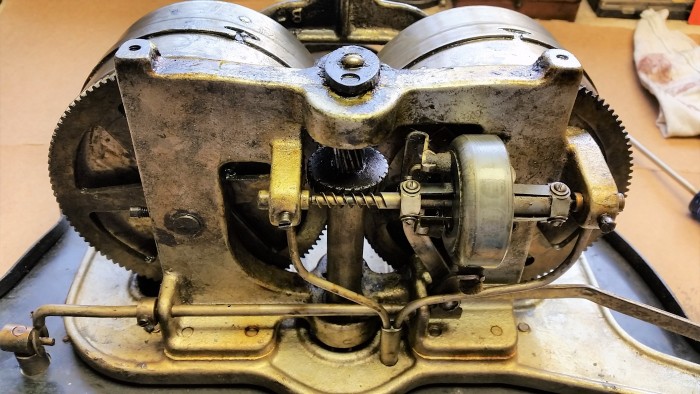

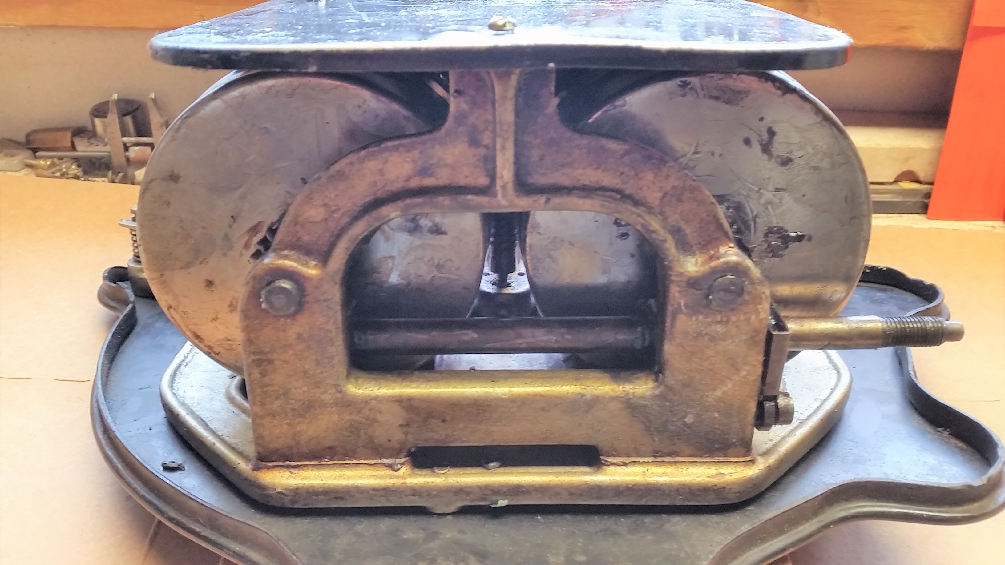

I started on the motor restore, man is this thing heavy. It has a stamped steel bed plate, large multi-part cast frame with 4 springs 2 drum drive. The drums rotate and wind in opposite directions off of the winding shaft. The spring drums drive a main worm shaft from both sides at the same time. The main shaft has a fiber gear that drives the spindle shaft. The spindle shaft has a fiber gear that drives the worm shaft of the governor. The governor has a drum that houses the weights and springs with speed control off the face of the drum and the brake that runs off of the outside edge of the drum.
In my opinion this is one of the best designs I have seen to date, (not saying much I have only done 6 motors and all of them have been different). It has 4 oil points from the top of the bedplate like Edison's. One that oils both ends of the governor through tubes to the ball bearing bushings. One that oils the main spring drive shaft and the spindle shaft through the frame casting. One oil point for the left spring side of the winding shaft through the casting. One oil point for the right spring side of the winding shaft through the casting. The only grease points are the winding gear of the spring drums and the drive gear to worm of the shafts. Dual fiber gears make it very quite while running.

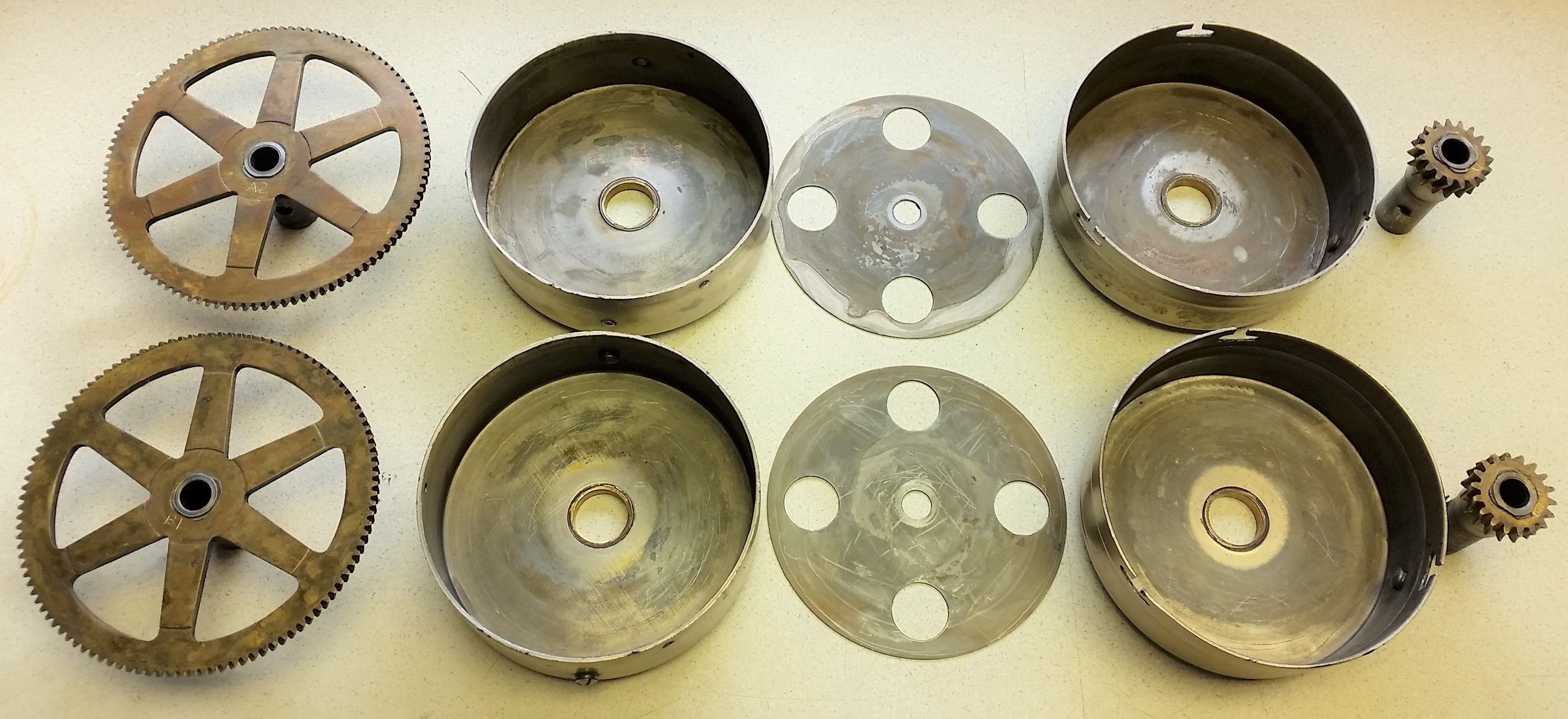

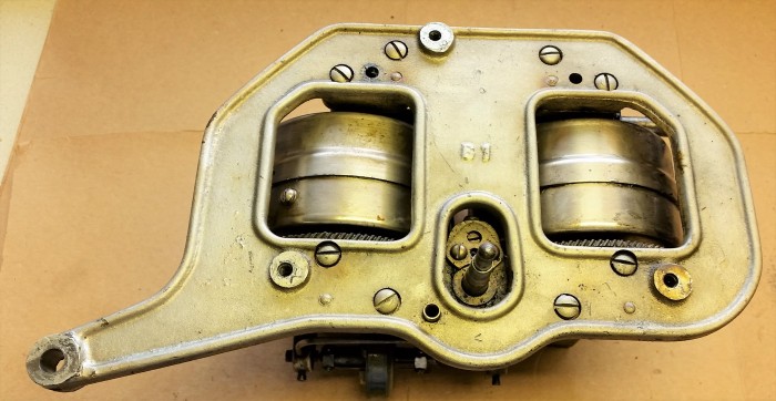

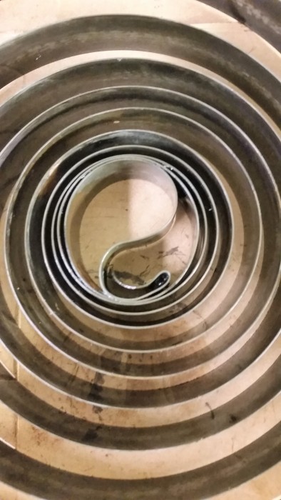

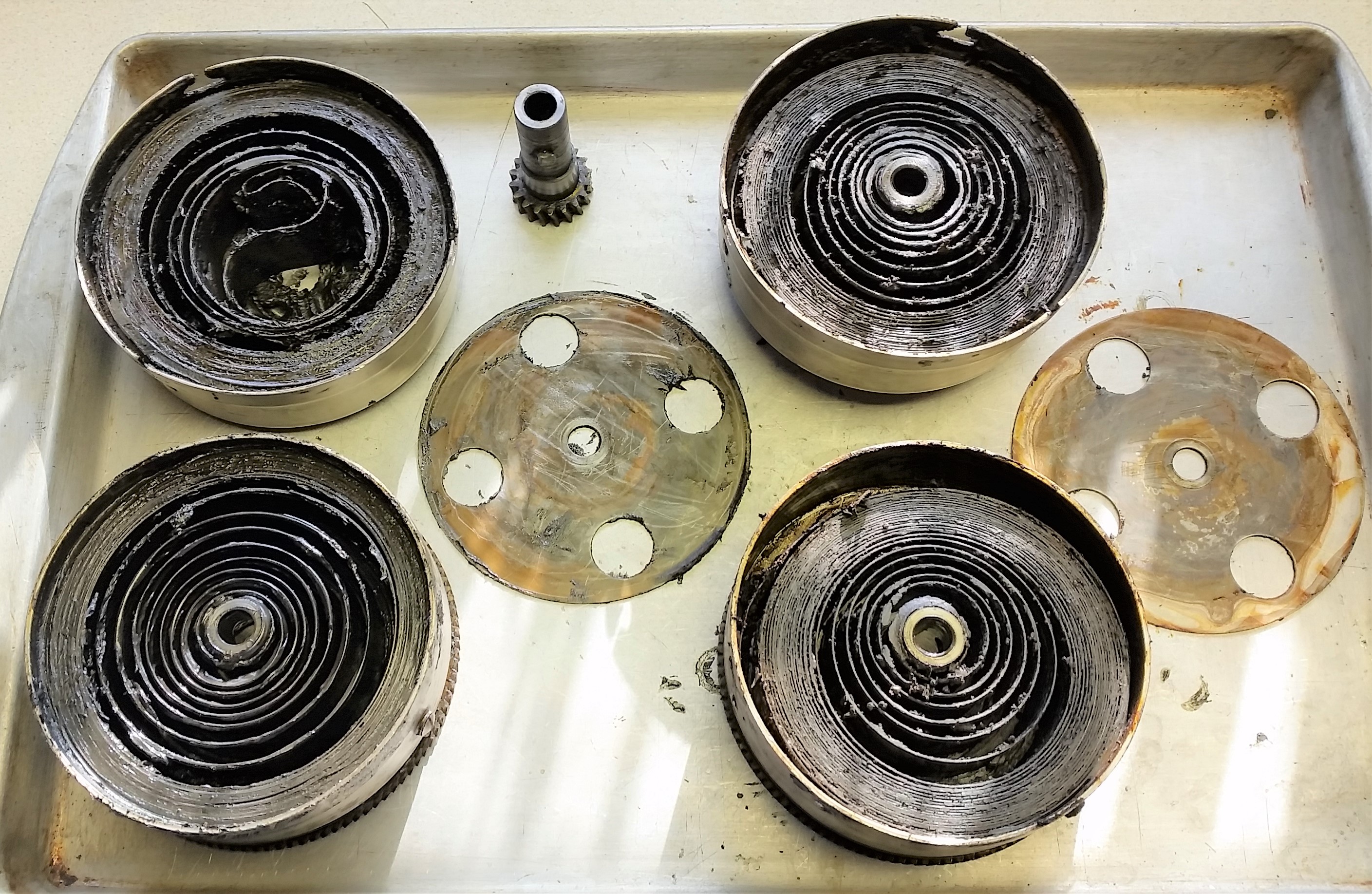

I broke the motor down, the usual muk these motors tend to have. Cracked open the spring drums after marking each gear and drum because it would be every easy to reassemble them back incorrectly with the drums rotating in opposite directions. First thing I found was that at some point someone installed the left upper drum spring in the pic the opposite direction that it needed to be. The main shaft bent the spring around backwards. This spring was dead as soon as they wound up the machine. The machine still would run because of the other drum. Always mark spring direction before ever removing one from a drum. I take a scribe and make an arrow at the drum spring stud on the outside of the drum in the direction the spring needs to be installed. The right side drum springs had completely dried up rock hard. I am very surprised That I got the machine to play at all when I brought it home.
I cleaned the drums and gears inspecting each piece for wear down to the gear teeth.
I cleaned all of the pieces of the motor down to each tooth of each gear and worm. Tooth picks come in handy for the gear tooth cleaning.

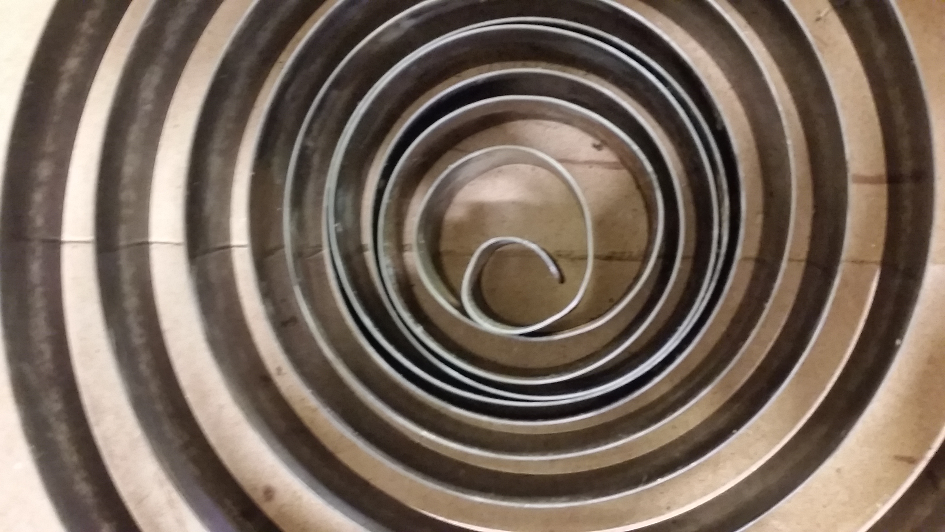

Now to spring cleaning and repair. The left drum with the dead spring was easy as it had not moved in no telling how long. The graphite was still pliable and easy to remove. The right side the graphite was hard as a rock and would have to be scraped or chipped off of the spring. Am not going to do that so I would need to soak them in some kind of solvent to loosen up the crud. Any solvent will do, acetone, paint thinner, kerosene, gasoline. Just so happened I have about 2 gallons of outboard gas that I would have to throw away by next fishing season. Worked like a charm. I took a oil change pan filled it up and put the springs in it over night. Cleaned up nice and puts a little oil film on the springs until I grease them at reinstall.
Spring shaping, because the spring ends are annealed, (Soft and untempered for about 4 inches on each end they can be bent back into shape. I slowly started to reverse the spring end back the other way to be able to install the spring in the correct direction.
I reinstalled the springs, assembled the motor back together. I am not going into details because it was pretty straight forward. No gear backlash adjustments, just shaft endplay. I am working on the motor plate cleanup and details before installing into the machine.
