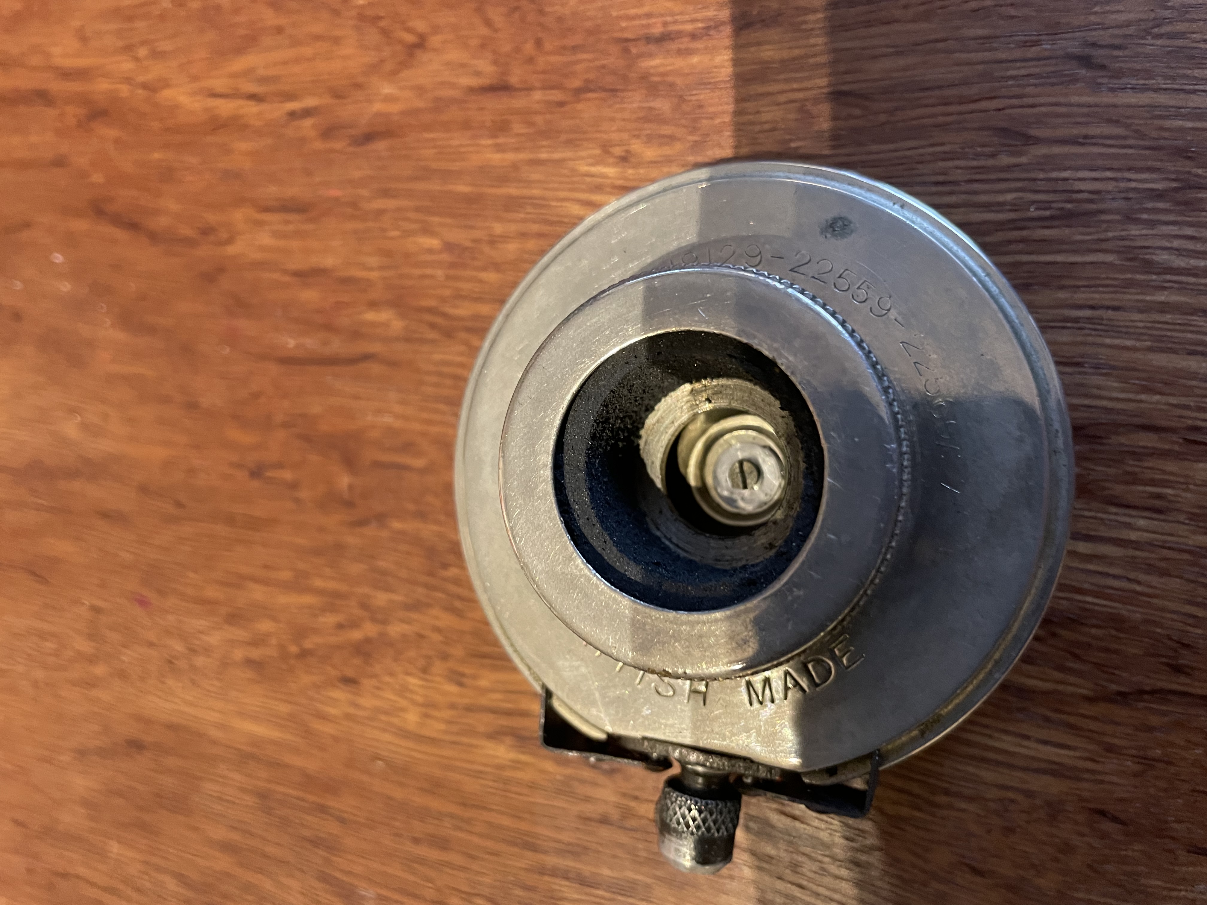

Following the comment re attaching the needle bar to the diaphragm, this example when I got it had a piece of flat metal acting as the diaphragm for some reason.
I had an old screw connecting needle bar so cut the old non screw end of the Meltrope needle bar off and soldered the screw fit on.
Not sure if the metal washers add any value acoustically, or if they were there as part of the original way of fixing to the diaphragm, but I added one either side just in case. It MAY help the piston action of the diaphragm providing an element of extra rigidity to the centre or not.
This also has a new made diaphragm and sounds pretty good (I’ve found that all Meltrope IIs sound slightly difference anyway).

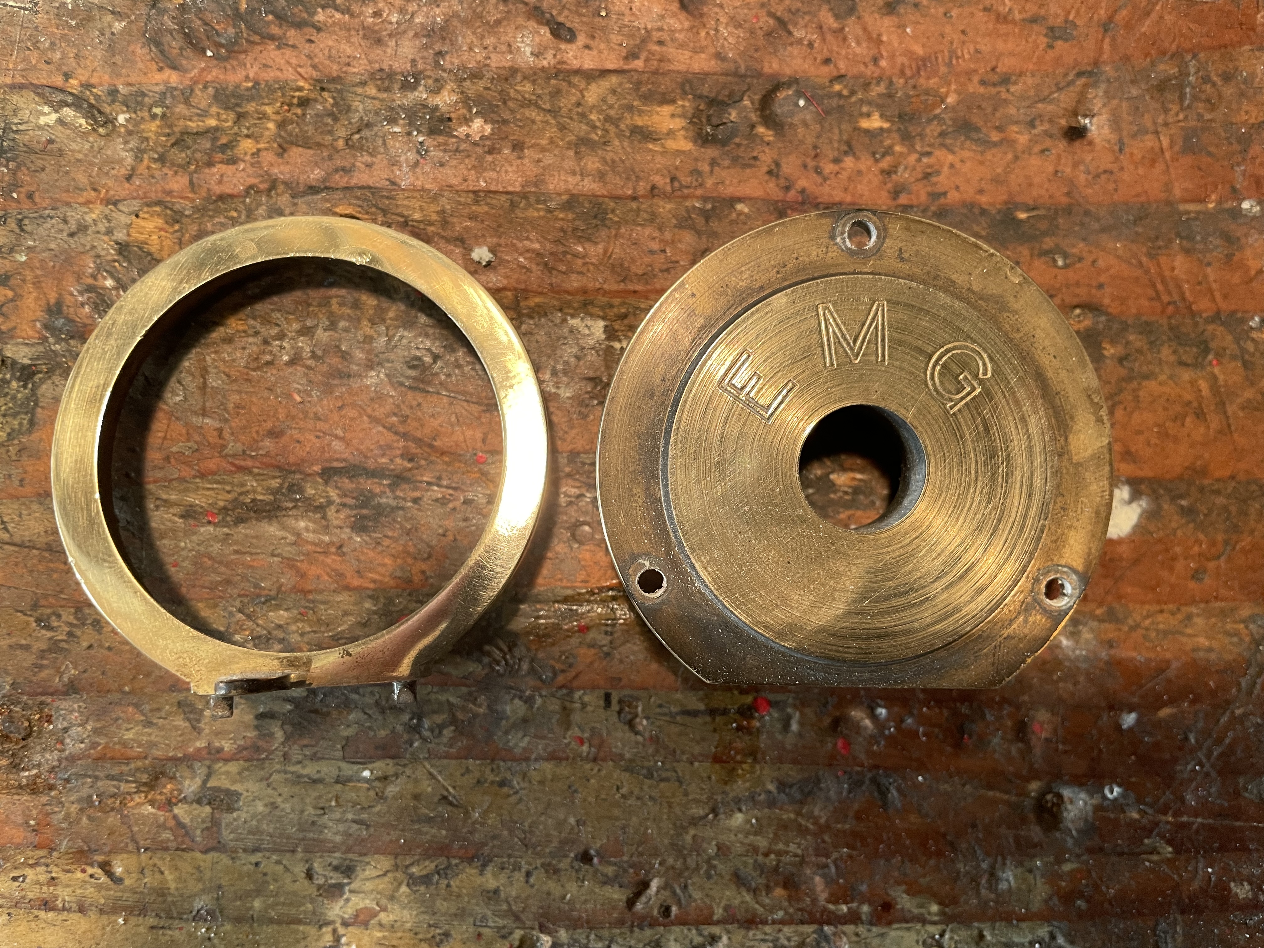

The EMG soundbox I have is more or less the same as an Exhibition, well, a brass fronted one anyway. I think it’s quite early though. It’s definitely EMG as the backplate has EMG engraved on it but it’s obscured by the diaphragm. I’m starting to think it was a conversion from a mica diaphragm.anchorman wrote: Sun Oct 30, 2022 6:26 pm I think the issue with side to side movement is why EMG and expert used steel points rather than the knife edge Victor used on the exhibitions. My one day plans to make a soundbox of that style include using small tungsten carbide points set into the body of the reproducer to act as fulcrums for the needle bar. Done right into appropriately shaped indents in the needle bar, it ought to hold correctly with little pressure and not be too inclined to rattle about.
It has the knife edges but there is no lateral movement. There are however two grooves where the spring tips sit on the bottom of the needle bar.
It does sound quite good but again the small diameter does I think mean it doesn’t perform as well as it could.

The common EMG design does not have lateral constraint on the needle holder platform--merely the two knife edges locating in two fine grooves. This is not generally a problem and works very well. However, some did have just one groove and one point to completely eliminate the possibility of sideways movement. Personally, I prefer the two groove design which affords more tuning options.
