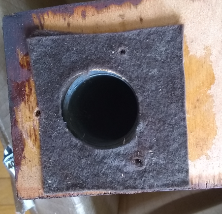

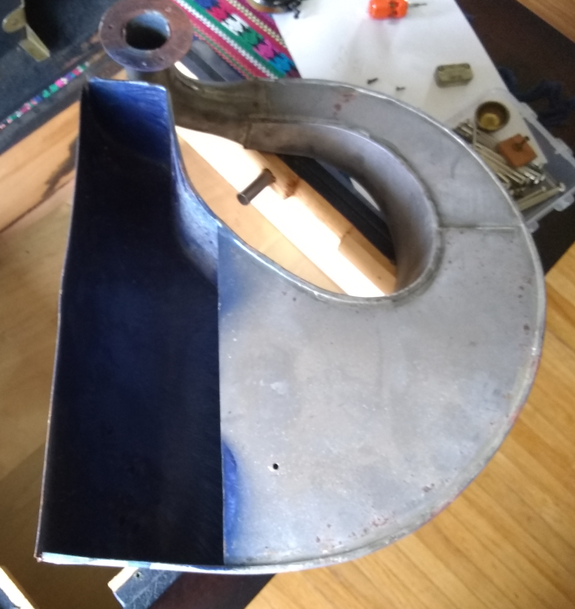

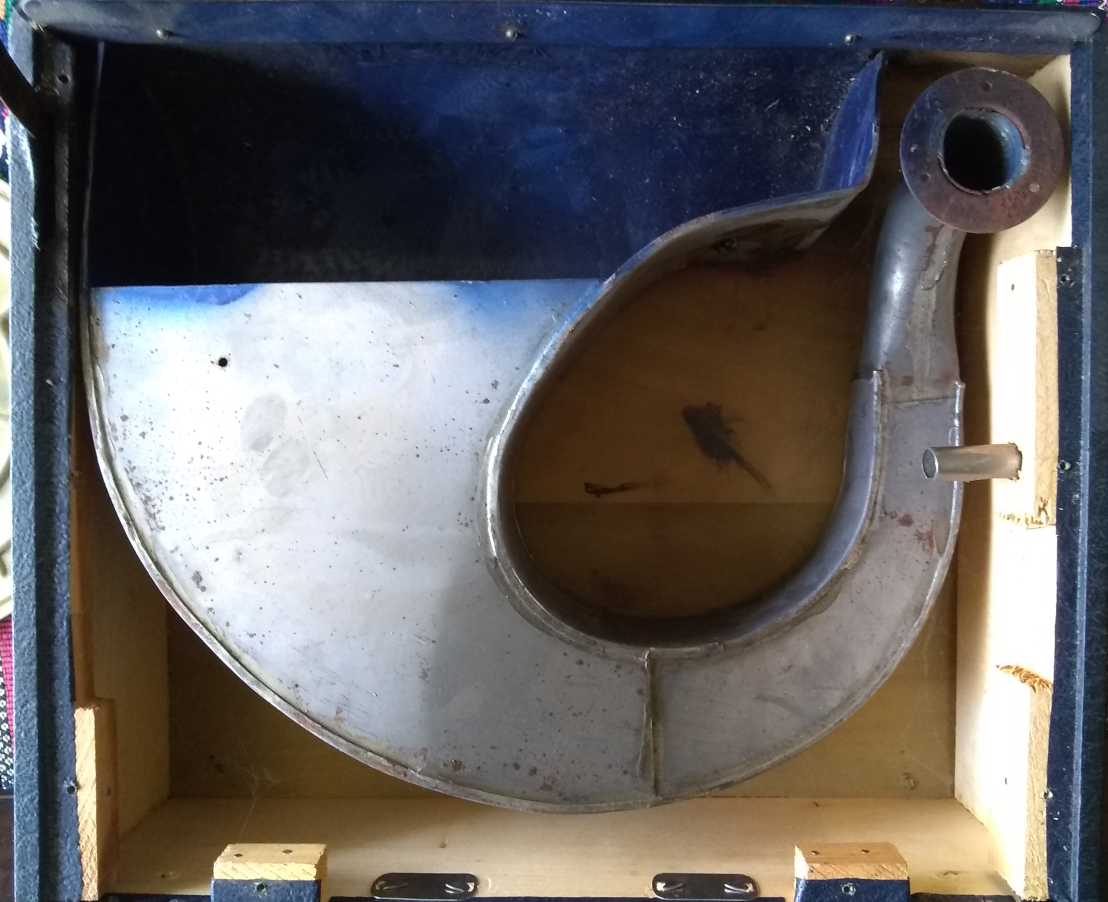

Inside the Case: Horn
The horn is solid steel that wraps right around the case. The seal between the base of the tone arm and the horn is just a piece of brown felt which probably does not do a very good job of sealing. The input of the horn is lower than the supports for the motorboard, and the felt is not nearly thick enough to bridge the gap between the tone arm and the horn. This should probably be amended.
The bottom of the motorboard is devoid of any interesting features other than the motor and the felt seal mentioned above. The motorboard plywood is a bit too thin for its purpose, and so it sags a bit from the weight of the motor.

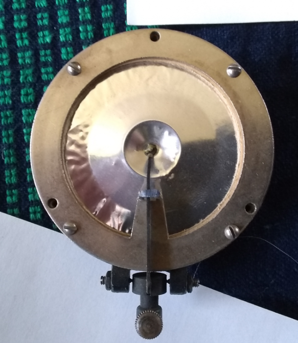

Reproducer without Guard
The diaphragm appears to be metal. The rubber gasket/bushing material in the socket for the tone arm reached its best before date a long time ago.

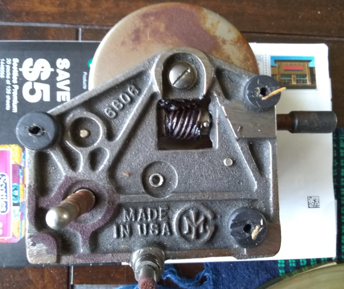

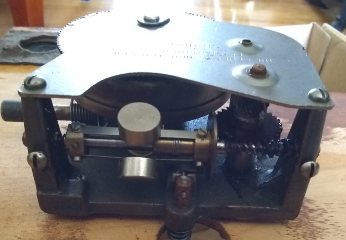

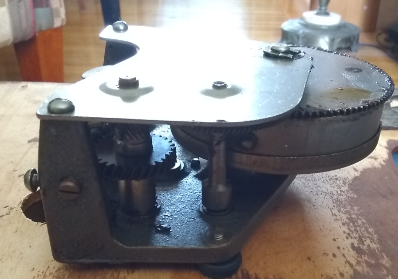

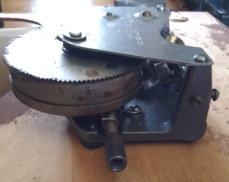

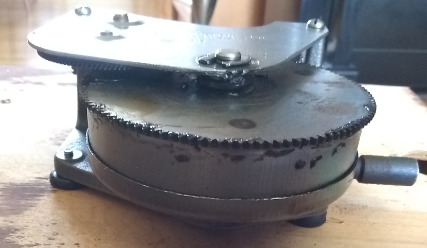

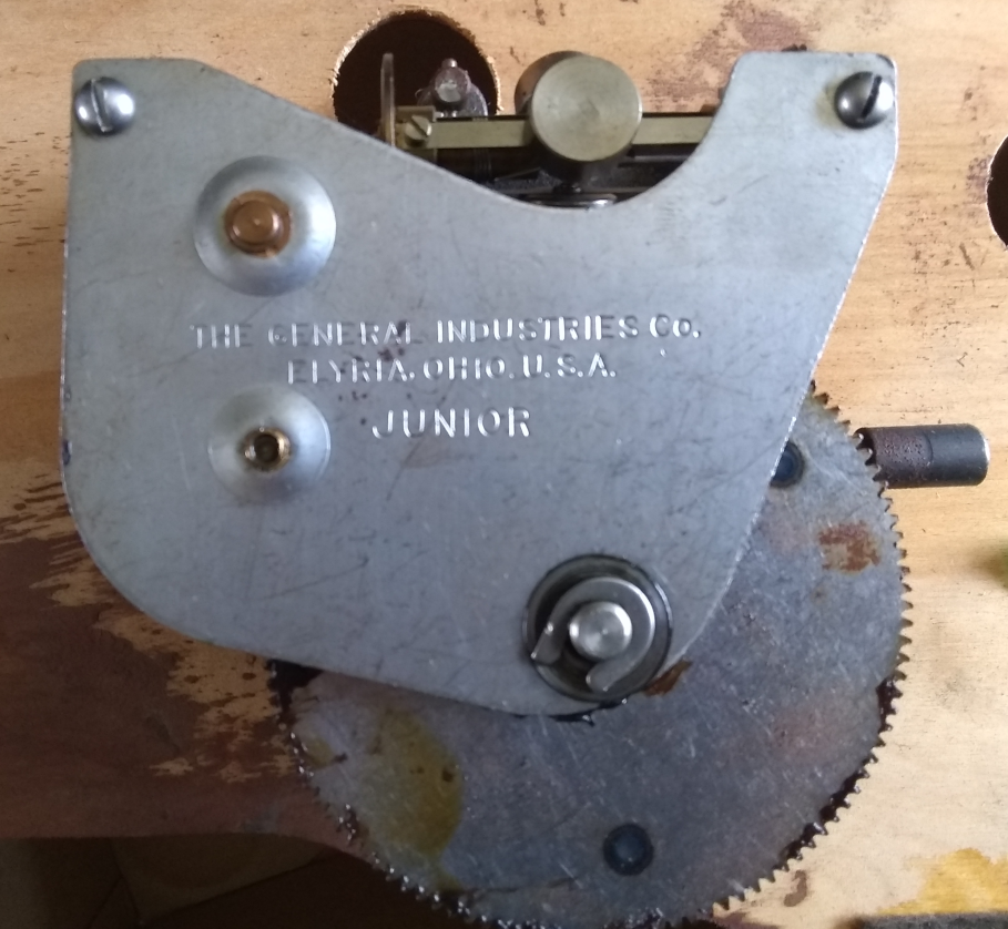

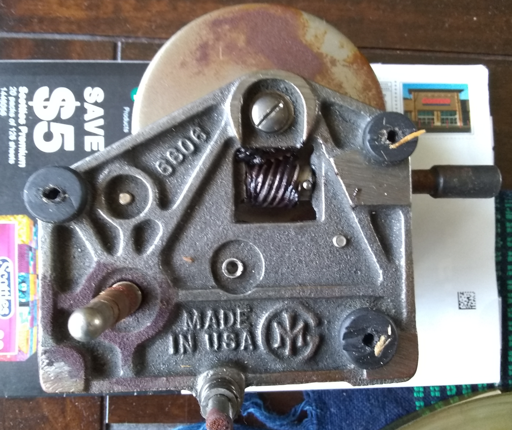

The Motor
The motor is a General Industries, single spring Junior. It appears to have been lubricated entirely with a black grease which has become a bit waxy/gummy but is still somewhat serviceable, at least as far as the coarser gears are concerned. It seems too heavy for the governor worm gear, though. Whatever is in the spring housing, away from the air, is probably still OK. The spring does not stick and makes no noise winding or unwinding. I will clean it up and re-lube it. I don't think I will bother with the spring for the moment, too much disassembly for something that doesn't seem to be presenting any problem.

Just got fun, my impressions and 2 cents...
The horn is magnific, very similar to that of the famous hmv102, but the mouth seems larger. It surely give a pretty loud warm full sound. Great!
The joint with the tonearm... If you're going to substitute the former pins that fixed the tonearm base with suitable bolts and nuts, you'll be able to put pressure on the joint and seal it perfectly. The brown felt you probably could add another layer, cut from fresh new similar felt to ensure the airtightness. In these joints I usually add some grease to impregnate the felt and make a better seal, butt probably it would not be necessary. If properly pressed, these joints are airtight enough.
The motor looks robust and powerful. I never had one of these (not sold here) but our American colleagues have a very good opinion about the General Industries products. It seems very well done. I would disassemble, clean and properly regrease the gears, then soft good oil on the governor bearings and the sliding sleeve, and you'll get it running soft and strong. The removing of old grease and cleaning, though, could make it more noisy of the gears area but worn. This is typical. Old gummy grease hides out the imperfections and makes it sluggish (bad) but silent (good), so it's up to you. Besides that, the gears imperfections are accommodated, and when you remove the gears and reassemble them, you'll never get them exactly in the same positions they were before. But freshly greased, it will gain power.
I'm inclined as you in not touching the spring if it runs well. You can do it later. Maybe only open the barrel and drop some oil in it, to soften a bit the old grease... But this is not very correct, as per experts... Some of these greases are very good and still are fresh. I had a Columbia motor and another Aeolian, that are still with their original (?) spring grease. I saw it so good, that I only added some oil (only a bit) and let them alone. They work like champions.
The soundbox seems also very good. The pivot system for the needlebar is good. If it has no side play, I would let it alone, only a drop of oil at each pivot, no disassembling if it works. The neck rubber of better to be replaced with a supple new one. You can make it from a strip of suitable rubber sheet, forming a small cylinder. It's a bit of trial and error until you get the right length so the joint between the edges gets the right pressure and is airtight. This is vital. You can also seal the joint with silicone or something to ensure no air pressure escapes, and all the sound energy goes into the tonearm.

Inigo wrote: Wed Apr 06, 2022 6:29 pm If you're going to substitute the former pins that fixed the tonearm base with suitable bolts and nuts, you'll be able to put pressure on the joint and seal it perfectly. The brown felt you probably could add another layer, cut from fresh new similar felt to ensure the airtightness. In these joints I usually add some grease to impregnate the felt and make a better seal, butt probably it would not be necessary. If properly pressed, these joints are airtight enough.
A light bulb just went on in my head.
There are three holes in the flange around the inlet for the horn. There are three corresponding holes in the motorboard. There were supposed to be three small wood screws securing the horn to the motorboard and forming a good seal with the flange. I found two of the missing screws, one in the case and one in the horn. There is also a hole for a screw in the horn near its mouth. A wood screw gores through the motorboard and horn and then into a small square of plywood that acts as sort of a nut. The horn is supposed to come out of the case with the motorboard and go back in with it as single unit. There is a metal strip, finished in the same colour and pattern as the inside the horn mouth (but without flocking), that runs along the back of the case and is screwed in to secure the horn. I don't think I can change the way the arm is mounted because I would not be able to put nuts on any screws because they would interfere with the horn seal. I could, however, drill holes in the flange around the inlet to match the holes in the motorboard for the tone arm rivets and then hold it all together with screws and bolts. I don't think I will do this, though.
