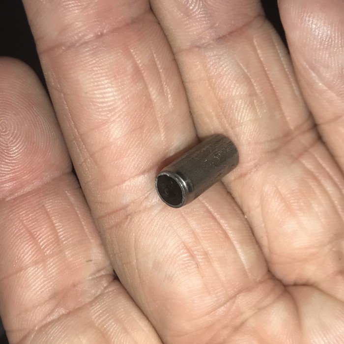

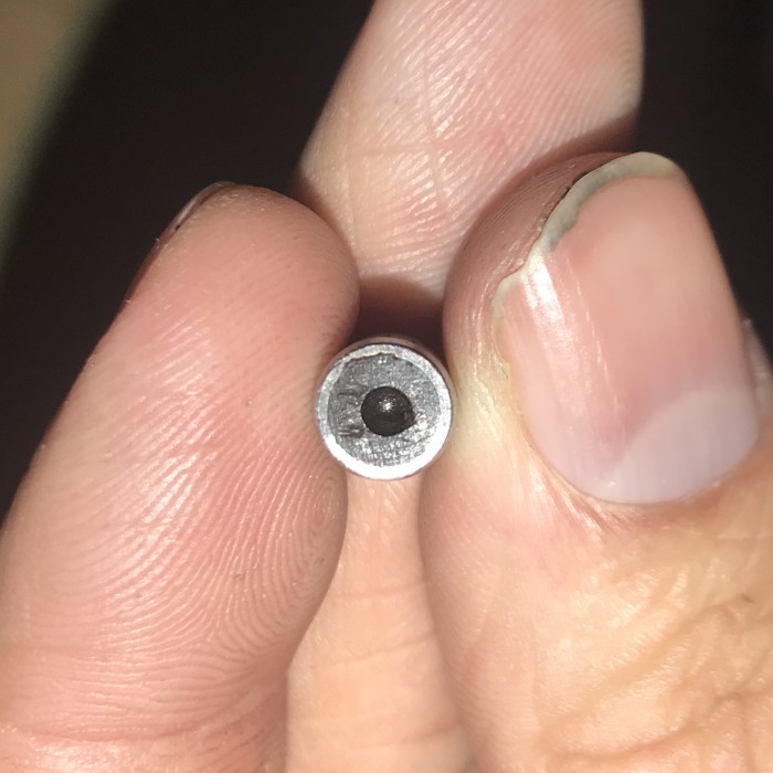

JerryVan wrote: Thu Aug 04, 2022 6:19 pm This is getting fun. Okay, when the motor is running in the horizontal position, (theoretically at least), the governor shaft is being thrust towards the outermost of its 2 bearings. When the lid is open, the weight of the governor counteracts that thrust, taking the thrust load off of the end bearing. My thinking is, there's drag in the bearing. With the motor fully unwound, remove the end bearing and have a close look at the "pin end" of the governor shaft and look down inside the end bearing. You guessed it, there should be a small ball bearing inside to act as a thrust bearing.
I do presume you are talking about the bearing that slides down around the pointy end of the governor, and this is the part that is in place. I am not sure if it is original, but I do not see any sort of ball bearing inside of it to act as a thrust bearing.

Yes, that's the piece I mean. It looks odd to me. Does it have some kind of dark colored core?

JerryVan wrote: Thu Aug 04, 2022 8:26 pm Yes, that's the piece I mean. It looks odd to me. Does it have some kind of dark colored core?
Yes, it has some sort of rubber/plastic in the middle of it. And down inside of it isn't a bearing, just some oil I couldn't get out of it completely for the photo.

Re: Help with a Columbia BI Sterling Disc Graphophone
While I have certainly not "seen everything" in this hobby, I have definitely never seen that. Maybe others will chime in to the contrary, but I do not believe that's a proper end bearing. I would seek out a replacement.

Post by outune »
Agreed- That looks to be homemade.. I have a box of Columbia motor parts I can look through to see if i have an extra bearing. If some one can share a picture of the correct one it would help me since I sold all of my Columbia machines.
