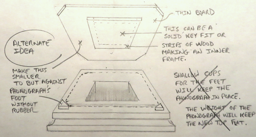

Here's an alternate idea ...
Making the panel small will help to hide it and reduce any color matching.
James.
James.

Roaring20s wrote: Tue May 30, 2023 8:25 pm Here's an alternate idea ...
James.
Excellent. It doesn't even have to be a square board. Basically an "X" shape would better hide the insert from being visible near the edges of the phonograph's base.

I like that idea very much…but…the tolerance or fit would have to be so tight and precise or else the phonograph would move forward and back a bit when I attempt to wind it. I’m not sure if I have that skill or not to pull that off. I guess I could remove the motor board and flip the case upside down and work on a perfect fit..
This reminds me of the locking in idea of the small strips of wood tucked and tacked behind the triangle bases. Similar strategies I guess…
It’s getting close….I CAN FEEL IT!!!

This idea is base on not driving screws into the top of the pedestal.
You could glue and screw two blocks into the hole and screw the new top to those blocks.
As far as making the top fit well, place the phonograph in position and use masking tape to accurately mark the feet on the pedestal. Then make a template to the shape you want.
There will always be some movement, but it won't slide off the pedestal.
James.
James.

Excellent point James.
This will be the method…final. I appreciate the members coming together with ideas. I know I went to the right place. Thank you all.
