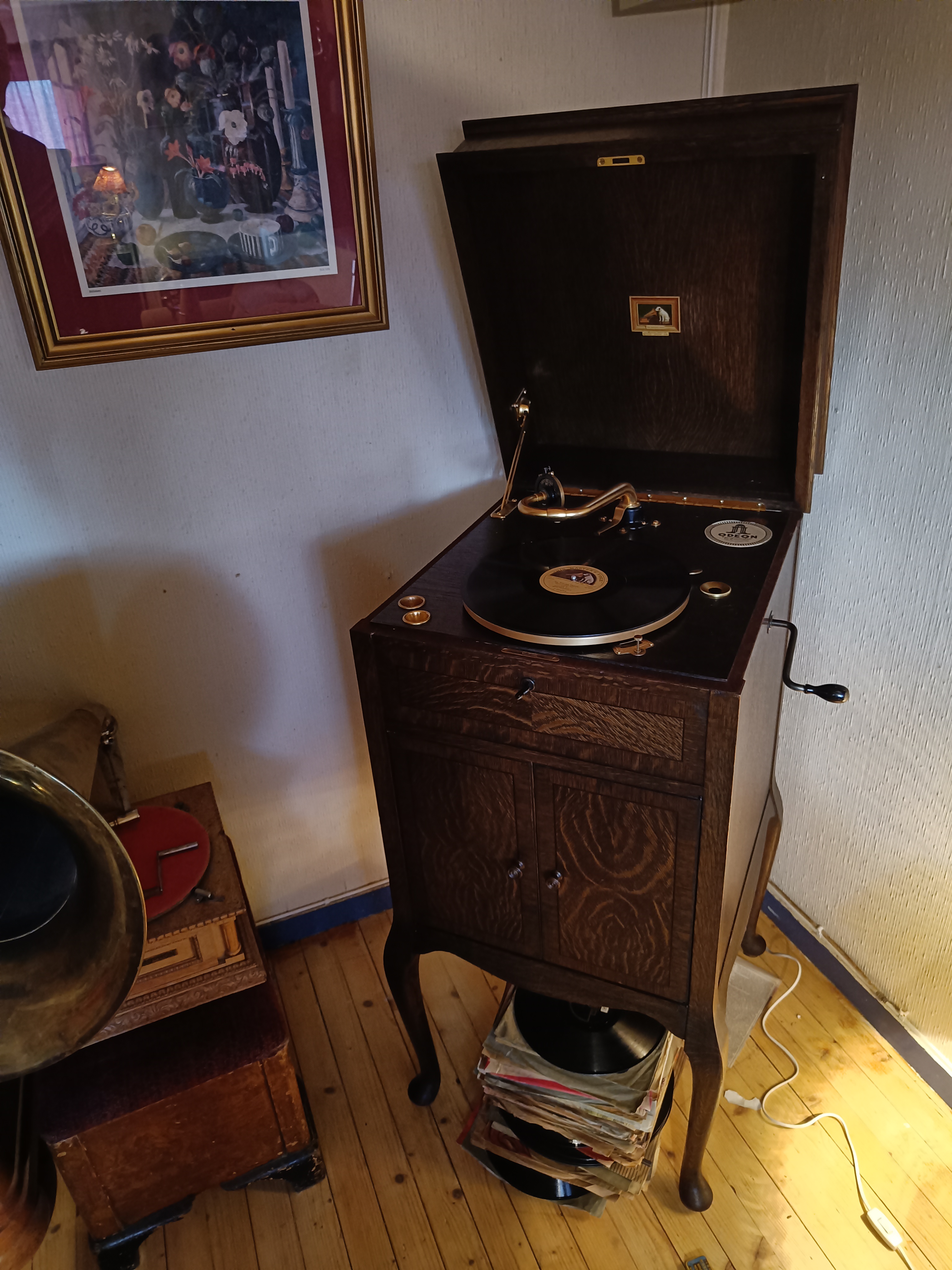

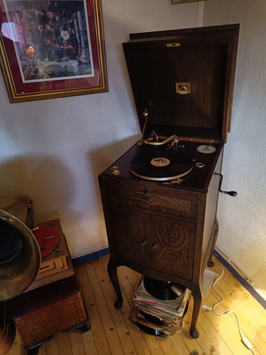

Motor is installed :D The wires used were torn apart during the installation, and the solution eventually was to put a cardboard box into the "back office" that my hand could rest on while I lifted the motor up, and my son inserted the first two screws and nuts, from there it was no problem to attach the last two screws and nuts.

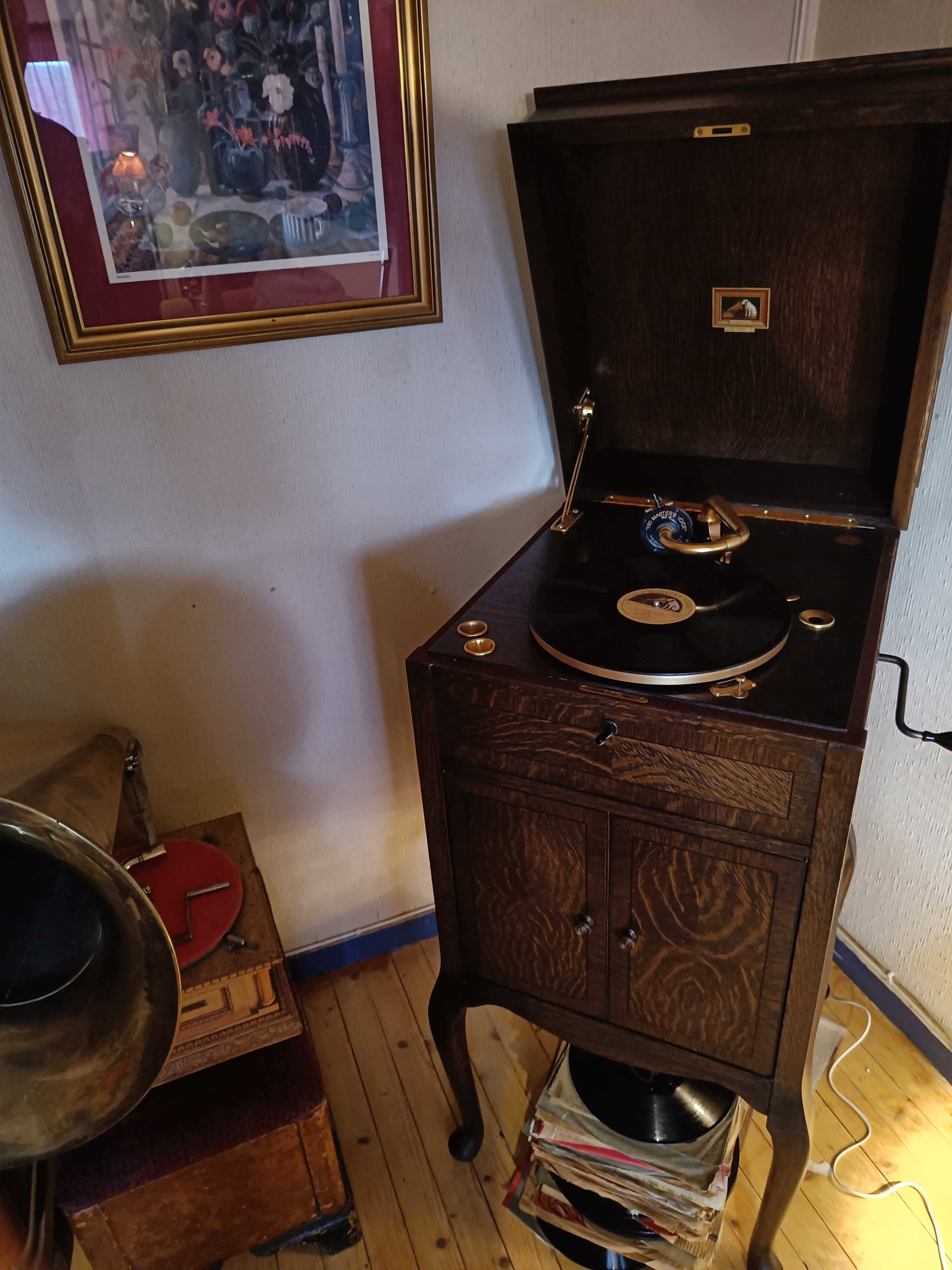

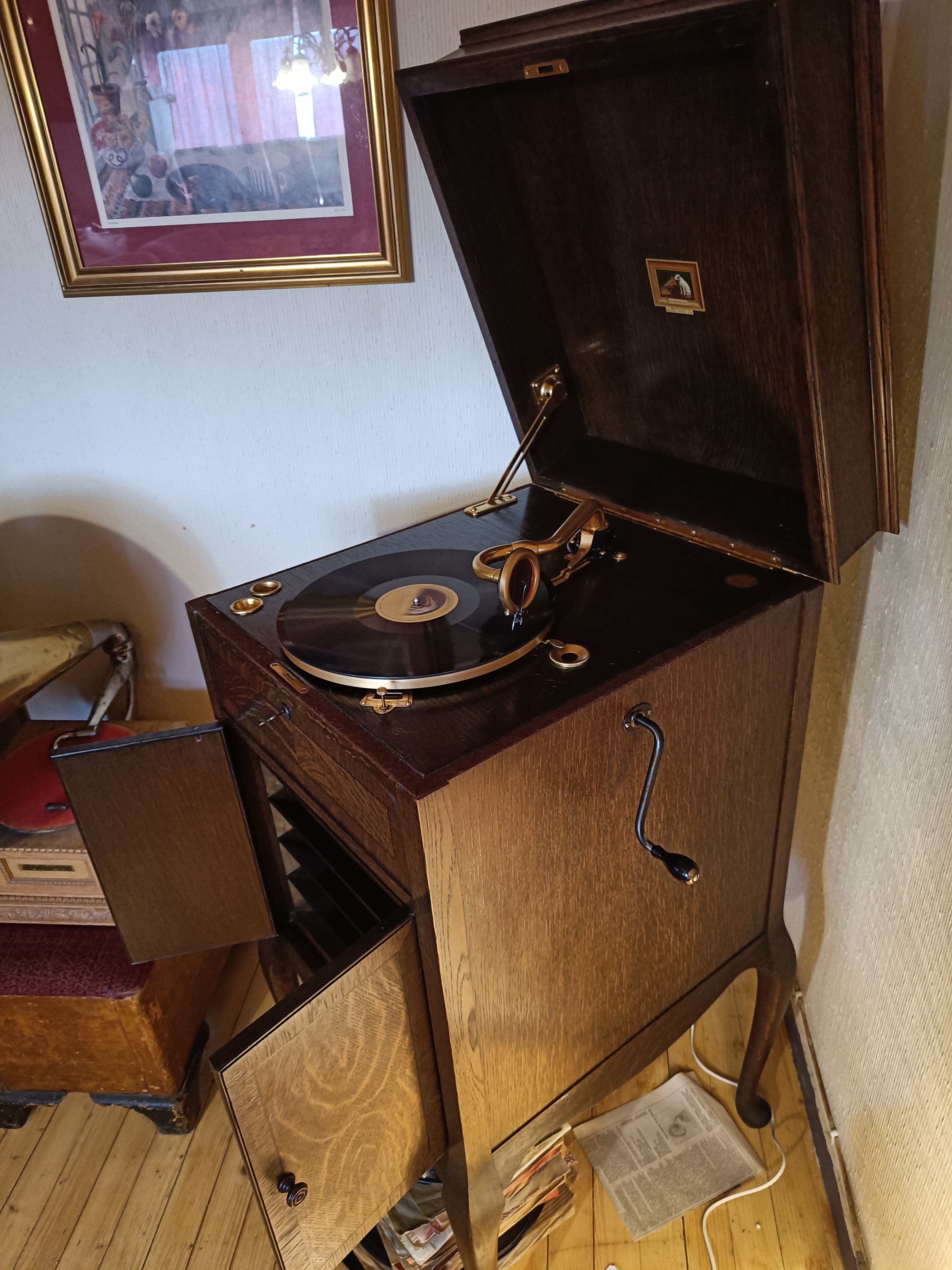

I threw out a cupboard used for records from my sitting room, my son gently gave up his bed and we put the cupboard in his room. I all fairness he has not slept in this bed for a year and we kept the mattress, it is easier to store a mattress agains the wall, than a big bed that takes far more space.
I felt the 511 deserved a corner, I first tested it against a flat wall, but it did not look too good in my small sitting room. This looks far better, and I even can store a horn gramophone next to it. It will very likely receive a carpet under it soon too, and a stand with an old lamp that I already have, that can throw some light on the machine.

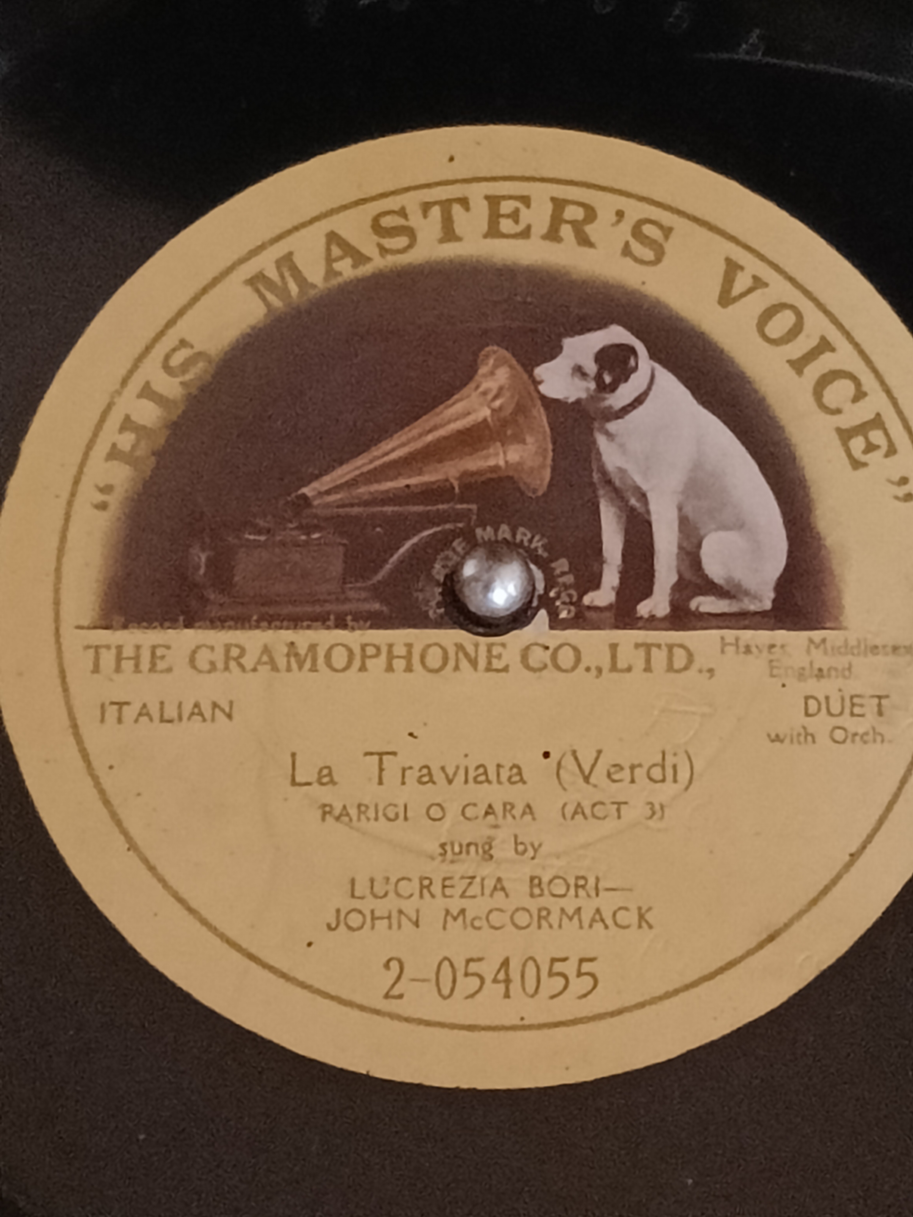

The record pictured was the first record played, and it plays and runs excellently, and quiet with no noise from the motor. The springs looked very good, as did the rest of the motor too. Mission accomplished.
