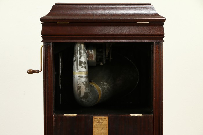

My A-200 is at least nice about one thing--You can oil it without taking the motor board out at all, if you use the oiling tubes, and you can work at the back of the motor by dropping the hatch in the back (using the foldaway brass handle provided to open it.) And it also has the take-away wooden strips near the motorboard to get in there and work on it. I think I may have done all right by waiting for a long time before I bought an Edison Disc phonograph. I did not know the B-80 was set up this way too, or that this was not "normal" on an Edison. It's pretty easy to work on but it also does not need worked on very often--thankfully, most of these early machines do seem dead reliable, unless it's my Home Model B, which is reliably dead.
Love that contrast between dead reliable and reliably dead. Goodness yes, cylinder machines can be very touchy.
I learn things all the time on the TMF. Never knew that the A200 innards can be accessed through a drop-down rear panel. Yet another delightful feature of an early Diamond Disc machine. Attached is a photo I pulled from online.

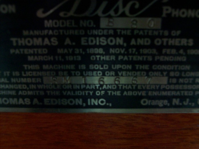

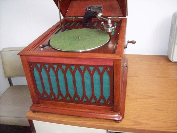

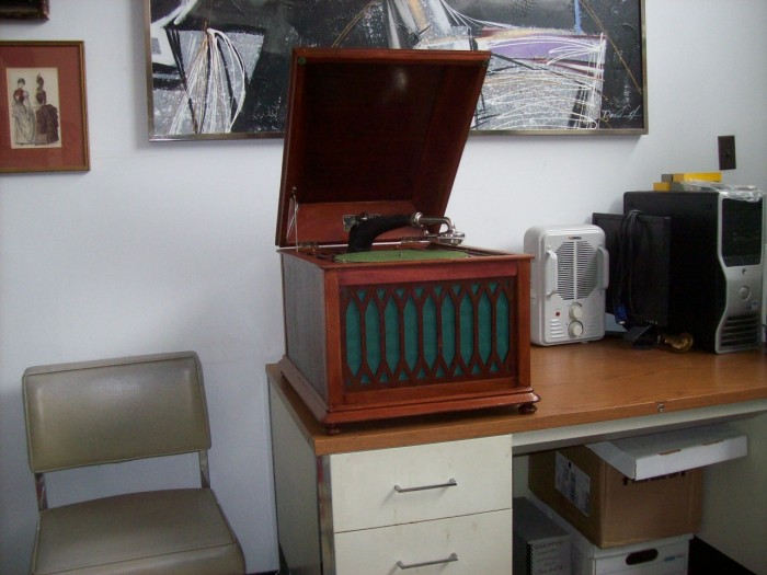

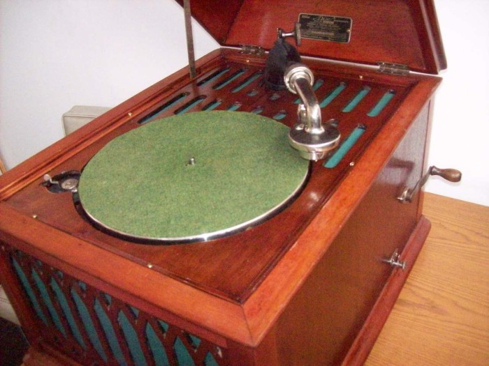

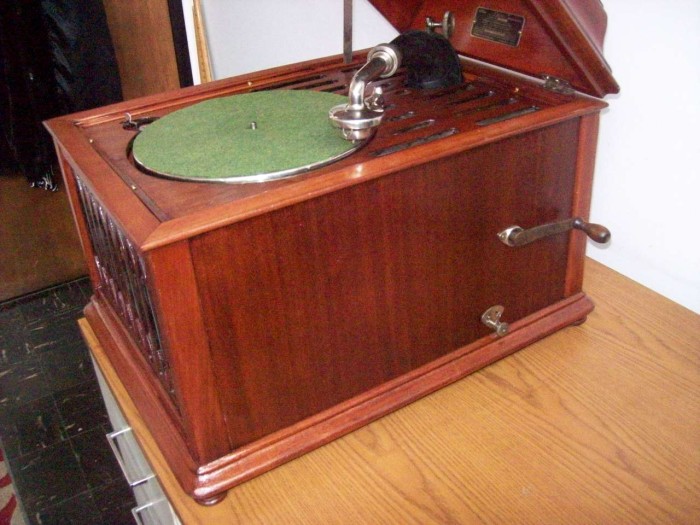

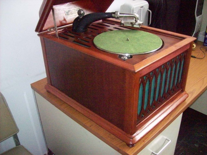

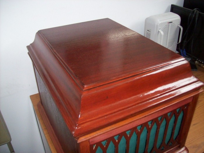

Hi Ken and all fans of the Edison B80 model,
After the initial work I did on the example I purchased from Ken last summer (SM 16667; documented at the beginning of this string) I decided to try harder and teach myself (with the invalable assistance of YouTube) how to strip, strain, and coat. I had really not done any of that before and it took half a year to learn. Most if not all of you know the drill: you have to buy your first sanders; you have to research stains; types of brushes (foam vs. conventional); and (hardest of all) you have to decide between a host of natural (shellac, etc.) and artificial coats (oil-based polyurethane, water-based polycrylic, etc.).
Several false starts; tried shellac (didn't like), polyurethane took too long to dry and didn't settle evenly. Finally settled on polycrylic applied with foam brushes (the most forgiving method).
Watched every YouTube video on the B80 I could find. Brad Hurt (the "Dyslexic Genius) loves the B80 too and provided tons of great info. He also said that his was originally stained Sedona Red and he said you can tell the original stain by looking on the underside, where it should appear without coating. Mine was the same. My goodness, when I got it, it sure looked like a dark mahogany: but I guess the original coat can REALLY get dark over a century. So I decided to go with Sedona Red and love it!!!
I initiallly put a Columbia grill on it (missing original grill when I got it) but a few days ago was finally able to find an original grill and spent a pretty penny to get it. I also got in touch with George Vollema and was able to buy his last set of mahogany feet.
So she's all done, except for a replacement Edison decal. I've dealt with Eduardo in Peru over the years (three purchases); two got lost in transit. I then tried someone in the U.S. but theirs was crappy and fell apart before I could apply it. So now I'm awaiting delivery of another, this time from South Korea.
I will post a YouTube video in the days ahead to show that it indeed does play! But the photos first.
The B80 demands attention, but it is such a COOL machine and I'm even more enthusiastic about the model than I was last summer.
Mindy
