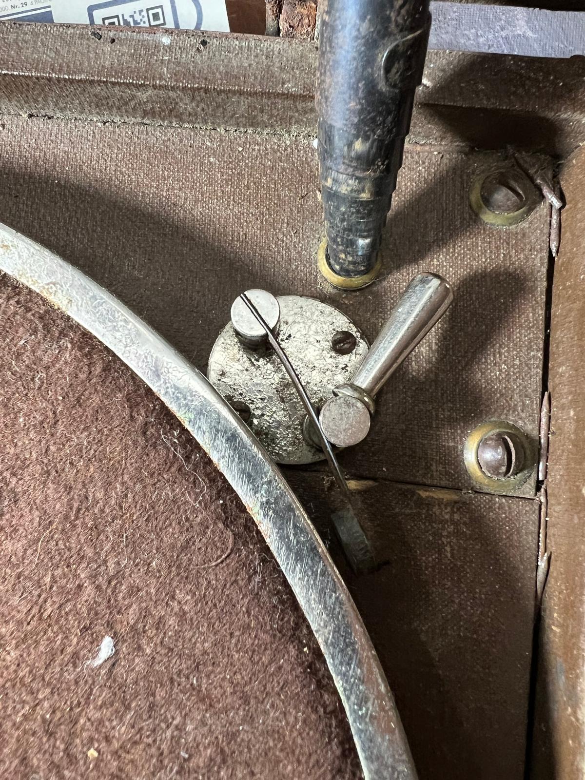

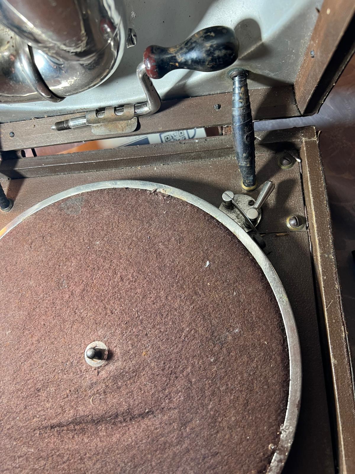

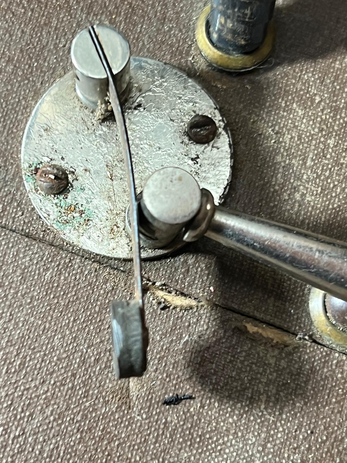

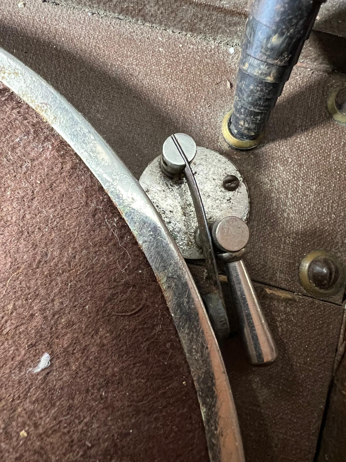

I may have missed it but I can't see a photograph of the brake. (I think I can see the needle holder and speed control only at the front ?).
Is it possible to upload a photo of the brake please I wonder >
These are the pictures of the brake.
Thank you

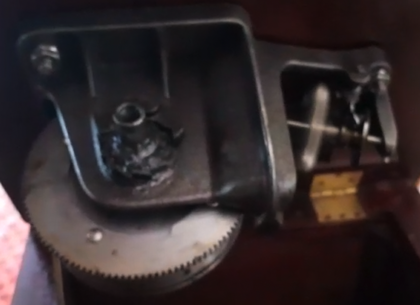

From the pictures and video, I would judge this machine to be original with the correct motor (shown working in the video). For 800 Euros, it's a bargain with the wood horn, which can be restored. It would be extremely lucky to find another one for 1000, since the horn is the major part of the value... Ignore the extra Columbia motor, which is not installed.

The supposed needle (not pin) problem with the DECCA is difficult to determine, since you have posted several irrelevant pictures of the tonearm. You need to show us what you think the problem is, with close up photos of the reproducer, needle bar and chuck (the part that holds the needle with a thumb screw). Then explain exactly what happens...
