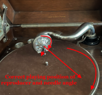

Diagram showing reproducer position and record rotation...
Screenshot 2024-06-19 at 9.27.30 PM.png (190.93 KiB) Viewed 607 times

In one of your photos, you show the needle positioned perfectly vertical. You also depict the reproducer/needle sitting to the left of the turntable spindle. Both are incorrect, (and for some odd reason a very common error seen these days).
The reproducer/tonearm/needle must be positioned to the right of the spindle. The reproducer/needle also must adjusted such that the needle sits at roughly a 30 degree angle from vertical and pointing "forward", in the direction of rotation.

Curt A wrote: Wed Jun 19, 2024 9:30 pm Diagram showing reproducer position and record rotation...
Curt,
Is this correct? If so, I guess there is a problem with the record? :lol:

MarieP wrote: Thu Jun 20, 2024 5:21 am
Curt,
No! You still have the reproducer to the left of the spindle, with the needle digging into the record. Swing the tonearm to the right side. The needle angle is now correct however.
The only problem with the record is that it's been ruined by playing it the wrong way.
Check out this video.. Notice where the reproducer is placed when playing. https://www.youtube.com/watch?v=bHc7mYlpGI8&t=3s

The last pic is correct...
