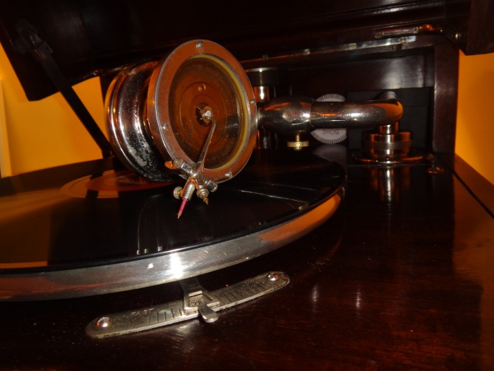

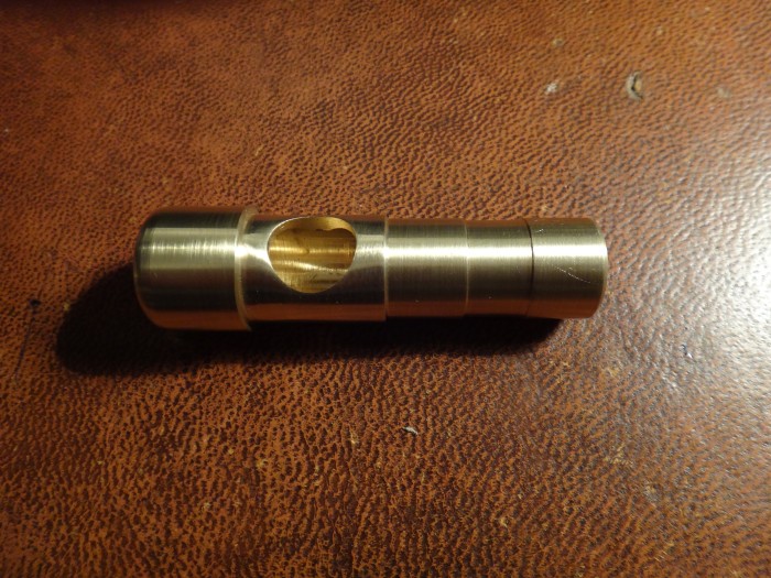

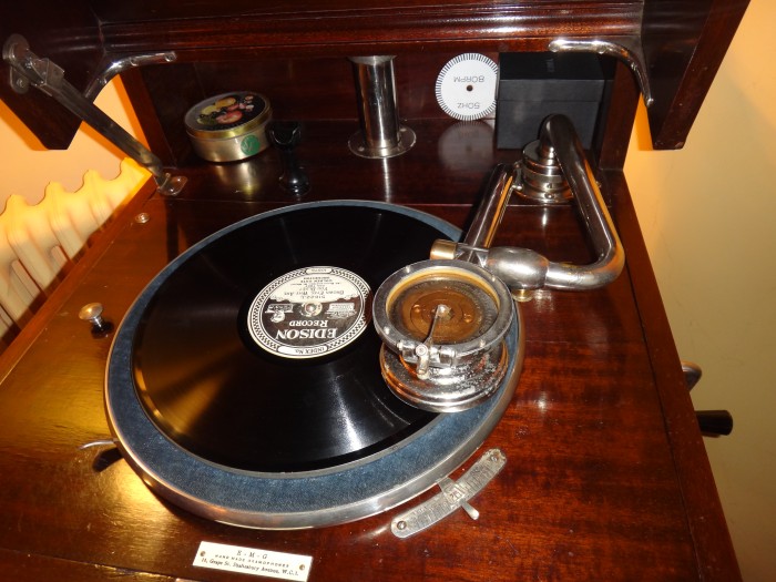

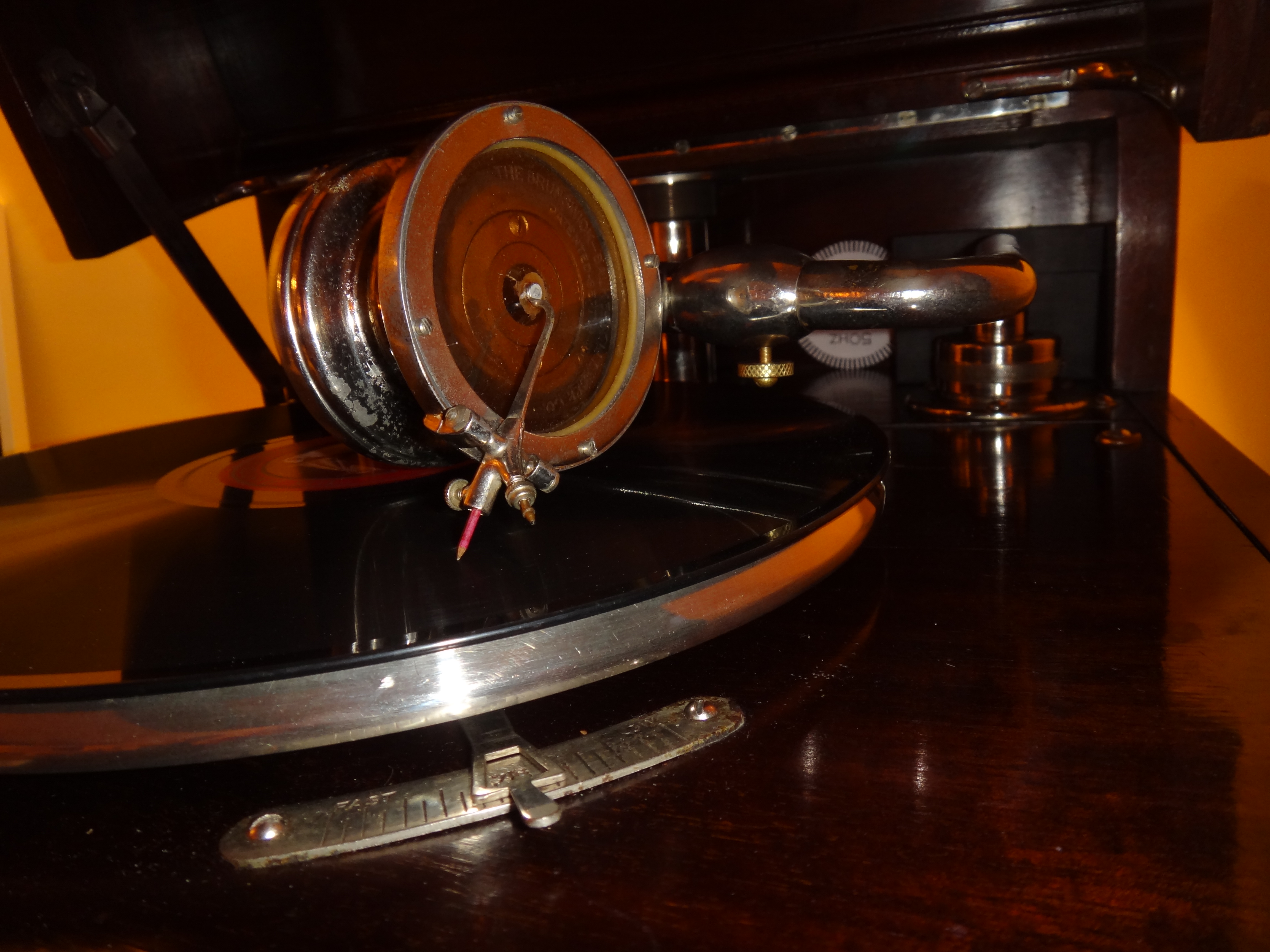

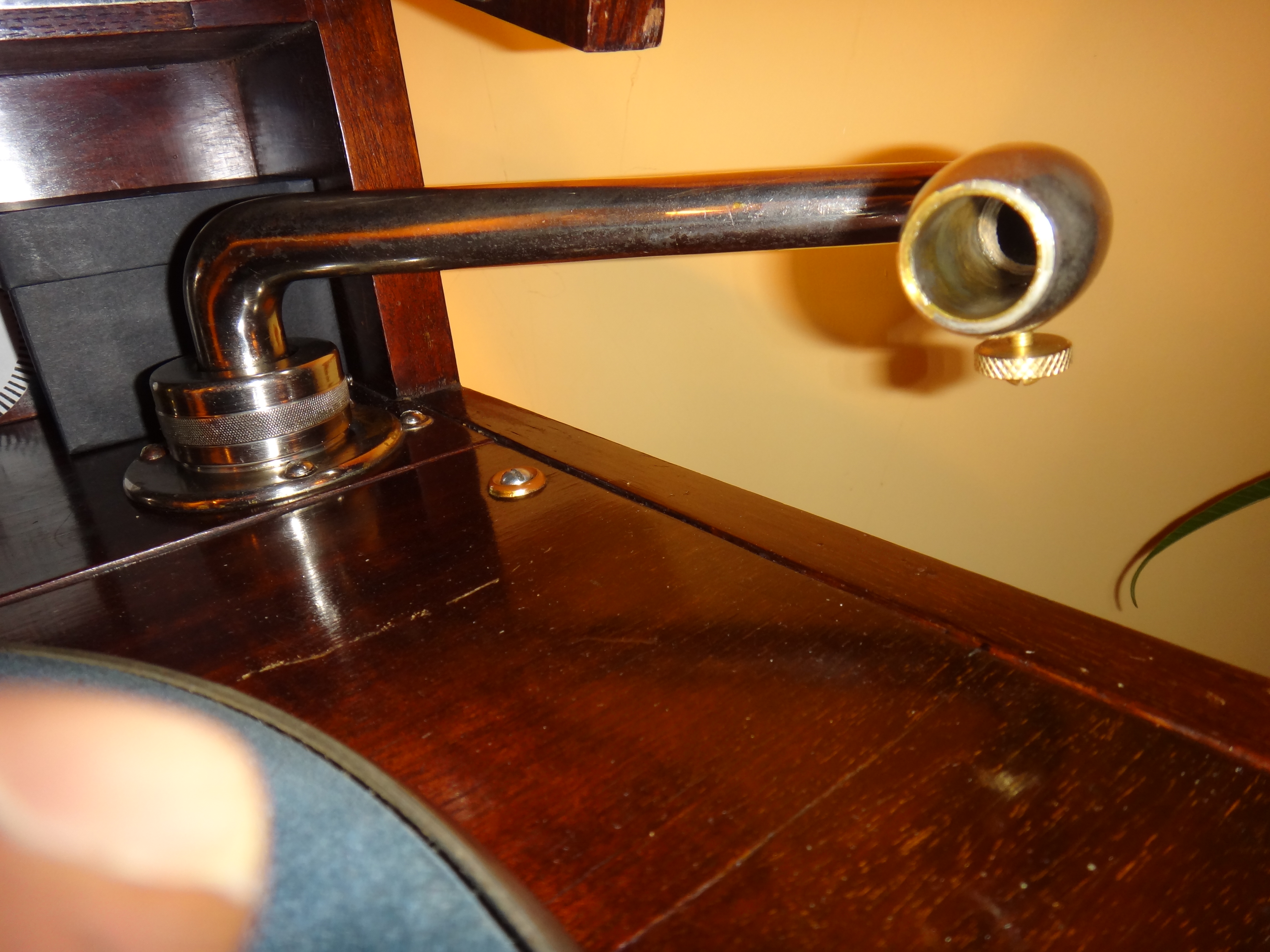

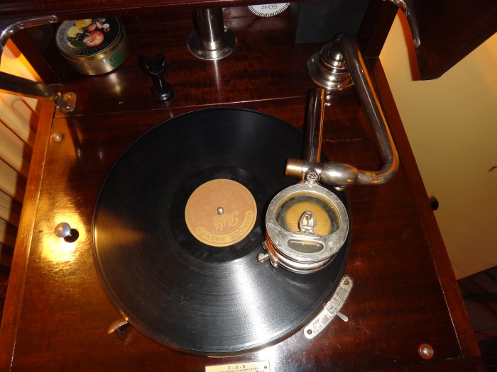

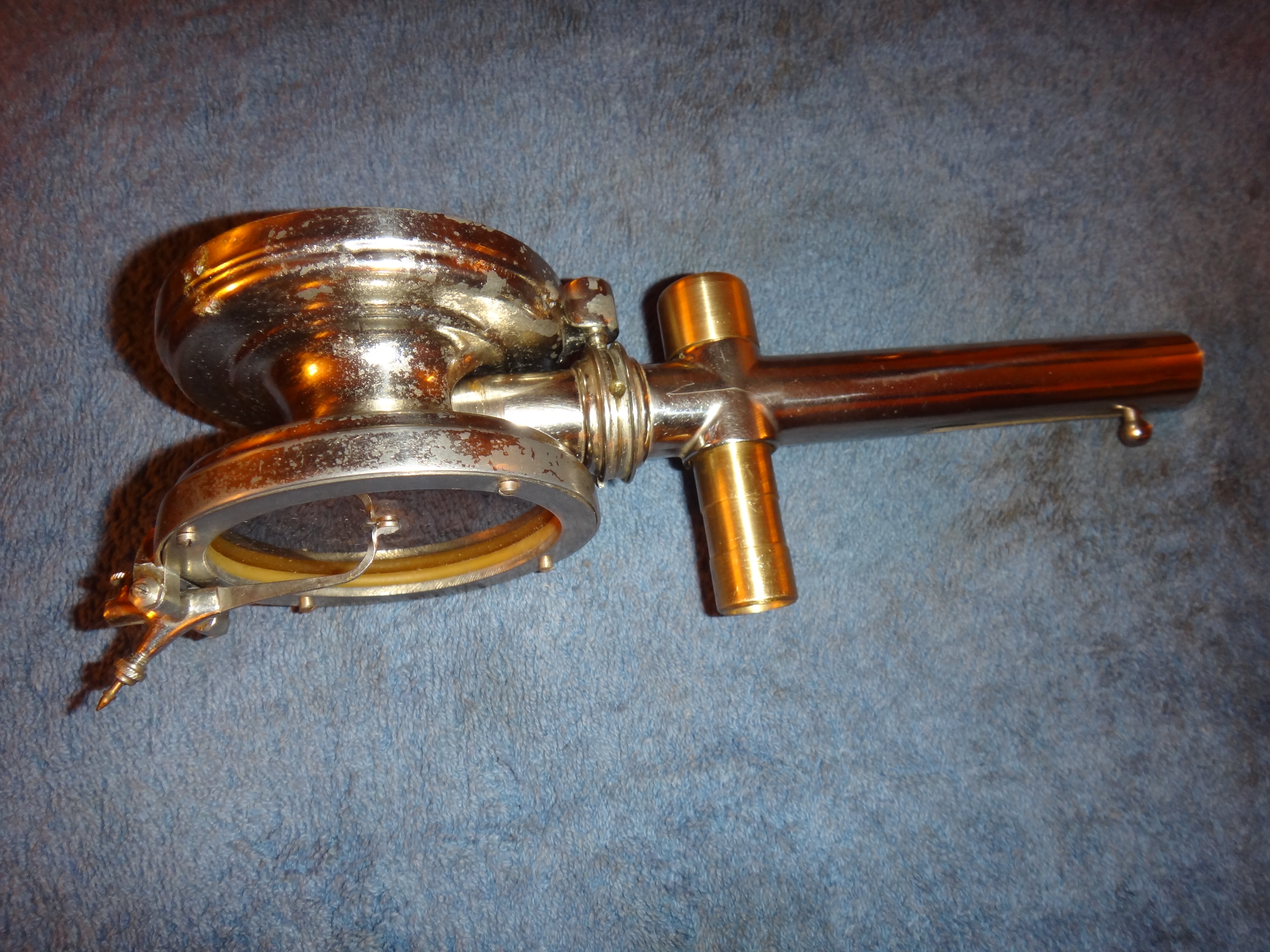

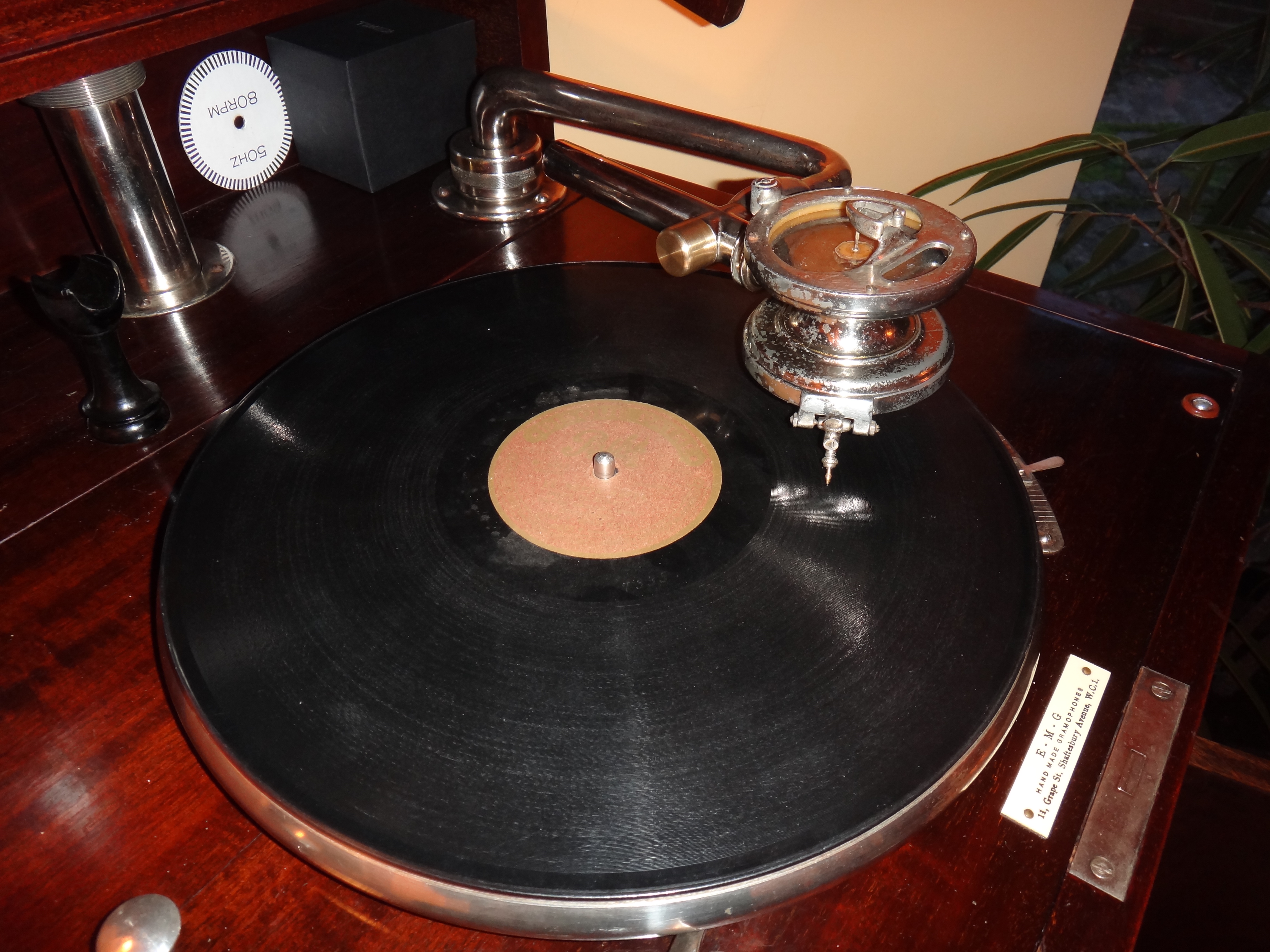

Here is another video showing how an EMG can be made to play both Edison and Pathé discs with a Brunswick Ultona soundbox. The latter is a brilliant piece of design and allows the playing of all three disc types. It also very cleverly incorporates a counterweight--maximum for Edison and minimum for Pathé. A simple brass adaptor is required to join the Ultona to the EMG tonearm having first removed the normal swinging section. Tracking of Edison records is quite reasonable but Pathé slightly less so in spite of rotation of the soundbox head (such a clever design) to allow the sapphire to approach the motor spindle to produce an acceptable overlap. Due to the spherical nature of the ball sapphire, and thus reasonable compliance to the record grooves, good sound is assured and record wear is not a problem.
https://www.youtube.com/watch?v=CNj7w3bcI1c Edison
https://www.youtube.com/watch?v=aHbLAyMAk40 Pathé
Brunswick Ultona playing Edison Diamond Disc.
Brunswick Ultona playing Pathé vertical-cut disc with full horizontal twist. (2).
Brunswick Ultona playing Pathé vertical-cut disc with full horizontal twist. (1).
Brunswick Ultona playing lateral-cut disc.
Brunswick Ultona soundbox with adaptor in position.
EMG tonearm with swinging section removed.
EMG Brunswick Ultona adaptor.

What a terrific attachment! 3-in-1, nearly universal!
Is it a factory-made period product I wonder, or the masterpiece of some skilled gramophone enthusiast?
CarlosV
Posts: 2150
Location: Luxembourg
Re: Edison Diamond disc machines in the UK?
Post by CarlosV »
Marco Gilardetti wrote: Fri Jun 28, 2024 3:46 am What a terrific attachment! 3-in-1, nearly universal!
Marco, the Brunswick Ultona soundbox, including its counterweight, is a standard product, made to cope with all existing record formats of the time. It was made in two formats: lateral+Pathé and the one shown, lateral+Pathé+Edison. But the adaptation gear to the EMG is Graham's conception and execution. It is a very successful solution, and his you tube videos show how well it works.
