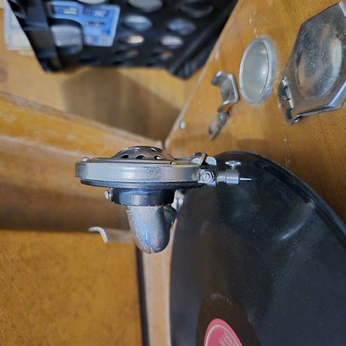

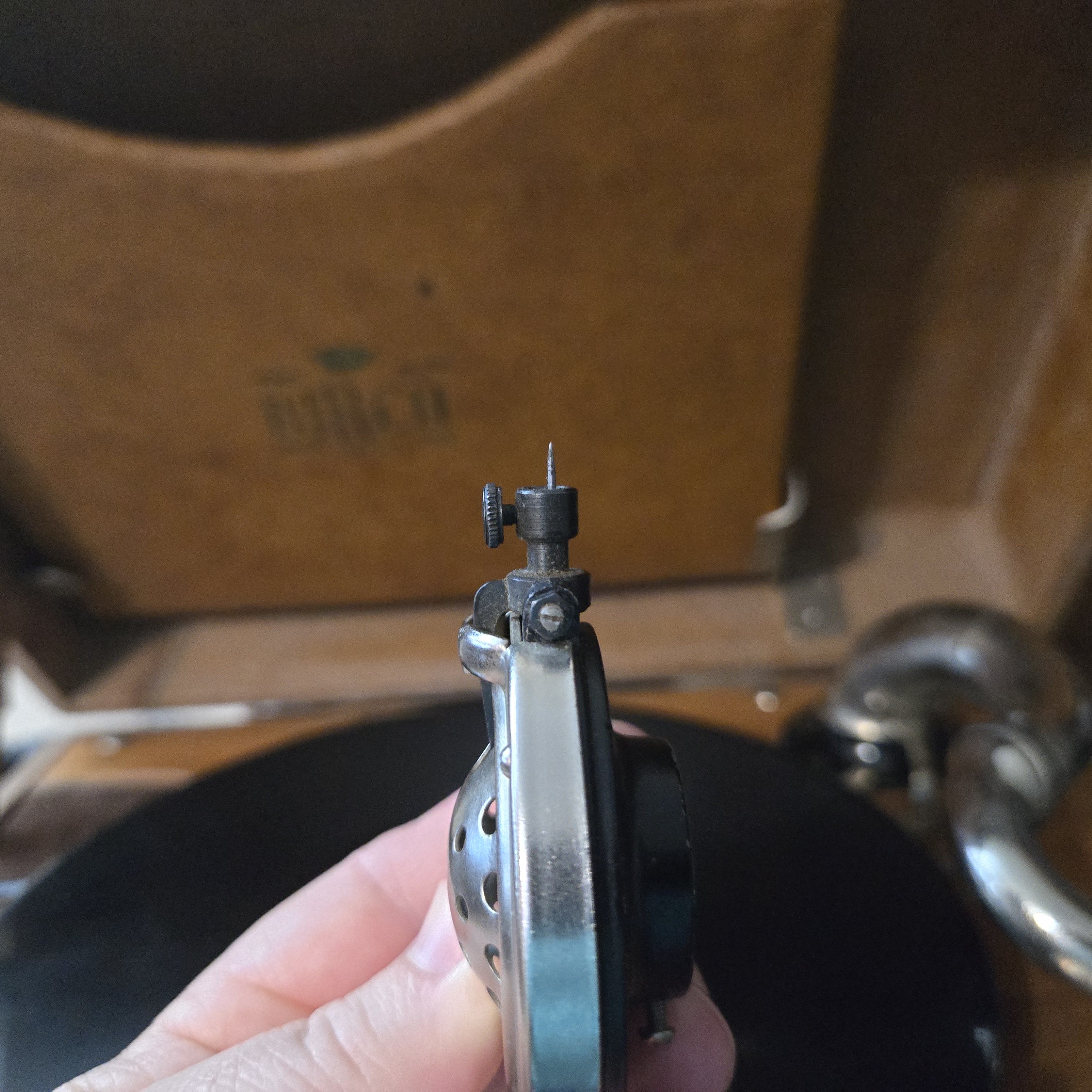

Lah Ca wrote: Tue Apr 01, 2025 10:12 am It also seems that with your reproducer things are not quite in alignment.
The bottom of the needle-bar, itself, looks slightly bent. The whole thing should run parallel to the face of the sound box (reproducer), as is the case with the photo you (Lah Ca) posted. The need, held in this position, would dig into the record's groove at an angle.
Along this line, the sound box also seems to be positioned at a slight angle on the end of the tonearm, and it looks like it needs a new rubber throat gasket.
I'm not sure if the needle-bar can be straitened on this type of sound box. It would have to be detached from the diaphragm and completely removed from the face-plate, via the two locking screws, straitened out, and re-attached.
Along this line, I'm wondering about the condition of the aluminum diaphragm. Are there any dents, tears or gouges?

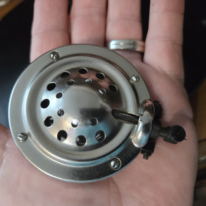

It all looks to line up pretty well from what I can tell. Although having little experience, I'm not sure I would recognize what to look for in a replacement. I've tried moving the needle to the side and it was certainly in the wrong spot, was not hitting the groove at all. It does play fine, but skips after a few rotations. Maybe its the tone arm being too stiff. It moves freely, but only when pushed. I can't give it a shove and it moves further than me pushing it (like a normal turntable tone arm would do). Adding a few more shots in case anything looks wonky to the experienced folks here.

doctor_of_jazz wrote: Tue Apr 01, 2025 3:43 pm It all looks to line up pretty well from what I can tell.
Yes. It looks much better than in the screen shot from your video clip.
The mounting on the tone arm looks a little off still, however. How tightly does the reproducer sit on the end of the tone arm without the set screw tightened? If it is a bit wobbly or loose, you could try a couple of wraps of green painter's tape around the end of the tone arm as an experiment to see if you can get a tighter fit. The tape can easily be removed when you replace the throat gasket (if it needs to be done).
doctor_of_jazz wrote: Tue Apr 01, 2025 3:43 pm I've tried moving the needle to the side and it was certainly in the wrong spot, was not hitting the groove at all.
Please don't do this. The diaphragm is quite fragile. It is somewhat concerning that you were able to do it. You can remove the chrome plated protective cap for the diaphragm quite safely if you are careful--there are four screws (no force--patience and a drop of penetrating oil if needed) . Have a look at the diaphragm and how it is attached to the needle bar. If the needle bar has ripped loose from the diaphragm or torn it, we have a problem.
doctor_of_jazz wrote: Tue Apr 01, 2025 3:43 pm Maybe its the tone arm being too stiff. It moves freely, but only when pushed. I can't give it a shove and it moves further than me pushing it (like a normal turntable tone arm would do).
Maybe. It won't hurt to keep working on it. Repeated movement back and forth for the full length of its travel. Repeated very light lubrication if needed.

Here is what the diaphragm on my reproducer looks like. Interestingly the covering plate on mine has only three screws holding it on.
download/file.php?id=167522&mode=view
Here is what the reproducer looks like from the back before I replaced the throat gasket.
download/file.php?id=167521
