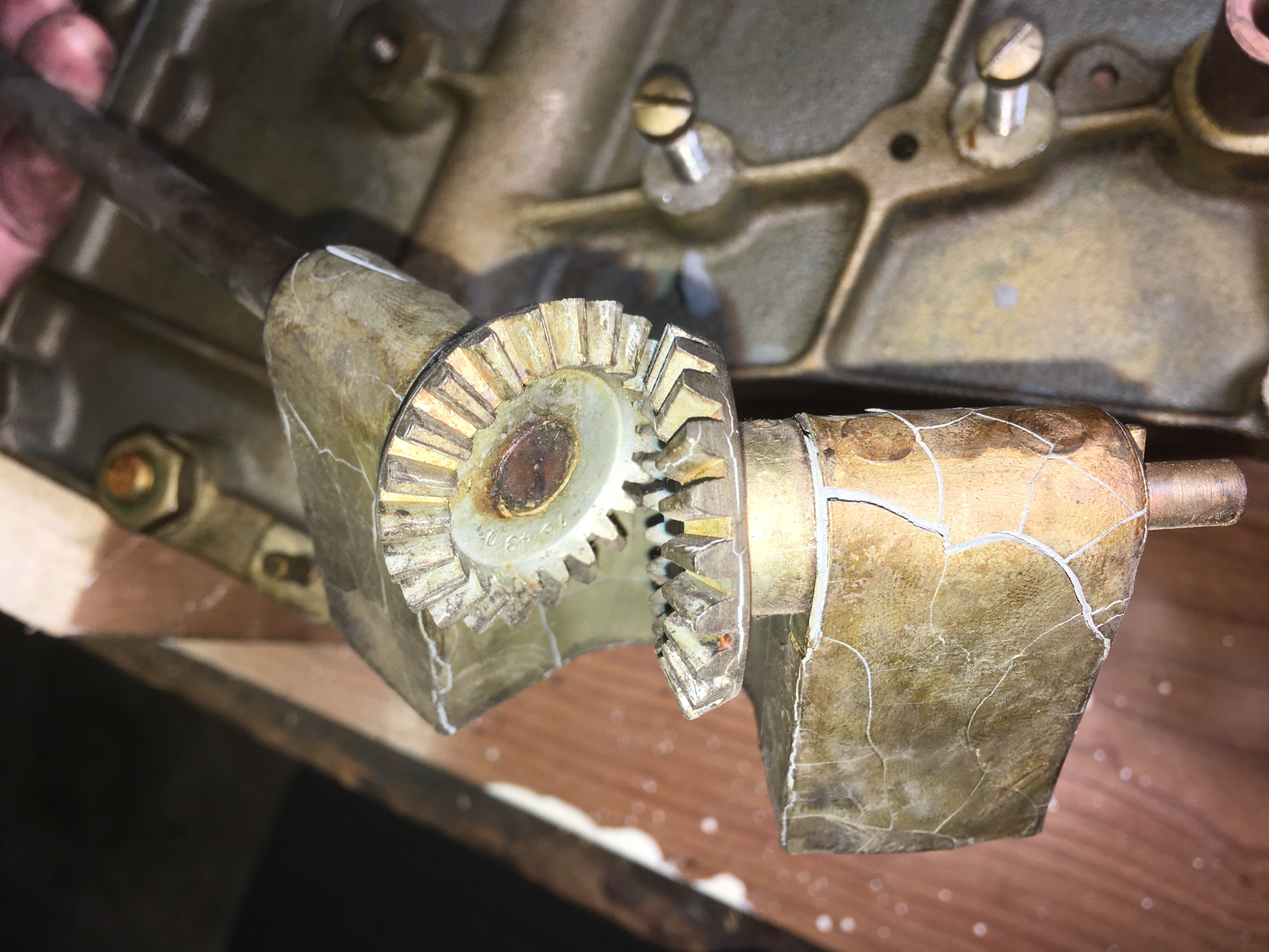

Hi Grover,
Thanks for making a reasoned and definite decision. Can you post some photos of the machine especially the corroded internal parts that concerned you. Remember that several of critical parts are made of pot metal and these parts are always bad, they usually look pretty terrible! Don’t be concerned because the replacement kit addresses every one of them. The mechanism can be made to work and look like new again. At 18 years old I suspect you are in a limited budget so perhaps the economics of this don’t make sense for you and that is a fine reason not to pursue it. Condition aside, comparing it to a single bargain sale of $150 (plus buyers premium and moving costs) is not a good comparison of the market though.
Please post some photos and give the rest of us the lead, I’m not interested but perhaps there is someone willing to take on a project.
Below are some photos of the typical as-found 10-50 mechanism. All of the issues are addressed with the replacement kit. The original parts always look bad! Is this what you saw?
Mark

by Garret
That all looks very familiar.
