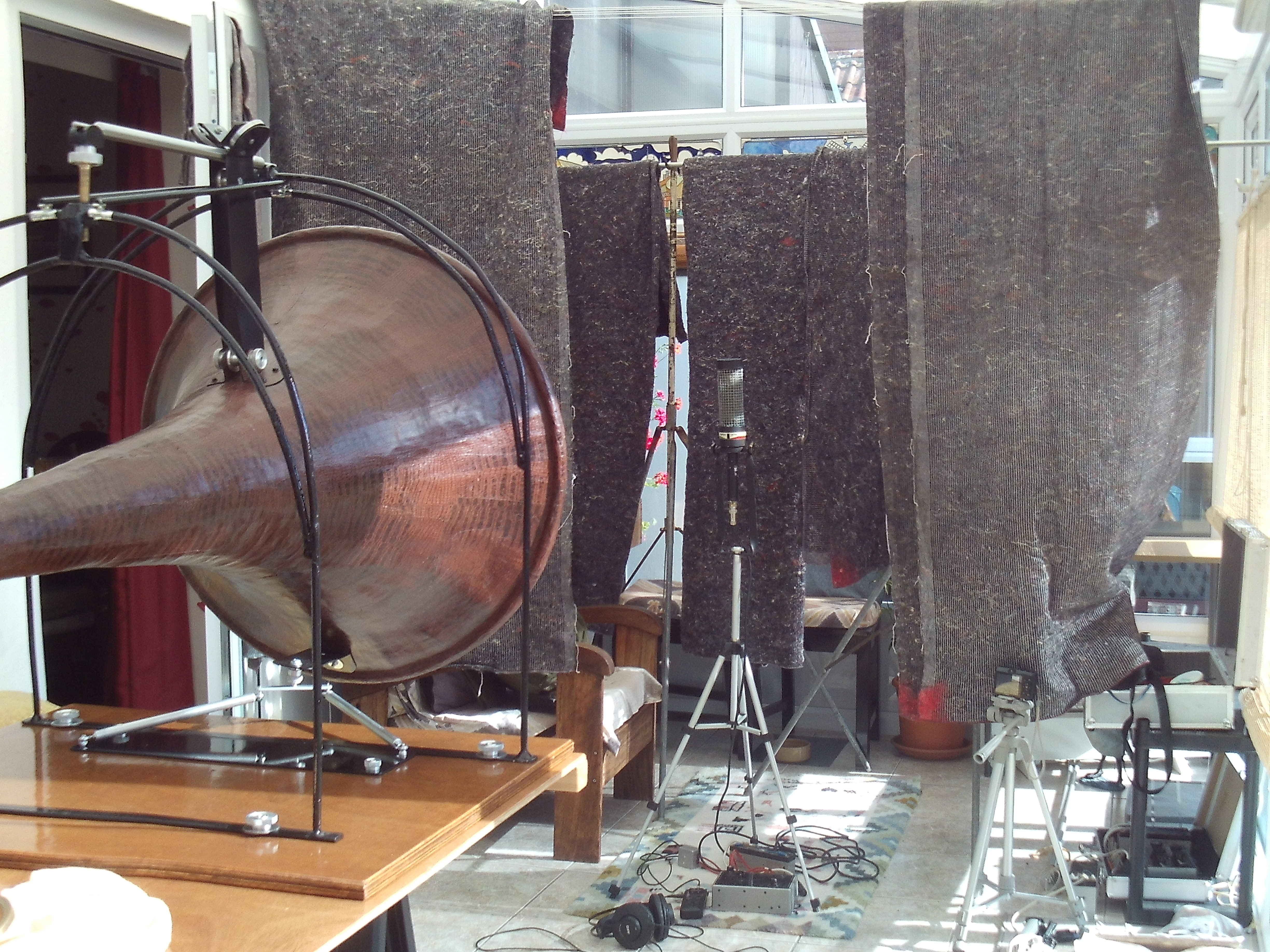

Greetings ALL! Thank you for your kind remarks re the reproduction
I have just looked in to hear the machine playing in the video. A lot of time was spent when recording the "Teddy Bears' Picnic". Liz had brought along all the necessary acoustic blankets and tripods, recording equipment, meters, etc., and after some time in placing blankets over just about every door and window, the recording was made. Several tries were attempted, until finally the no 5a soundbox was attached and that gave the best all round performance it seems. The Meltrope was good with extra bass, but the treble a little wanting (must have been my fiddling with it too much!). A no 4 mica box was also used earlier on. It was very acceptable, with a good all round performance. A Ginn soundbox, 4 spring was tried also on this recording day. Disappointing I thought, as I expected a really marvellous sound, that must have succumbed to my "adjustments" also.
This recording of the "Teddy Bears' Picnic is one of the later pressings, but the surface noise was bit better on this than on one of the original pressings from around 1932, "DB 955-maroon label)

old country chemist
- Posts: 286
- Joined: Mon Nov 14, 2011 5:06 pm
Re: PAPER HORN "BALMAIN"
I forgot to add this picture, which shows the acoustic blankets, etc pre the recordings on the machine.
