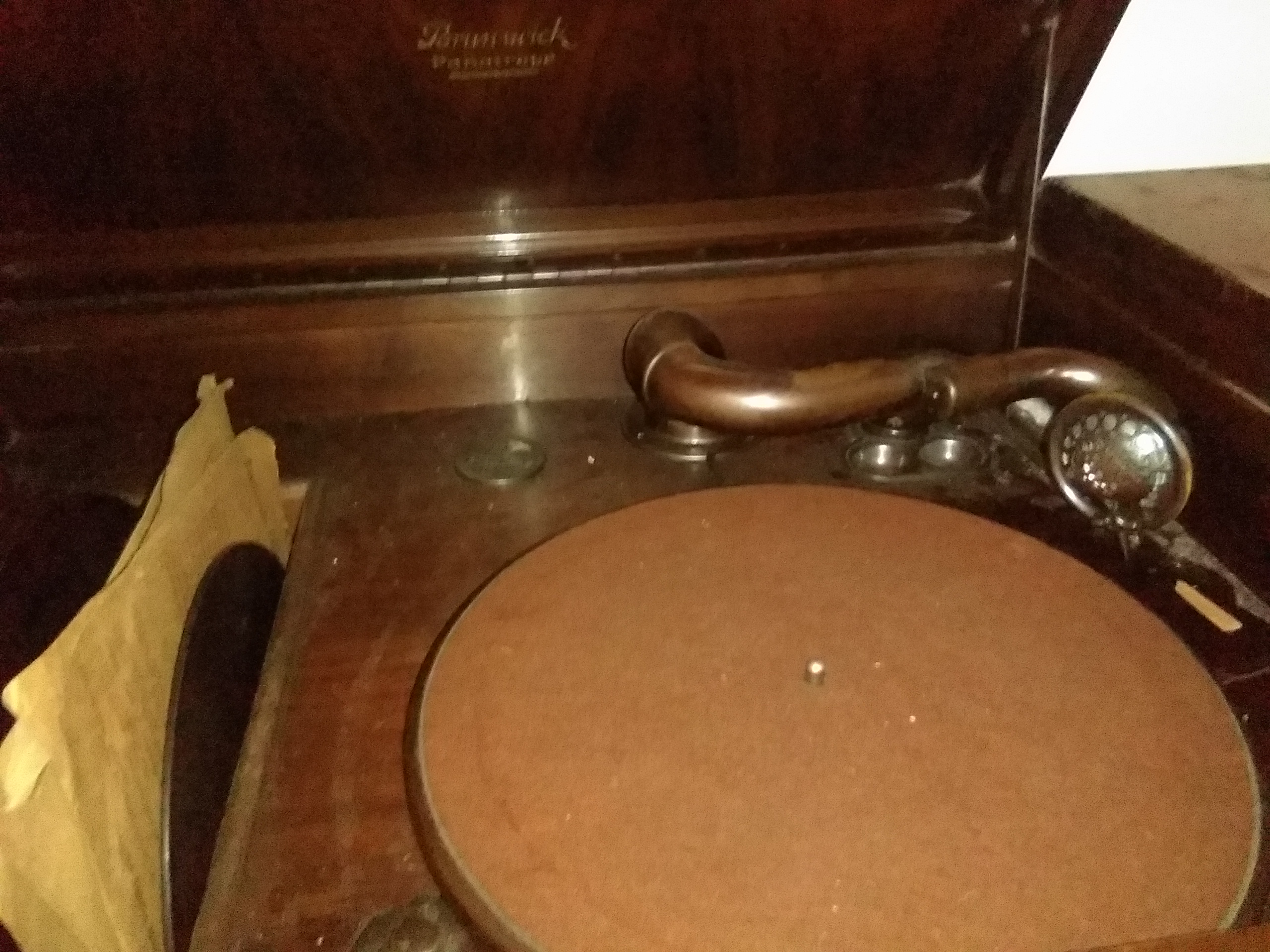

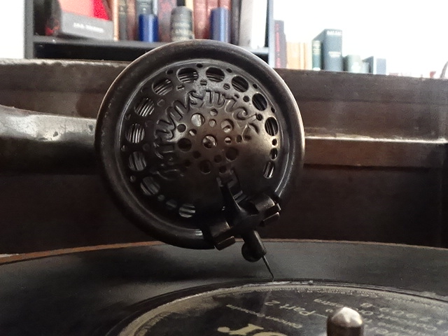

The Panatrope reproducer. This one was carefully reconstructed from parts. Notice ball bearing fulcrum, pleated diaphragm made of very thin aluminum, and the near-complete lack of rubber. All gaskets are paper. A Panatrope does not have gasket problems, and if adjusted it will play well. This one is a mix of mechanical parts from two pot-metal reproducers, fitted into a brass body. With appropriate care it should last about a century before it's due for another few adjustments.
The tone arm will rest with the needle down without dragging the needle on the deck and scratching the finish. Underneath the turntable is an autobrake system similar to the one on earlier Brunswicks fitted with the Ultona. The pivot is ball-bearing supported and requires little service. I've never seen a Panatrope with a damaged tonearm support, though the pot-metal reproducer bodies may swell.

I know this is an ancient thread, but what kind of tonearm do you use for the panatrope reproducer?
Panatropes come with their own tonearm. It's not an aftermarket reproducer but part of a carefully done system.
Sure, I know that much. After all, I owned one and can attest to it being the finest available. Mine needed adjustment, and to any out there I HIGHLY recommend greasing the ball bearings- it swings a lot easier after you do.
The major drawback of the Panatrope reproducer is the direct metal-to-metal connection to the arm. Without the dampening that a rubber ring provides, it imposes a higher stress on the record groove and does not attenuate the extraneous frequencies generated in the reproducer.
