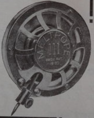

Is the diaphragm aluminum? Admittedly, I have no experience with a meltrope, but with Victor reproducers it is important not to have downward or too much upward pressure from the needle bar that distorts the diaphragm. Something definitely looks wrong from your pictures. The cover should not exert pressure on the needle bar or diaphragm, it should go back together without that large gap. The cover's only purpose is to protect the needle bar and diaphragm from damage (and hold the ball bearings), all of which should go back together level. The picture in the ad shows it closed normally.
