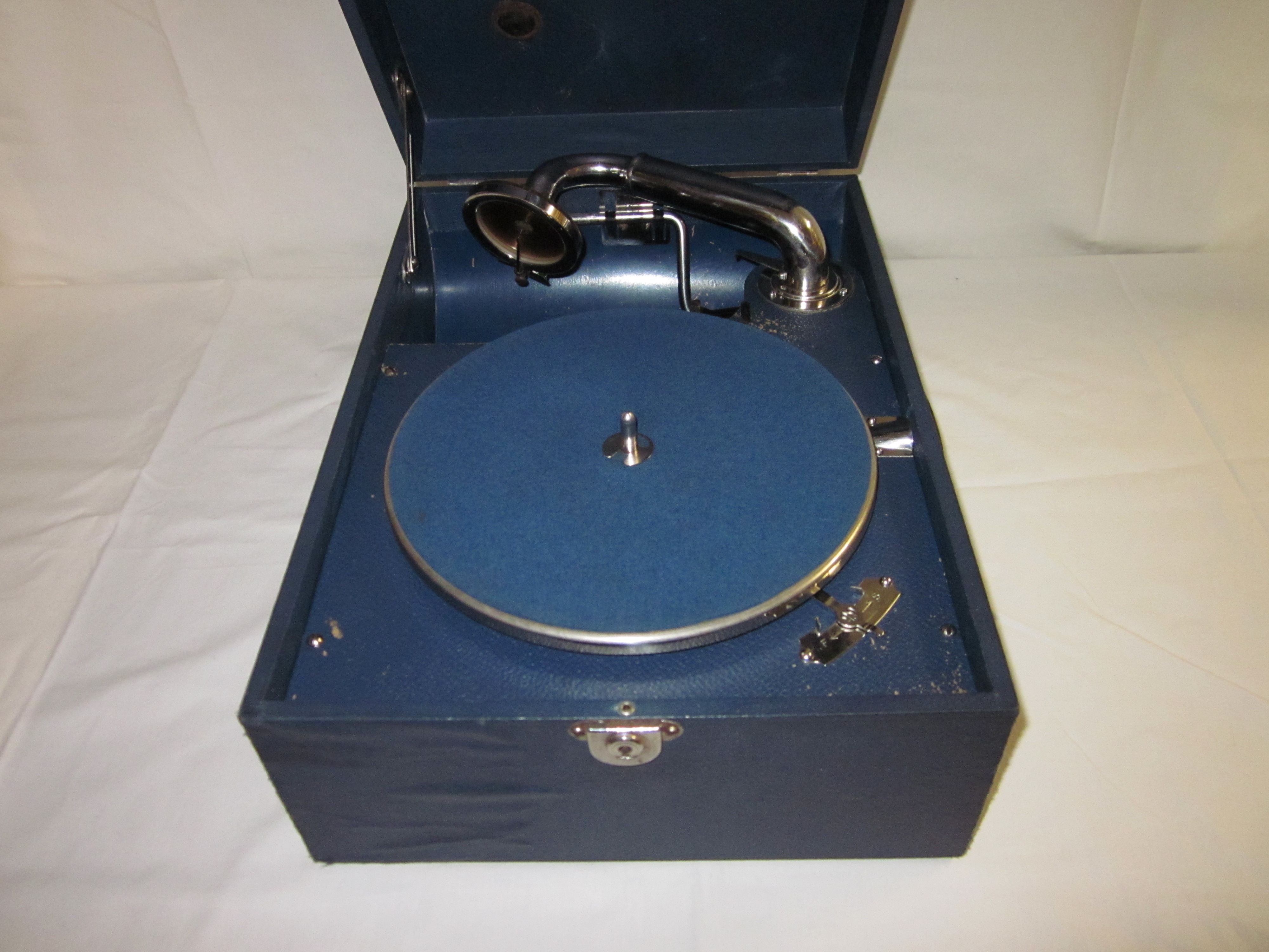

Thanks "nostalgia". I was actually a member here long time ago but during my inactivity my profile got "cleaned up".
I appreciate the answer. This is a bit annoying but tolerable now that I know it is a feature rather than a fault. This machine has a serial number 346 so it must be made quite early in the production? This machine is actually owned by a museum or one of its staff personally (I haven't asked) so it will be taken care of. The mainspring has been repaired in the past. It has probably been broken and is now shorter than it should be but it is still capable of playing one side of the record nicely (at correct speed) although it struggles more or less on some records that have higher resistance. The sound box is a Goldring Juwell Electro so I assume it is not original.
I attached some pictures. It was not in the best of conditions but a little glue and shoe polish did wonders. It still shows it age though.

Thanks for posting photos, and nice to know the machine is in good hands.
The Goldring soundbox is as you also state, not original to this machine. If you have a look at the repair photos of the green colored 87 in this thread, you will see the original HMV No. 23 soundbox that followed also the blue 87 when it was new. There is however missing a gold colored HMV shield in the middle of the soundbox on my machine, it has fallen off at some stage during its lifespan.
Regarding the serial number, where did you find this number on your machine?

Re: HMV Model 87 portable, in...green color
The serial number is on the white tag under the turntable. At least I assume it is the serial number of the machine. Yours seems to be 13337, nostalgia.

Yes, that is the serial number, sorry I did not pay attention to that the label was visible on your photo.
Yes, that is a very low serial number and was an early production, my machine has, as you say a much higher serial number.

This machine also doesn't have the needle cup and the speed control is on the other side. Maybe they changed this during the production?

Yes, these are good observatioons.
According to the excellent "His Master's Gramophone" book ( Proudfoot/Oakley), there were two variations of this Model 87. At one stage in production the Model 87A was introduced, and it has the needle bowl in front, right hand corner. The 87A also has a small needle cup cover that is attached to the upper right corner of the main lid on the machine, that covers the nedle cup when the main lid is closed. So my green machine is actually a 87A, while your machine, is a 87. This is actually also spotted on the white serial number label, where your machine is listed as a 87, while my machine has a "A" behind the 87.
Citing the book: " By the end of 1937, "87" had become "87A"

Thanks for the info, nostalgia.
Despite being a low end machine, this one plays quite nicely. I did change the gaskets on the sound box and that improved the sound also.

The 'B/1' before the serial number indicates that this machine was made in 1937. The serial numbers were allocated in random blocs each year, so all the low number tells us is that the Model 87 had the lowest bloc of numbers in 1937, and this was an early example from that bloc.
