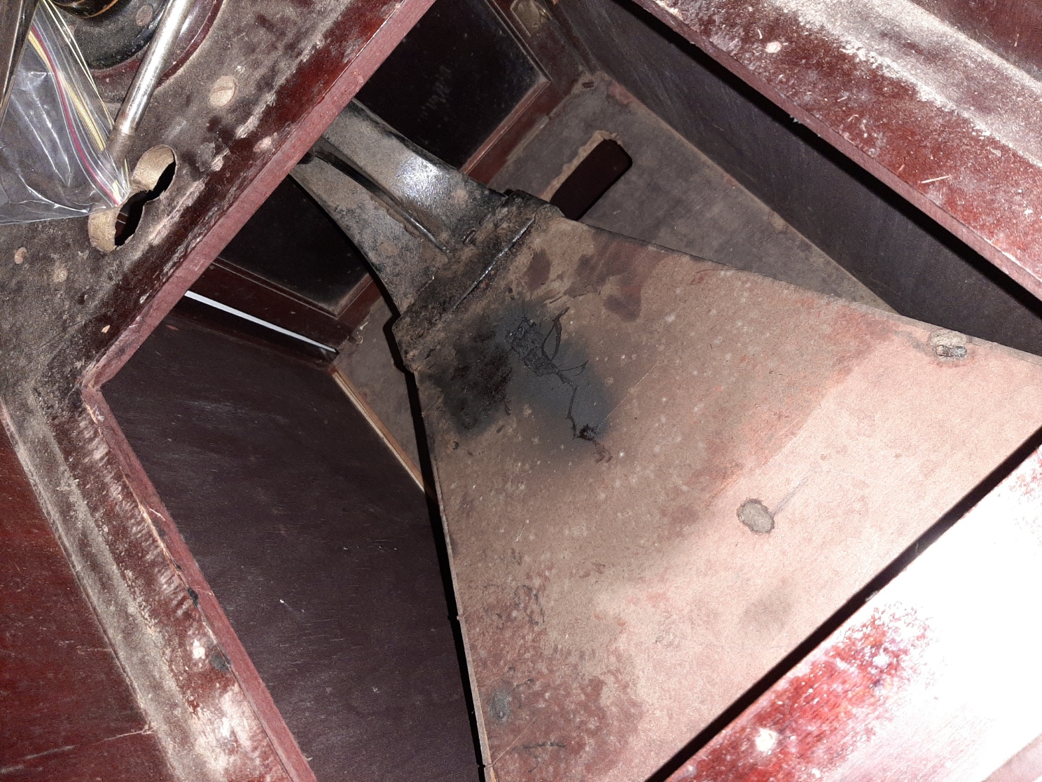

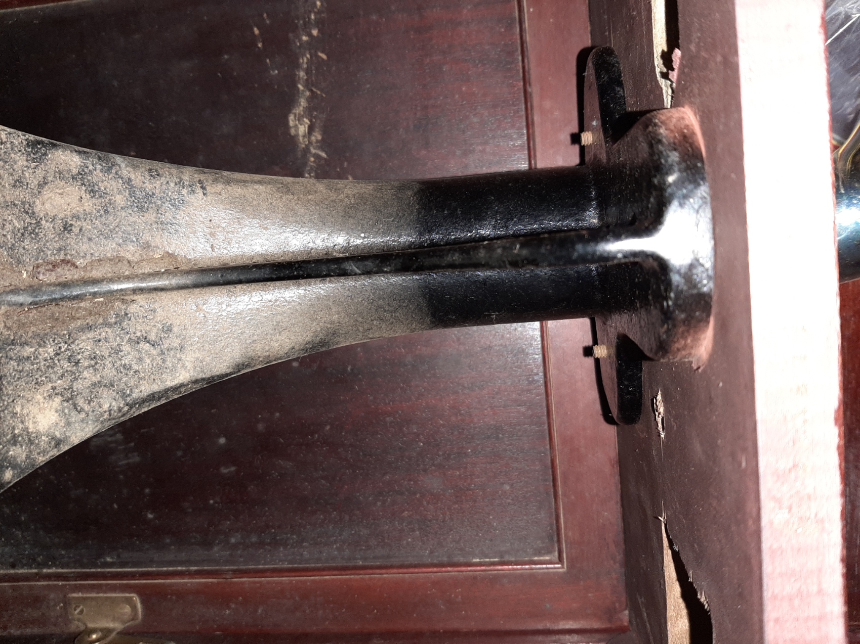

Hi. Here are the photos of the horn as requested. Hope this helps.

Re: Re-motored "Die Stimme seines Herrn" Cabinet
Thank you so much for uploading photos of the horn. Now we can see the original horn that is in your machine, and as also earlier remarked from knowledgeable forum members, we can see that the horn inside my GEM, is not original.

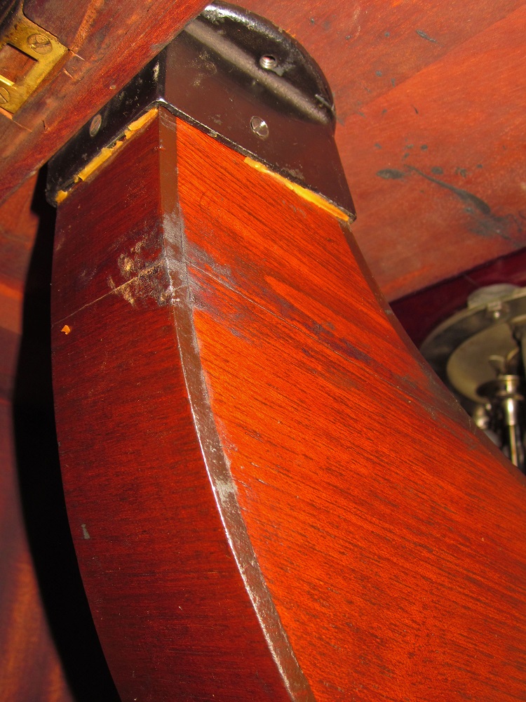

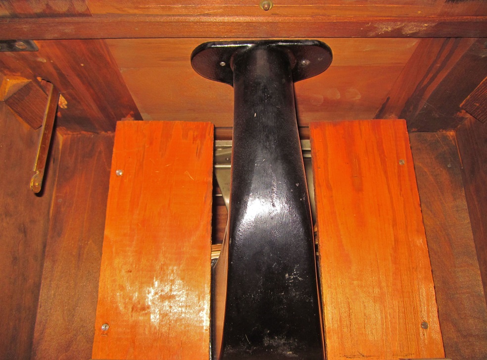

I don't see how this machine could ever have had a horn much different from what it has now- certainly not one of the later Victor/HMV horns with their heavy iron castings. Because of their weight, those horns required at least one additional machine screw (usually placed in front of the tone arm base). Notice that the machine in question has no such screw. I realize it's risky to assume American practice was followed anywhere else but look at these pictures of an early Victrola horn (1906-07) compared with one of 1909. Your horn looks (to my eyes anyway) much like my early one; almost entirely wood and light enough to be satisfactorily supported by just the three screws in the tone arm base. Yes, a skilled home woodworker could have made your horn, but if that's a cast-iron "collar" at the throat (as it is on mine) it's unlikely any home workshop made that.
