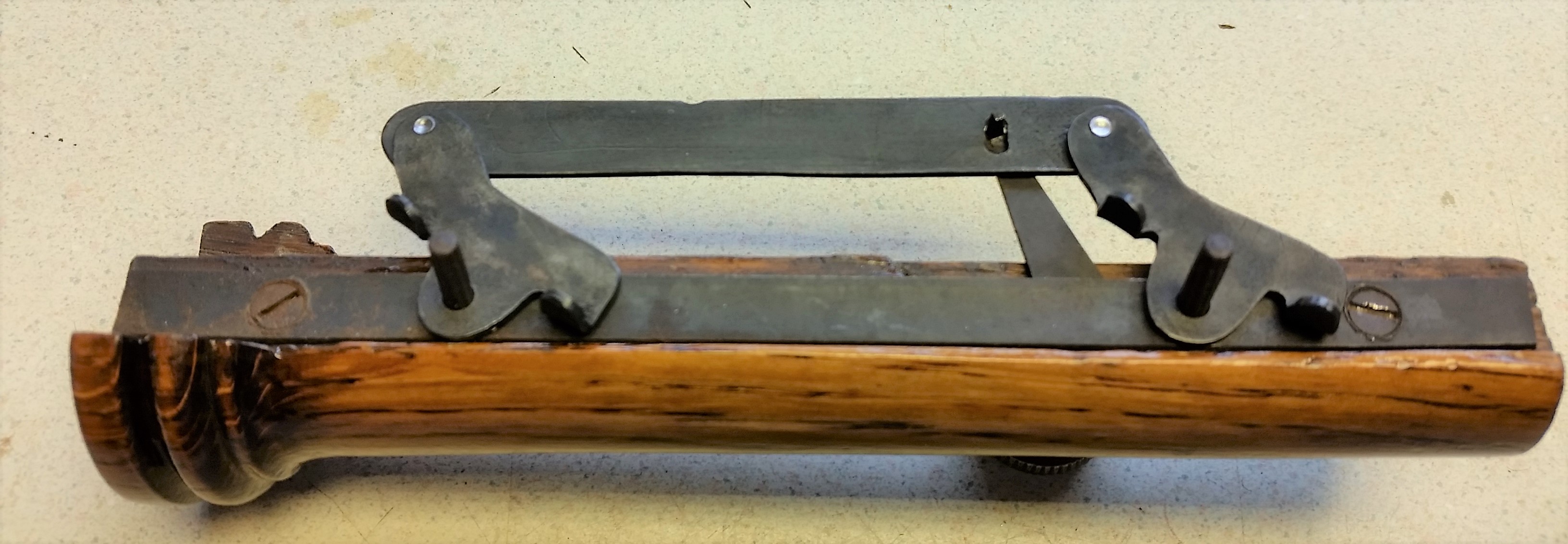

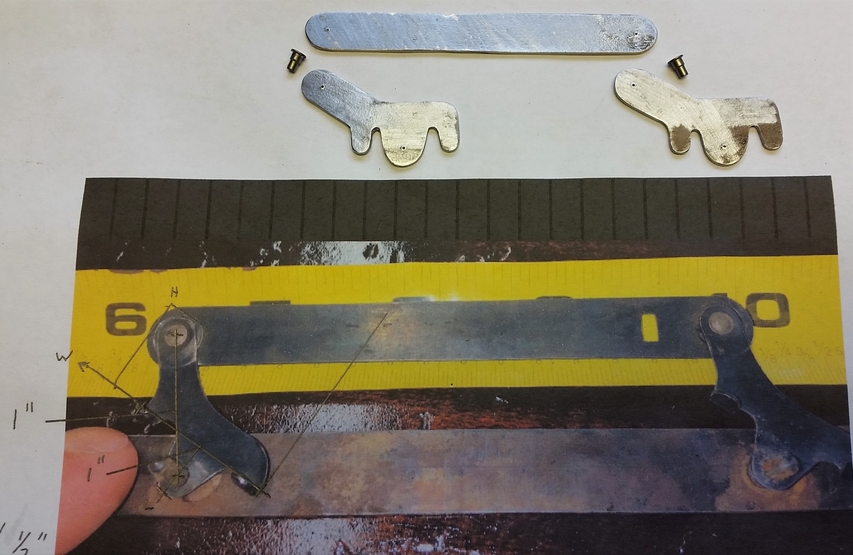

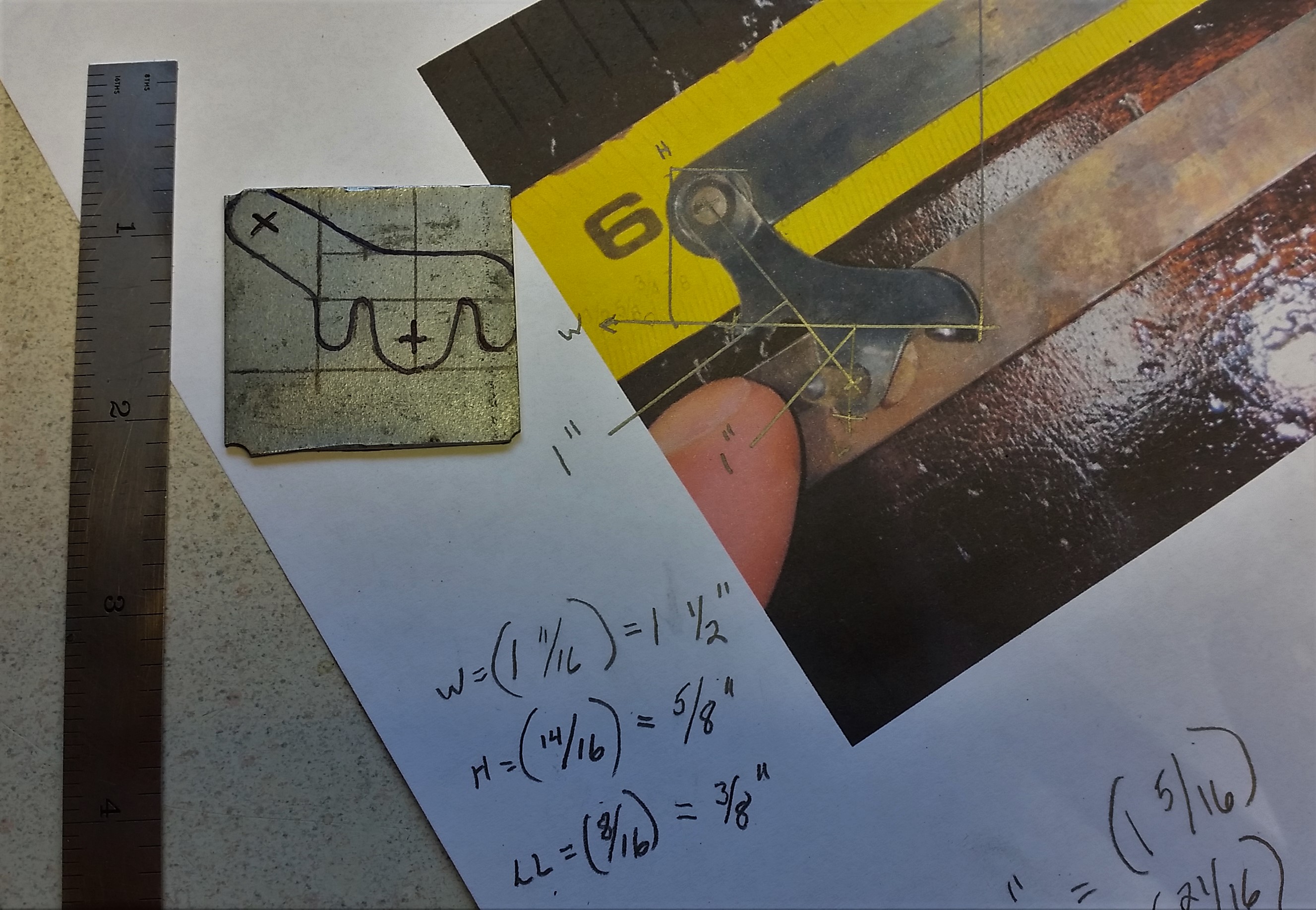

Thanks all, dzavracky thank you for the great pics and the time you took to dimension your louvers. I was able to use your pics with the ruler to scale and make a pattern.
Your machine is and upright were mine is a table top. There are a little differences but angles and engineering should be the same. Your machine, louver pivot pin to louver pin looks to be about 3 ½", mine is 3" pin to pin. I just scaled my blanks to 3" pivot points for the louver pins and the linkage rod. I will rivet the linkage together after final drilling of rivet hole and bent tabs to move the louvers. Then I will blue the steel. Here is where I am at today with my blanks.

Thanks David, But I am able to get what I need from what you posted for me. You have done way more than what I have needed. Thanks for the louver detail but I think by all the research that my machine has flat louvers on both sides and does not have the curve on the inside. They are 3" buy 12 ¾", just different horn opening.

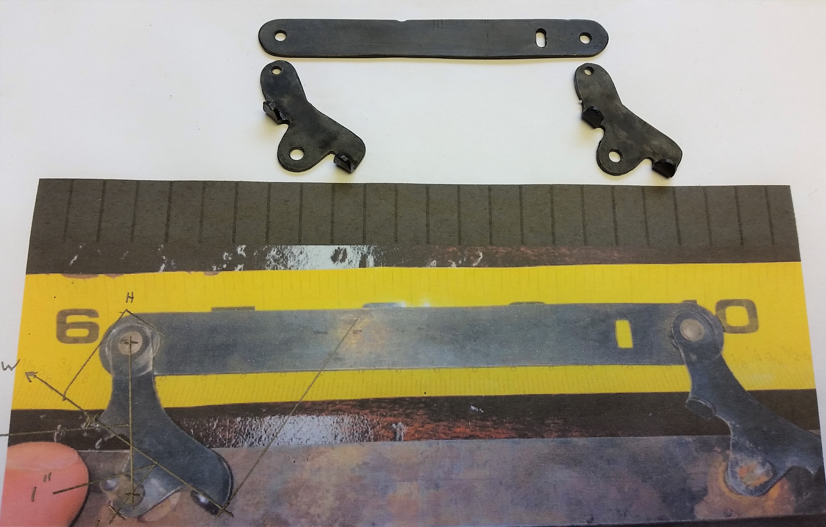

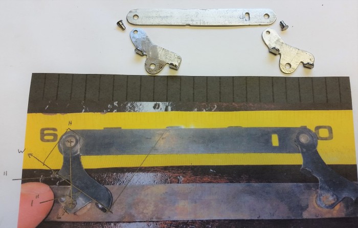

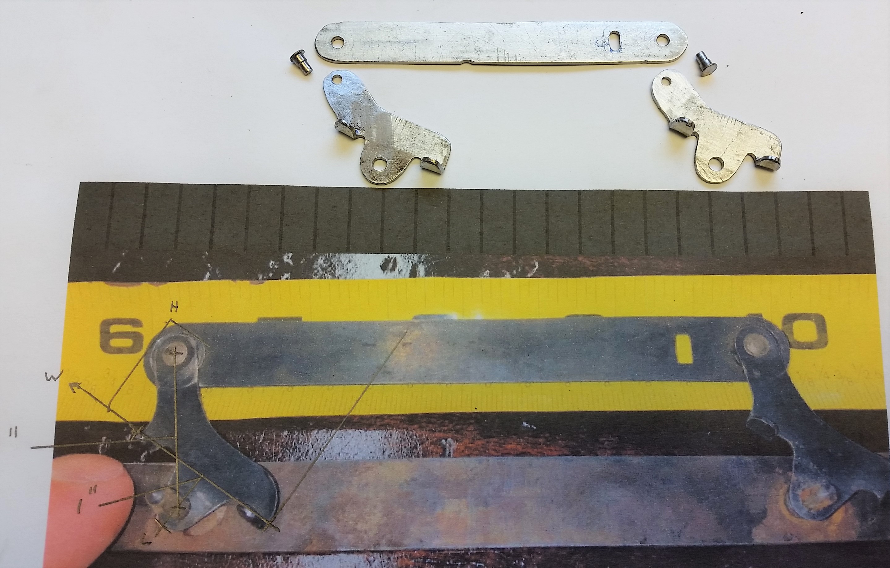

I drilled all the holes on the blanks were I thought they should go and bent over the louver tabs per my thickness of the louvers I am about to make.

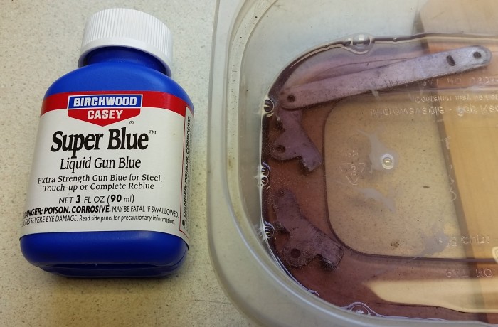

I used degreaser on the pieces to prep them for bluing
After bluing the pieces are ready for staking.

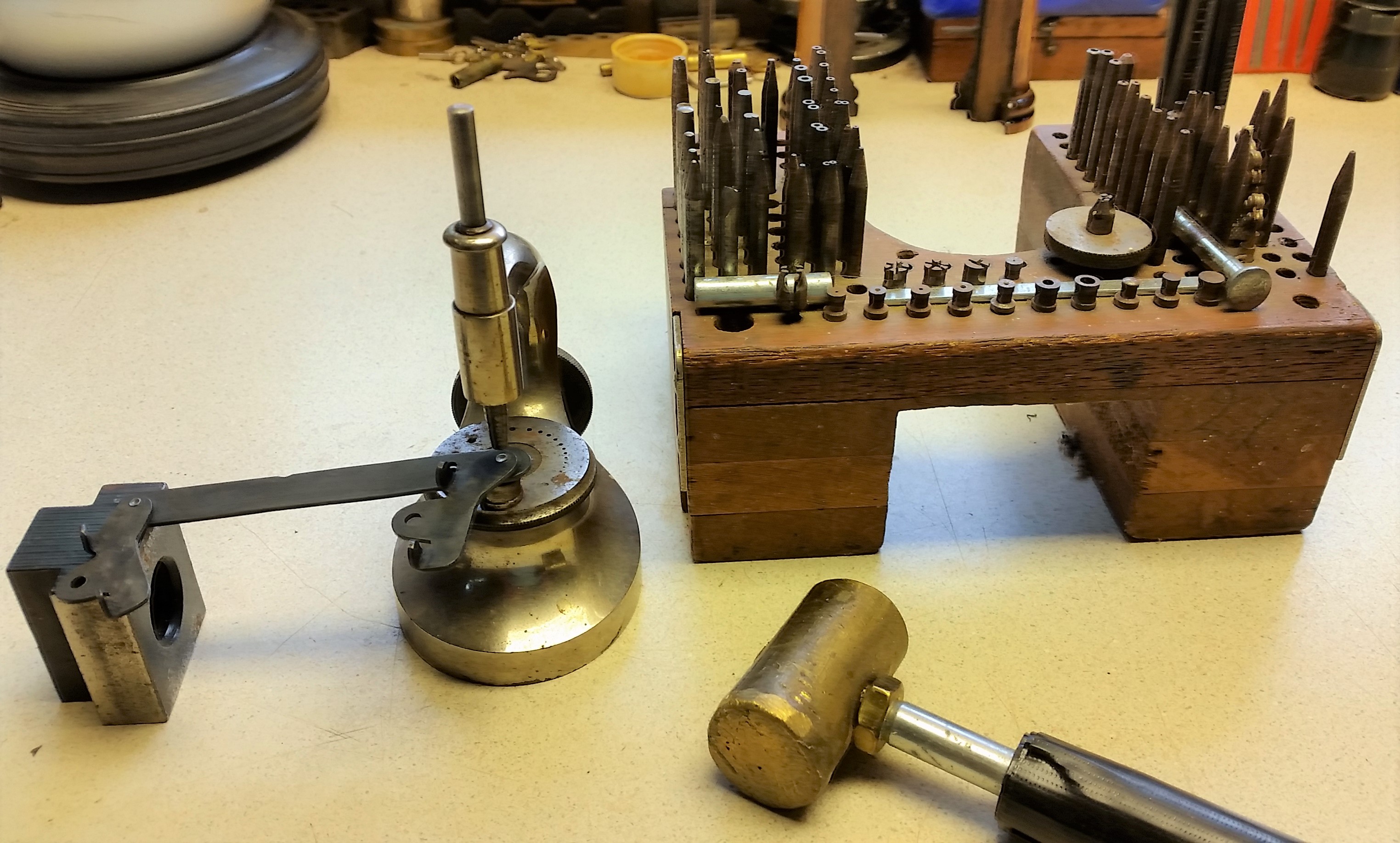

I used my clock staking anvil to stake the rod and levers. The rod runs on a shoulder on the rivet, the rivet is staked solid on the louver cams.
As far as I can tell right now the new linkage will open and close the louvers if I can make them right.
