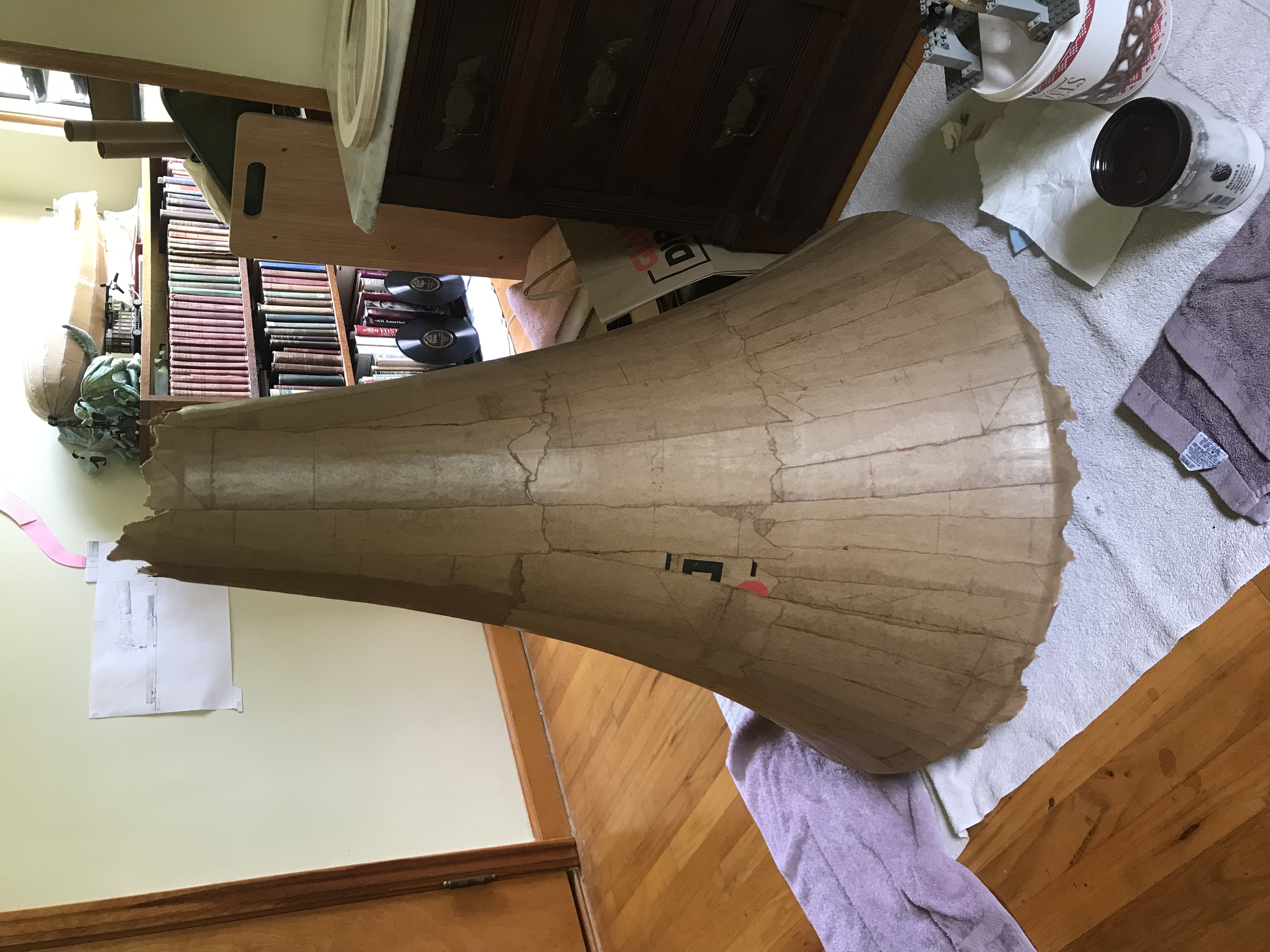

Well, I may not have any more of that particular paper, but I have plenty of other packing papers that I’ve been saving for the project, so I can certainly test some to see if they give similar results. My original intention was to use off-white paper for a finishing layer, but the brown color has been growing on me—from a distance, the color is reminiscent of the reptilian paper used on some EMG horns, and the mottling is a very interesting effect.
I started work on the mouth section, and just added the third layer (fifth and sixth, counting individual sheets) to-day; I mismeasured when cutting out the wood ring for the mouth—gave it a 12.75” radius instead of 13.75”—but then realized that I can just cut off the extra paper from each layer before adding the next, and fold a final layer over the cut edge after the horn is off the former.
Once the lower layers have dried, adding more wet layers on top makes the first layers expand, so the mouth keeps expanding and rippling as paper is added, but so far, it seems to shrink back and pull tight against the former—Could this be why homemade paper horns tend have wrinkly inner surfaces? And if so, has anyone else noticed it happening and found a way to prevent it?
Rippling from first layers expanding when re-wet while applying second layers.  The rippling wasn't as bad when I applied the third pair of layers, so I'm hoping that it keeps becoming less noticeable as layers are added.
Horn progress as of yesterday--the paper had dried and pulled tight at this point, and the rough ends had not been cut off yet.
