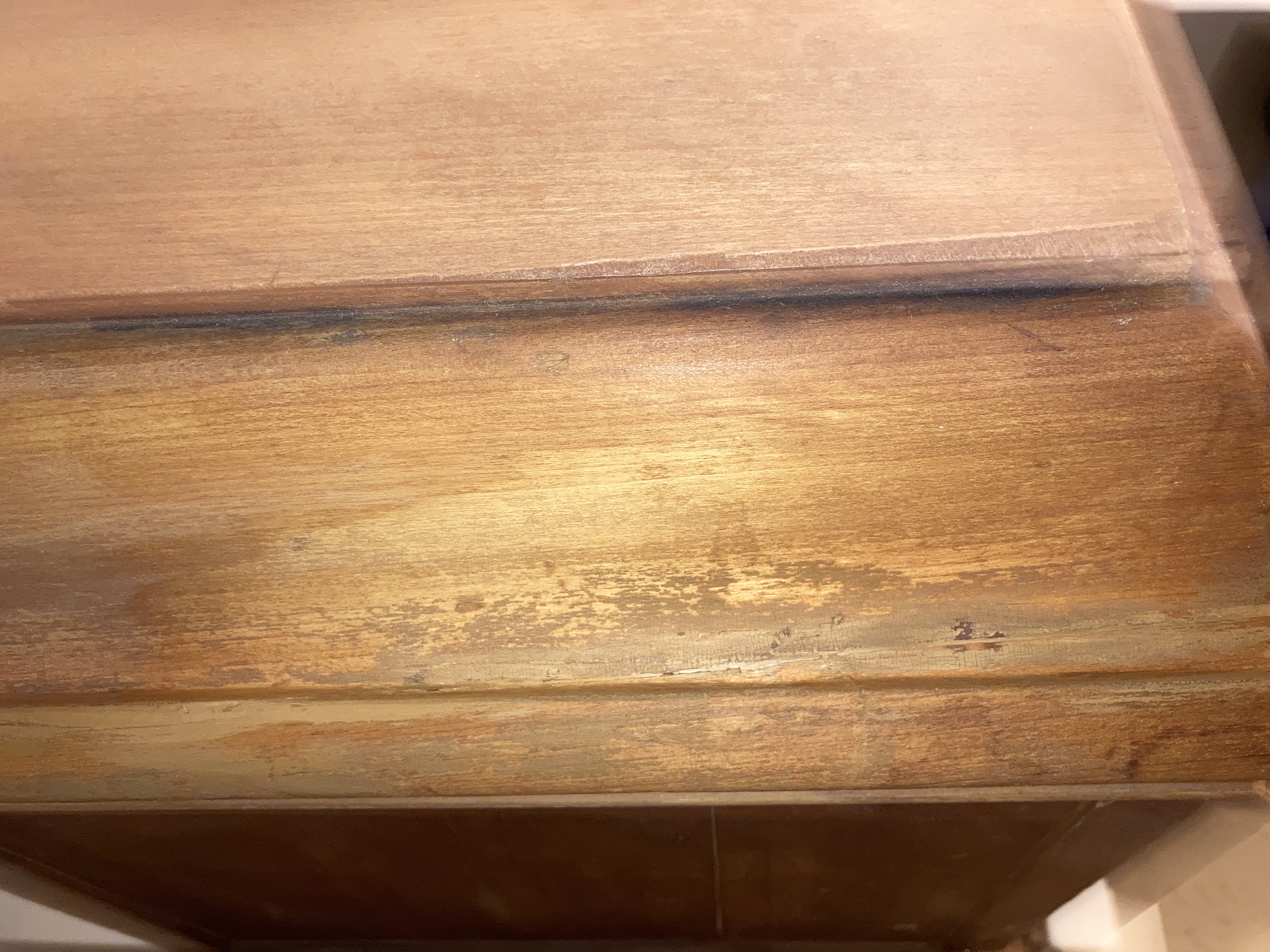

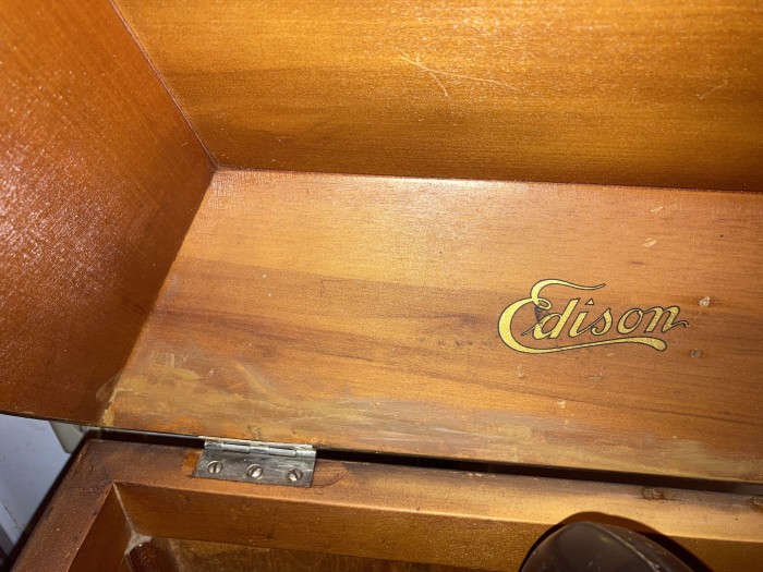

Looking closely at the back of the lid, I can see where a possible repair was made because the lid had broken at one point?

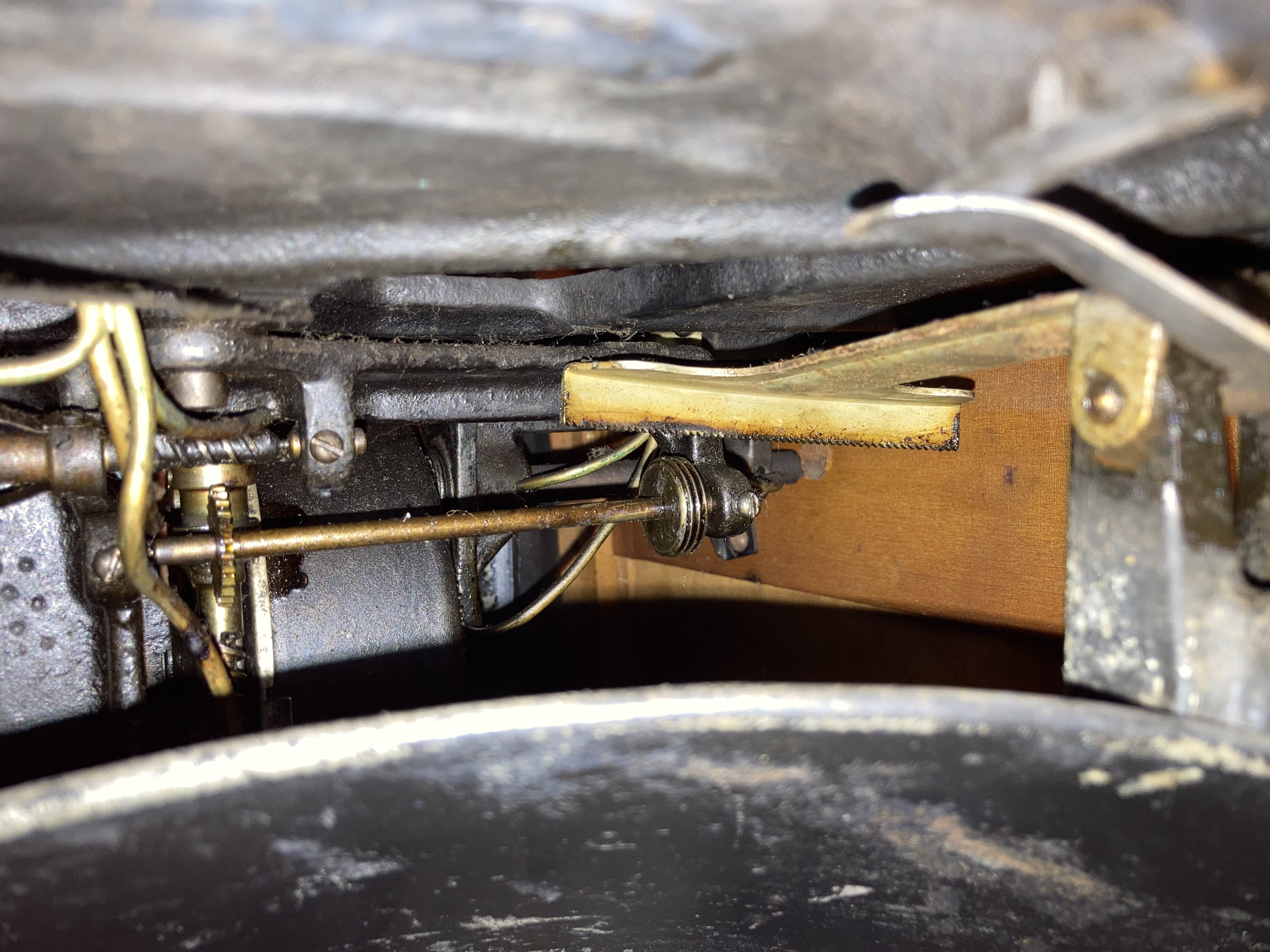

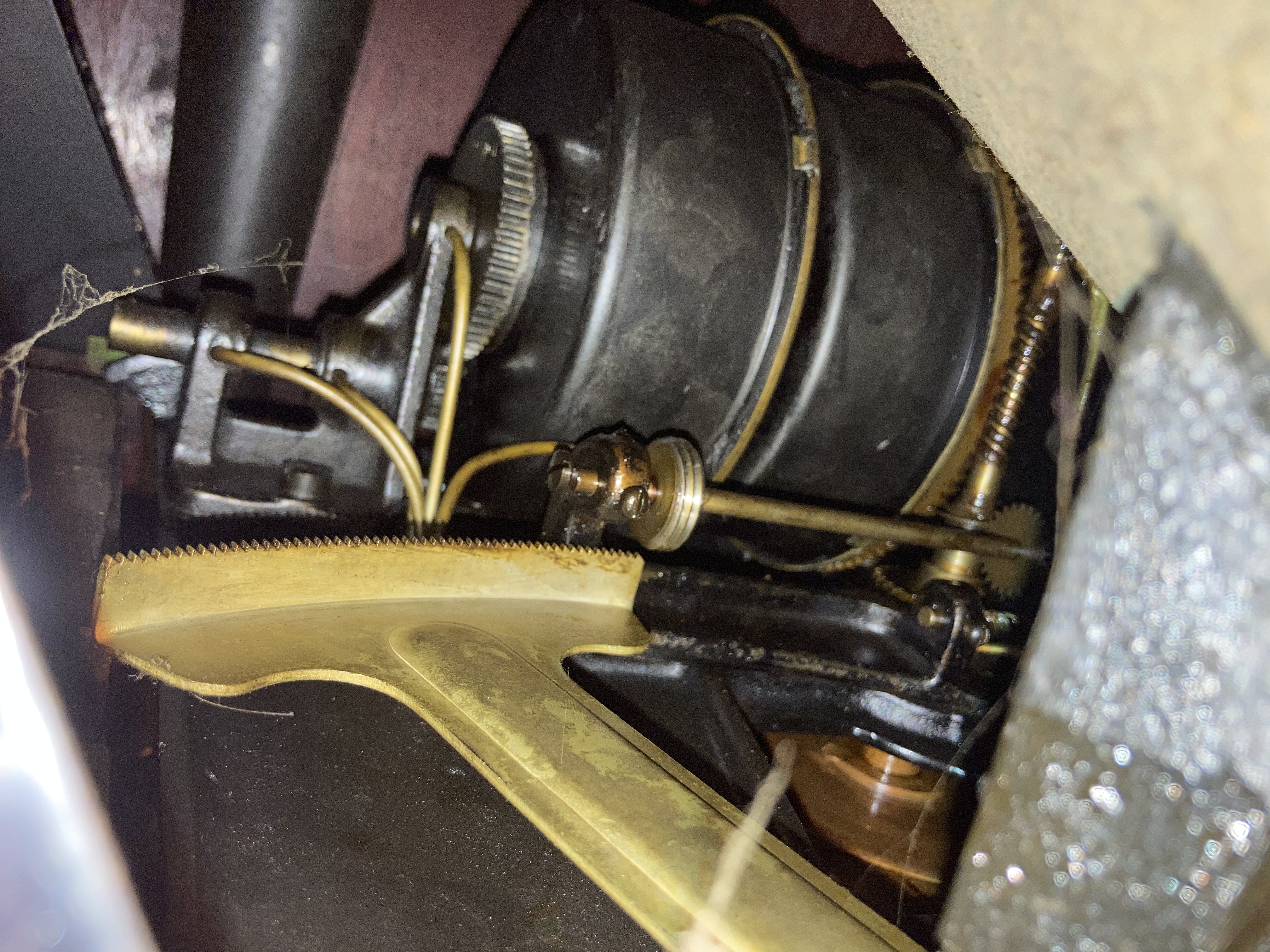

"Is the feed rack giving you the same business as me where I adjust it to not have the teeth scrape with the wheel, the beginning of the record won’ track at the beginning? Or when I set it to make contact to the beginning of the record, the teeth scrape the wheel moving it back? I think something’s bent."

The horn doesn’t appear to be bent? I have the issue temporarily fixed, I slightly bent it the other way so and it seemed to take care of it?VanEpsFan1914 wrote: Tue Nov 23, 2021 8:16 am "Is the feed rack giving you the same business as me where I adjust it to not have the teeth scrape with the wheel, the beginning of the record won’ track at the beginning? Or when I set it to make contact to the beginning of the record, the teeth scrape the wheel moving it back? I think something’s bent."

What did you have to bend, the rack itself? I'm glad you got it fixed--if it's working, then that's great!

Well bending the rack the other way did fix my issue I don’t know if it’s supposed to be angled like that. I’ll look at the one on my C-19 and compare.VanEpsFan1914 wrote: Tue Nov 23, 2021 9:49 am What did you have to bend, the rack itself? I'm glad you got it fixed--if it's working, then that's great!

Here’s the feed rack for my C-19 it’s on completely straight and not at an angle. This confirms my suspicion that the feed rack in my B-19 somehow got bent and was causing the tracking issue I was having!
