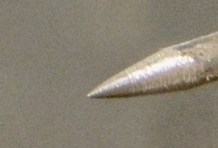

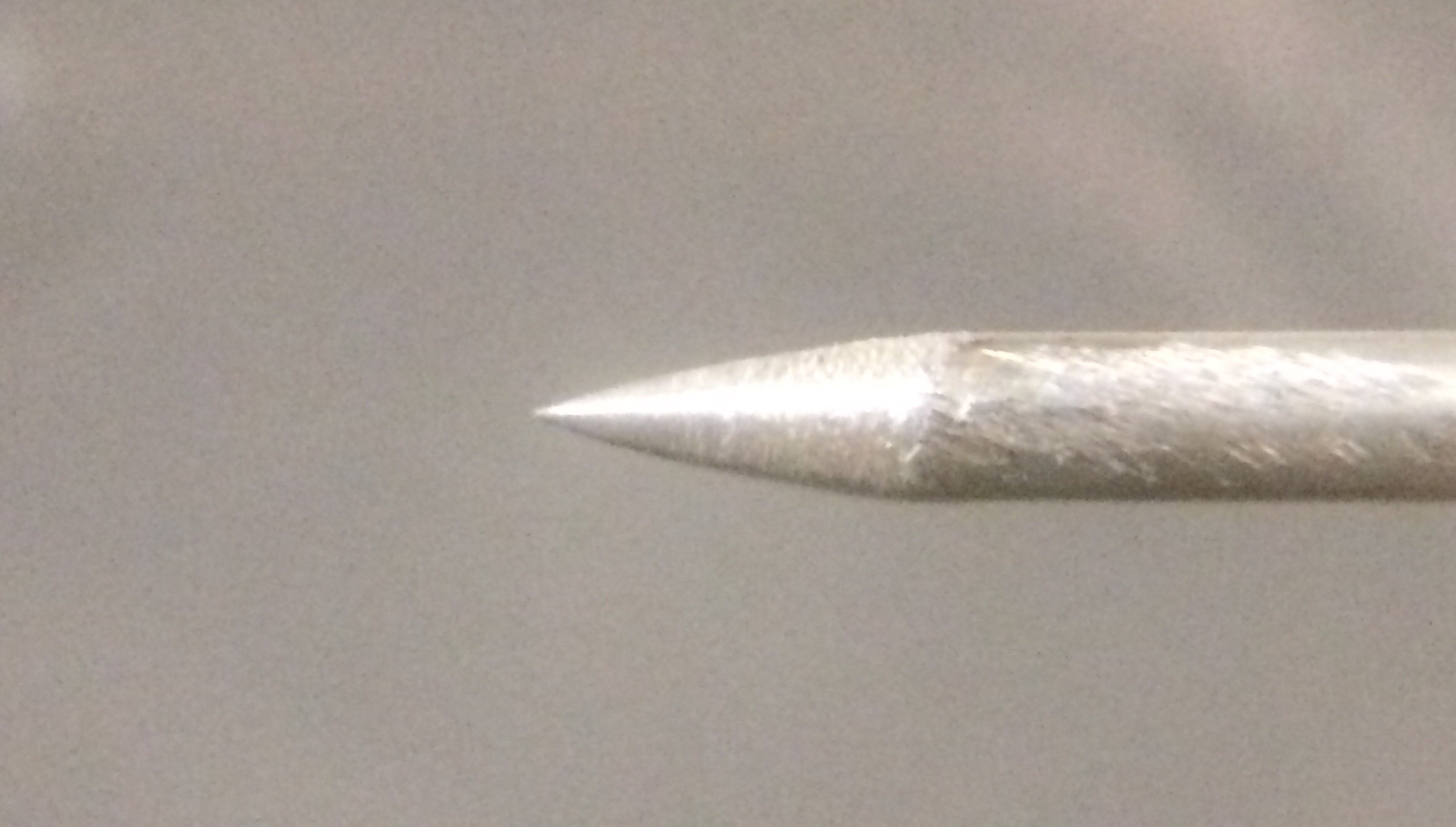

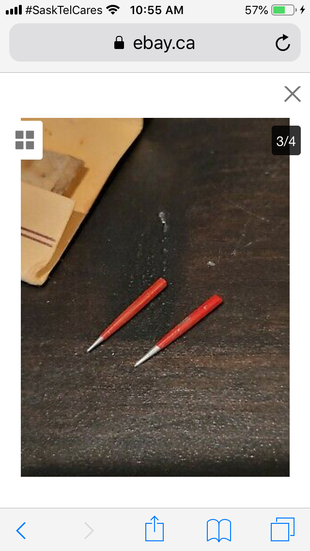

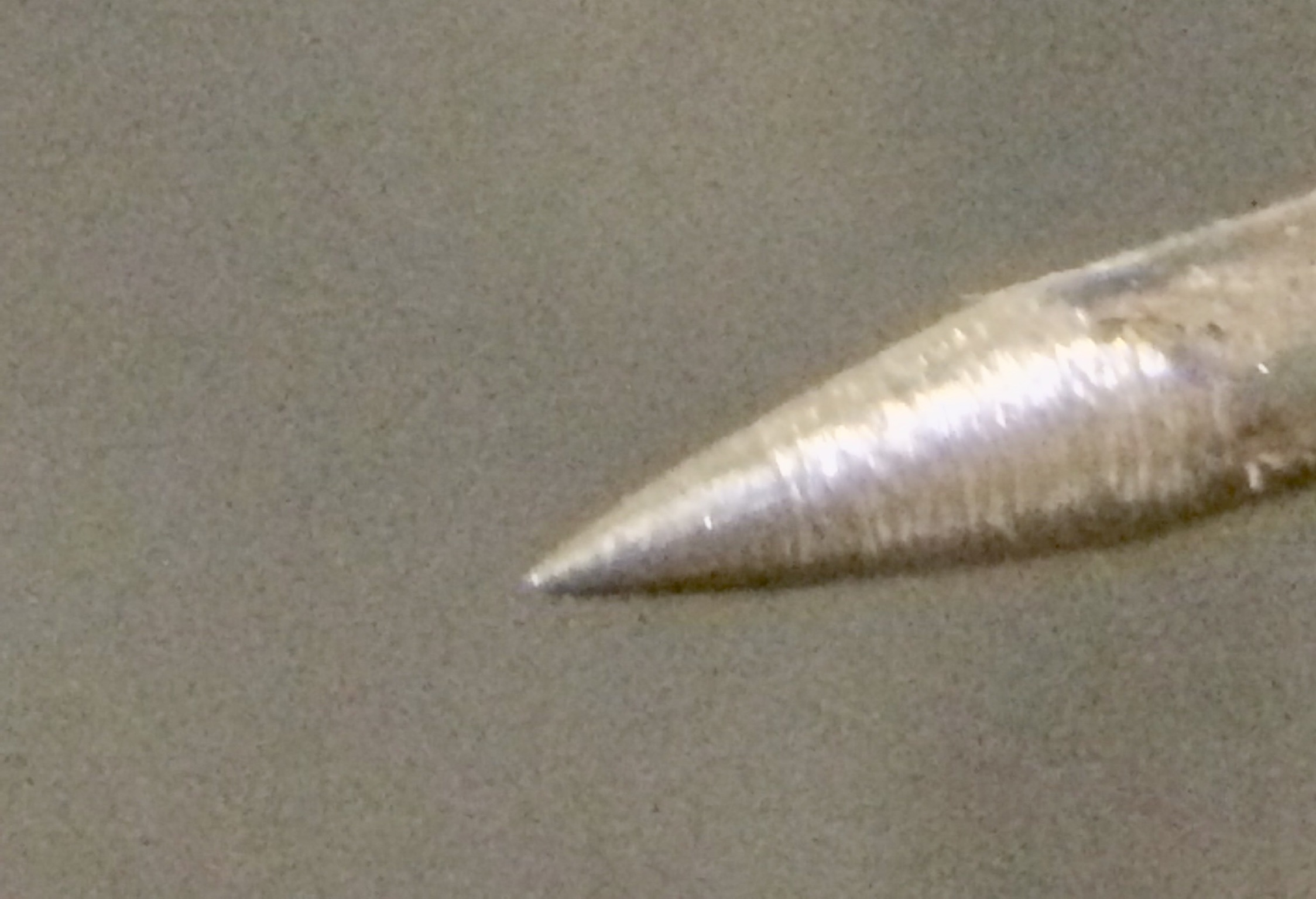

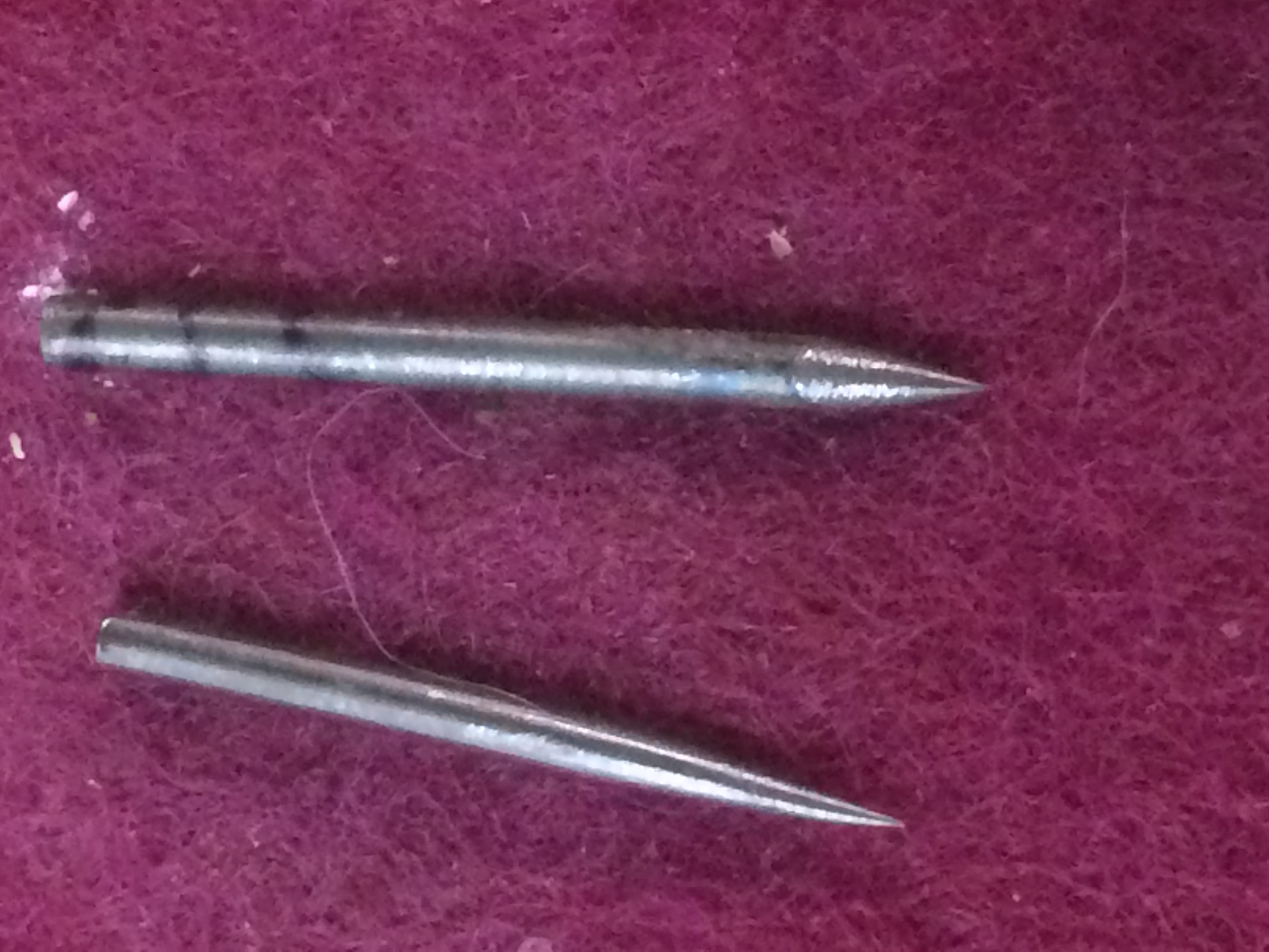

Well, a few days ago I made a needle from a tungsten TIG electrode, the 1/16” size, and played a good condition record that I do not care for much (I Miss My Swiss, Victor 19718) ten times without changing or resharpening the needle. The record seemed to suffer no damage and the needle showed only about as much wear as a normal needle suffers after a single play.
Yesterday, I saw on Ebay, from a seller in California, some old stock needles that I think are also tungsten but, like mine, in the form of normal needles.
I include pictures of my needle, posed beside a loud to e steel needle, and the ones from Ebay, though the pictures seem to want to load in the opposite order of what I intended.
